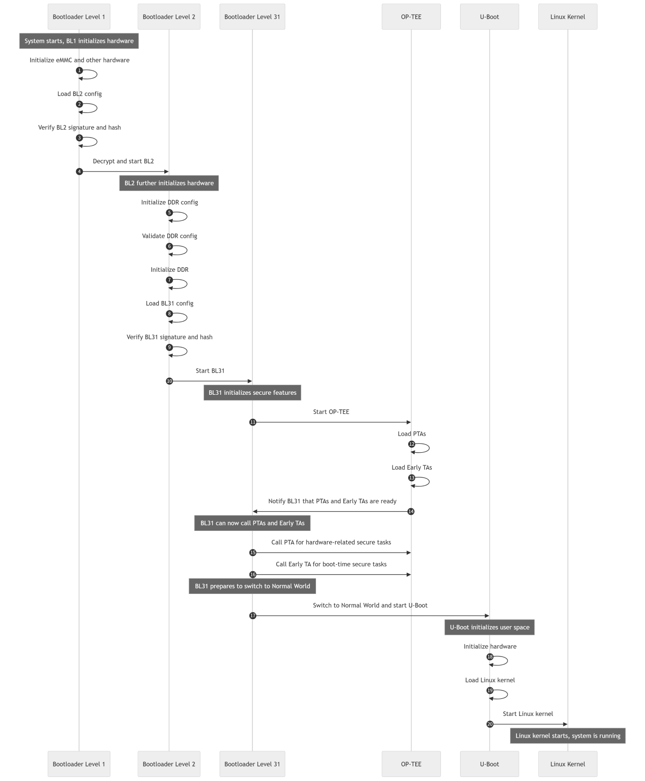

The bootloader boot flow on the X5 platform is as follows:
bootloader_startup_process
Overview of Bootloader Boot Process:
  1. BL1 Stage (Bootloader Level 1):
    This stage initializes basic hardware functions, checks eMMC configuration, and loads the BL2 configuration file. During this process, BL1 verifies the signature and hash value of BL2 to ensure firmware integrity and origin. Upon successful verification, BL1 decrypts and starts BL2.
  2. BL2 Stage (Bootloader Level 2):
    BL2 continues hardware initialization, especially DDR configuration, loads DDR configuration files, and performs hash validation. After DDR initialization, BL2 loads and verifies the signature and hash value of the BL31 configuration file to ensure its security. Upon successful verification, BL2 starts BL31.
    Entering Secure World: After BL2 starts BL31, the system enters the Secure World, preparing to execute security-related initialization tasks.
  3. BL31 Stage (Bootloader Level 31):
    BL31 is responsible for initializing security features and launching OP-TEE (Open Portable Trusted Execution Environment). After OP-TEE completes secure environment initialization, control returns to BL31, which executes security-related tasks via PTA (Pseudo Trusted Application) and ETA (Early Trusted Application).
    Secure World Operations: BL31 and OP-TEE run entirely within the Secure World, ensuring the security of the entire boot process.
  4. OP-TEE Stage:
    This stage loads OP-TEE’s PTA and Early TA, providing secure services such as encryption and key management. All operations are performed within the Secure World, ensuring isolation and security of security tasks.
  5. Switching to Normal World:
    After BL31 completes security tasks, the system prepares to switch to the Normal World. BL31 transfers control to U-Boot, completing the transition from Secure World to Normal World. This process is achieved through mechanisms provided by TrustZone, ensuring isolation between Secure and Normal Worlds.
  6. U-Boot Stage:
    After BL31 finishes its work, control is transferred to U-Boot. U-Boot’s main responsibilities include loading and verifying the Linux operating system and initializing the user-space environment, including hardware initialization and preparation of user interaction interfaces. After mounting Linux system partitions, U-Boot begins executing user-space code.
    Normal World Operations: U-Boot and the subsequent Linux kernel run in the Normal World, handling regular system functions and user interactions.
  7. Linux Kernel Startup:
    Finally, U-Boot boots the Linux kernel, completing the system startup process. The Linux kernel runs in the Normal World, managing system resources and executing user applications.

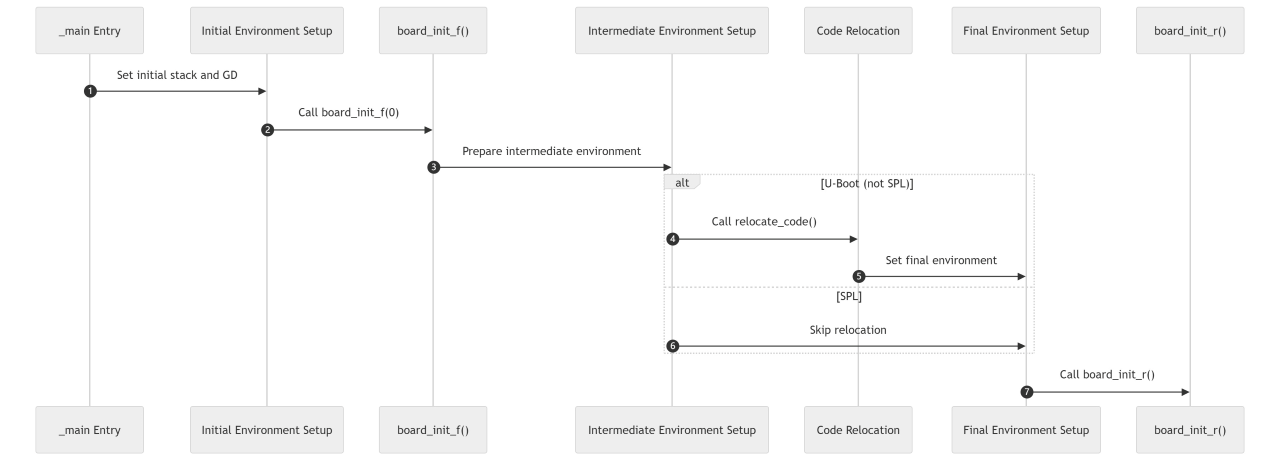

_main
The _main function is located in uboot/arch/arm/lib/crt0_64.S. crt0_64.S is U-Boot’s startup code for the AArch64 architecture, responsible for setting up the C runtime environment and jumping into C functions board_init_f and board_init_r to complete initialization at different stages.
The _main function is primarily responsible for:
  1. Setting up the initial runtime environment, preparing the stack and initializing global data (GD).
  2. Calling board_init_f() to initialize hardware.
  3. Enabling debug serial port (optional).
  4. Setting up intermediate environment and performing code relocation (U-Boot only, not SPL).
  5. Preparing the final environment and calling board_init_r().
Execution flow of _main function:
_main_Timing
Detailed explanation:
  1. Entry (_main Entry):
    • Entry point of the _main function, starting the entire boot process.
  2. Initial Environment Setup (Initial Environment Setup):
    • Set up initial stack and global data structure (GD), preparing the environment for calling board_init_f().
  3. Call board_init_f():
    • Call the board_init_f() function to prepare the hardware environment for running in system RAM.
  4. Intermediate Environment Setup (Intermediate Environment Setup):
    • Update stack and GD based on results from board_init_f().
  5. Code Relocation (Code Relocation):
    • If U-Boot (not SPL), call relocate_code() to move U-Boot code to the target address.
  6. Final Environment Setup (Final Environment Setup):
    • Set up the final runtime environment, including initializing BSS and non-constant data.
  7. Call board_init_r():
    • Jump to board_init_r(), entering the next phase.
Branch Explanation:
  • Difference between U-Boot and SPL:
    • For U-Boot, code relocation is performed.
    • For SPL (Secondary Program Loader), relocation is skipped, directly proceeding to final environment setup.

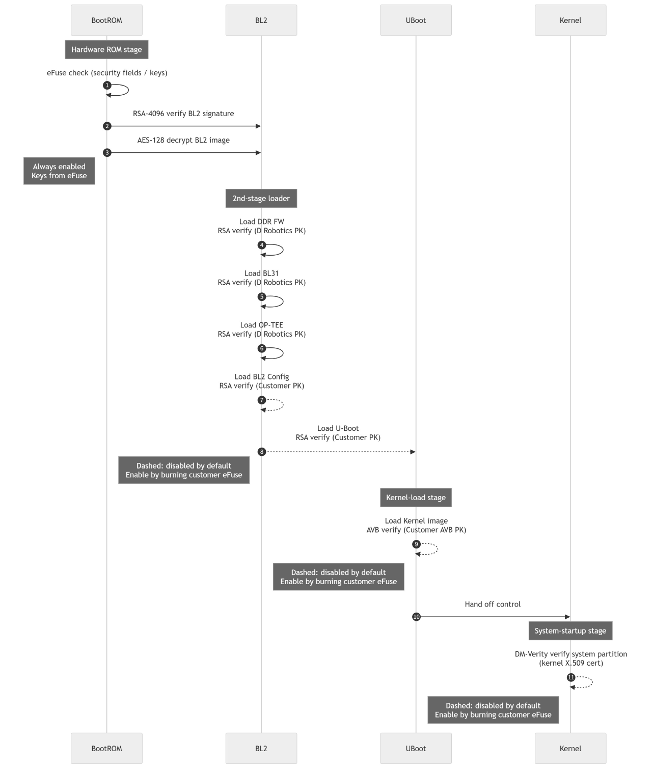

Introduction to Secure Boot Process
Secure Boot is a crucial mechanism ensuring the integrity and trustworthiness of firmware and software during system startup. Throughout the bootloader boot process, secure boot is based on the Root of Trust, verifying boot images level by level to achieve trusted firmware loading.
The Secure Boot process in this system is shown below:
secure_boot
BootROM Stage
Verification Mechanism:
  • Signature Verification: RSA-4096 (based on public key certificate)
    • BootROM uses the RSA-4096 public key algorithm to verify the signature of firmware (e.g., BL2). RSA-4096 is a commonly used strong encryption algorithm, sufficient to ensure the security of the verification process. Signature verification ensures firmware content has not been tampered with and originates from a trusted source.
  • Decryption Algorithm: AES-128 (used for BL2 image decryption)
    • AES-128 (Advanced Encryption Standard) is used to decrypt the BL2 image. AES-128 is a symmetric encryption algorithm with high security and performance. During boot, AES-128 decryption protects firmware confidentiality, preventing tampering or leakage during transmission.
  • Certificates/Keys:
    • Root Public Key: Stored in eFuse, typically a non-modifiable hardware storage area. The root public key allows BootROM to verify BL2’s digital signature. Pre-provisioned root public keys ensure only trusted firmware passes verification.
    • AES Decryption Key: May also be stored in eFuse or hard-coded in hardware to enhance key protection, ensuring key security and preventing malicious programs from obtaining the key and cracking the firmware.
  • Default State:
    • Signature verification and decryption are enabled by default, requiring no customer intervention.
BL2 Stage
Certificate and key information involved in the BL2 stage is shown in the table below:
Image Verifier Certificate Source Default State
BL31 D-Robotics D-Robotics pre-provisioned public key certificate Enabled by default

The main task of the BL2 stage is to verify the integrity and trustworthiness of firmware images, ensuring no malicious code is loaded during boot. All images use RSA signature verification, using pre-provisioned public key certificates to verify firmware legitimacy.
  • Verification Mechanism: All images use RSA signature verification
      • Use the certificates/keys listed in the table above for verification.
    • Default State:
      • Disabled by default; verification for U-Boot and BL2 Config requires customers to enable custom public keys by burning eFuse.
    • Key Operation: Perform hash verification (verify_hash) before loading BL31 and OP-TEE to ensure image integrity.
    • For detailed information on U-Boot and BL2 Config verification, refer to the U-Boot & BL2 CFG Verification section.
Certificate and Key Management:
  • At the BL2 stage, D-Robotics provides pre-provisioned public key certificates to verify the integrity of BL31, OP-TEE, and DDR Firmware images.
    • By default, verification for these images is enabled, ensuring trustworthiness of these critical components.
    • The system automatically verifies these images during boot to ensure they have not been tampered with.
  • For U-Boot and BL2 Config images, verification is disabled by default. Customers can enable custom public key certificate verification by burning eFuse according to their needs.
  • For detailed information on certificates/keys, refer to the Key Management section.
RSA Signature Verification:
  • All firmware images (including BL31, OP-TEE, DDR Firmware, U-Boot, and BL2 Config) use RSA signature verification.
    • This mechanism verifies firmware integrity and authenticity through digital signatures, ensuring only unmodified images can be loaded and executed.
    • With RSA signatures, any unauthorized modification to firmware can be detected during boot, preventing injection of malicious code.
Image Integrity Verification:
  • Before loading BL31 and OP-TEE images, the system performs hash verification (verify hash) to ensure the loaded image files have not been tampered with.
  • This verification step is a critical part of the BL2 stage, ensuring image integrity and further enhancing system security.
U-Boot Stage
Verification Mechanism: Android Verified Boot (AVB)
  • Tools/Algorithms:
    • Use AVB 2.0 protocol to verify kernel image hash and signature.
    • Supports RSA-2048/4096 or SHA-256 hash trees.
    • Verification chain based on AVB public key burned by customer into eFuse.
  • Default State:
    • Disabled by default, requires customer to burn eFuse to enable AVB verification.
  • For detailed information on U-Boot encryption, refer to the Boot Encryption Introduction document.
Linux Kernel Stage
Verification Mechanism: DM-Verity (Device-Mapper Verity)
  • Function: Perform integrity verification (anti-tampering) on the system partition.
  • Configuration Dependency:
    • Disabled by default, requires customer to burn eFuse to enable DM-Verity.
  • Implementation:
    • After kernel boot, load DM-Verity metadata (hash tree and signature).
    • Use the public key pre-installed in the kernel keyring (system_trusted_keyring) to verify the signature.
  • For detailed information on AVB and DM-Verity, refer to the Kernel & Rootfs Verification section.
Summary of Security Configuration
Stage Verification Tool/Algorithm Certificate/Key Source Default State Enable Condition
BootROM RSA-4096 + AES-128 eFuse Root Public Key Enabled Hard-coded, not alterable
BL2 RSA Signature D-Robotics/Customer Certificate Partially Enabled Customer burns eFuse
U-Boot AVB 2.0 Customer AVB Public Key Disabled Customer burns eFuse
Kernel DM-Verity Kernel Built-in X.509 Certificate Disabled Customer burns eFuse
Additional Notes:
  • Tiered Verification in BL2 Stage: D-Robotics’ public key ensures trustworthiness of base firmware (BL31, OP-TEE, DDR FW), while customer public keys are used for business-related modules (U-Boot, BL2 Config), achieving responsibility separation.
  • Relationship between AVB and FIT Image: U-Boot supports both FIT (Flat Image Tree) image verification (traditional method) and AVB verification; priority for AVB flow must be configured at compile time.
