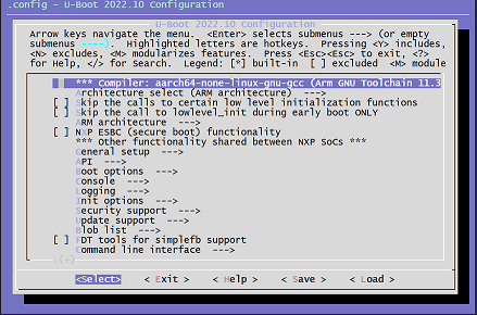

Within the xbuild build system, an automated tool is provided to configure U-Boot options. The following command simplifies the configuration process by automatically setting up the environment, generating configuration files, and saving them:
./bd.sh uboot menuconfig
# Or use the shortcut command after running source build/quickcmd.sh to set up the environment
bumc
Upon successful execution, the system launches a graphical configuration interface. Users can enable desired features or disable unwanted ones within this interface.
  • After opening the configuration interface, a series of options will be displayed. Users can interactively select features to enable or disable.
    image-20220518111319607
  • After completing the configuration, select Exit. The system will prompt whether to save changes. Choose Yes to save the configuration into the .config file.
    image-20220518111506018

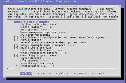

Configuring the Kernel is similar to configuring U-Boot. The xbuild system also provides a graphical interface to assist users in configuring Kernel options. Run the following command to open the Kernel configuration interface:
./bd.sh boot menuconfig
bbmc
Upon successful execution, the graphical configuration interface will automatically launch, allowing users to enable or disable required features.
  • After opening the configuration interface, a list of options will be displayed. Users can interactively select features to enable or disable.
  • After completing the configuration, select Exit. The system will prompt whether to save changes. Select Yes to save the configuration into the .config file.
