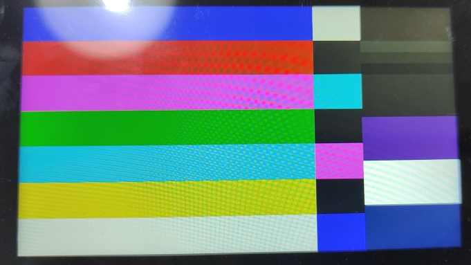

Test using the command: modetest -M vs-drm -a -s 73@31:720x1280 -P 33@31:720x1280@NV12
If everything goes smoothly, the connected display will light up and show the pattern shown in the image below (image rotated):
modetest-pattern
