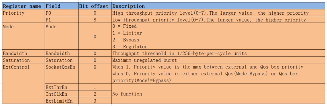

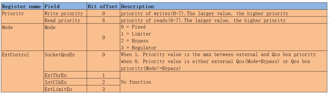

Register definition under Fixed Mode:
image-qos3

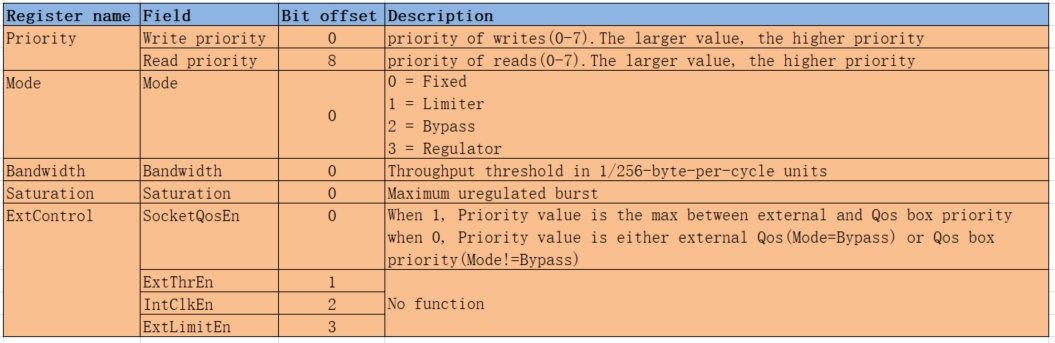

Register definition under Limiter Mode:
image-qos3

Register definition under Regulator Mode:
image-qos3

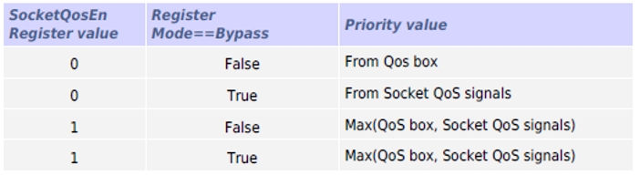

Bypass mode is more complex, where the value of the Priority register is determined by both Socket qos signals and Qos box:
  • Socket qos signals refer to internal QoS adjustment values (the maximum of AxQOS and Hurry), where:
    • AxQos: Value adjusted by the IP itself
    • Hurry: A signal supported only by SIF, which increases the processing priority of pending transactions that haven’t received a response for a long time. The SIF Hurry signal is driven by the almost-full signal of the relevant FIFO.
  • Qos box refers to the priority register value described earlier.
Main cases include:
  • When the SocketQosEn register value is 0 and the current mode is not Bypass, the priority is set via the priority register.
  • When the SocketQosEn register value is 0 and the current mode is Bypass, the priority is set by Socket qos signals.
  • When the SocketQosEn register value is 1, the maximum of Socket qos signals and Qos box is used as the priority.
Priority values follow the rules shown in the table below:
image-qos3

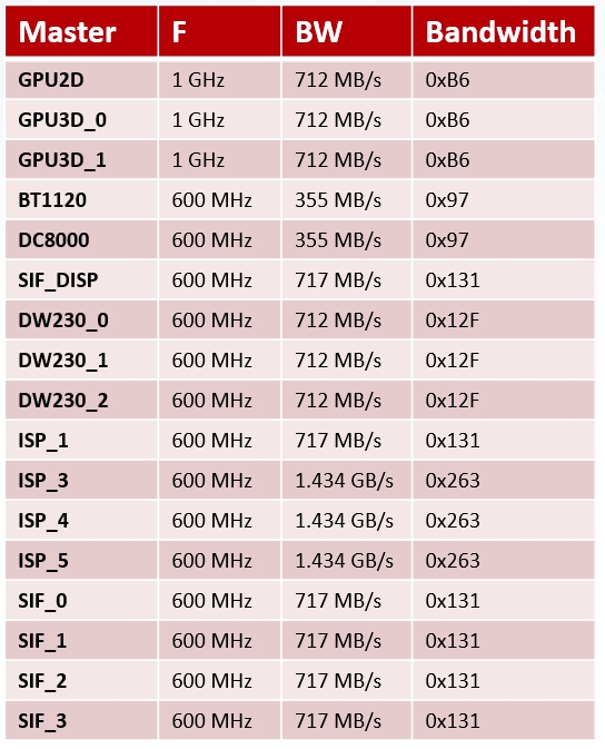

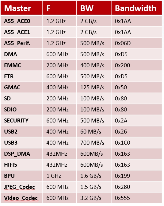

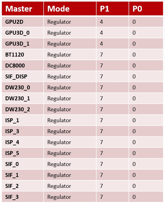

4.3.23.4. QoS Register Default Configuration
Bandwidth, BW, F Register Values
image-qos9
image-qos9

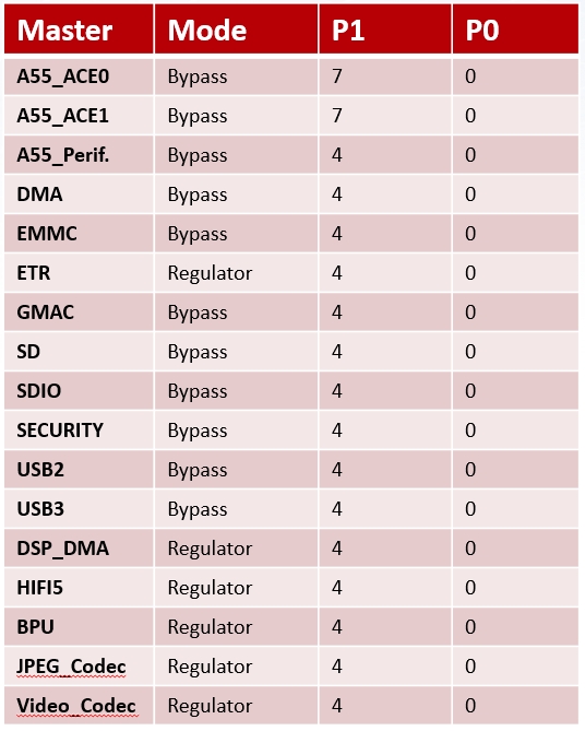

Mode, P1, P0 Registers
image-qos9
image-qos9
Notes

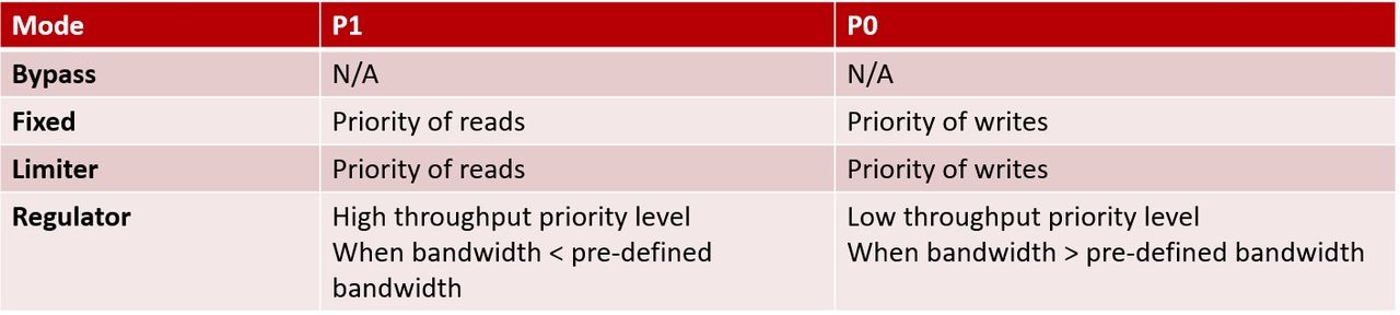

  • The X5 chip typically uses Fixed mode. To switch to Limiter, Regulator, or Bypass modes, see the Advanced Mode Configuration Section.
  • Priority register definitions differ across modes:
    • In Fixed and Limiter modes: P0 represents write priority, P1 represents read priority.
    • In Mode and Regulator modes: P0 represents low priority, P1 represents high priority.
  • Definitions of write\P0 and read\P1 priorities:
    • write\P0 priority is determined by bits [0:2] of the Priority register, range [0–7]
    • read\P1 priority is determined by bits [8:10] of the Priority register, range [0–7]
    • Higher numerical values indicate higher priority
image-qos3

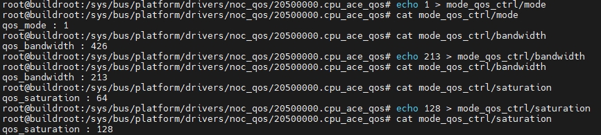

Example using cpu_ace_qos
Set Limiter mode with BW = 1 GB/s, threshold = 2 MB, where F = 1.2 GHz (module frequency; refer to QoS Register Default Configuration Table for module-specific frequencies). The Bandwidth register value is 0xD5, and the Saturation register value is 0x80.
image-qos9

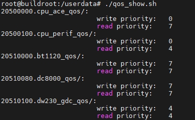

Without parameters (only read/write priorities displayed)
image-qos9

  - Requires root to write sysfs under /sys/bus/platform/drivers/noc_qos

Set Fixed set {module} fixed {read_p} {write_p} Fixed read/write priorities; {read_p} is read priority P1, {write_p} is write priority P0, range 0~7, higher value means higher priority
Set Limiter set {module} limiter {read_p} {write_p} {bw_mbps} {threshold_kb} Cap maximum bandwidth; {bw_mbps} (MB/s) is the desired bandwidth limit, {threshold_kb} (KB) is the adjustment threshold—rate limiting starts when bandwidth exceeds bw_mbps + threshold
Set Regulator set {module} regulator {p0_low} {p1_high} {bw_mbps} {threshold_kb} Guaranteed bandwidth; dynamically adjusts read/write priorities around target bandwidth {bw_mbps} (MB/s). {p0_low} is low priority P0, {p1_high} is high priority P1, P1 ≥ P0 required; drops to P0 when bandwidth exceeds bw_mbps + threshold, rises to P1 when below bw_mbps - threshold, keeps current priority within the adjustment band

Register conversion calc {module} {bw_mbps} [threshold_kb] [--freq mhz] Calculate only, no hardware write; converts {bw_mbps} (MB/s) to the bandwidth register; if {threshold_kb} (KB) is given, also converts the saturation register. Frequency F defaults to the embedded module table in the script; use {--freq mhz} to override. Both {threshold_kb} and {--freq mhz} are optional. Preview register values before configuring Limiter / Regulator
Additional parameter notes:
  • module: Module alias or full ID; see the table above, or list full IDs under /sys/bus/platform/drivers/noc_qos/
  • threshold_kb: Bandwidth adjustment threshold for Limiter / Regulator, written to the saturation register; conversion: saturation = threshold_kb × 1024 / 16 (i.e. threshold_bytes = saturation × 16). Register range 0~1023, corresponding to a maximum threshold of about 16368 bytes (max KB parameter for set / calc is 15). Common values: 1~2. Required for set limiter / set regulator; in apply profiles, either threshold_kb or sat_reg may be used.
  • bw_mbps conversion: Bandwidth register = 256 × BW / F, where F comes from the embedded module table in the script or calc --freq
  • Regulator mode: Hardware does not adjust read/write separately; it switches between P0 (low) and P1 (high) based on bandwidth. Read/write share the same priority set—different from read/write semantics under Fixed / Limiter.

List modules and configuration
# qos_tool.sh list  # List all QoS modules and current read/write priorities
# qos_tool.sh list -a  # Same as above, plus advanced, mode, bandwidth, saturation, extcontrol (full-capability modules)
# qos_tool.sh show sif0  # Show a specific module; sif0 is an alias in the script
# qos_tool.sh show -a cpu_ace  # Show cpu_ace with mode, bandwidth, and other register details
# Example: list all modules and read/write priorities
# qos_tool.sh  list

Register conversion (no hardware write)
# Convert using module frequency from the embedded module table
# qos_tool.sh calc cpu_ace 800 2
module     : 20500000.cpu_ace_qos
freq_mhz   : 1200
bw_mbps    : 800
bandwidth  : 170 (0xaa)
threshold  : 2 KB (2*1024 bytes)
saturation : 128 (0x80)
# Manually specify frequency F (MHz)
# qos_tool.sh calc cpu_ace 1000 2 --freq 1200
freq_mhz   : 1200
bw_mbps    : 1000
bandwidth  : 213 (0xd5)

extcontrol Extended control register — Optional Optional Optional

Mode Selection Guidelines
  • SIF, HDMI, ISP, GDC, VSE and other real-time pipelines: use Fixed with higher priority
  • BPU, codec and other background modules: use Fixed with low priority or Limiter to cap bandwidth
  • CPU and other modules needing dynamic bandwidth adjustment: optionally use Regulator

advanced and mode may differ (common after power-on)
# qos_tool.sh show cpu_ace -a
20500000.cpu_ace_qos             read=7 write=0
                        advanced=0 mode=2(bypass) bandwidth=426 saturation=64 extcontrol=0
Node Storage Value Meaning
mode Hardware register 0~3 Module current operating mode: 0=Fixed, 1=Limiter, 2=Bypass, 3=Regulator. Use this to determine actual behavior
advanced Driver memory (default 0) 0 Simple mode: writing write_priority_qos_ctrl / read_priority_qos_ctrl priority also sets mode to Fixed(0)
advanced Driver memory (default 0) 1 Advanced mode: writing priority does not change mode; Limiter / Regulator / Bypass remain effective
  • Before active configuration after power-on, advanced is usually 0 while mode retains the SoC boot default
  • When advanced=0, set fixed or writing priority forces mode back to 0 (Fixed)
  • set limiter / set regulator automatically sets advanced=1
  • save records the hardware mode as-is and does not mis-record as fixed when advanced=0; apply can restore bypass / limiter / regulator configurations
  • Module frequency F embedded in the script is derived from the QoS Register Default Configuration Table; if board clocks differ from the defaults, edit QOS_MODULES_CONF_DATA in hbre/hbutils/qos_tool/qos_tool.sh, or specify --freq in calc
