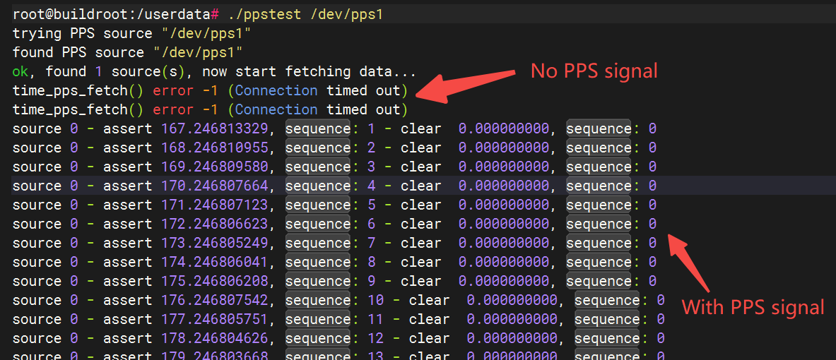

Use the ppstest test code to verify whether the PPS function can receive signals normally.
hobot_pps_example
The test tool can directly use open-source code: https://github.com/redlab-i/pps-tools
Compilation instructions are also available in the repository’s README.

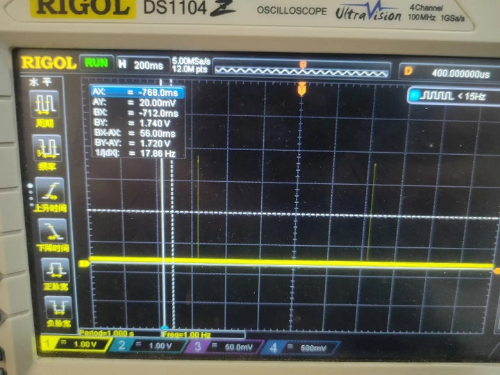

  • Q: How to confirm whether the PPS signal is actually generated?
  • A: An oscilloscope can be used to observe the signal. After connecting to the PPS signal generator, if a waveform like the one below appears, it indicates the PPS signal is being generated correctly.
pps_oscilloscope_display
If a PPS device is temporarily unavailable, a PWM signal can also be used to simulate the PPS signal to verify normal PPS testing. The signal in the figure above was generated using PWM simulation.
