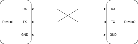

UART typically requires three wires: TX, RX, and GND. TX is used for data transmission, RX for data reception, and GND provides a reference potential.
uart_driver_single_link
It should be noted that each device’s TX and RX are defined from the perspective of the local device. That is, the local device’s RX is responsible for receiving data and must be connected to the other device’s TX to enable normal communication.

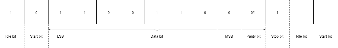

UART sends and receives data through a serial interface, transmitting data in frames. Each frame contains a start bit, data bits, an optional parity bit, and stop bits, among others.
instruction_diagram_of_frame_data_1
Explanation:
  • Start Bit: One logic 0 (low level) is sent to indicate the beginning of data transmission.
  • Data Bits: Can be 5–8 bits of data, transmitted LSB-first (least significant bit first), then MSB. Commonly used is 8 bits (1 byte), though others like 7-bit ASCII codes exist.
  • Parity Bit: Odd or even parity. With even parity, the total number of 1s (including the parity bit) is even; with odd parity, it is odd.
  • Stop Bit: Indicates the end of data transmission, can be 1, 1.5, or 2 bits of logic 1 (high level).
  • Idle Bit: When idle, the data line remains at a high level, indicating no data transmission.
instruction_diagram_of_frame_data_2
If we transmit the data 0x33 (binary 00110011), the corresponding waveform would be as shown above. Since LSB is transmitted first, the 8 data bits are sent in the order: 11001100.
To send additional data, simply repeat this process.

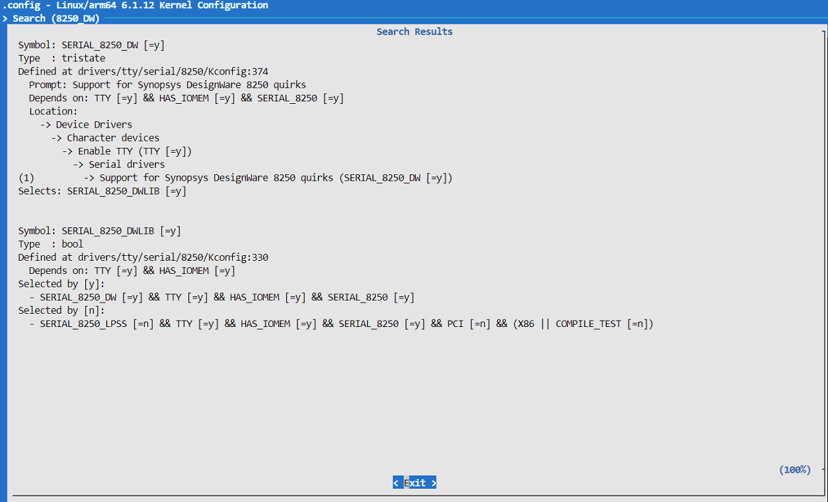

Kernel Configuration
SERIAL_8250_DW
SERIAL_8250_DWLIB
Kernel_deconfig

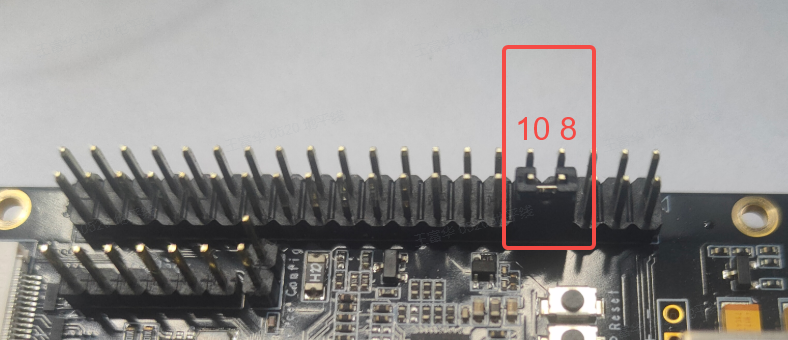

Software API (Example: Loopback Test)
Connect the TX and RX pins of UART2 together on hardware.
Refer to the following jumper connection:
loopback_test_pin_connect

Example command for 100-loopback test (parameter specified by -c):
# ./uart_duplex -c 100 -d /dev/ttyS2
test size:1024 Kbytes, baud:4000000

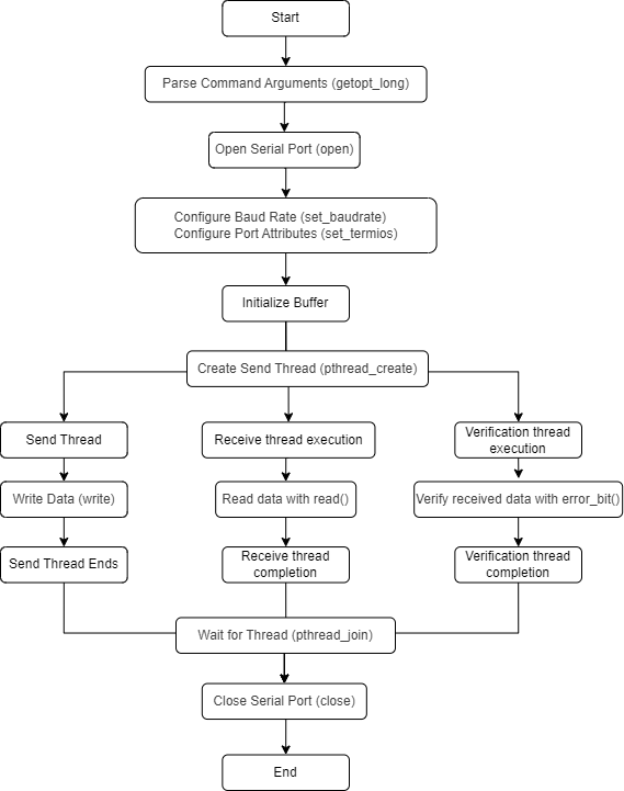

A brief explanation of this example program:
This sample program communicates with a serial device via the UART interface, implementing data transmission, reception, and verification. It uses multiple threads to handle sending, receiving, and checking functions separately, and employs semaphores for thread synchronization. For details, refer to the flowchart below:
uart_loopback_test_flowchart
