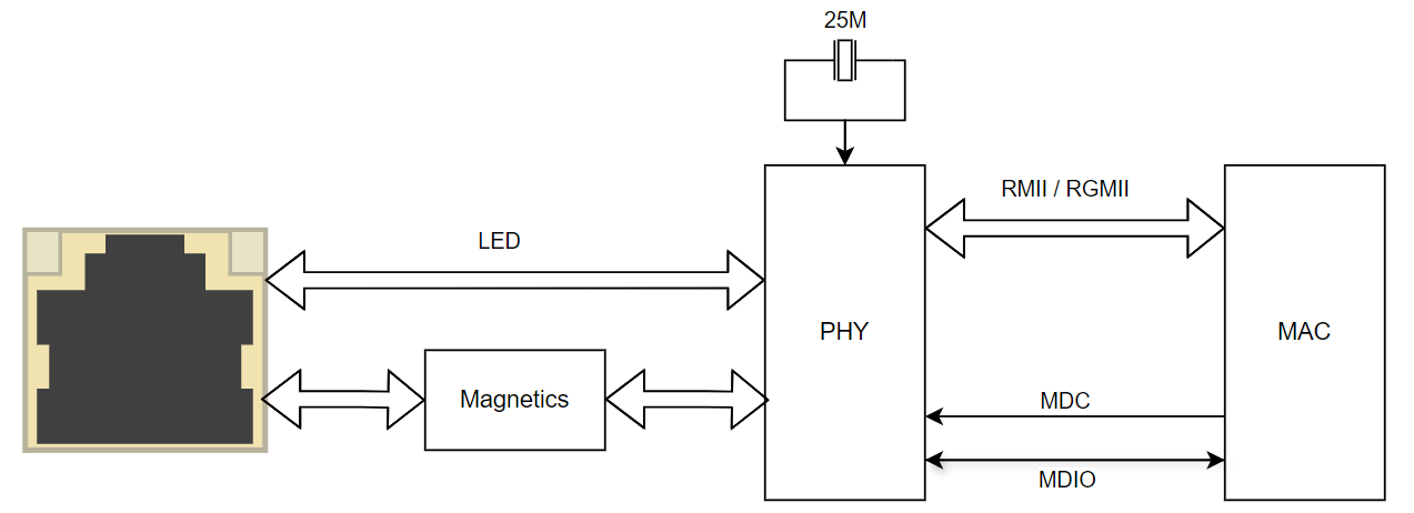

Typical Application
Typical connection diagram as shown below:

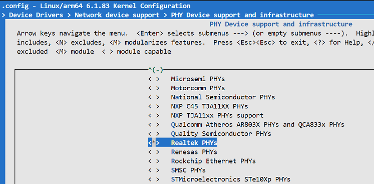

Enable PHY Driver
PHY drivers are located in the kernel/drivers/net/phy directory, containing source code for various PHY vendors. For example, enable Realtek PHY driver via menuconfig.

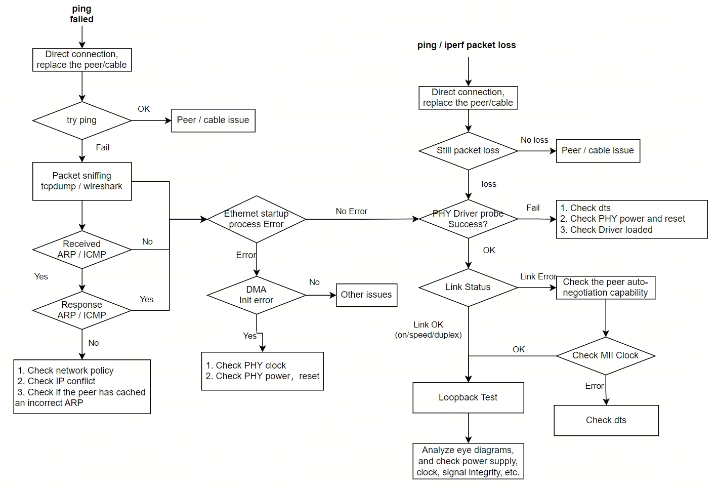

4.3.15.6. Common Issues
Quick Network Interface Troubleshooting
PHY-related network issues are mainly categorized as no network connectivity or severe packet loss. Refer to the following methods for quick checks:

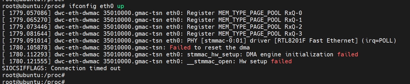

“Cannot attach to PHY” When Loading Network Interface
Error message:
root@ubuntu:~# ifconfig eth0 up
[  222.582785] dwc-eth-dwmac 35010000.gmac-tsn eth0: __stmmac_open: Cannot attach to PHY (error: -19)
SIOCSIFFLAGS: No such device
MDIO communication failure on the network interface. Troubleshoot using the following steps:

“MAC Reset Failed”
U-Boot logs show:
EQOS_DMA_MODE_SWR stuck
Kernel reports “DMA engine initialization failed” when link comes up: Error message:
Root cause analysis: Usually due to MAC reset failure, commonly caused by missing RGMII-RX clock. Analyze using the following steps:
  • Check if a reference clock is present and whether its frequency and amplitude meet requirements
  • Verify PHY power supply and reset pin status
  • Review PHY datasheet for any special register configuration required before RGMII-RX clock is provided
Auto-negotiation Failure
Troubleshooting methods:
  • Use cross-comparison to determine whether the issue is on the local or peer side
  • If negotiation fails in U-Boot, try increasing the timeout to see if it improves
  • Use ethtool eth0 to check whether the PHY negotiation capabilities of both local and peer devices match expectations, and whether either side restricts auto-negotiation

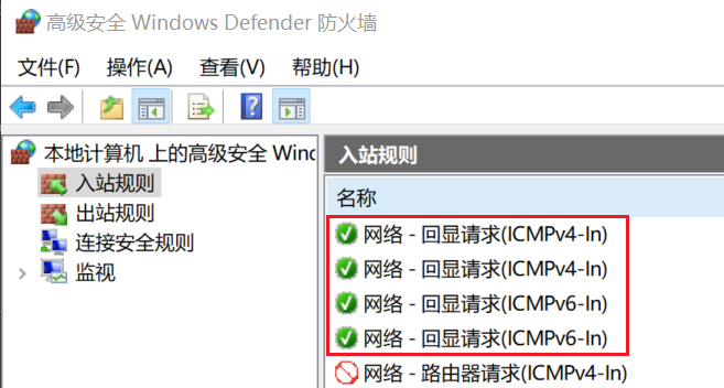

Unable to Ping in U-Boot / Kernel
  • Use third-party devices and cables for cross-validation to rule out peer device or cable issues; direct connection testing (without routers or switches) is preferred
  • In U-Boot, verify correct ipaddr setting, ensure it is in the same subnet as the peer, and avoid IP address conflicts
  • In kernel, verify correct IP address and subnet mask configuration, ensure same subnet as peer, and avoid IP conflicts
  • Perform packet capture on the peer device:
    • If ARP packets from the board are received but no ARP reply is sent, check for IP conflicts
    • If ARP exchange is normal and ICMP packets are received but no ICMP reply is sent, investigate peer network policies. For example, ensure Windows firewall is disabled and ICMP inbound rules are enabled.
Severe Packet Loss or High Number of Transmit/Receive Errors
  • Perform eye diagram testing to verify signal quality meets requirements.
  • Confirm whether clock delay is enabled on the PHY.
  • Measure clock stability.
  • Use ethtool -S eth0 | grep crc to count packets dropped due to CRC errors. If this value increases significantly over time, it is likely a signal integrity issue.
