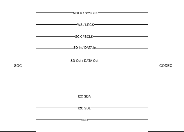

There are two typical application scenarios for Audio: playback and capture. In terms of hardware implementation, full-duplex connections use the following connection method. The difference lies in whether control signals are present—one scenario lacks control signals, while the other includes an additional set of control signal lines.
Typical Application 1
In the figure above, the CODEC connects to the SOC via I2S. When clock signals are correct, playback sends data to the CODEC through the SD Out / DATA OUT line, and capture receives data from the CODEC via SD In / DATA In.
Such CODECs without control signals do exist in the market, but some also include control signal lines. For example, in the following figure, the CODEC and SOC connect via I2C to transmit control signals. Such setups generally involve partial routing control or more complex CODEC drivers.

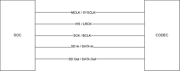

Typical Application 2
Functional Principles
I2S transmission mainly involves the following types of data lines:
  • MCLK / SYSCLK: Represents the Master Clock or System Clock, used for synchronization between SOC and CODEC.
  • SCK / BCLK: Represents the Serial Clock or Bit Clock. SCK is a synchronization signal within the module, provided externally in slave mode and generated internally in master mode. Each pulse corresponds to one bit of digital audio data.
  • WS / LRCK: Represents the Word Select (sampling clock), also known as the Left-Right Clock (Left Right Clock).
  • SD / DATA: Represents the Serial Data signal, also called the data line, used primarily for transmitting digital audio data. In full-duplex mode, there are two such lines—one for SOC transmission (commonly used for playback) and one for SOC reception (commonly used for capture).

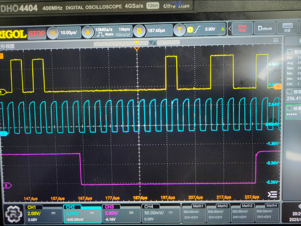

Signal Example

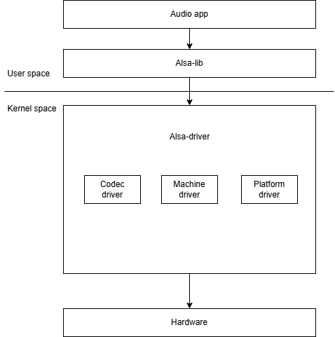

Combining with the ALSA framework, we need to confirm the following code locations.
Codec, i.e., codec-dai code location: kernel/sound/soc/codecs/xxx.c. This part contains numerous codes, including codec codes already uploaded to the Linux mainline.
Platform, i.e., cpu-dai code location: kernel/sound/soc/dwc/dwc-i2s.c. This part follows the platform and is generally not extensive.
Machine code location: kernel/sound/soc/hobot. This part is also SOC-related and mainly connects codec-dai and cpu-dai.

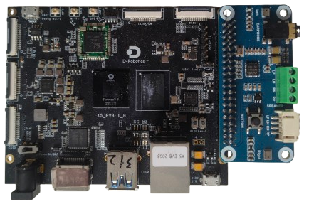

First is the normal registration of the Codec. Again, taking WM8960 as an example (wiring diagram as shown above), ensure that the I2C communication of the Codec is normal. This primarily involves debugging the Codec’s own driver.
For SPI communication, refer to the SPI debugging manual for debugging. Similarly, for I2C communication, refer to the I2C debugging manual.
Here we need to confirm three points: whether power-up is normal, I2C address, and I2C speed.
After configuring according to the device tree and code provided above, after normal startup, manually load the ko module, refer to the following commands:

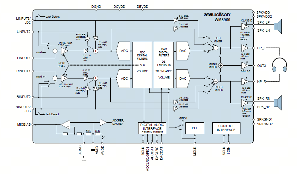

After determining the tools, we need to confirm the audio routing. We should first read the Audio Codec manual, preferably finding a diagram like this:
WM8960 Path Reference
It can vividly illustrate the connection of Audio routing.
Then, use the tinymix command to confirm the routing: Our Device number used is 1, so when operating, -D should be followed by 1
tinymix -D 1 contents
Then we can establish the routing and perform Audio recording and playback.

Q1: How to troubleshoot silence issues?
Similarly, using the node-based approach mentioned in the operating mode, investigate each point. First, differentiate the scenario: is it playback silence or recording silence? Then troubleshoot software and hardware; the troubleshooting order generally follows the audio source sequence. For example, for playback, first check if the audio source issued by the software is abnormal, whether the I2S status is correct, whether the codec register status is correct, and finally whether the I2S signal and clock are correct. Of course, if convenient, directly measuring signals when the audio source is confirmed normal can directly identify board status rather than hardware side issues. Recording is the reverse process. For example, in the figure below, we can see that the I2S hardware signal is normal.
Yellow represents the DATA line
Blue represents BCLK
Purple represents LRCLK
Q1
