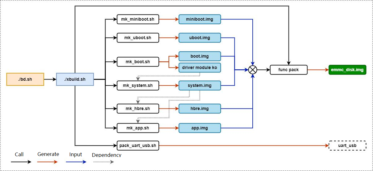

4.1.3.4. build Directory
The build directory is used to compile and package various BSP modules:
build/
├── common                # Common Makefiles and configurations; mk_hbre.sh uses source code from this directory when compiling hbre
├── Dockerfile            # Used to generate BSP build Docker container, used with start_docker.sh
├── hbre_config           # hbre compilation configurations, defines which hbre modules to compile
├── install_host_deps.sh  # Installs host dependency packages
├── mk_app.sh             # Compiles app directory and generates app.img
├── mk_hbre.sh            # Compiles hbre and prebuilts/hbre, generates hbre.img
├── mk_boot.sh            # Compiles kernel and prebuilts/kernel, generates boot.img
├── mk_miniboot.sh        # Packages miniboot, generates miniboot.img
├── mk_system.sh          # Packages system root filesystem, generates system.img
├── mk_uboot.sh           # Compiles U-Boot, generates uboot.img
├── mk_appsdk.sh          # Packages APPSDK (cross-compilation SDK for applications), generates platform-appsdk-<ver>.deb + bundle .tar.gz
├── mk_fde.sh             # Example script for compiling encrypted partitions
├── pack_uart_usb.sh      # Packages images for UART/USB flashing
├── quickcmd.sh           # Provides common shortcut commands
├── README.md             # Built-in English xbuild usage guide, provides basic environment setup and command usage
├── start_docker.sh       # Used to generate and start Docker container for BSP compilation
├── tools                 # Tools for compilation, packaging, and signing
├── utils_funcs.sh        # Common utility functions
└── xbuild.sh             # Main build entry point
