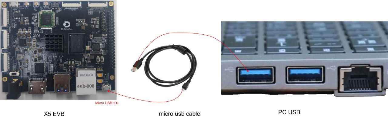

    First, connect the development board to the host computer using USB or Ethernet.

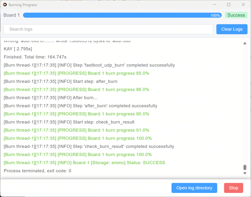

  5. Execute the flashing operation:
    After setting the flashing parameters, start the flashing process. The tool will write the image data byte by byte to the board’s storage device (eMMC or NAND Flash), ensuring the OS and applications can load correctly.

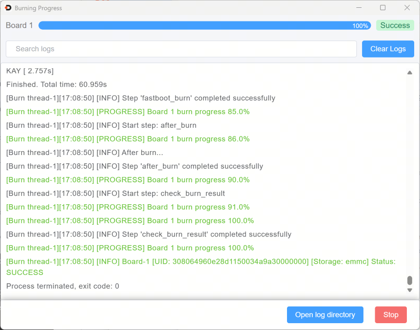

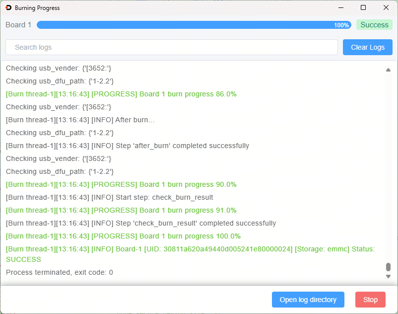

  6. Verify the flashing result:
    After flashing is complete, verification is required to confirm success. Use the board’s serial output or other debugging interfaces to check whether the system boots correctly and whether applications run as expected.

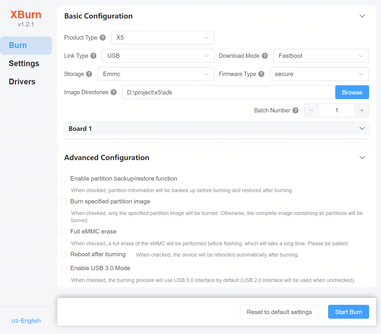

2.5.3. Graphical Tool Flashing Introduction

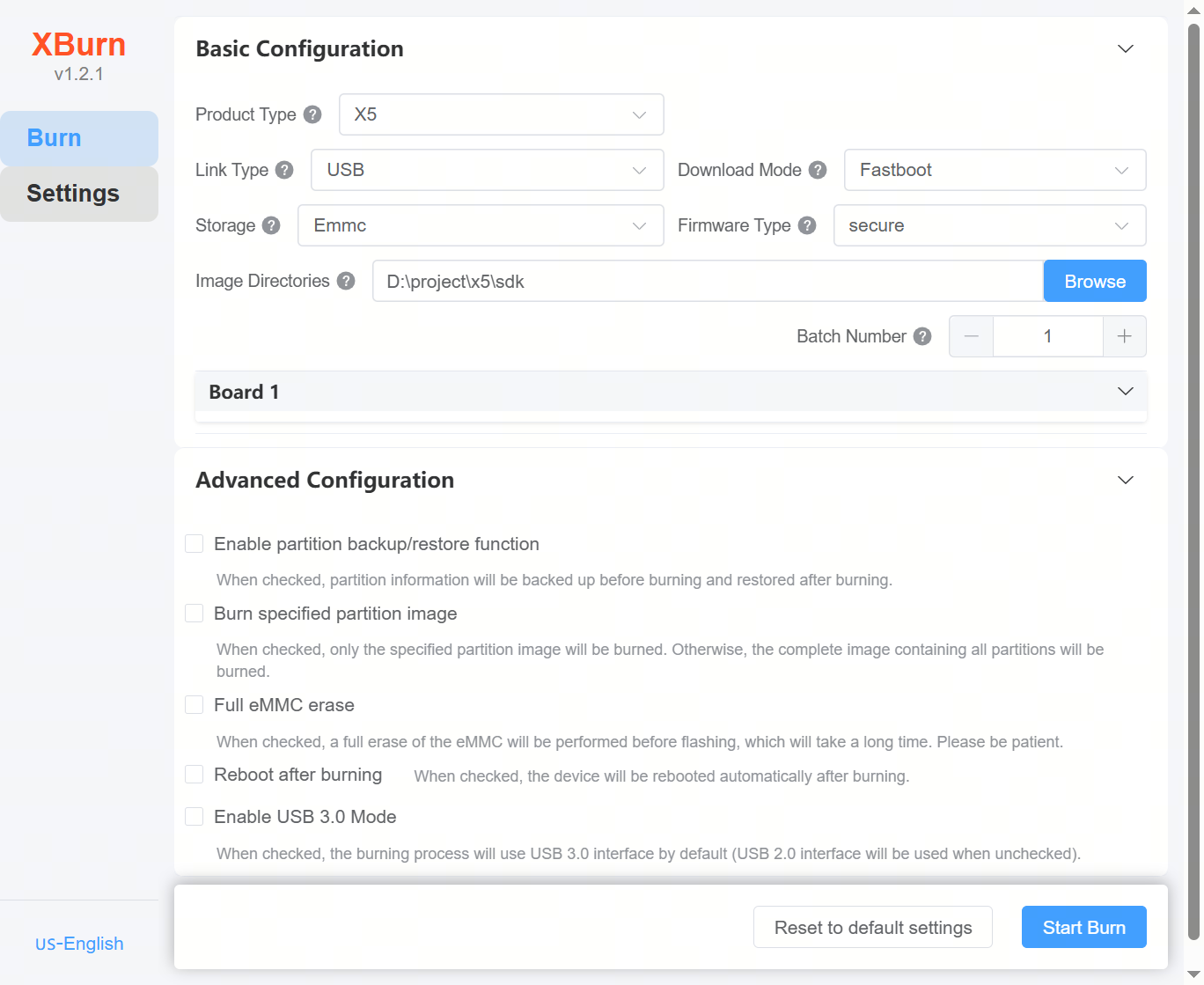

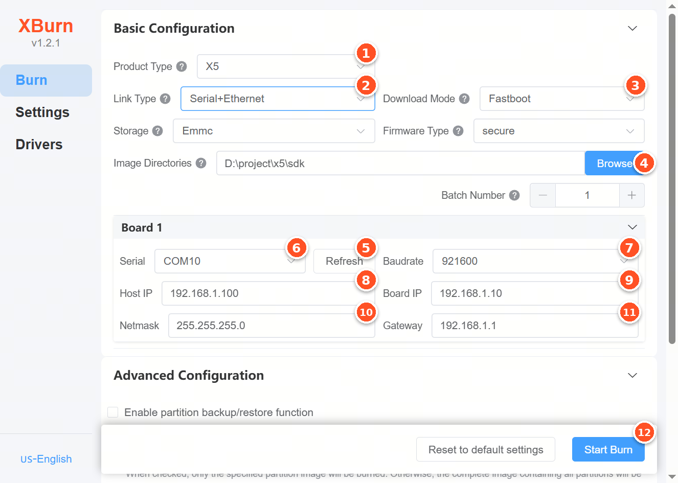

The XBurn-gui tool provides a rich graphical interface, as shown below:
2.5.3.1. Flashing Tool Interface Overview
Flashing Interface

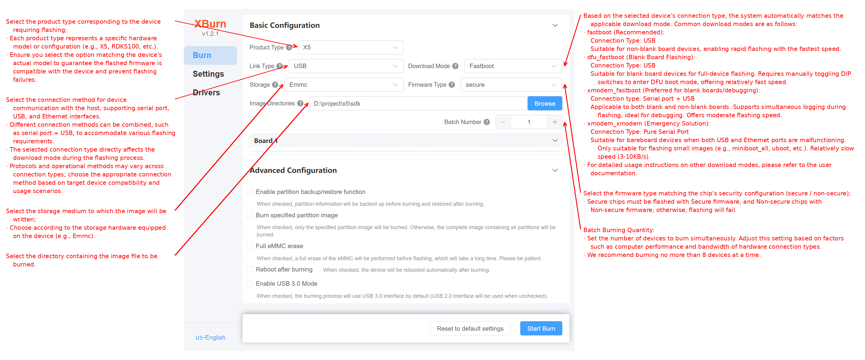

Explanation:

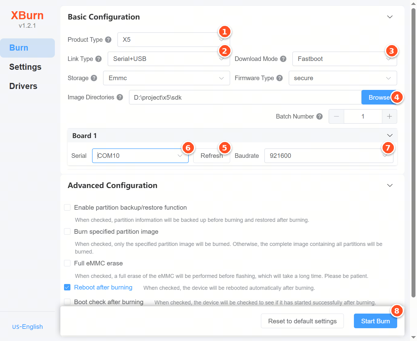

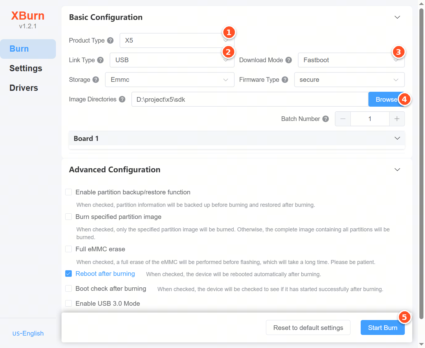

  • Basic Configuration:
    1. Product Type: Select the corresponding product type for the device you are flashing.
      • Each product type corresponds to a specific hardware model or configuration (e.g., X5, RDKS100, etc.).
      • Ensure the selected option matches the actual device model to guarantee firmware compatibility and avoid flashing failure.
    2. Connection Type: Select the communication method between the device and host. Supported options are serial, USB, and Ethernet.
      • Multiple connection types can be combined (e.g., serial + USB) to meet different flashing needs.
      • The selected connection type directly affects the download mode used during flashing.
      • Different connection types may use different protocols and procedures; select the appropriate one based on device compatibility and use case.
    3. Download Mode: Based on the selected connection type, the system automatically matches the applicable download mode. Common modes include:
      • fastboot (recommended):
        • Connection Type: USB
        • Suitable for non-blank devices, enabling fast flashing with the highest speed.
      • dfu_fastboot (blank board flashing):

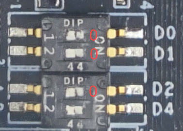

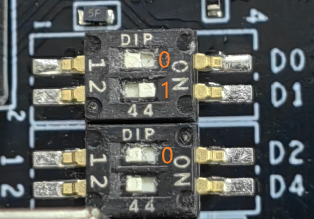

        • Suitable for blank devices, enabling full-system flashing. Requires manual DIP switch configuration to enter DFU boot mode. Fast speed.
      • xmodem_fastboot (preferred for blank boards/debugging):
        • Connection Type: Serial + USB
        • Suitable for both blank and non-blank devices. Supports real-time log viewing during flashing, ideal for debugging. Moderate speed.
      • xmodem_xmodem (emergency fallback):
        • Connection Type: Pure serial
        • Suitable for blank devices when USB and Ethernet are unavailable. Only suitable for small images (e.g., miniboot_all, uboot). Slow speed (3–10 KB/s).
      • For detailed descriptions of other download modes, refer to the table in the Flashing Methods Overview section.
    4. Image File Directory:
      Select the directory containing the image file to be flashed.
    5. Batch Flashing Count:
      Set the number of devices to flash simultaneously. Adjust based on computer performance and bandwidth of the hardware connection.
      It is recommended to flash no more than 8 devices at once.

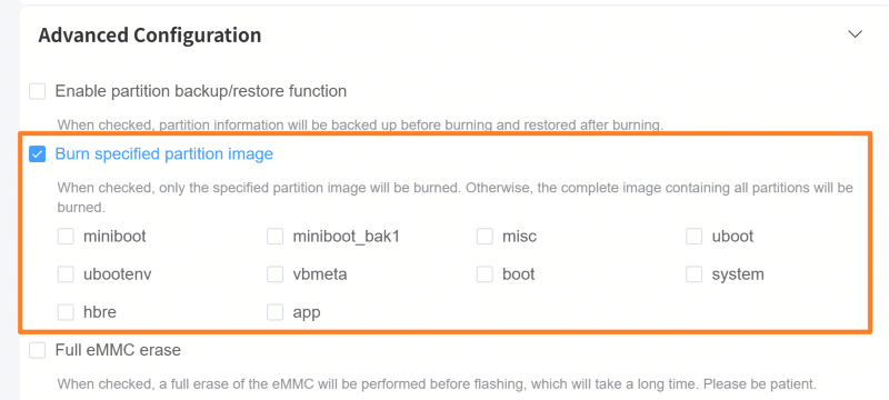

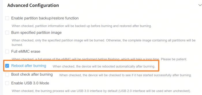

  • Advanced Configuration:

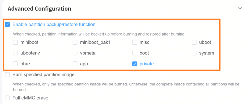

    • Enable Partition Backup/Restore: If checked, partition information will be backed up before flashing and restored afterward.
    • Flash Specific Partition Image: If checked, only the specified partition image will be flashed; otherwise, a full image containing all partitions will be written.

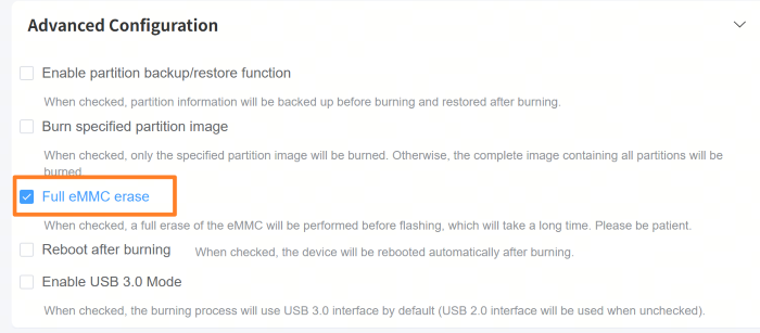

    • Erase eMMC Entirely: If checked, the eMMC will be fully erased before flashing, which takes longer—please wait patiently.

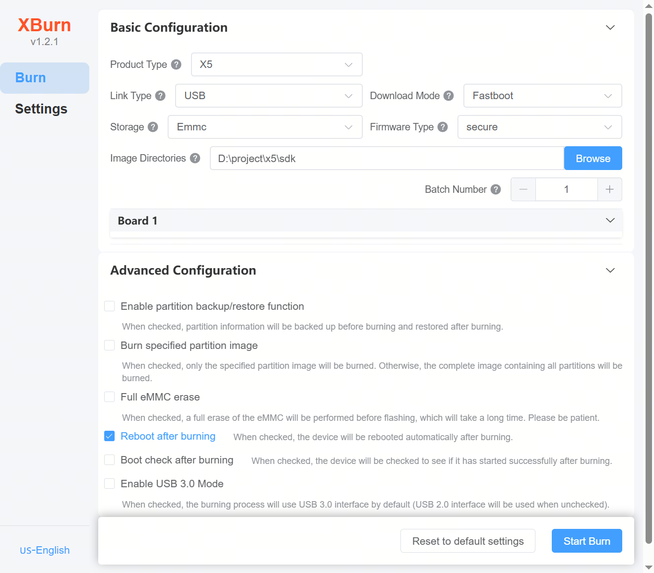

    • Auto-reboot After Flashing: If checked, the device will automatically reboot upon completion.
    • Enable USB 3.0 Mode: If checked, USB 3.0 will be used; otherwise, USB 2.0 is used by default.
    • For detailed usage, refer to the Advanced Configuration section.
  • Operation Buttons:
    • Restore Default Settings: Reset to default configuration.
    • Start Upgrade: Begin the flashing process.

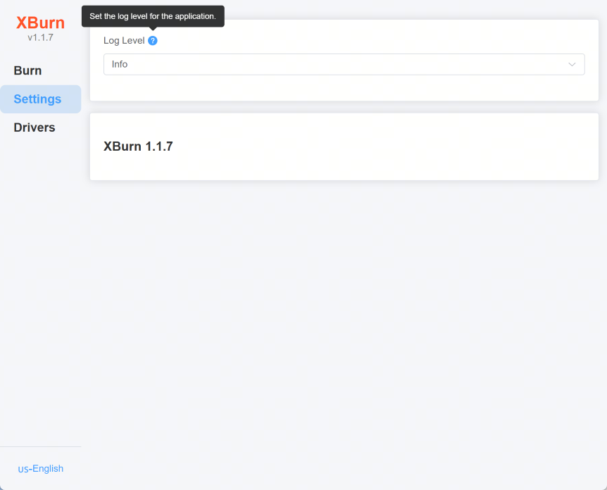

This interface is used to set the log level and control log output verbosity.
  • Log Level: Choose the log output level (e.g., Info, Debug).

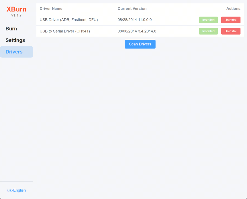

Driver Interface
This interface is used to view and manage driver status.
  • Driver Name: Lists installed drivers (e.g., USB Driver (ADB, Fastboot, DFU), USB to Serial Driver (CH341)).
  • Current Version: Displays the current driver version.
  • Actions: Buttons to install or uninstall drivers.
  • Scan Drivers: Button to detect and install new drivers.

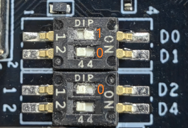

USB DFU+Fastboot Single USB cable 1. Set the board to DFU boot mode (Set DIP switch D5 to 0, D[2:0] to 010) to download BL2 and BL3x and boot into U-Boot command mode.
2. Run fastboot 0 in U-Boot to enter Fastboot mode.
3. Use Fastboot over USB to flash the full image.
4. After flashing, restore DIP switches to normal boot mode (e.g., eMMC boot: Set D[5][2:0] to 1001).
· Supports flashing on blank boards
· Must click Start Upgrade within one minute of power-on, otherwise DFU timeout will cause failure

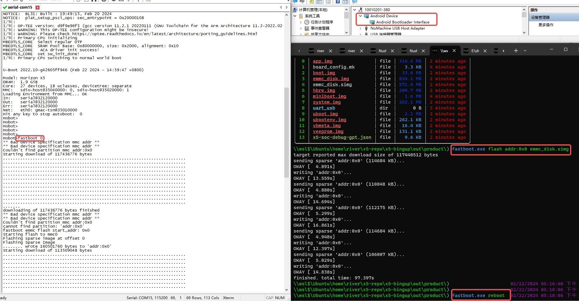

USB Fastboot Single USB cable 1. On non-blank boards, ensure the device can enter U-Boot command mode and run fastboot 0:
a. If already in Fastboot mode, flash directly.
b. Otherwise, if ADB is connected (adb devices), use adb shell to enter the board terminal, then run reboot -m usb2 -f to enter fastboot mode.
2. Use Fastboot over USB to flash the full image.

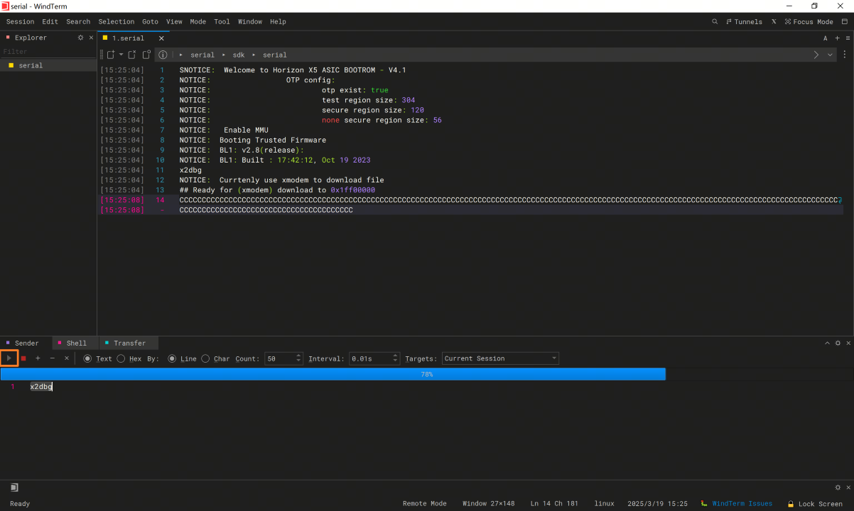

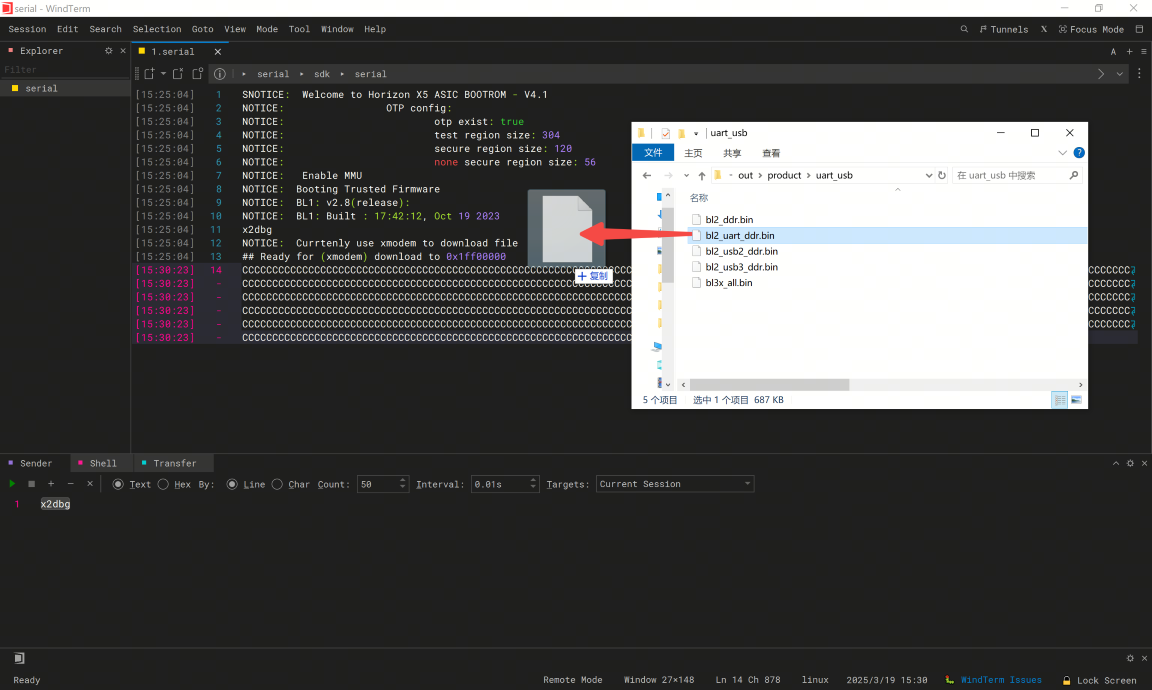

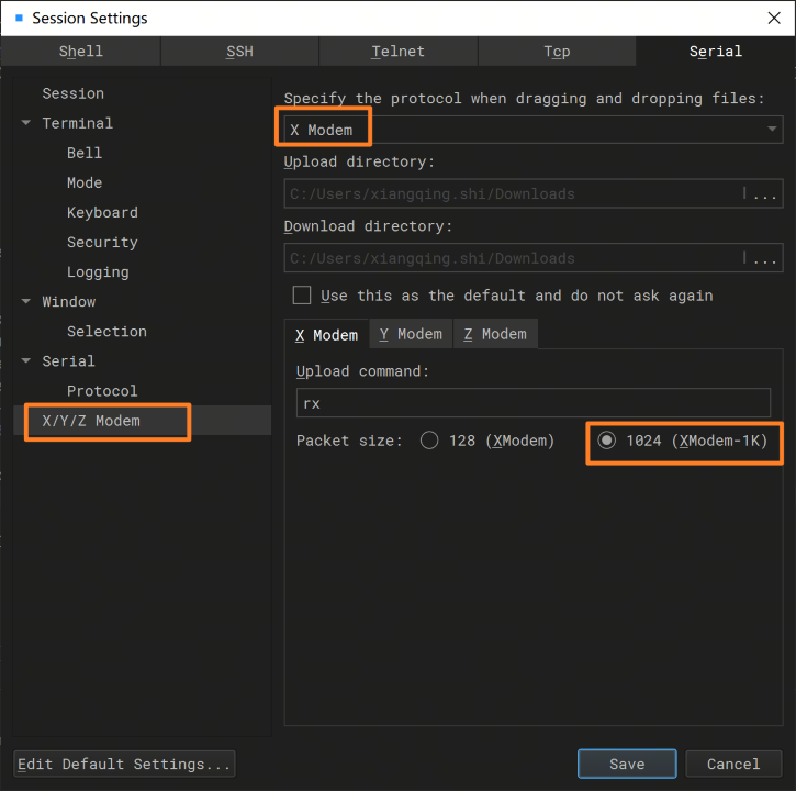

Serial+USB Xmodem+fastboot Serial + USB cables 1. Use Xmodem over serial to download BL2 and BL3x, boot into U-Boot command mode.
· Supports blank boards

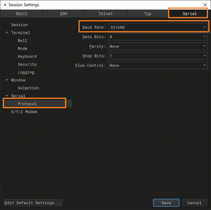

· Recommended to set serial baud rate to 921600 (DIP switch D4 set to 1)

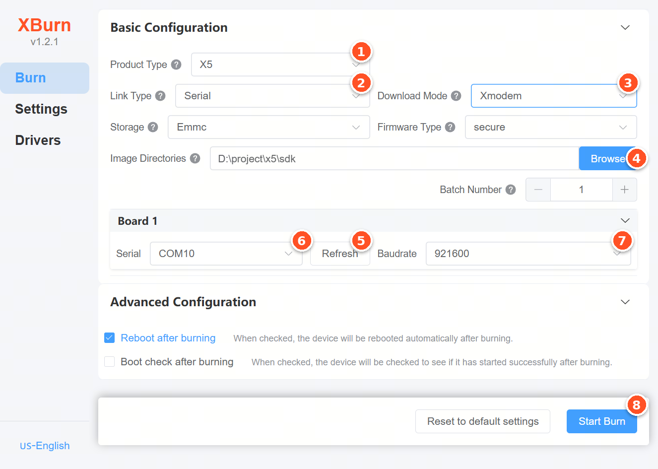

Serial xmodem_xmodem Single serial cable 1. Use Xmodem over serial to download BL2 and BL3x, boot into U-Boot command mode.
2. Continue using serial protocol (e.g., loady, loadx) in U-Boot to download and flash the image.
· Only recommended for small images

Note: For all download modes using the Xmodem protocol, it is recommended to set the serial baud rate to 921600 bps (set DIP switch D4 to 1) to improve flashing speed.

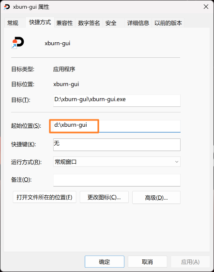

2.5.3.3. Flashing Tool Installation and Startup Guide
Installing and Launching XBurn on Windows

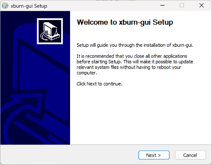

Double-click the installer xburn-gui_X.X.X_x64-setup.exe (the actual version number of the installation package shall prevail) to begin installation. Follow these steps:
  1. Click Next:

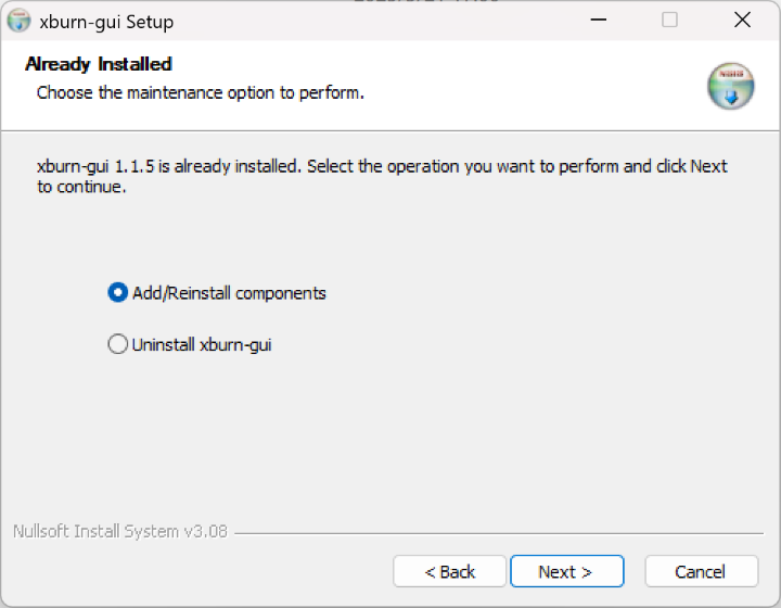

  2. Select Add/Reinstall components, then click Next:

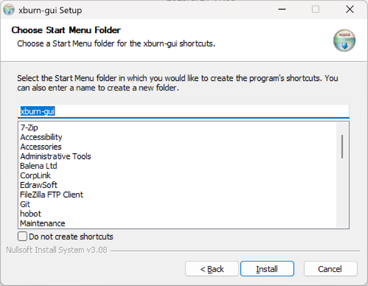

  3. Click Browse to select the installation path:

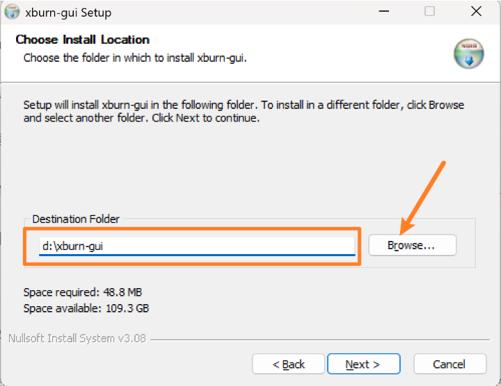

    Tip: It is recommended to install the software in the root directory of a hard drive (e.g., D:\xburn-gui) for easier log file access.
  4. Click Install:

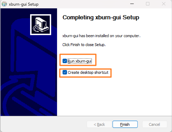

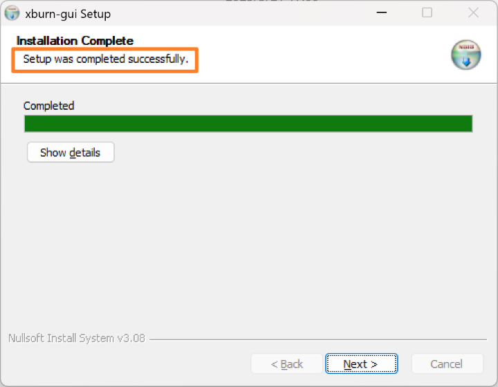

  5. Wait for the progress bar to complete. When Setup was completed successfully. appears, click Next:
  6. Check Run xburn-gui and Create desktop shortcut, then click Finish:
  7. After installation, the XBurn-gui interface will automatically open:
  8. Subsequently, launch the software by double-clicking the XBurn.exe icon on the desktop.

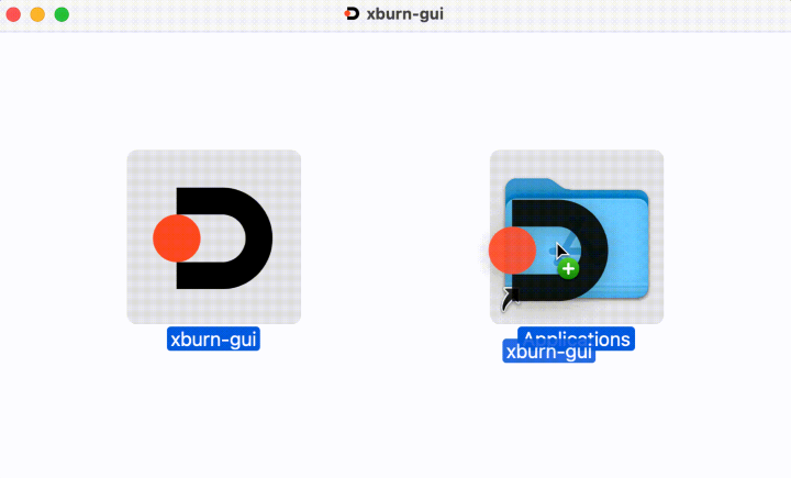

Installing and Launching XBurn on macOS

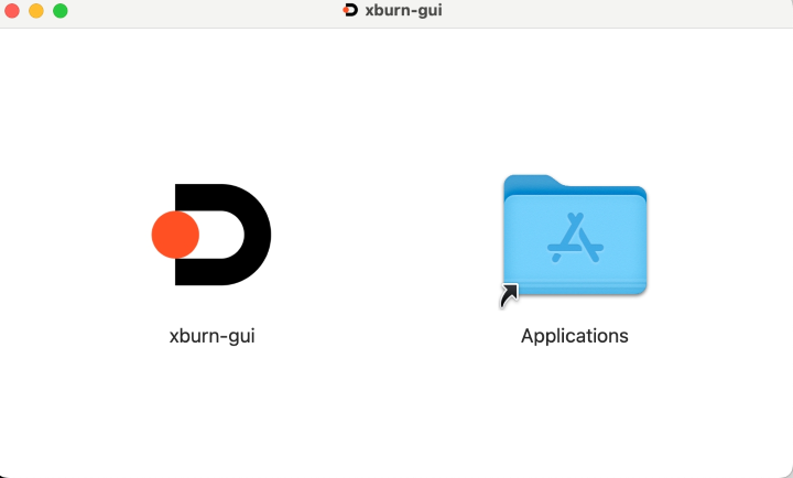

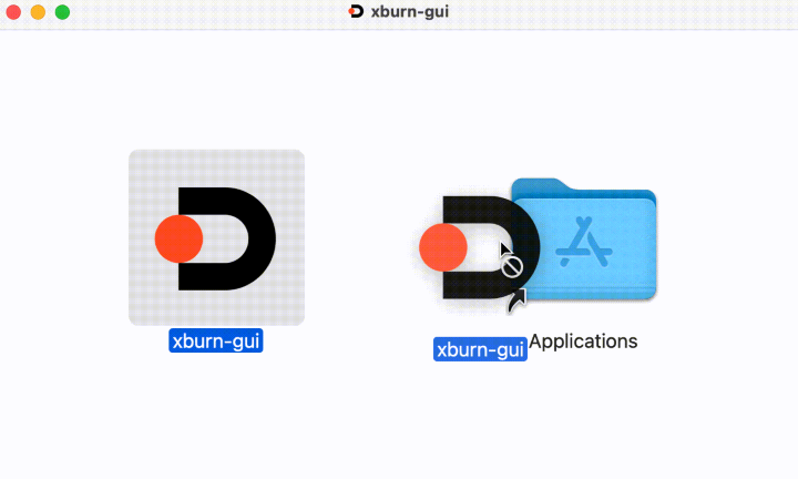

Double-click the installer xburn-gui_X.X.X_universal.dmg (the actual version number of the installation package shall prevail) to begin installation. Follow these steps:
  1. A pop-up will appear. Click and drag the xburn-gui icon to the Applications folder:
  2. Once installed, double-click the xburn-gui icon to launch the application:

  1. Use DFU download mode:
    • The hardware must have boot DIP switches configured for USB boot;
    • The DFU bit (usually D5) in BOOT CONFIG must be grounded (set to 0). If the board has a DIP switch for DFU, set it to 0; otherwise, modify the hardware circuit by removing/installing the DFU resistor;
    • This option can be used when the image is missing or corrupted.
      USB boot mode requires the DIP switches to be set as follows:
      USB_Download_Mode
  2. Use Xmodem download mode:
    • Can be used when the image is missing or corrupted;
    • In Xmodem mode, for X5 EVB, set DIP switch D4 to 1 (to set serial baud rate to 921600 bps), which significantly increases flashing speed.
      Xmodem boot mode requires the DIP switches to be set as follows:
      UART_Download_Mode
Selecting Download Mode When Image is Normal
When the image is intact, use the Fastboot download mode, which requires the board to enter U-Boot command line:
  • If the hardware lacks boot DIP switches, ensure a valid bootable image exists in storage—no further action needed;
  • If DIP switches are present, ensure they are set for normal boot.
The default boot mode is eMMC boot, with DIP switches set as follows:
EMMC_Download_Mode
Other boot modes are detailed in the DIP switch truth table in the DIP Switch section.
Note: If the software in storage is missing or corrupted, the X5 chip will automatically switch to USB boot mode.

Wiring Diagram:
USB_UP
USB Connection Flashing Instructions:
Using DFU+Fastboot mode as an example, the following explains how to use the XBurn-gui tool.
Before flashing, configure the boot mode to USB (set DIP switch D5 to 0, D[2:0] to 010; if no DIP switch, temporarily modify the hardware). If the serial port is connected, the serial terminal will show logs like:
NOTICE:   Enable MMU
NOTICE:  BL1: v2.8(release):
NOTICE:  Enter USB2 Mode......
NOTICE:  Currtenly use dfu-util to download file
NOTICE:  Download file via USB
NOTICE:  DFU Start...
XBurn-gui tool configuration:
Step 1:
Select product type. In the Product Type dropdown, select X5.
Step 2:
Select connection type. In the Connection Type dropdown, select USB.
Step 3:
Select download mode. In the Download Mode dropdown, select DFU+Fastboot.
Step 4:
Select the image directory. Click Browse and choose the image folder, typically the out/product directory generated after compilation, e.g., S:\home\sxq\projects\sdk_x5_main\out\product.
Step 5:
Power on the board, then click Start Upgrade. The tool will begin flashing. When the progress bar reaches 100%, the upgrade is successful.
Step 6:
Note: The Start Upgrade button must be clicked within one minute of powering on the board. Otherwise, the board will exit DFU mode due to timeout, entering Xmodem file transfer waiting state. The flashing tool will usually report an error like:

If the serial port is connected during USB upgrade, the serial terminal will show:
NOTICE:  Welcome to Horizon X5 ASIC BOOTROM - V4.1
NOTICE:   Enable MMU
NOTICE:  USB DFU function timeout and need switch to xmodem download
NOTICE:   dfu-util timeout, forcily switch xmodem download......

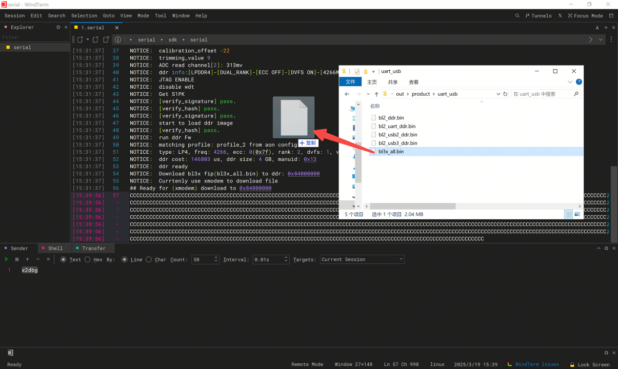

## Ready for (xmodem) download to 0x1ff00000
CCCCCCCCCCCCCCCCCCCCCCCCCCCCCCCCCCCCCCCCCCCCCCCCCCCCCCCCCCCC
If DFU timeout causes failure, power off and restart the board, then retry the upgrade.

The XBurn-gui burning tool interface configuration is as follows:
fastboot_usb
The following is the detailed description of the burning process:
Step 1:
Select the product type. Click the Product Type dropdown list and select model X5.
Step 2:
Select the connection type. Click the Connection Type dropdown list and select Serial+USB.
Step 3:
Select the download mode. Click the Download Mode dropdown list and select Fastboot mode.
Step 4:
Select the directory of the image to be flashed. Click Browse, then select the directory containing the image files, typically the out/product directory generated after system compilation, such as S:\home\sxq\projects\sdk_x5_main\out\product.
Step 5:
Click the Refresh button to ensure the software recognizes the correct serial port.
Step 6:
Select the serial port. From the Serial Port dropdown, choose the correct COM port, such as COM6.
Step 7:
Set the baud rate. In the Baud Rate field, enter or select the correct baud rate, for example 921600 (recommended).
Step 8:
Start flashing. Power on the development board, then click Start Upgrade. The tool will begin flashing. When the progress bar reaches 100%, the upgrade is successful.
2.5.3.7. Serial+Ethernet Connection Upgrade Procedure
Prerequisites:
Applicable Scenarios:
The Serial+Ethernet connection supports two download modes: Fastboot over Ethernet and Xmodem+fastboot. For detailed explanations of these download modes, please refer to the table in the Flashing Methods Overview section.
  • This connection method applies to scenarios where both the serial port and Ethernet port can be connected simultaneously.
  • This connection method supports the Xmodem+fastboot download mode, which uses the Xmodem protocol for flashing in cases where the development board has no valid image or the image is corrupted. In this case, use the BL2 and BL3X images from out/product/uart_usb. It is recommended to set the serial baud rate to 921600 (DIP switch D4 set to 1).
The following description uses Fastboot download mode as an example.
Wiring Diagram:
fastboot_udp
Configuration of the XBurn-gui flashing tool interface:
fastboot_usb
Below is the detailed description of the flashing process:
Step 1:
Select the product type. From the Product Type dropdown list, select X5.
Step 2:
Select the connection type. From the Connection Type dropdown list, select Serial+Ethernet.
Step 3:
Select the download mode. From the Download Mode dropdown list, select Fastboot.
Step 4:
Select the image directory. Click the Browse button and select the directory containing the image files, for example S:\home\sxq\projects\sdk_x5_main\out\product.
Step 5:
Step 6:
Select the serial port. From the Serial Port dropdown list, select the currently used COM port, such as COM6.
Step 7:
Set the baud rate. From the Baud Rate dropdown list, select the current serial port baud rate, such as 921600.
Step 8:
Set the host IP. In the Host IP input field, enter the static IP address of the PC’s network interface, such as 192.168.1.101.
Step 9:
Set the board IP. In the Board IP input field, enter 192.168.1.10 (default IP).
Step 10:
Set the subnet mask. In the Subnet Mask input field, enter 255.255.255.0.
Step 11:
Set the gateway. In the Gateway input field, enter 192.168.1.1.
Step 12:
Start flashing. Click the Start Upgrade button to begin the flashing process. When the progress bar reaches 100%, the upgrade is successful.
fastboot_usb
XBurn_Serial_Ethernet_Fastboot_dl
Step 1:
Step 2:
Select the connection type. From the Connection Type dropdown list, select Serial.
Step 3:
Select the download mode. From the Download Mode dropdown list, select Xmodem.
Step 4:
Step 5:
Select the serial port. From the Serial Port dropdown list, select COM6.
Step 6:
Click the Refresh button to refresh the serial port list and ensure the correct serial port is selected.
Step 7:
Set the baud rate. In the Baud Rate input field, enter 921600.
Step 8:
Start flashing. Click the Start Upgrade button to begin the flashing process. Xmodem transfer speed is very slow; please be patient.
2.5.3.9. Advanced Configuration
Auto-reboot after flashing
When the option Auto-reboot after flashing is checked, the development board will automatically reboot upon completion of the image flashing.
  • By default, this option is checked. After flashing, the board will reboot automatically. If unchecked, the board remains in the state it was in at the end of the flashing process. For example, if flashing was done via fastboot and auto-reboot is unchecked, the board will remain in fastboot mode after completion.
auto_reboot
When checked, an additional option Check if device rebooted successfully becomes available for selection.
Full eMMC Erase
When Full eMMC Erase is checked, if the main storage medium on the development board is eMMC, the entire eMMC will be erased before flashing the image.
  • Full eMMC erase takes a long time; please be patient. A full erase of a 16GB eMMC takes 3–5 minutes.
  • If Burn specified partition image mode is selected, checking Full eMMC Erase will have no effect.
all_emmc_erase
Enable Partition Backup/Restore Function
Overview
The XBurn-gui flashing tool supports partition backup and restore functionality. You can specify a partition to back up, and after flashing a new image, the backed-up partition will be rewritten to the development board, ensuring that the data in that partition remains unchanged despite the new image flashing.
  • The development board’s storage medium must already have partitions.
Usage Method
  • By default, no partition backup is performed during flashing.
    partition_backup
  • Check the Enable Partition Backup/Restore Function option and select the partition(s) to back up. During flashing, the selected partitions will be backed up.
The flashing steps are otherwise identical to those described for the previous connection methods, except for the additional step of checking the Enable Partition Backup/Restore Function option.
Note: After flashing is complete, reboot the development board and verify that the partition backup was successful.
Burn Specified Partition Image
Burn_specified
  • Burn Specified Partition Image: This option supports flashing only one or more specific partitions from the image, leaving other partitions unaffected. It is suitable for the following scenarios:
    • Only updating a specific component in the system (e.g., miniboot, uboot, system, app partitions)
    • Performing a system upgrade without affecting user data partitions
    • After selecting this mode, you must manually choose the target partition(s) to flash.

2.5.4.2. Command-line Environment Configuration
On Windows, add the installation directory of the xburn-gui flashing tool to the system environment variables to enable command-line flashing operations. For example:
XBurn_path
Add the above path D:\xburn-gui to the system environment variables as follows:
  1. Press Win + R to open the Run dialog.
  2. Type sysdm.cpl and press Enter.
  3. In the System Properties window, go to the Advanced tab and click Environment Variables at the bottom right.
  4. In the Environment Variables window, select the Path variable and click Edit.
  5. In the Edit Environment Variable window, click New and paste the installation path of the xburn-gui flashing tool.
  6. Click OK.
On Ubuntu, the xburn command is automatically integrated into /usr/bin/ after installation and can be used directly.

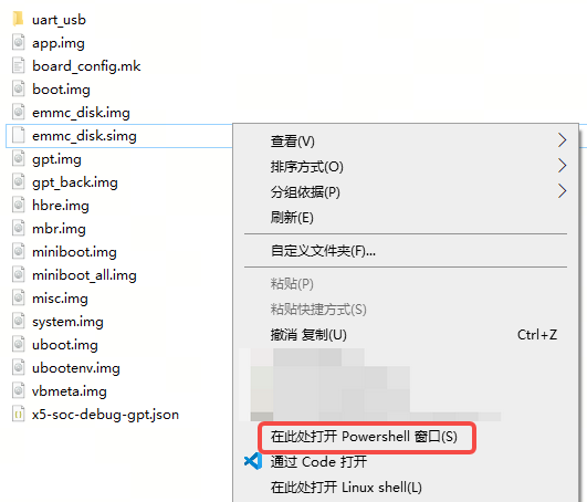

2.5.4.3. Command-line Usage
On the PC, open the command-line interface of the corresponding system and execute sudo xburn (on Ubuntu and macOS terminals) or xburn (on Windows PowerShell) to start flashing. Run xburn --help to view the complete usage:

  --reboot              Enable or disable board reboot after burn.

Parameter Abbreviation Options Description Example Format Requirements
--erase_part - List of partition names Erase specified partitions --erase_part cache,userdata Comma-separated partition names
--select_part - List of partition names Flash only selected partitions --select_part boot Comma-separated partition names
--backup_part - List of partition names Backup partitions before flashing --backup_part recovery Comma-separated partition names

  1. Single-device flashing (Serial + USB Fastboot)
    xburn -V info -p X5 -l serial_usb -d fastboot -i S:\home\sxq\projects\sdk_x5_main\out\product --batch_num 1 --baudrate 921600 --serial COM6 --reboot
  2. Empty board debugging (Serial + USB xmodem_fastboot)
    xburn -V info -p X5 -l serial_usb -d xmodem_fastboot -i S:\home\sxq\projects\sdk_x5_main\out\product --batch_num 1 --baudrate 921600 --serial COM6 --reboot
    Successful execution log:
    Finished. Total time: 31.990s
    [Burn thread-1][18:44:37] [INFO] Step 'fastboot_burn' completed successfully
    [Burn thread-1][18:44:37] [PROGRESS] Board 1 burn progress 85.0%
    [Burn thread-1][18:44:37] [INFO] Start step: after_burn
    [Burn thread-1][18:44:37] [PROGRESS] Board 1 burn progress 86.0%
    [Burn thread-1][18:44:37] [INFO] After burn...
    [Burn thread-1][18:44:37] [INFO] Step 'after_burn' completed successfully
    [Burn thread-1][18:44:37] [PROGRESS] Board 1 burn progress 90.0%
    [Burn thread-1][18:44:37] [INFO] Start step: check_burn_result
    [Burn thread-1][18:44:37] [PROGRESS] Board 1 burn progress 91.0%
    [Burn thread-1][18:44:37] [ERROR] Write failed: Write timeout
    [Burn thread-1][18:44:37] [INFO] Reconnected successfully
    [Burn thread-1][18:44:37] [PROGRESS] Board 1 burn progress 100.0%
    [Burn thread-1][18:44:37] [INFO] Step 'check_burn_result' completed successfully
    [Burn thread-1][18:44:37] [INFO] Board-1 [UID: 308064960e30c82402062d570000024] [Storage: emmc] Status:  SUCCESS

  • Please refer to Connect via Serial Port to complete the installation of the serial driver. In Device Manager on Windows, you should see the corresponding COM port; in the /dev directory on Ubuntu, you can find the corresponding tty serial device.
  • Please refer to Connecting via USB Port to complete the installation of the USB driver. On Windows, it usually appears as Android Bootloader Interface in Device Manager.

After the development board enters U-Boot command-line mode, execute the fastboot 0 command to enter Fastboot mode.
U-Boot 2022.10-gca2c6582a0 (Mar 13 2024 - 19:04:15 +0800)
Model: Horizon X5
... (omitted) ...
Hobot>fastboot 0
Next, open a Windows PowerShell terminal in the directory where the emmc_disk.simg image is located. In Windows, right-click while holding Shift in the image directory to see:
usb_fastboot_usPower_Shellage
Then, execute the following command in the PowerShell terminal to flash the full system image:
fastboot flash addr:0x0 emmc_disk.simg
After flashing, execute fastboot reboot in the PowerShell terminal to reboot the device, or power cycle the board to apply the update.
The full system image flashing process is illustrated below:
usb_fastboot_usage

Prerequisites:
  • Please refer to Connect via USB to complete the installation of the USB driver. On Windows, it usually appears as Android Bootloader Interface in Device Manager.
  • Connect the hardware according to the wiring diagram for the GUI tool’s USB download mode wiring method.
  • This flashing method is primarily used for development boards with no image or corrupted images.
  • It can also be used on boards that already have a valid image and can boot normally.

  • Wire the board according to the wiring method for UART download mode in the graphical tool.
  • For boards with DIP switches, ensure the switches are set to the default boot mode, such as EMMC boot mode.

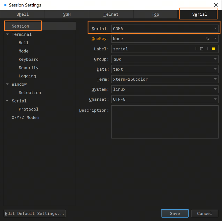

Use WindTerm to connect to the device’s serial port. In the WindTerm interface, click Session -> New Session from the menu bar to create a serial session, and configure the serial port settings accordingly:
WindTerm_Serial_Config1
WindTerm_Serial_Config2
WindTerm_Serial_Xmodem
Set the file drag-and-drop protocol to Xmodem, and it is recommended to select a packet size of 1024 to improve file transfer speed.
Step 4:

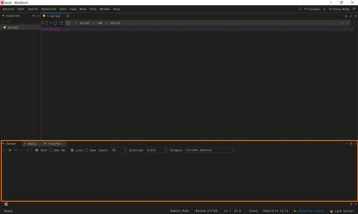

In the WindTerm interface, click View -> Panes -> Sender from the menu bar to open the Sender window:
WindTerm_Sender
Step 5:

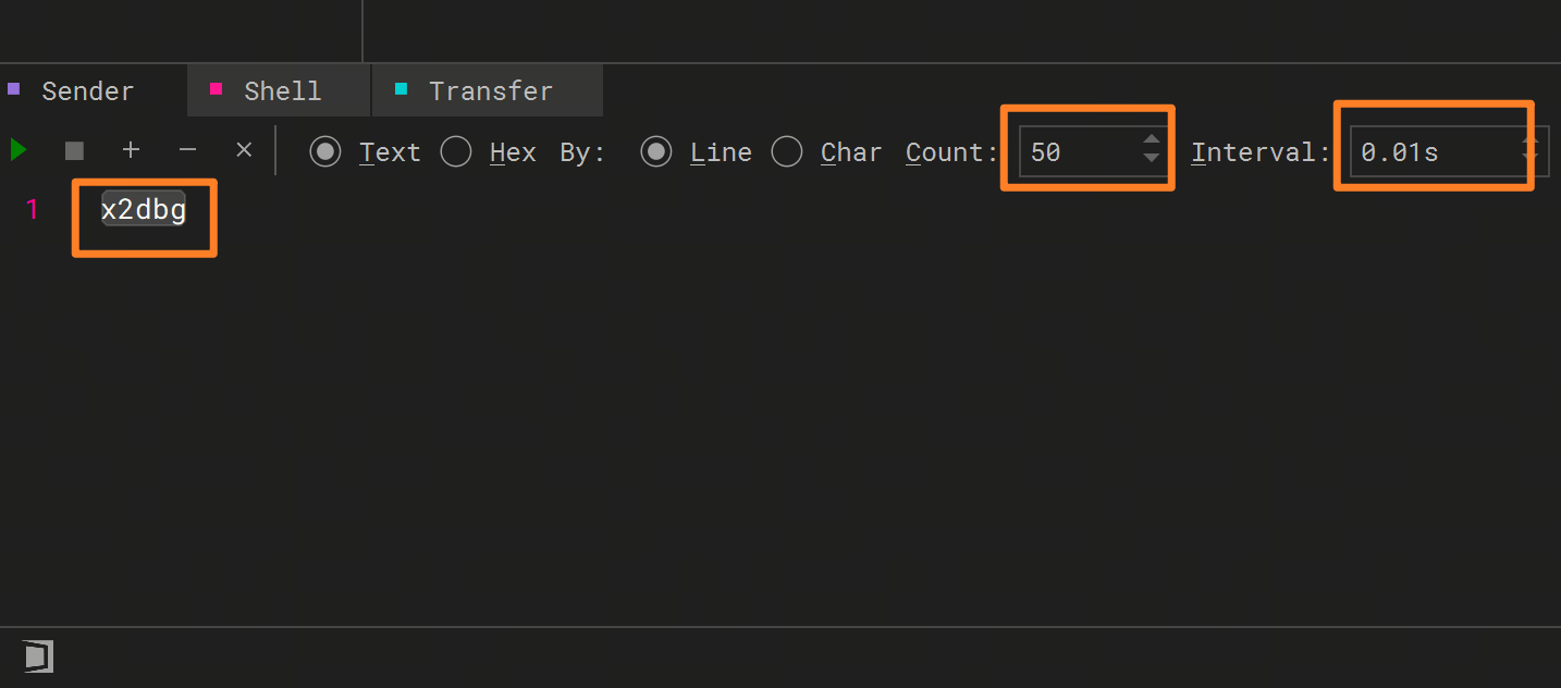

In the Sender window, enter the command x2dbg, and set the execution count to 50 times with an interval of 0.01 seconds:
WindTerm_Sender_cmd
Step 6:
Click run (the green triangle button) to start executing the command in a loop.
Step 7:
Immediately after starting the script, power on the development board. Once powered, the device will enter serial download mode, and the serial terminal will continuously print C, with a prompt indicating Currently use xmodem to download file.
WindTerm_Run
Step 8:
Drag the bl2_uart_ddr.bin firmware file from the out\product\uart_usb directory (after BSP compilation) into the current serial window. Xmodem file transfer will begin automatically:
WindTerm_Xmodem1
Step 9:
After bl2_uart_ddr.bin is successfully downloaded and executed, the serial log will appear as shown below. At the end of the log, the message Download bl3x fip(bl3x_all.bin) will appear, indicating that the xmodem protocol must be used again to transfer the next firmware. The serial terminal will once again continuously print the character C, waiting for the next action.
 100% [====================] 00:00:10 704360 bytes

NOTICE:  ddr cost: 146803 us, ddr size: 4 GB, manuid: 0x13
NOTICE:  ddr ready
NOTICE:  Download bl3x fip(bl3x_all.bin) to ddr: 0x84000000
NOTICE:  Currtenly use xmodem to download file
## Ready for (xmodem) download to 0x84000000
Step 10:
Similar to Step 8, drag the bl3x_all.bin firmware file from the out\product\uart_usb directory (after BSP compilation) into the current serial window. Xmodem file transfer will begin automatically. This firmware is relatively large; if the baud rate is set to 115200 bps, the transfer will be slow—please be patient until the transfer completes.
WindTerm_Xmodem2
Step 11:
After bl3x_all.bin is successfully transferred and executed, the device will enter U-Boot command-line mode. In this mode, you can choose to flash firmware using the fastboot command, or manually download images via tftp.
The serial log will appear as follows:
100% [====================] 00:00:32 2144940 bytes

  2. Lower the serial baud rate and retry. For the X5 EVB board, you can set the DIP switch D4 to 0 and adjust the baud rate to 115200

  1. Check if the USB driver is installed
  2. Check the USB cable connection status
  3. Fastboot device startup depends on the development board’s U-Boot; check if U-Boot starts normally
