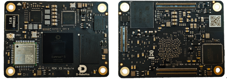

The X5 MD adopts a modular design that separates the core module from the IO carrier board, facilitating functional expansion and customized development.
The RDK X5 Module serves as the core board, integrating the D-Robotics Sunrise®5 intelligent computing chip and its key circuitry, incorporating core functional units such as PMIC power management module, DDR, eMMC, QSPI NAND, Wi-Fi/Bluetooth, etc. The core board provides a 300-pin high-speed expansion interface, enabling flexible connection to various peripherals and meeting the rapid deployment needs across diverse application scenarios.

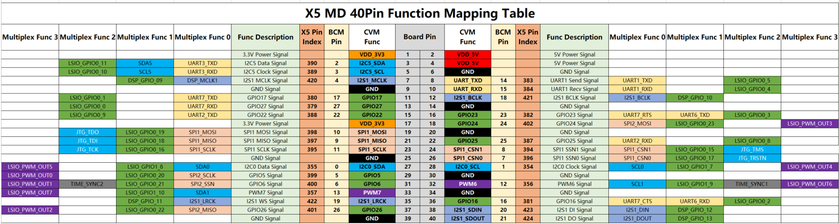

  • 40-pin expansion interface (including GPIO, I²C, SPI, I²S, PWM)

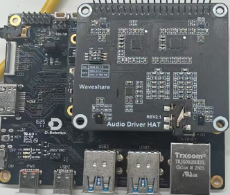

  • Audio sub-board, for voice function testing

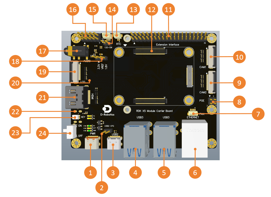

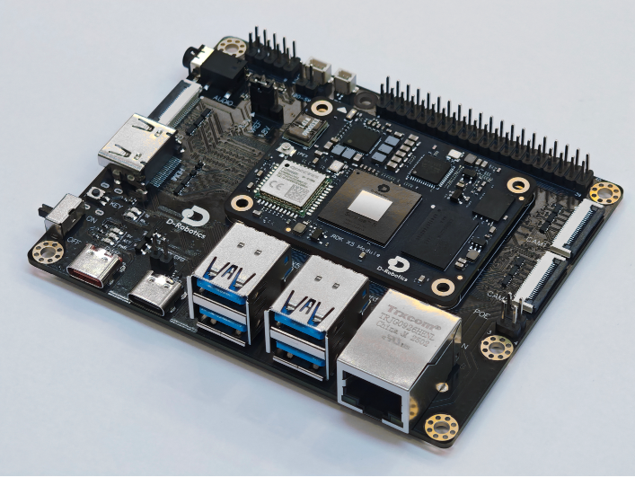

2.3.2. IO Carrier Board Functional Module Layout
image-202507041116
Interface Function Interface Function
1 USB Type C 5V/5A power supply interface 13 RTC battery interface
2 USB2.0 configuration header 14 CAN termination resistor switch
3 USB2.0 interface 15 CAN bus interface
4 USB3.0 HOST interface x2 16 Functional control IO header
5 USB3.0 HOST interface x2 17 Audio interface
6 Gigabit Ethernet port 18 IO voltage level selection header
7 Fan interface 19 MIPI DSI interface
8 POE interface 20 Micro SD card interface (back side)
9 CAM2 interface, 4-lane 21 HDMI interface
10 CAM1 interface, 4-lane 22 Debug port, USB-to-serial (back side)
11 40-pin header 23 Sleep button
12 Core module interface 24 Power switch

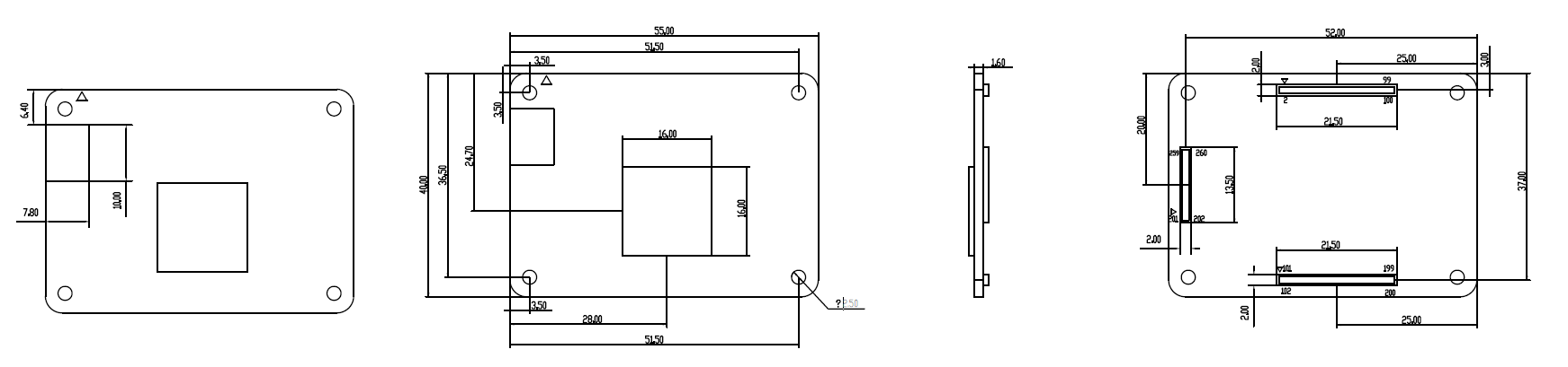

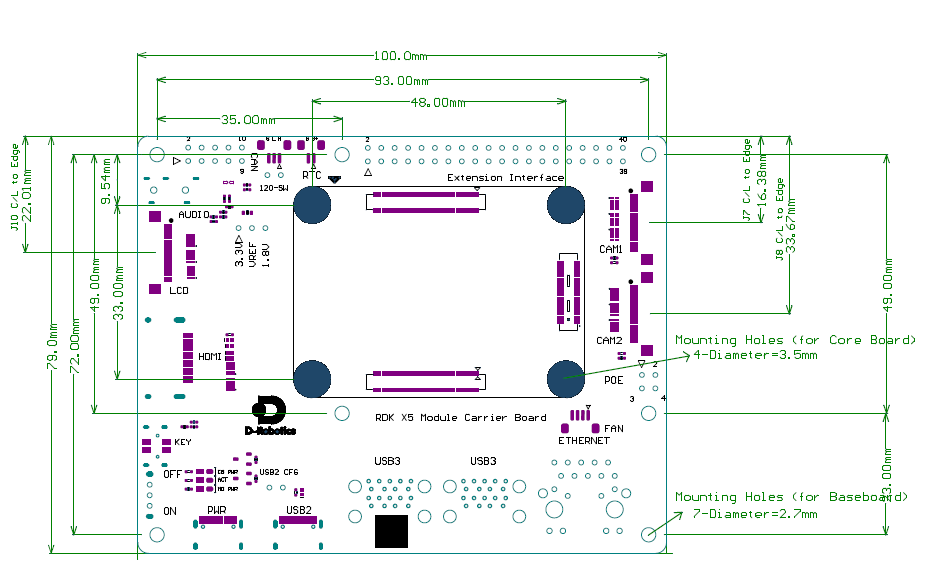

2.3.2.1. Dimension Diagram
image-20250704141256
image-20250704141132

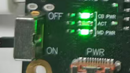

2.3.3.1. Powering On the Development Board
Connect the 5V/5A power adapter (interface 1), turn on the power switch (interface 24). When CB PWR and MD PWR lights up, it indicates the development board is powered normally.

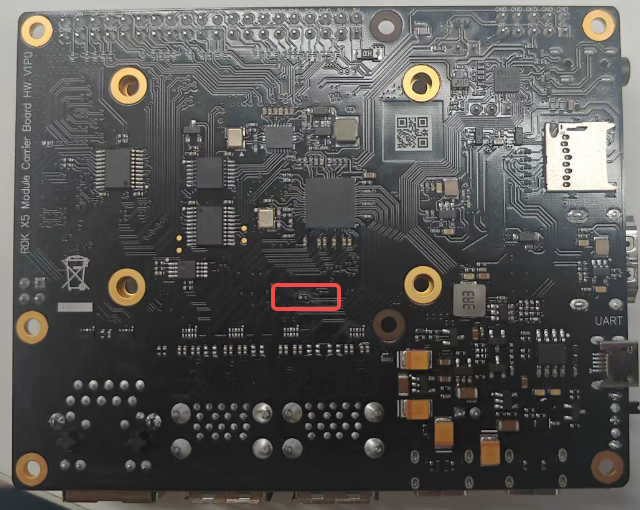

2.3.3.2. Booting from eMMC
The X5 MD was initially designed for RDK ecosystem customers running the RDK system, booting from spi nand by default. If you need to flash and use the SDK system, you must change to boot from eMMC.
First, confirm the board’s hardware version using silkscreen markings on the core board and IO carrier board.
For version V0.X: you need to modify the core board; please contact FAE for the eMMC boot modification method;
For version V1.X: you need to modify the IO carrier board: solder a 4.7kΩ resistor at the position shown in the figure.

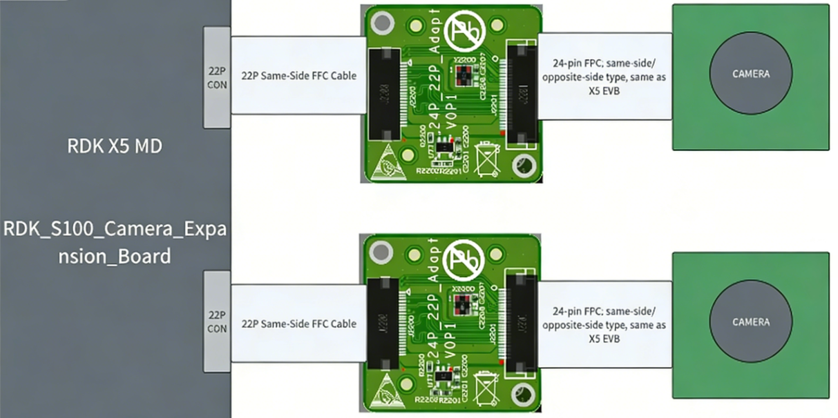

An official 22-pin to 24-pin adapter board is provided, which integrates a 24MHz active crystal to provide MCLK for the sensor. The IO voltage (interface 18) should be set to 1.8V.
sensor_board
The X5 MD connects to the adapter board via a 22-pin 0.5mm pitch same-direction FPC, and the adapter board connects to the camera module using the same type of ribbon cable as the EVB board.
Using the adapter board, a series of camera modules supported by the EVB board can be connected, such as SC230AI, SC132gs, IMX415, facilitating user testing under various imaging scenarios. For a complete list of supported Camera Sensors, please refer to Camera Sensor Support List.

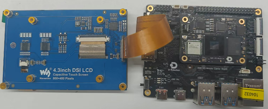

2.3.3.10. LCD (MIPI DSI) and TP Interface
The development board supports MIPI DSI and touchscreen interfaces (interface 19), a 22-pin connector. It can use DSI-Cable-12cm to connect to a Waveshare 4.3-inch capacitive touchscreen with 800×480 resolution, as shown below:

After successfully entering the Linux system, execute the following commands to load drivers:
modprobe sii902x
modprobe panel-wh-cm480
modprobe ft5406
modprobe hb_bl
modprobe vio_n2d
modprobe vs-x5-syscon-bridge
modprobe vs_drm
The serial console will print:
play-subsystem on minor 0
Appearance of [drm] Initialized vs-drm 1.0.0 20191101 for 3e000000.disp_apb:display-subsystem on minor 0 indicates successful display driver loading.

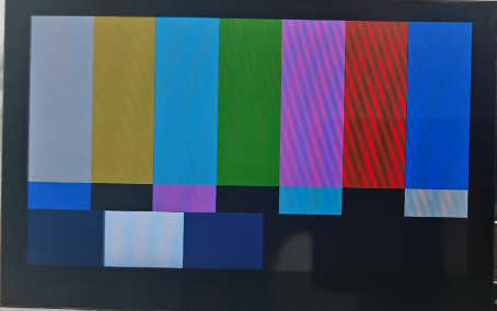

Use the command modetest -M vs-drm -a -s 73@31:800x480 -P 33@31:800x480@NV12 for testing.
The connected screen will light up, displaying a pattern as shown below:
image-20250704155508

2.3.3.14. CANFD Interface
The development board provides a CANFD interface (Interface 15) and a CAN termination resistor switch (Interface 14). For high-speed communication, termination resistors should be enabled at both ends to prevent signal reflection and improve noise immunity. This interface supports both CAN and CAN FD communication.
The three signal pins of the CANFD interface are GND, L, and H.

2.3.3.15. 40PIN Interface
The development board provides one 40PIN interface (Interface 11), allowing users to expand peripheral connections. The pin definitions and supported multiplexing functions are shown below:
image-20250331-120318
All IO pins on the 40PIN interface support voltage domain selection (3.3V or 1.8V) via the voltage selection interface (Interface 18).
Connection Example:
Below is a hardware reference connection diagram for an Audio Driver HAT:
image-20250704163146

  • Power Switch
Controls power-on and power-off of the board. Corresponds to Interface 24.
  • Reset Switch
Performs full board power-down. The leftmost button of Interface 22 is for full board reset; the second button from the left is for X5MD module power-down.
  • Wake-up Switch
Used to wake up the system from Sleep mode via an external wake-up source. Corresponds to Interface 23.
