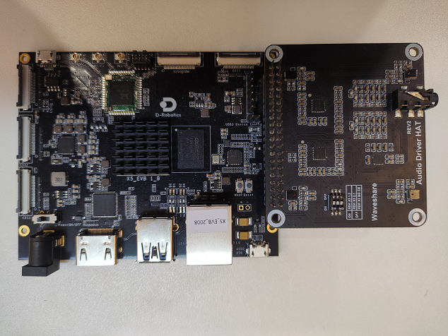

  • Audio sub-board, for voice function testing

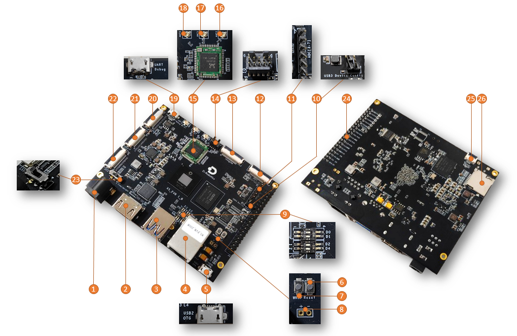

2.1.2. Function Module Layout
image-20240422232039197
Interface Function Interface Function
1 12V DC power adapter input 14 JTAG debug interface
2 HDMI Type-A interface, supports up to 4K@30 output 15 Wi-Fi and Bluetooth module, CDW-47852BS
3 USB 3.0 Type-A interface 16 Bluetooth antenna interface
4 Gigabit Ethernet interface 17 Wi-Fi antenna interface, Duplex supports simultaneous transmission of 2.4G&5G signals
5 Micro USB 2.0 data interface 18 Wi-Fi antenna interface, Duplex supports simultaneous transmission of 2.4G&5G signals
6 Reset button 19 Micro USB 2.0 debug serial port
7 Wake-up button 20 4-lane MIPI CSI interface (can be split into 2 x 2-lane MIPI CSI via expansion board)
8 RTC external power supply interface 21 2-lane MIPI CSI interface
9 Boot configuration DIP switch, for selecting boot mode 22 2-lane MIPI CSI interface
10 USB 3.0 host/device mode switching interface 23 Power switch
11 ADC[3-7] functional pins 24 40PIN functional pins, support UART, I2C, SPI, PWM, I2S
12 4-lane MIPI DSI interface 25 Independent I2C interface, can be extended to MIPI CSI interface
13 I2S&PDM audio interface 26 TF card interface

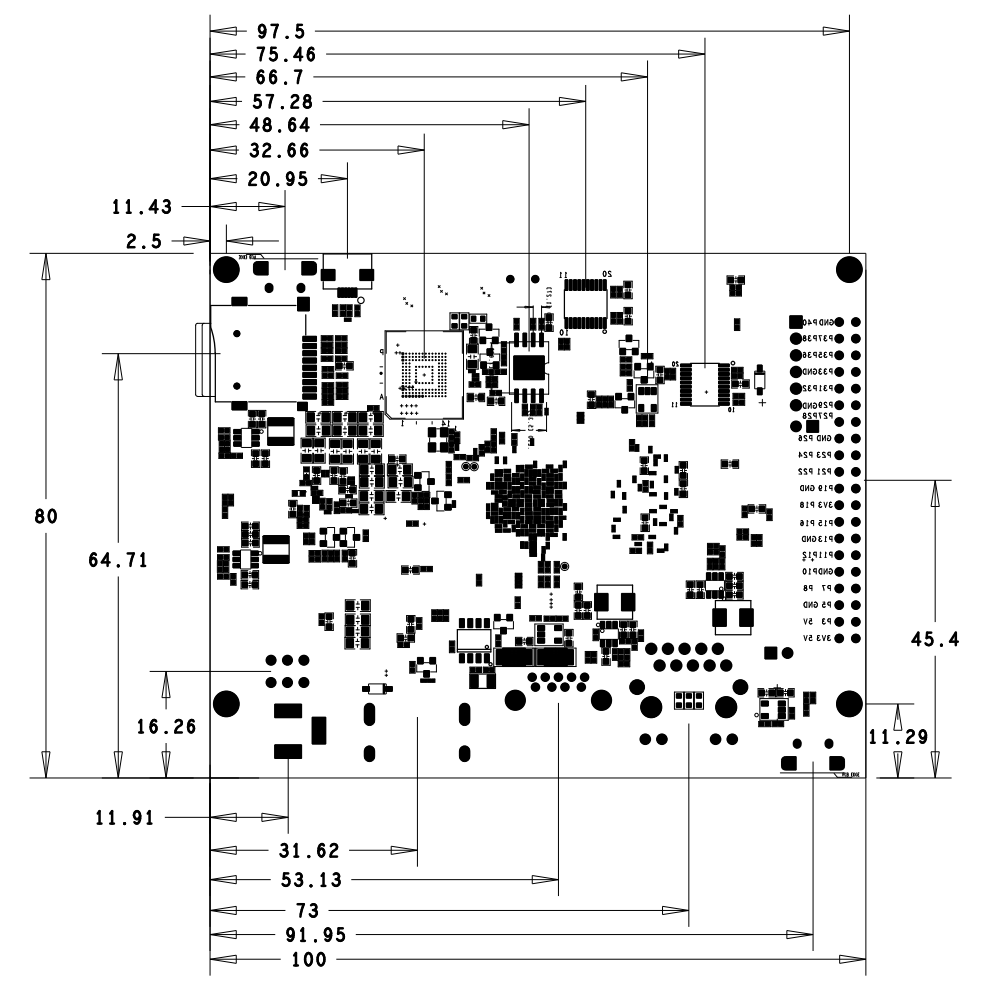

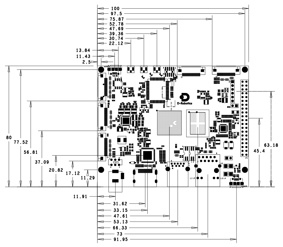

2.1.2.1. Dimension Diagram
image-20240426172550294 image-20240426172550294

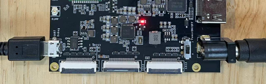

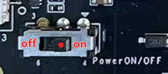

  • Connect the 12V power adapter (interface 1), turn on the power switch (interface 23). The red indicator light should illuminate, indicating normal power supply.
image-20240423093931582 image-20240422235946226
Note: If the power LED is lit but no output appears on the debug serial port, verify the DIP switch settings.

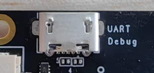

2.1.3.3. Debug Serial Port
The development board provides 1 debug serial port, corresponding to interface 19. The board uses a CH340N USB-to-serial chip to convert the serial signal to a USB interface. Users can connect a Micro USB data cable to enable serial communication between the PC and the development board.
image-20240411141146046

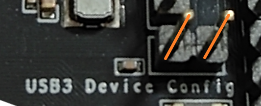

  • Hardware Method
    Short-circuit the pins of interface 10 to automatically switch USB 3.0 to Device mode. Disconnecting the short will return it to Host mode.
    image-20240424235012876

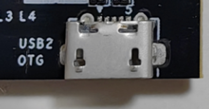

2.1.3.6. USB 2.0 Interface
The development board provides 1 Micro USB 2.0 interface (interface 5), supporting OTG functionality.
image-20240424235743905
Main applications of this interface include:
  • Function debugging, defaulting to adb mode; can switch to rndis, uvc, etc., via commands
  • Image flashing, supporting dfu, fastboot, and other flashing modes
  • Peripheral connection, enabling various USB peripherals via OTG cable

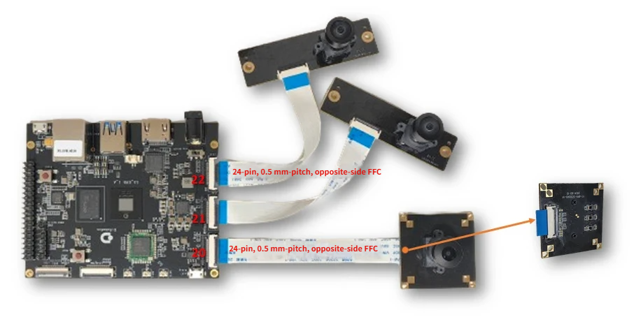

2.1.3.7. Camera (MIPI CSI) Interface
The development board provides 3 MIPI CSI interfaces, corresponding to interfaces 20, 21, and 22.
Capabilities and configurations of the three interfaces are listed in the table below:
Interface MIPI CSI Host Max Lanes Supported I2C Bus Reset GPIO
20 MIPI_CSI0&1 4 lanes I2C4 AON_GPIO_PIN0 - 498
21 MIPI_CSI2 2 lanes I2C2 AON_GPIO_PIN4 - 502
22 MIPI_CSI3 2 lanes I2C7 LSIO_GPIO1_06 - 353
Note: Interface 20’s MIPI CSI0&1 can be split into two 2-lane MIPI CSI interfaces (MIPI CSI0 and MIPI CSI1) using an external expansion board.
The board currently supports multiple camera modules including SC230AI, SC132gs, IMX415, etc., to meet various image testing requirements. For the complete list of supported Camera Sensors, refer to Camera Sensor Support List.
Camera modules connect to the board’s camera interface via a 24PIN FPC cable. Pay attention to the correct orientation when connecting, as shown in the figure below:
X5_Camera_Hardware_Resources_EN
The number of MIPI lanes used by the camera module is the sole factor determining interface selection. Examples:
  • The SC132gs module uses 2 lanes, so it can be connected to any of interfaces 20, 21, or 22.
  • The IMX415 module uses 4 lanes, so it can only be connected to the 4-lane interface, i.e., interface 20.
After installation, use commands to verify if the module’s I2C address is detected. If not detected, check the FPC connection for issues such as poor contact or reversed orientation.

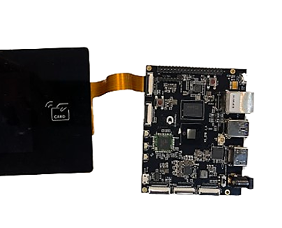

2.1.3.9. LCD (MIPI DSI) and TP Interface
The development board supports MIPI DSI and touch panel interfaces (interface 12), requiring connection to a compatible screen, as shown below:
image-20240426174259461
After successfully entering the Linux system, execute the following commands to load the drivers:
modprobe panel-jc-050hd134
modprobe vio_n2d
modprobe lontium_lt8618
modprobe vs-x5-syscon-bridge
modprobe vs_drm
The serial port will print:
play-subsystem on minor 0
Appearance of [drm] Initialized vs-drm 1.0.0 20191101 for 3e000000.disp_apb:display-subsystem on minor 0 indicates successful driver loading.

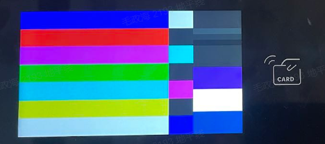

Test using the command: modetest -M vs-drm -a -s 73@31:720x1280 -P 33@31:720x1280@NV12.
The connected screen will light up, displaying a pattern as shown below:
image-20240426174508923

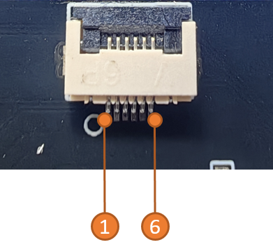

2.1.3.10. Independent I2C Interface
The development board supports 1 independent I2C interface (interface 25). This interface is primarily designed to work with the MIPI CSI expansion board to split the MIPI CSI0&1 interface (interface 20) into two separate MIPI CSI0 and MIPI CSI1 interfaces. It can also be used as a standalone I2C interface for connecting peripherals.
image-20240425113814265
Pin layout is as follows:
No. Name Property Description
1 GND Signal ground reference Ground
2 RESET 1.8V single-ended output Board resets module, active low
3 I2C1_SCL Default 3.3V single-ended I2C clock line
4 I2C1_SDA Default 3.3V single-ended I2C data line
5 CSI1 Triggle 1.8V single-ended input Used for triggering Camera Sensor when expanding MIPI CSI1
6 VDD33 3.3V, 200mA Module power supply

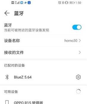

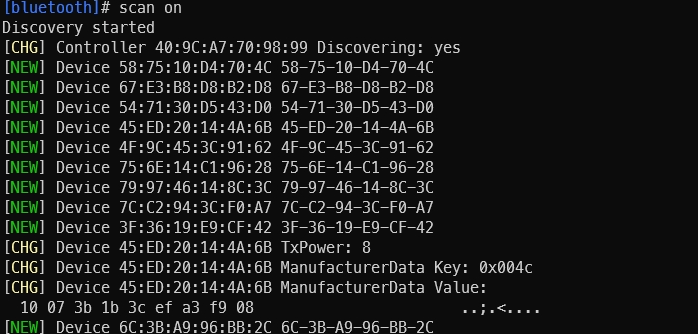

  • Using Bluetooth
Run /etc/init.d/bt_init.sh to complete Bluetooth initialization.
Run bluetoothctl to enter the interactive Bluetooth configuration interface. If device information similar to the image below appears, the Bluetooth module has been recognized. Use the show command to view Bluetooth details, paying attention to the powered and discoverable status.
Run power on to enable Bluetooth, as shown below:
To make the Bluetooth device discoverable by nearby devices, run discoverable on to enable the discoverable attribute, as shown below:
At this point, scanning with a phone or computer will reveal a Bluetooth device named “BlueZ 5.64” (the version number may vary depending on the BlueZ version, e.g., it could be BlueZ 5.79):
Next, test Bluetooth’s active scanning function. Enter scan on in the bluetoothctl interactive interface to start scanning. It will periodically print nearby devices. As shown, your phone can be detected. Use scan off to stop scanning and summarize the discovered Bluetooth devices:

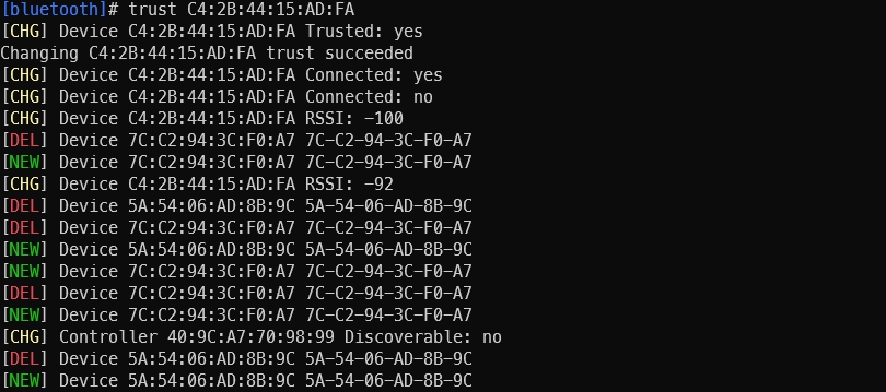

Then proceed with pairing with other Bluetooth devices:
Pairing command: pair [targetMAC]. After entering the command, confirm with yes when prompted, and select the “Pair” option on the remote Bluetooth device to complete pairing.
After successful pairing, use trust [targetMAC] to allow automatic connection in the future.

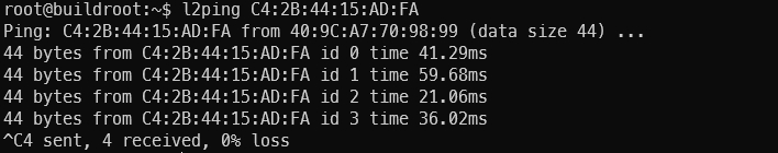

Use l2ping to test network connectivity.

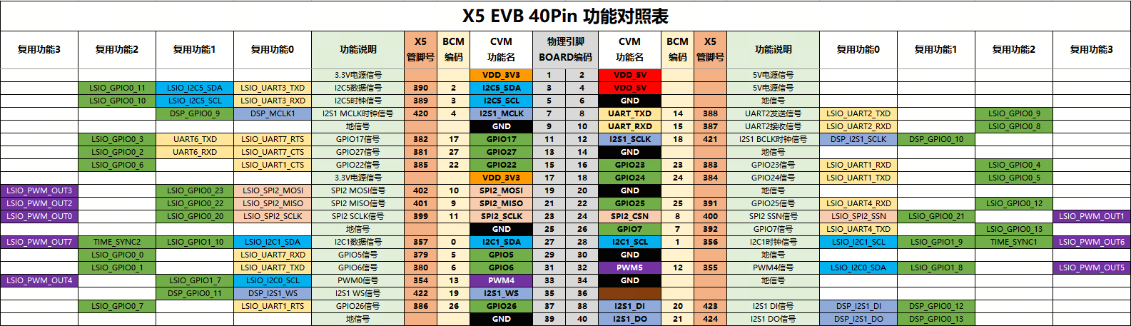

2.1.3.13. 40-Pin Interface
The development board provides one 40-pin interface (Connector 24) for easy peripheral expansion. The pinout and supported multiplexing functions are shown below:
image-20250331-120318
All IO pins on the 40-pin interface default to the 3.3V voltage domain. You can adjust resistors R903 and R902 to switch between 3.3V and 1.8V voltage domains.
VDDPST33ADJ
Warning: U-Boot code must be updated synchronously when switching voltage domains. Failure to do so may result in mismatch between software configuration and actual power supply, potentially causing chip damage.
Connection Example:

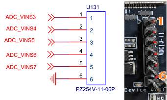

2.1.3.15. ADC Interface
Connector 11 is the ADC (Analog-to-Digital Converter) interface on the development board. It provides five pins labeled ADC[3-7] for connecting analog signal sources and converting them into digital signals for system processing. Users can read corresponding system files to obtain the converted ADC values.
  • Input Voltage Range: The supported input voltage range is 0.1–1.7V. Ensure that the input signal voltage stays within this range to avoid signal distortion or ADC damage.
image-20240426235339200
Reading ADC Values
Read the system files /sys/bus/iio/devices/iio:device0/in_voltage3_raw to /sys/bus/iio/devices/iio:device0/in_voltage7_raw to get the raw ADC values for channels ADC[3-7]. For example, to read ADC3 value:
root@buildroot:~$ cat /sys/bus/iio/devices/iio:device0/in_voltage3_raw
1020
This command outputs the raw digital value from the ADC3 channel. To read values from ADC[3-7], simply replace in_voltage3_raw with the corresponding in_voltageX_raw (where X ranges from 3 to 7).
