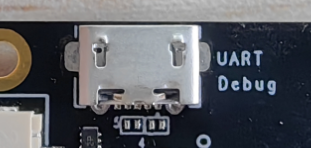

The X5 EVB development board already includes a USB-to-serial chip (CH340N). Users can connect the board to a personal computer (PC) using a Micro USB 2.0 data cable. After installing the CH340N driver on the PC, the serial interface becomes usable. The physical interface is labeled as interface 19 in the Functional Module Layout, as shown in the figure below:

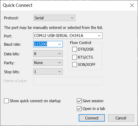

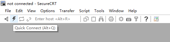

  1. Click the Quick Connect button to open the creation window.
image-20220309103341869

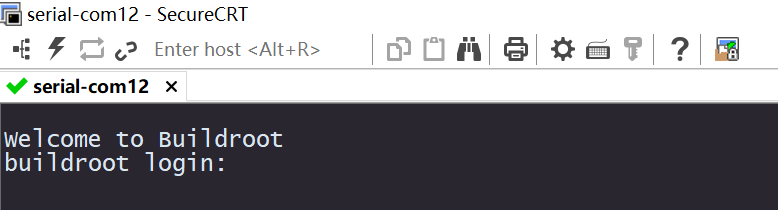

  1. In the Quick Connect dialog, set Protocol to Serial, select the detected COM port (e.g., COM12) as Port, and configure according to the above parameters.
image-20220215153207781
  1. Click the Connect button in the Quick Connect dialog to complete the connection.
image-20220215153135685
  1. Enter username root and password root to log in to the device.

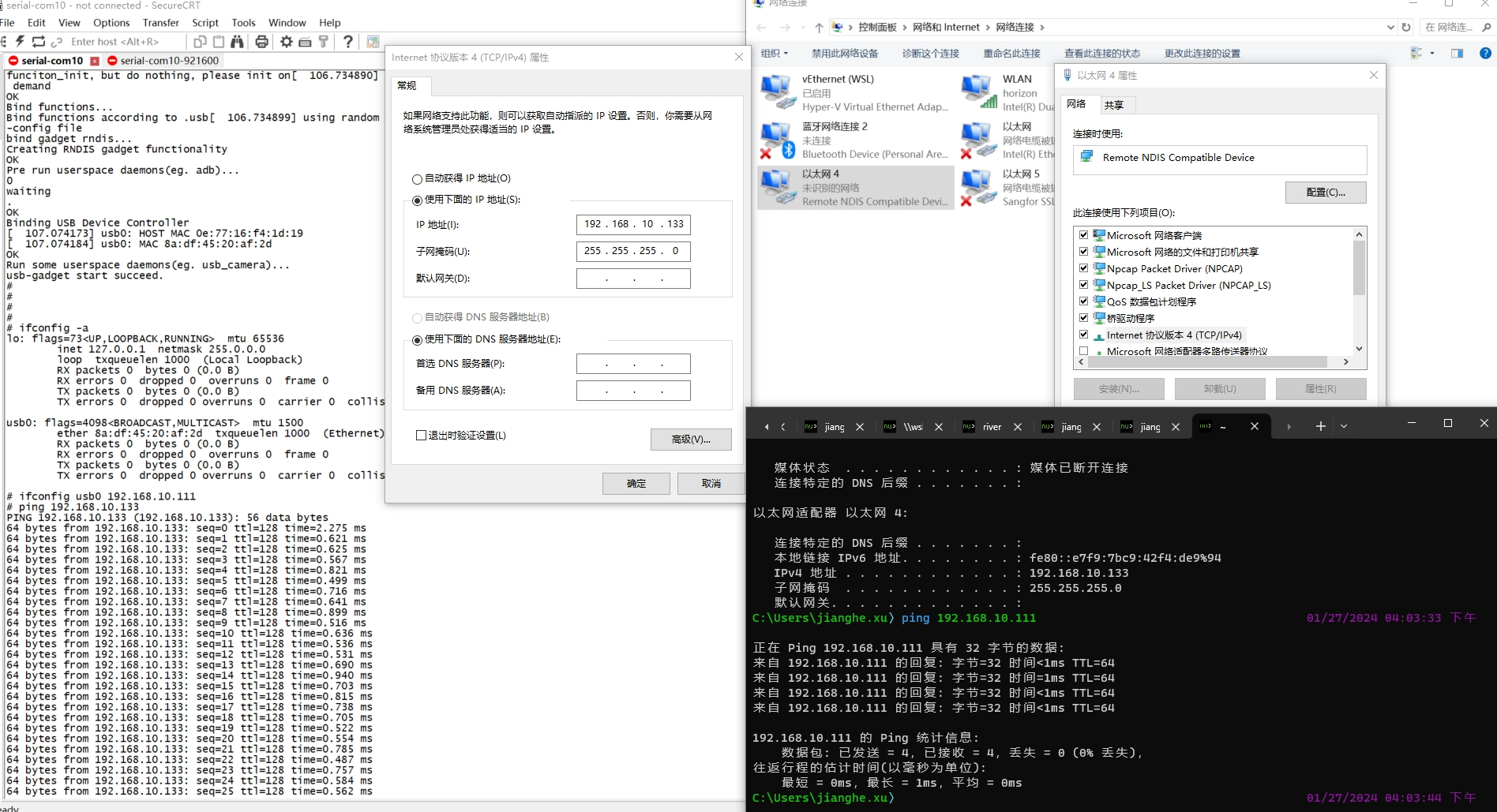

After confirming the development board’s network settings, configure the PC’s network parameters accordingly.

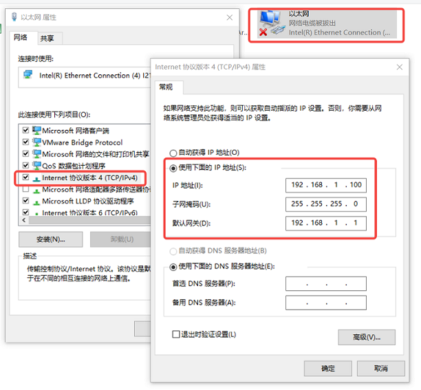

2.4.2.1. Windows Network Configuration
Example: Configure PC IP as follows:
  • IP address: 192.168.1.100
  • Netmask: 255.255.255.0
  • Gateway: 192.168.1.1
Steps:
  1. In Network Connections, locate the corresponding Ethernet device and double-click to open it.
  2. Find Internet Protocol Version 4 (TCP/IPv4) and double-click to open.
  3. Enter the network parameters in the red box area as shown in the image below, then click OK.
image-ETH-ipconfig

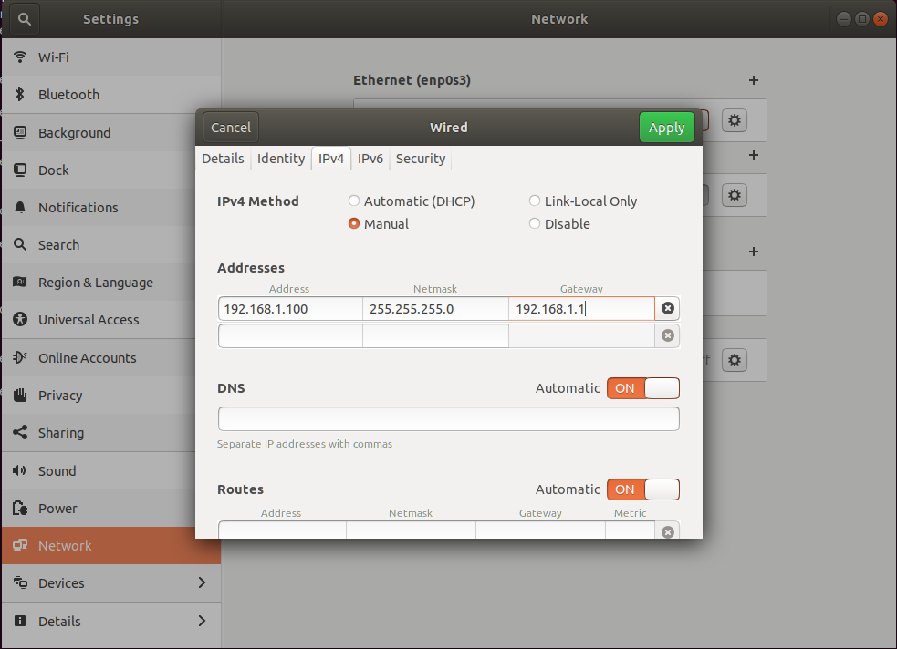

2.4.2.2. Ubuntu Network Configuration
Steps:
  1. On the Ubuntu desktop, open System Settings → click Network → locate the wired connection interface connected to the board (if not directly connected, identify the interface communicating with the board), and click the gear icon next to it.
  2. In the pop-up window, switch to the IPv4 tab for configuration.
  3. Select Manual, enter the Address, Netmask, and Gateway, click Apply, and restart the network.
image-ETH-ipconfig
After completing the network configuration, verify bidirectional ping connectivity between the development board and PC. If ping fails, recheck the configuration against the network requirements.

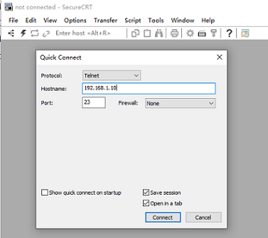

2.4.2.3. Terminal Software Configuration
Commonly used PC debugging tools include Putty, MobaXterm, SecureCRT, etc. Users can choose based on preference. The process of connecting to the development board via network is generally similar across tools. This document uses SecureCRT as an example to demonstrate creating a new network connection.

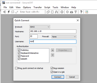

  1. Click the Quick Connect button and set Protocol to SSH2.
  2. Set Hostname to the development board IP address (192.168.1.10). For SSH2, also enter Username as root.
image-ETH-Telnet image-ETH-SSH2
  1. Keep other settings default and click Connect to complete setup.
  2. For Telnet login, enter username (root) and password (root).
  3. For SSH2 login, only password (root) is required.

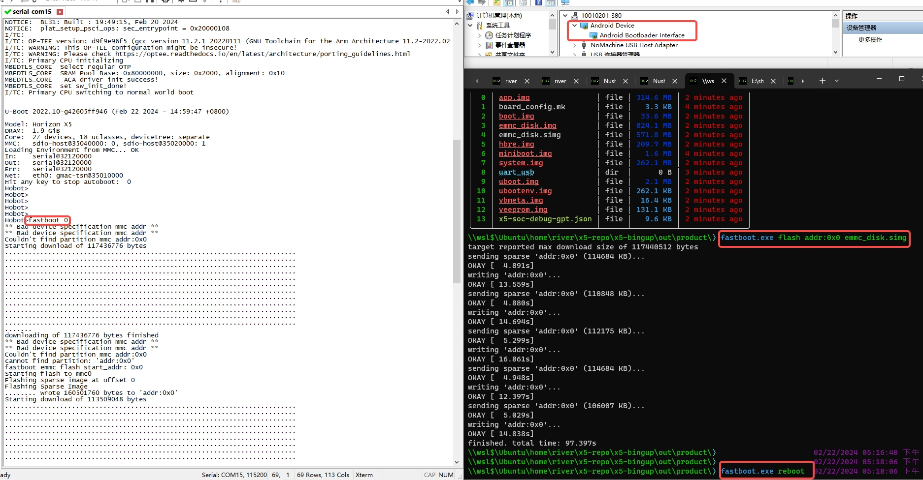

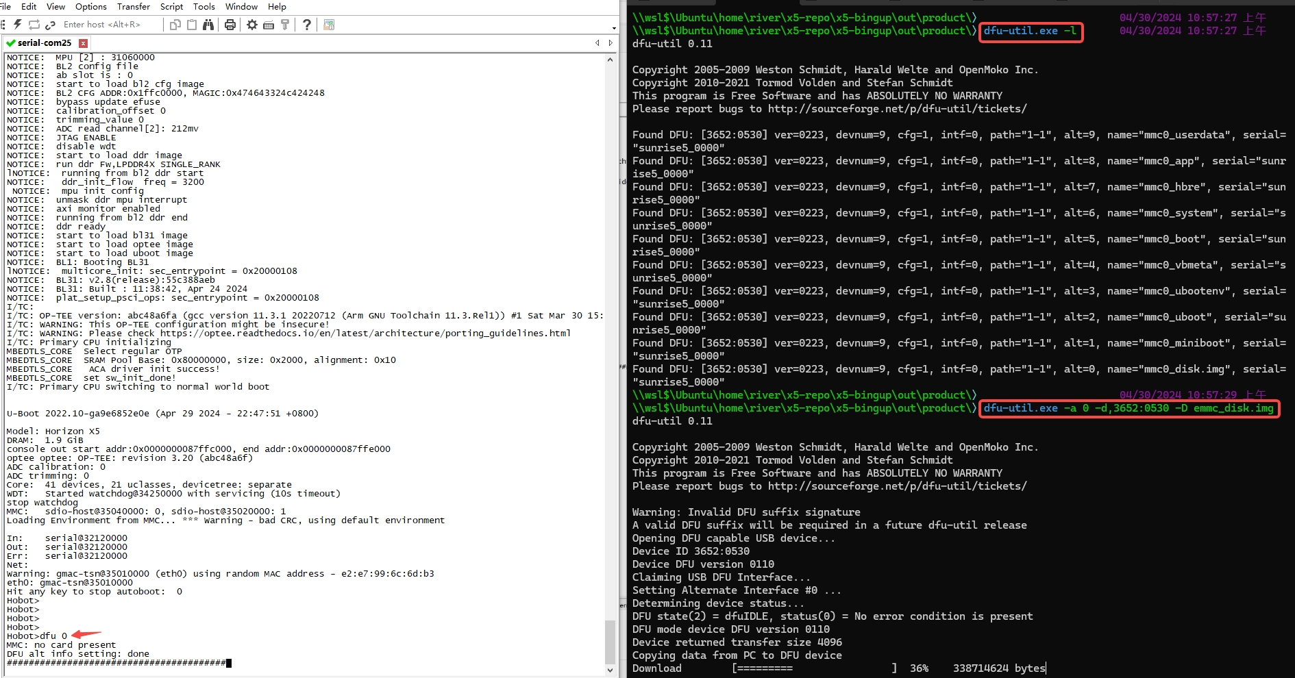

Enter fastboot 0 at the development board’s U-Boot command line to enter fastboot mode:
U-Boot 2022.10-gc52e405209 (Nov 26 2024 - 14:20:51 +0800)
Model: Horizon X5
... (omitted) ...
Hit any key to stop autoboot:  0
Hobot>
Hobot>fastboot 0
select emmc(0) as flash medium
do fastboot usb
If the driver is not installed, Device Manager will show an unknown device labeled USB download gadget, as shown below:
image-20220214144850602
In this case, use the software_tools\winusb_drivers\sunrise5_winusb.zip package from the SDK delivery package to install the driver:
  1. Extract sunrise5_winusb.zip.

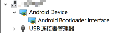

  2. Navigate into the sunrise5_winusb folder, right-click install_driver.bat, and select Run as administrator.
After successful installation, Device Manager will display an Android Device, as shown below:

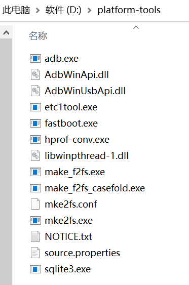

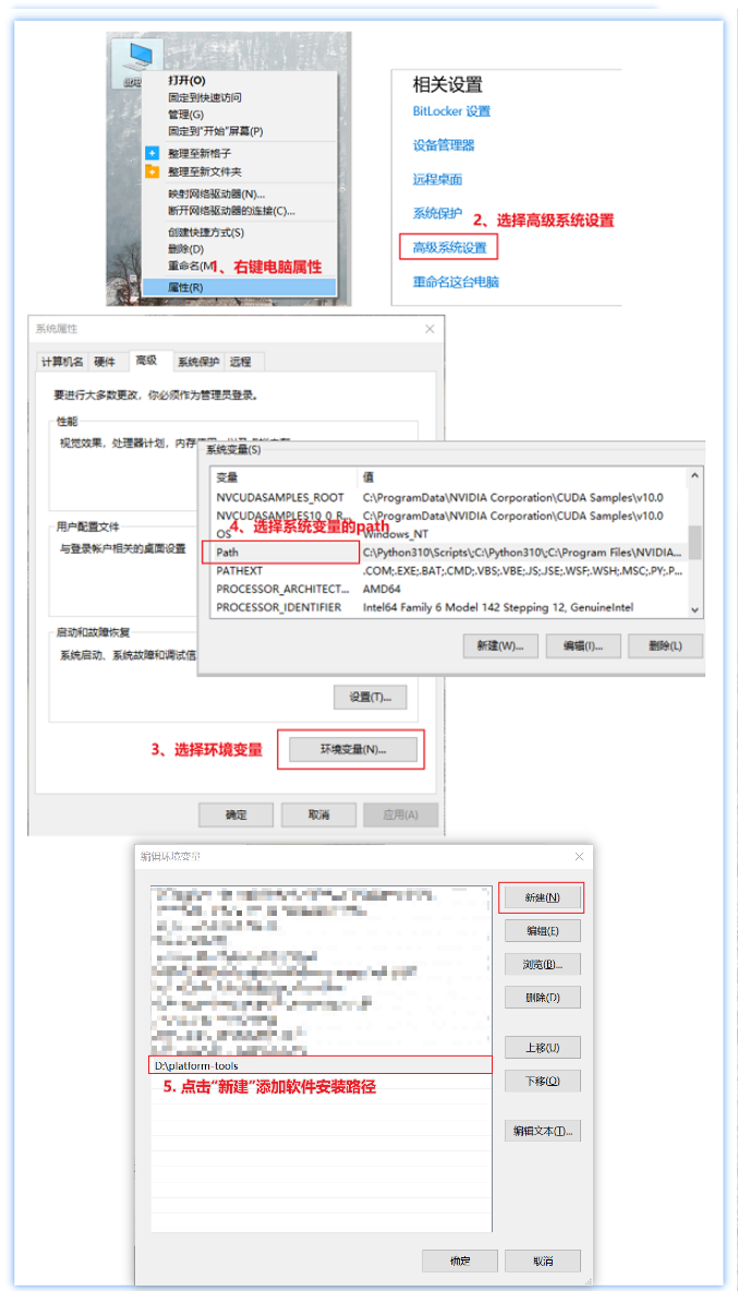

Locate the file software_tools\adb_and_fastboot\platform-tools_r34.0.5-windows.zip in the SDK delivery package. Follow these steps to install the software and set environment variables:
  • Extract platform-tools_r34.0.5-windows.zip to a folder without spaces, Chinese characters, or special characters, e.g., D:\platform-tools.
image-20220425194733026
  • Open the Windows system advanced environment settings and add the extracted tool path to the system PATH variable.
image-20220425195125259

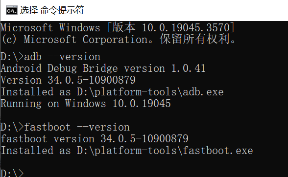

After correctly configuring the environment variables, open Command Prompt and run adb --version and fastboot --version to verify the tool versions.
image-20240314142602339

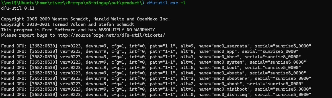

Run the following commands to install adb, fastboot, and dfu on Ubuntu:
sudo apt install android-tools-adb
sudo apt install android-tools-fastboot
sudo apt-get install dfu-util

Check the dfu-util version:
$ dfu-util --version
dfu-util 0.9
Copyright 2005-2009 Weston Schmidt, Harald Welte and OpenMoko Inc.
Copyright 2010-2016 Tormod Volden and Stefan Schmidt
This program is Free Software and has ABSOLUTELY NO WARRANTY
Please report bugs to http://sourceforge.net/p/dfu-util/tickets/

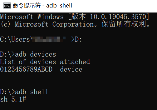

2.4.3.3. Using adb

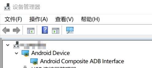

After the development board boots, the adbd service starts automatically. Once the board is connected to the PC via USB, you can use adb shell for debugging.
When the development board’s Micro USB is connected to the PC, Device Manager will recognize the adb device as Android Composite ADB Interface, as shown below:
image-USB-xj3
Alternatively, users can run the adb devices command to confirm whether the PC has recognized the adb device. Normal recognition status is shown below:
image-20220309121640583
Failure to recognize the adb device usually has two possible causes:
  • The Micro USB data cable used does not support data communication, preventing the PC from recognizing the device;
  • The development board has not started the adbd service.
Users can troubleshoot as follows:
  • Log in to the development board via serial or network, and run ps | grep adbd to check if the adbd process is running;
  • If the adbd process is not running, start it with the command /etc/init.d/usb-gadget.sh restart adb. Example output:

Common Commands
adb shell
adb pull
adb push
# adb shell does not currently export related environment variables. Manual configuration is required; otherwise, some programs may fail to run due to missing variables. Either of the following methods resolves this:
# Method 1: Manually source /etc/profile after connecting
adb shell
source /etc/profile
# Method 2: Use the command below. Note: Tab completion may not work with this method
adb shell "ENV=/etc/profile sh -i"
2.4.3.4. Using fastboot
Fastboot is primarily used to upgrade software on the development board via USB. Below are two methods to enter fastboot mode:
  • Method 1: After booting into the shell, run reboot -m usb2 -f. Upon reboot, the board will automatically enter fastboot mode:
    # reboot -m usb2 -f
    155.850561] reboot: Restarting system with command 'usb2'
    ... (omitted) ...
    boot action: FASTBOOT USB2.0
    do fastboot usb
  • Method 2: Enter U-Boot command line mode and run fastboot 0:
    Model: Horizon X5
    ... (omitted) ...
    Hobot>
    Hobot>fastboot 0
    do fastboot usb
The easiest way to flash the full system image is:
 fastboot flash addr:0x0 emmc_disk.simg
After flashing, run fastboot reboot on the host PC or power-cycle the board to apply the update.
The full system image flashing process is illustrated below:
usb_fastboot_usage
Traditional partition-by-partition flashing is also supported:
fastboot flash uboot uboot.img          # Flash uboot partition
fastboot flash miniboot miniboot.img    # Flash miniboot partition
fastboot flash boot boot.img            # Flash boot partition
fastboot flash system system.img        # Flash system partition
Note:
  • When flashing miniboot_all, do not use the partition name miniboot. Instead, use flash addr:0x0, e.g.:
fastboot flash addr:0x0 miniboot_all.img
Reason: miniboot_all.img includes all images before the U-Boot partition (i.e., miniboot.img, partition table, and misc partition). To update both miniboot and the partition table together, it must be written from addr:0x0, just like emmc_disk.simg, and cannot be flashed to the miniboot partition alone.
  • It is recommended to connect the PC and development board directly via USB cable. Avoid using a USB hub, as it may affect transmission stability and cause flashing failure.
2.4.3.5. Using dfu
DFU is primarily used to upgrade software on the development board via USB.
After entering the U-Boot command line mode, run dfu 0 to enter DFU mode. If no image has been flashed to the storage medium (eMMC or NAND flash), and there is no valid partition table, run run dfu_emmc.
U-Boot 2022.10-gca2c6582a0 (Mar 13 2024 - 19:04:15 +0800)
Model: Horizon X5
... (omitted) ...
Hobot>dfu 0
DFU alt info setting: done
View partitions on the PC side, and select the corresponding type through -a to burn the entire or partitioned burn:
dfu-util -l
For example, the reference image partition table is shown in the figure below:
usb_dfu_list
Flashing the full system image:
dfu-util -a 0 -D emmc_disk.img
# If there are multiple DFU devices on the host (e.g., some laptop cameras are also DFU devices), use the -d parameter to specify the device ID:
# The comma is required. DFU devices have both run-time and DFU modes; the ID after the comma matches the DFU mode device.
dfu-util -d,3652:0530 -a 0 -D emmc_disk.img
The process of flashing the full system image is illustrated below:
usb_dfu_usage
Flashing by partition:
# Refer to the partition information listed by `dfu-util -l` for the actual partition number (i.e., the number after -a)
dfu-util -a 2 -D uboot.img                      # Flash uboot partition
dfu-util -a 5 -D boot.img                       # Flash boot partition
dfu-util -a 6 -D system.img                     # Flash system partition

2.4.3.7. Virtual Network Interface (RNDIS)
After the development board boots into the system, execute the following command to start RNDIS:
/etc/init.d/usb-gadget.sh restart rndis
Windows 10 has built-in driver support. After connecting the PC and development board via USB cable, a network interface node will be created.
Configure the IP address of the Remote NDIS network interface on Windows, and configure the IP address of the usb0 interface on the development board, then perform a ping test. The specific steps are as follows:
Configure IP Address for Remote NDIS Interface (on PC):
  1. Open Network Connection Settings: In Windows, right-click the network icon in the taskbar (usually Wi-Fi or Ethernet), then select Open Network & Internet settings.
  2. Access Network Settings: In the Network & Internet settings window, click Change adapter options.
  3. Locate Remote NDIS Connection: In the Network Connections window, find and right-click the Remote NDIS connection, then select Properties.
  4. Configure IP Address: In the Local Area Connection Properties window, double-click Internet Protocol Version 4 (TCP/IPv4) or select it and click Properties.
  5. Manually Set IP Address: In the Internet Protocol Version 4 (TCP/IPv4) Properties window, select Use the following IP address, then enter the IP address, subnet mask, and default gateway. Typically, you can assign an unused local network address, for example: IP address 192.168.10.133, subnet mask 255.255.255.0, and leave the gateway blank or set it to your router’s IP address.
  6. Save Configuration: After entering the details, click OK to save and close all windows.
Configure IP Address for usb0 Interface (on Development Board):
  1. Log in to the Development Board: Access the command line interface of the development board via serial, SSH, or other methods.
  2. Set IP Address: Run the command ifconfig usb0 192.168.10.111 to configure the IP address of the usb0 interface.
Perform Ping Test:
  1. Verify Connection: Ensure the PC and development board are connected via USB, and both the Remote NDIS and usb0 interfaces have been correctly configured with IP addresses.
  2. Run Ping Command on PC: Open Command Prompt and enter ping 192.168.10.111 (assuming the development board’s IP is 192.168.10.111), then press Enter.
  3. Check Ping Results: If the ping command succeeds and displays responses like Reply from 192.168.10.111, the network connection between PC and development board is functioning properly.
The configuration and test results are shown in the figure below:
usb_rndis_usage
