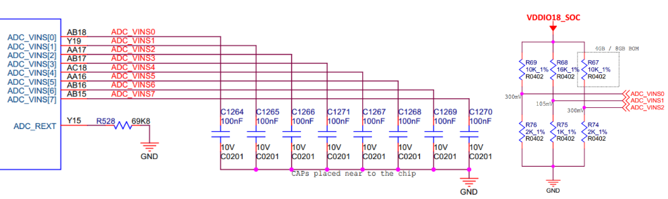

4.2.3.1. Hardware Board ID Overview
On the X5 platform, the Board ID is defined via 4 ADC channels, using different external voltage values for hardware identification. Current ADC channel (ADC_VINS) configurations are as follows:
  • ADC_VINS0: Mainboard type — different X5 projects use different IDs. For example, if a user has two internal X5 project lines, they can use different resistor dividers on VIN0 to distinguish them.
  • ADC_VINS1: Used to differentiate hardware versions within a project line (e.g., First hardware release, second hardware release.).
  • ADC_VINS2: DDR parameter configuration. Users must strictly follow the official hardware reference design when selecting the appropriate setting based on the motherboard’s DDR BOM.
  • ADC_VINS6: Reserved setting; recommended to leave NC. If additional ADC is needed, prefer other ADC channels (ADC_VIN).
Hardware Board ID circuit design requires a 100nF decoupling capacitor and appropriate voltage divider resistors to ensure accurate ADC voltage readings.
image-20241225152523451
Selection of External Voltage Divider Resistors:
Refer to the official hardware reference design for pull-up/pull-down resistor selection. Total resistance should not exceed 50KΩ. High-value resistors (especially above 100KΩ) may cause:
  • High resistance leads to noticeable RC effects in internal ADC sampling, reducing accuracy.
  • Higher susceptibility to noise.
  • Most ADC applications stay below 50KΩ; values above 100KΩ are rare.
Example resistor combinations:

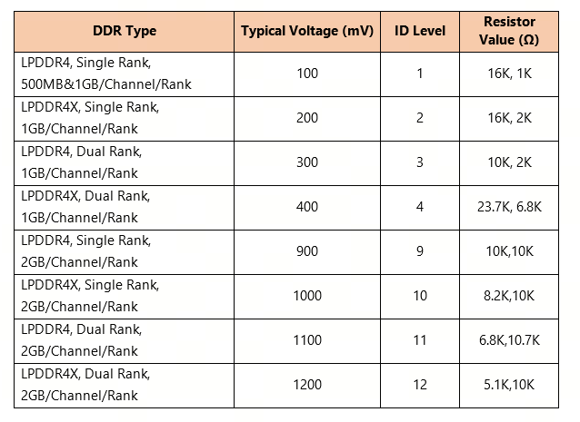

ADC Voltage Level Design Guidelines:
Users are advised to use the reference voltage levels provided in this section and avoid custom voltage ranges. That is, each level should be 100mV, 200mV, etc. Thus, each field supports up to 17 levels (ADC voltage range 0.1V ~ 1.7V).
The software mapping of each analog voltage (e.g., 100mV mapped to ID=1 in software) is user-defined and not strictly enforced.
ADC_VINS2 is strictly constrained and related to DDR Type:
  • The X5 platform supports a total bus width of 32 bits, using a 2-channel design, each channel 16 bits wide (i.e., 2CH x 16 = 32 bits). Each die in the DDR chip must have a x16 width. Design must ensure DDR frequency and capacity meet platform performance requirements, with careful PCB layout for signal integrity and length matching to ensure system stability and compatibility.
  • X5 supports both LPDDR4 and LPDDR4X modes, and both single-rank and dual-rank configurations, distinguished via ADC_VINS2.
  • ADC_VINS2 levels do not reflect DDR capacity; supported capacities include 1GB, 2GB, 4GB, and 8GB.
  • For supported models, refer to Approved Vendor List.
Important: Configure level values from 1 to 17. Do not directly pull ADC input low (level 0) or high to power (level 18).
ADC sampling range, divider values, and level assignment reference:
adc_voltage_range_reference
