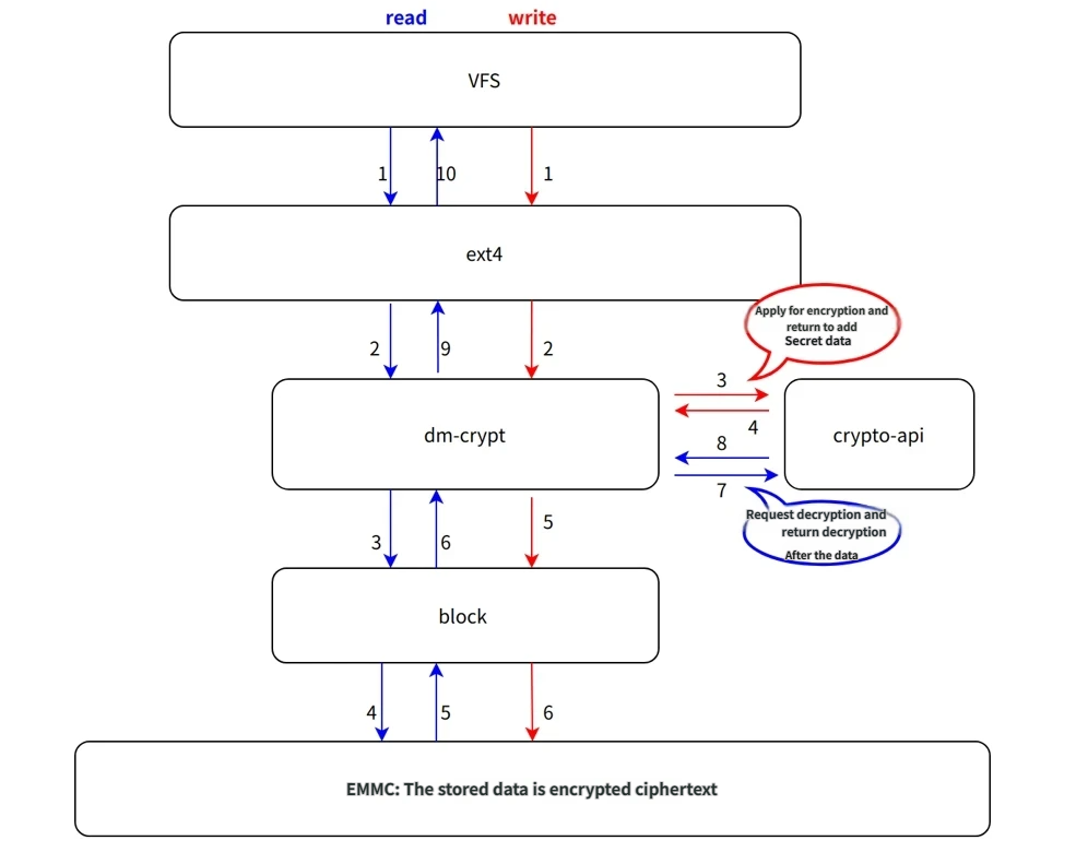

The core idea of FDE encryption is to use encryption algorithms to encrypt all data on the hard drive, typically encrypting and decrypting data before the operating system layer. This means that every time data is read from or written to the disk, it is transparently encrypted and decrypted, and users are hardly aware of this process.
FDE data flow is as follows:
fde_data_stream

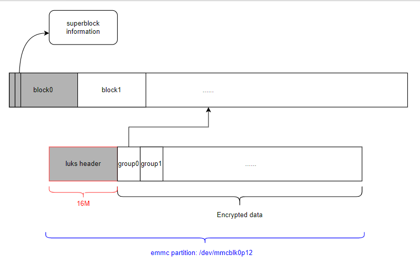

When creating a LUKS encrypted volume, a LUKS header is generated for the target partition to store keys, salts, etc., and the remaining portion (excluding the LUKS header) is reformatted to generate a new encrypted superblock.
cryptsetup_intro

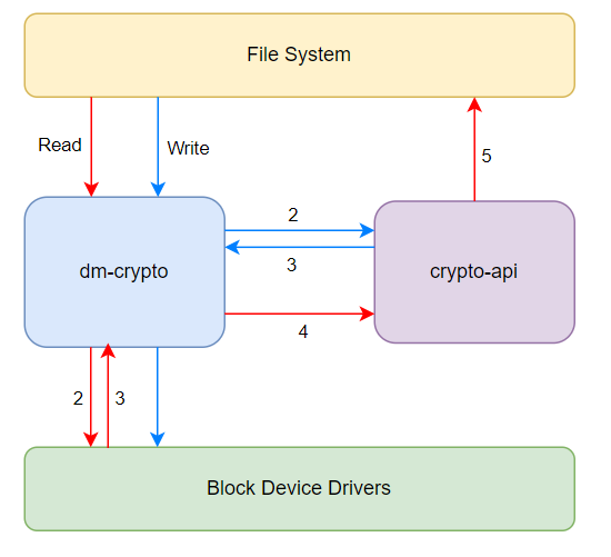

dm-crypt is implemented based on Device Mapper technology. It separates the encryption layer from the storage layer by creating a new virtual device. The operating system performs all read/write operations through this virtual device, while the encryption and decryption processes are automatically completed in the background.
When you read from or write to an encrypted device, dm-crypt automatically encrypts (on write) or decrypts (on read) the data. This encryption/decryption process is transparent, and applications or users do not need to understand the encryption details.
dm-crypt_read_write

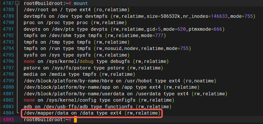

As shown below, after successful enablement, “data” will appear under /dev/mapper:
normal_fde_res

The system decrypts the fdedata partition and generates the node /dev/mapper/fdedata. Finally, the decrypted partition is automatically mounted to /userdata/test
root@buildroot:~# mount | grep fdedata
/dev/mapper/fdedata on /userdata/test type ext4 (rw,relatime)
