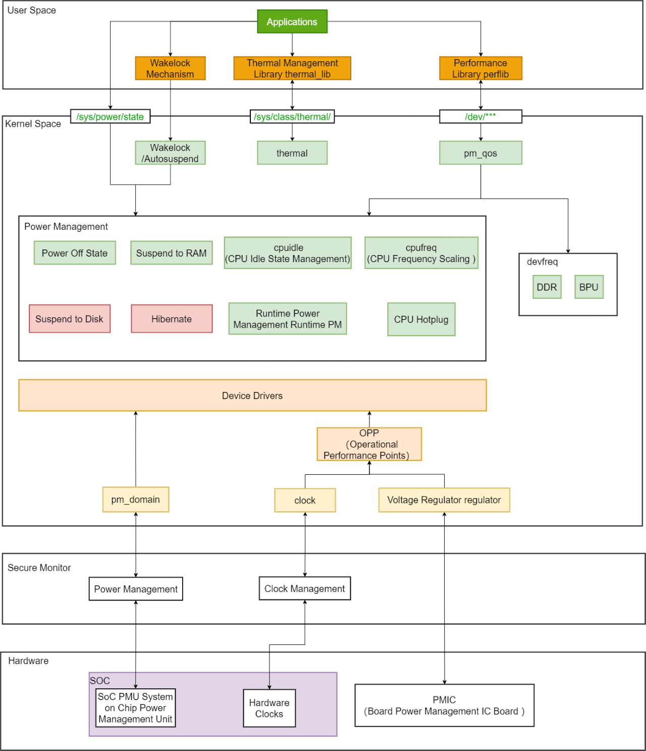

The Low Power Management System aims to reduce energy consumption and extend battery life by optimizing the power usage of electronic devices. It adjusts hardware and software to maintain minimal power consumption in standby states, while achieving an optimal balance between power efficiency and performance across different usage scenarios.
4.4.11.2. Detailed Explanation of Low Power Debugging
This system supports operation in three distinct modes: Off Mode, Sleep Mode, and Work Mode. Depending on the corresponding operational state and application, it is divided into nine sub-power domains:

The system’s power management operates under different working modes, with different power domains enabled accordingly:
  • OFF Mode: All power domains are turned off.
  • SLEEP Mode: In this mode, the AON, DSP, and HIFI5 domains remain powered to support hardware wake-up (via RTC, GPIO, counters) and voice wake-up. The HIFI5 watchdog interrupt can also wake the system back to Work mode.
  • WORK Mode: In this mode, the AON, DSP, SOC, CPU, and DDR domains must be powered on. HIFI5 and individual CPU cores (CORE0 to CORE7), along with other subsystems (such as BPU, GPU, ISP, VIDEO), can be selectively powered on or off as needed. At least one A55 core must remain active. The system can enter Sleep mode via software configuration.
To optimize power consumption, the system often dynamically adjusts resource usage based on varying workloads. Two common and effective low-power management techniques are Dynamic Voltage and Frequency Scaling (DVFS) and sleep-wakeup mechanisms. DVFS reduces power consumption by adjusting the processor’s voltage and frequency in real time according to workload, balancing performance and efficiency. The sleep-wakeup mechanism further reduces power by placing the system into low-power states during inactivity and quickly resuming operation when needed. The following sections will explore these two methods in detail.

Linux Power Management Core Framework
Linux power management consists of two main parts: System-Level Power Management and Device Power Management.
  • System-Level Power Management: Manages overall system power states, including CPU idle states (C-states), system suspend, hibernate, etc. Ensures key hardware enters low-power states when idle.
  • Device Power Management: Manages peripheral device power, including how drivers control device power, suspend, resume, etc.
The Linux kernel coordinates via the PM framework and device driver interfaces. Each driver can register PM callbacks to inform the kernel when to power on/off devices or enter low-power states.
The Linux PM framework is illustrated below:
low_power-Linux_Power_software_framework
Key DVFS-related components in the diagram:
  • cpufreq Subsystem
    cpufreq is the Linux kernel subsystem for CPU frequency scaling. It provides a unified interface for dynamic CPU frequency adjustment by kernel or user space.
    • Frequency Drivers: Different platforms require different drivers (e.g., intel_pstate for Intel, acpi-cpufreq for ACPI systems).
    • Governors: Strategies like ondemand, conservative, performance, powersave adjust frequency based on load.
  • cpuidle Subsystem
    Manages CPU idle states. By placing CPUs into deeper idle states, power consumption is further reduced. Works with cpufreq—when idle, frequency and voltage drop.
  • devfreq Subsystem
    Controls frequency of devices (e.g., GPU, memory). Allows devices to scale frequency based on load for power efficiency.
DVFS in Linux optimizes power and performance by adjusting frequency and voltage of CPU and other components. The kernel manages this via cpufreq, cpuidle, devfreq, while users can configure and optimize using tools and interfaces. Proper DVFS strategies allow Linux to reduce power without sacrificing performance.

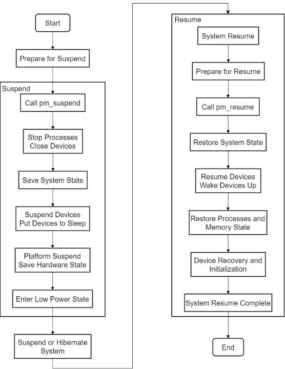

Overview of Linux System Suspend / Resume Process
Linux system suspend mainly consists of two modes: Suspend and Hibernate. In Suspend mode, the system state is saved in memory (STR, Suspend to RAM), and hardware enters a low-power state. In Hibernate mode, the system state is saved to disk, and power is completely turned off; upon resume, the system state is loaded from disk.
The basic steps of system suspend are as follows:
  1. Prepare for Suspend:
    • Call the pm_suspend() function to switch the system into suspend state.
    • Before calling pm_suspend(), the Linux kernel performs a series of preparations, such as stopping running processes and shutting down unnecessary devices.
  2. Save System State:
    • The system calls suspend_devices() to suspend all supported devices.
    • Call platform_suspend() to save platform-specific hardware states.
  3. Enter Low-Power State:
    • Once all devices and system states are saved, the CPU enters a low-power state. At this point, most hardware is suspended, with only essential components (such as memory) remaining active.
  4. Restore System State:
    • When the system resumes from suspend or hibernate, resume_devices() is called to restore the state of all devices.
    • The kernel restarts all processes and loads the system state from memory or disk, returning to the pre-suspend working state.
When the Linux system resumes from Suspend or Hibernate state, a series of steps are required to re-enable devices and restore previously saved states. The key to the resume process is loading the system’s operational state from the low-power state or disk, ensuring that devices and processes resume operation as expected.
The basic steps of the system resume process are as follows:
  1. Prepare for Resume:
    • After the system resumes from a low-power state or disk, it first calls the pm_resume() function to begin system recovery.
    • Before calling pm_resume(), the Linux kernel performs a series of preparations, such as reactivating required hardware and restoring system state.
  2. Restore System State:
    • The system calls resume_devices() to restore the state of all devices. This process restores device operation according to the device drivers.
    • For Suspend mode, device states are saved in memory and thus restored from memory.
    • For Hibernate mode, the system reads the saved system state from disk and restores it to the pre-hibernation state.
  3. Restore Process and Memory State:
    • After resuming from suspend or hibernate, the kernel restores the state of all processes, ensuring each process can continue execution from its paused state.
    • For hibernate mode, the kernel loads the process and memory state from the hibernation image on disk, restoring the system to its pre-hibernation state.
  4. Device Recovery and Initialization:
    • The recovery process involves not only restoring memory and processes but also reinitializing all hardware devices. Specifically:
      • For hardware devices such as PCI and USB controllers, the system calls the device’s resume method to re-enable them.
      • Drivers ensure that hardware devices return to the correct operational state, such as re-enabling interrupts and resuming data transmission.
  5. Resume Completion:
    • During the recovery process, all devices are restored to normal operation, memory data is recovered, and processes are restarted and continue execution.
    • After the system resumes, users can continue using the computer, and the system state is nearly identical to before the suspend.
The suspend and resume process of the system is illustrated below:

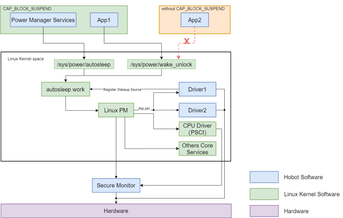

log_buf_size
The Linux system suspend process involves three components: user-space applications, kernel space, and the Secure Monitor, which cooperate to complete the suspend operation. This process can be illustrated as follows:
The power management workflow during suspend and resume in the above figure can be summarized as follows:
  • Applications interact with Linux PM through specific interfaces. Linux PM interacts with device drivers and core services via PM APIs, ultimately affecting the power state of the hardware.
  • The Secure Monitor plays a monitoring and protection role throughout the process, ensuring the security of power management.
The following is an explanation of each part in the figure:
  1. Hobot Software (blue):
    • Power Manager Services: Software services responsible for managing power.
    • App1 and App2: Applications, where App2 does not have the CAP_BLOCK_SUSPEND permission and therefore cannot call the /sys/power/wake_unlock interface.
  2. Linux Kernel Software (green):
    • autosleep work: The automatic suspend mechanism, possibly used to automatically enter low-power states when the system is idle.
    • Linux PM (Power Management): The core power management module responsible for coordinating system power states.
    • Driver1 and Driver2: Device drivers, typically used to manage the power state of specific hardware.
    • CPU Driver (PSCI): CPU driver using the PSCI (Power State Coordination Interface) to manage CPU power states.
    • Others Core Services: Other core services, generally including system logging, security monitoring, etc.
  3. Interfaces:
    • /sys/power/autosleep: Interface for setting or querying automatic suspend.
    • /sys/power/wake_unlock: Interface for unlocking wake-up sources; App2 cannot use it due to permission issues.
  4. Secure Monitor:
    • Responsible for monitoring and managing hardware-level power states, ensuring system security and stability.
  5. Hardware:
    • Underlying hardware that interacts with the software layer to implement power management functions.

The following is a detailed analysis of the log:
  1. Suspend Process
    • Entering Suspend:
      • echo mem > /sys/power/state: This command puts the system into suspend mode, specifically “deep sleep”.
      • PM: suspend entry: The system begins entering the suspend state.
    • File System Sync:
      • Filesystems sync: 0.003 seconds: Before entering suspend, the system synchronizes the file system to ensure all data is written to disk.
    • Freezing User Space Processes:
      • Freezing user space processes: The system freezes user space processes to prevent state changes during suspend.
      • Freezing user space processes completed (elapsed 0.001 seconds): The freezing process is complete.
    • Disabling Non-Boot CPUs:
      • Disabling non-boot CPUs ...: The system disables non-boot CPUs (all except the boot CPU) to save power.
  2. Device Suspend
    • Device Suspend:
      • Multiple device suspend operations are logged, e.g.:
        • hobot_gdc_suspend, cim_suspend, vpu_suspend, jpu_suspend, etc., indicating these devices are suspended upon entering sleep.
      • PM: suspend devices took 0.050 seconds: The device suspend operation took 50 milliseconds.
  3. Resume Process
    • Resuming Devices:
      • PM: resume devices took 0.600 seconds: The device resume process took 600 milliseconds.
      • Log entries indicate multiple devices (e.g., hobot_gdc_resume, cim_resume, vpu_resume, jpu_resume) are reactivated.
    • Re-enabling Non-Boot CPUs:
      • Enabling non-boot CPUs ...: The system re-enables previously disabled non-boot CPUs.
      • Logs show startup messages for each CPU (e.g., CPU1 is up), indicating successful recovery.
  4. Other Events
    • USB Device Status:
      • usb usb1: root hub lost power or was reset: The USB root hub lost power or was reset during suspend/resume, which may affect USB device operation.
    • Random Number Generator:
      • random: crng reseeded on system resumption: Upon system resume, the cryptographically secure random number generator is reseeded, a security measure.
    • OOM Killer:
      • OOM killer disabled and OOM killer enabled: The OOM (Out Of Memory) killer is disabled during suspend to prevent process termination under low memory, and re-enabled upon resume.
Common Suspend/Resume Issues
  • Issue: System fails to wake up normally after suspend.
    • Solution: Check that wake-up source configurations are correct—for example, verify RTC wake-up settings and ensure GPIO pins used for wake-up are properly configured as wake-up sources. Also, examine system logs for error messages or anomalies during suspend and resume.
  • Issue: System performance degrades after wake-up.
    • Solution: After system wake-up, check the status of devices and drivers to ensure they have properly resumed operation. Consider adjusting suspend/resume strategies—such as using different suspend modes or modifying sleep durations—to minimize performance impact.

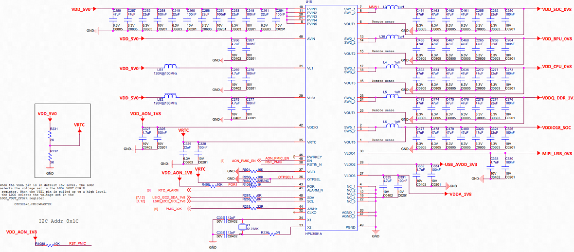

4.4.11.5. Typical Scenario Power Consumption
Using the X5 EVB motherboard as an example, the following are typical application scenario power consumption data:
  • Hardware Environment: X5 EVB motherboard
  • Workload Scenario:
    • 8x CPU @ 1.5GHz, 80% load
    • 1x BPU @ 1.0GHz, 80% load
    • LPDDR4 @ 3200MHz, 100% bandwidth
    • Dual camera input, 2x 1080p @ 30fps
  • Test Method:
    • Under 85°C junction temperature, average current data from each power rail of the X5 chip is recorded
  • Test Results:
    • Maximum average power consumption of the X5 chip is 4335mW
Voltage Domains Voltage(V) Avg Current(mA) Avg Power(mW)
CH0 SOC_1V8 1.8 16 28.8
CH1 DDR_0V8 0.8 817 653.6
CH2 GPU_0V8 0.8 0 0
CH3 SOC_0V8 0.8 992 793.6
CH4 DSP_0V8 0.8 80 64
CH5 18_DSP 1.8 4 7.2
CH6 CSI_0V8 0.8 4 3.2
CH7 SOC_3V3 3.3 0 0
CH8 DSI_0V8 0.8 0 0
CH9 AON_0V8 0.8 7 5.6
CH10 AON_1V8 1.8 0 0
CH11 18_SOC 1.8 40 72
CH12 USB_3V3 3.3 28 92.4
CH13 CSI_1V8 1.8 4 7.2
CH14 USB_0V8 0.8 28 22.4
CH15 BPU_0V8 0.8 1033 826.4
CH16 DDR_1V1 1.1 639 702.9
CH17 CPU_0V8 0.8 1295 1036
CH18 VDDA_1V 1.8 4 7.2
CH19 DDR_PLL 1.8 4 7.2
CH20 DSI_1V8 1.8 0 0
CH21 ADC_1V8 1.8 3 5.4
Total Power 4335.1

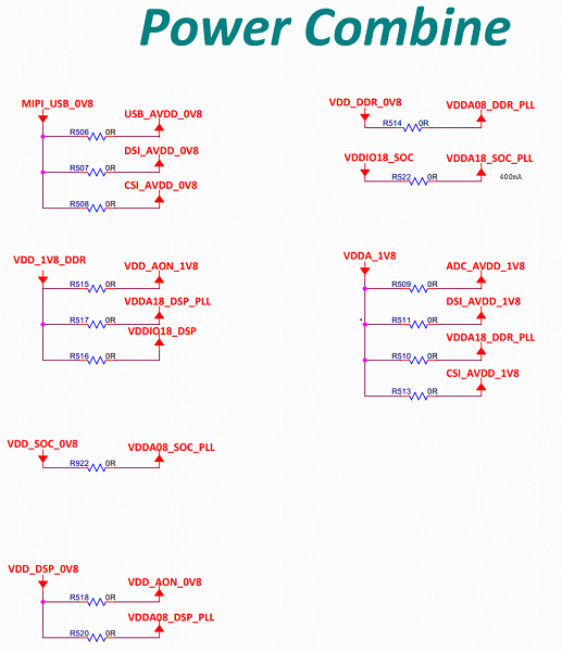

Note:
The power domains listed in the table above can be located on the X5 EVB schematic in the PMIC and Power Combine sections. Users can insert a current probe into the corresponding circuit to measure current and power consumption.
low_power-PMIC
low_power-Power_Combine
