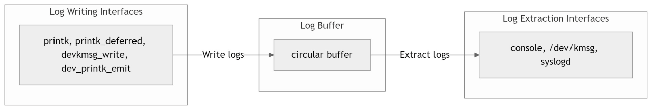

The Linux logging system can primarily be divided into three main components:
  1. Log Buffer: The log buffer is the core component of the logging system.
  2. Log Writing: Logs are written into the log buffer via interfaces such as printk, printk_deferred, devkmsg_write, and dev_printk_emit.
  3. Log Extraction: Log information is extracted through registered consoles, /dev/kmsg, and syslogd.
These three components can be illustrated in the following diagram:

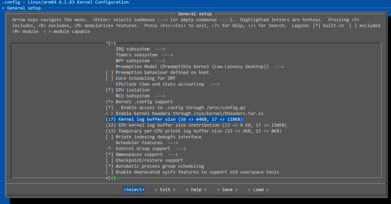

The value of __LOG_BUF_LEN is determined by CONFIG_LOG_BUF_SHIFT, which is set in the kernel configuration:
log_buf_size
As shown, the current system’s CONFIG_LOG_BUF_SHIFT is set to 17, so the log buffer size is 2^17 bytes (128KB). To modify the log buffer size, simply adjust CONFIG_LOG_BUF_SHIFT in menuconfig and recompile the kernel image.
Note that in the current kernel version (Linux V6.1.83), the log buffer size ranges from 4KB to 32MB (the range of CONFIG_LOG_BUF_SHIFT is 12 to 25):

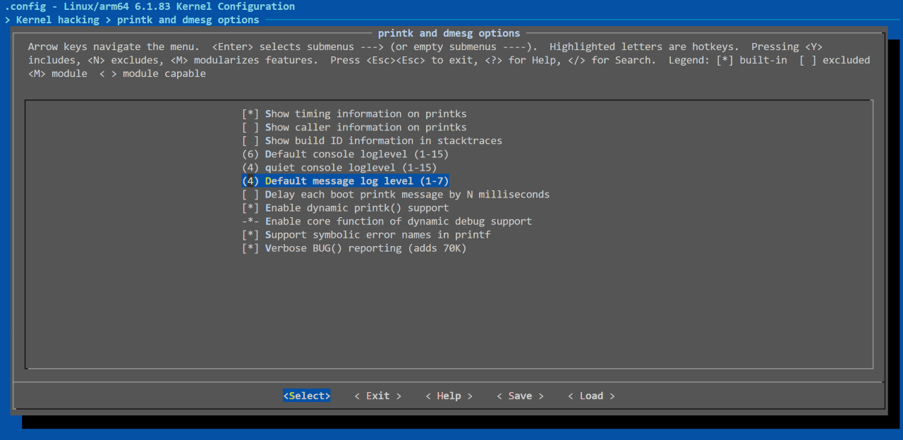

    The actual value of default_message_loglevel is MESSAGE_LOGLEVEL_DEFAULT, which is set in the kernel configuration:
    The value of MESSAGE_LOGLEVEL_DEFAULT ranges from 1 to 7:

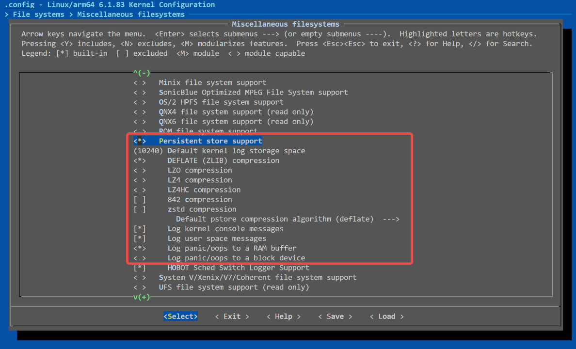

To enable pstore functionality, relevant options must be enabled in the kernel configuration (enabled by default):
pstore
Note: The configured pstore log storage location is on RAM, so corresponding logs can only be seen in /sys/fs/pstore after the automatic reboot following a system panic. Once powered off and restarted, files in /sys/fs/pstore will be cleared:
<*>     Log panic/oops to a RAM buffer
After a power-off restart, you need to check the latest log in the transfer directory /userdata/log/pstore/.
After enabling pstore support, the corresponding driver will be loaded, and relevant content can be seen in the system boot logs:
