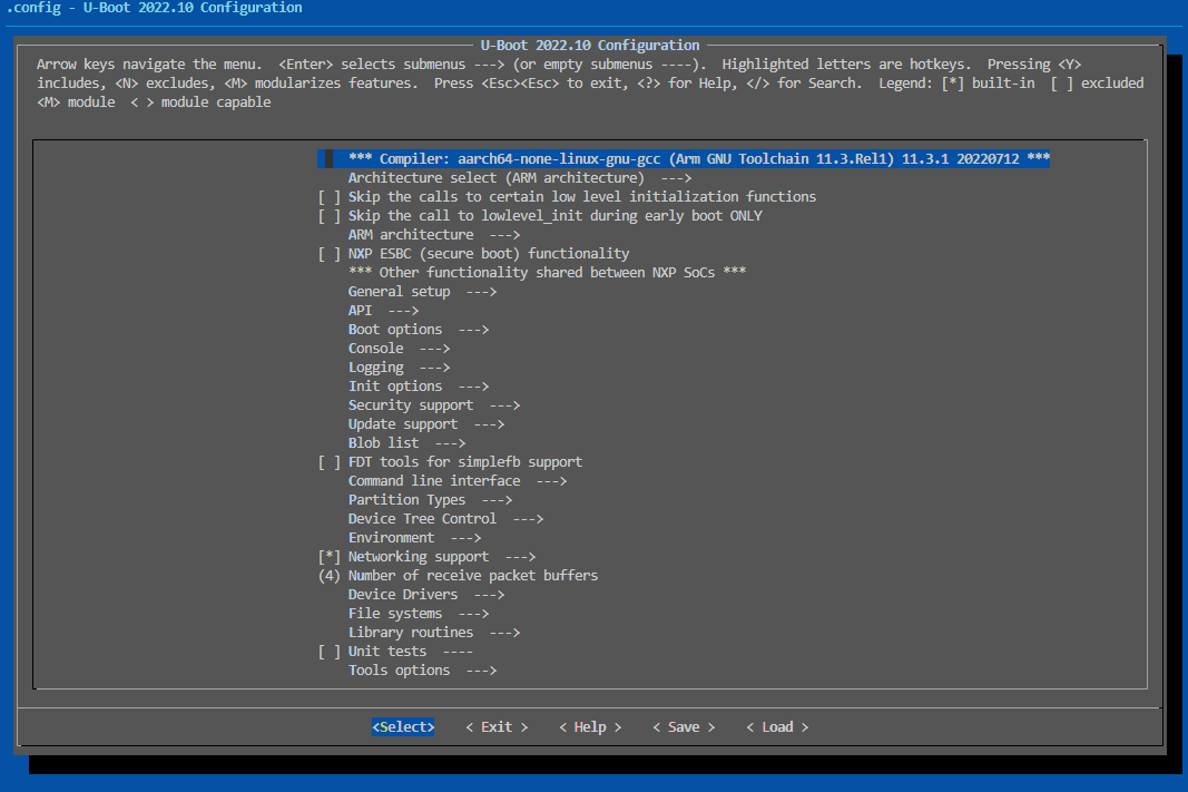

U-Boot is the bootloader in embedded devices, primarily responsible for device initialization, kernel loading, and hardware initialization. The main objective of U-Boot trimming is to streamline its codebase by removing modules and functionalities unrelated to the target hardware platform.
In this platform, the U-Boot configuration file is uboot/configs/hobot_x5_soc_defconfig. Use the following command to configure U-Boot options:
./bd.sh uboot menuconfig
This command automatically uses the U-Boot configuration file defined in the board-level configuration. After configuration, it automatically performs savedefconfig and saves the changes. For detailed instructions, refer to the Configuring U-Boot Option Parameters section.
Upon successful execution, this command opens the U-Boot graphical configuration interface, where you can interactively configure options:
uboot_config
In this interface, you can disable unnecessary features or commands based on requirements to reduce the U-Boot image size.

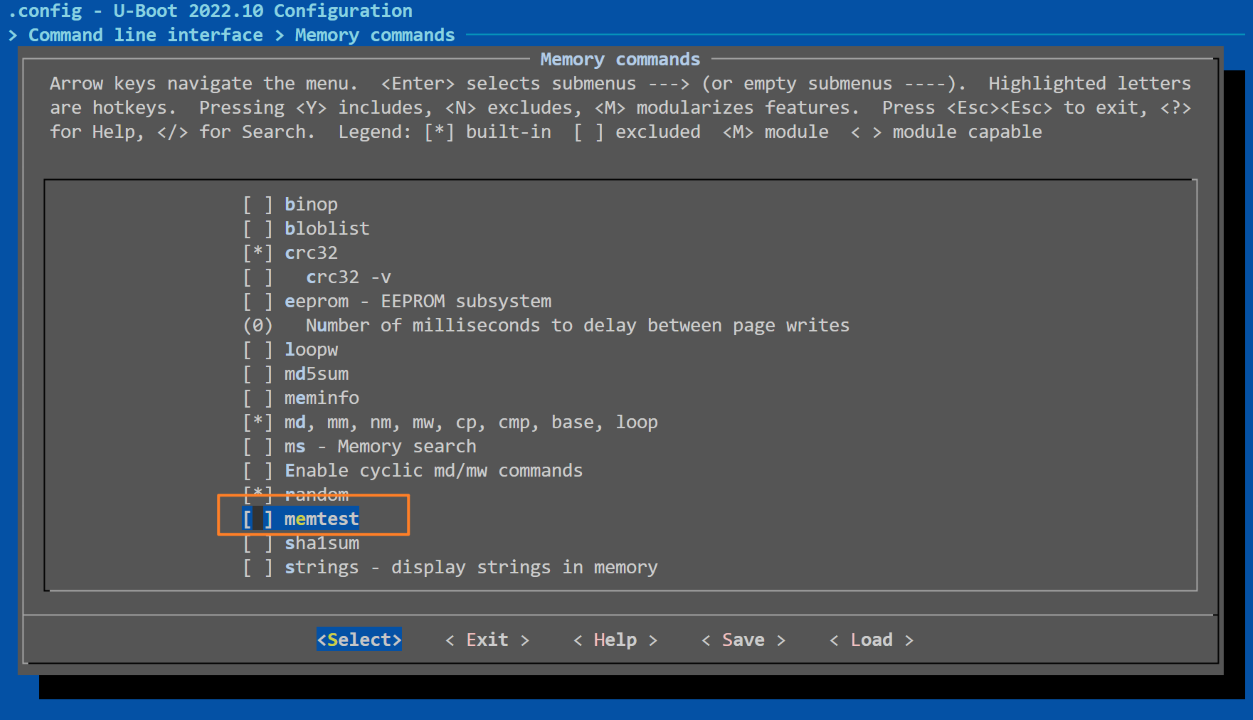

  • Disable unnecessary commands
    For example, if the memtest command is not needed, it can be disabled by unchecking it in the menuconfig interface:
    memtest_cmd

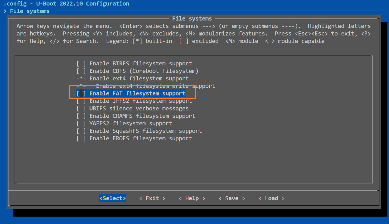

  • Disable filesystem support
    If certain filesystems (e.g., FAT, ext4) are not required, their support can be disabled by unselecting related options. For example, to disable FAT filesystem support:

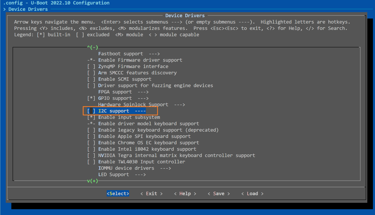

  • Disable unnecessary hardware drivers
    If I2C device support is not needed, disable the I2C driver by unchecking I2C support in the menuconfig interface:
    I2C_CONFIG

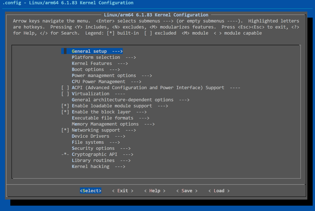

Similar to the U-Boot configuration process, this platform provides a command for configuring kernel options:
./bd.sh boot menuconfig
For detailed explanation of this command, refer to the Configuring Kernel Option Parameters section. Upon successful execution, the command opens the kernel’s graphical configuration interface, allowing interactive configuration and removal of unnecessary modules:
kernel_config
The process of removing unnecessary features or drivers in the Linux kernel menuconfig interface is similar to that of U-Boot. The key to kernel trimming lies in accurately identifying removable components without affecting system functionality. After completing the settings in the menuconfig interface, select Exit, and choose Yes when prompted to save changes to the .config file (on this platform, typically kernel/arch/arm64/configs/hobot_x5_soc_defconfig).

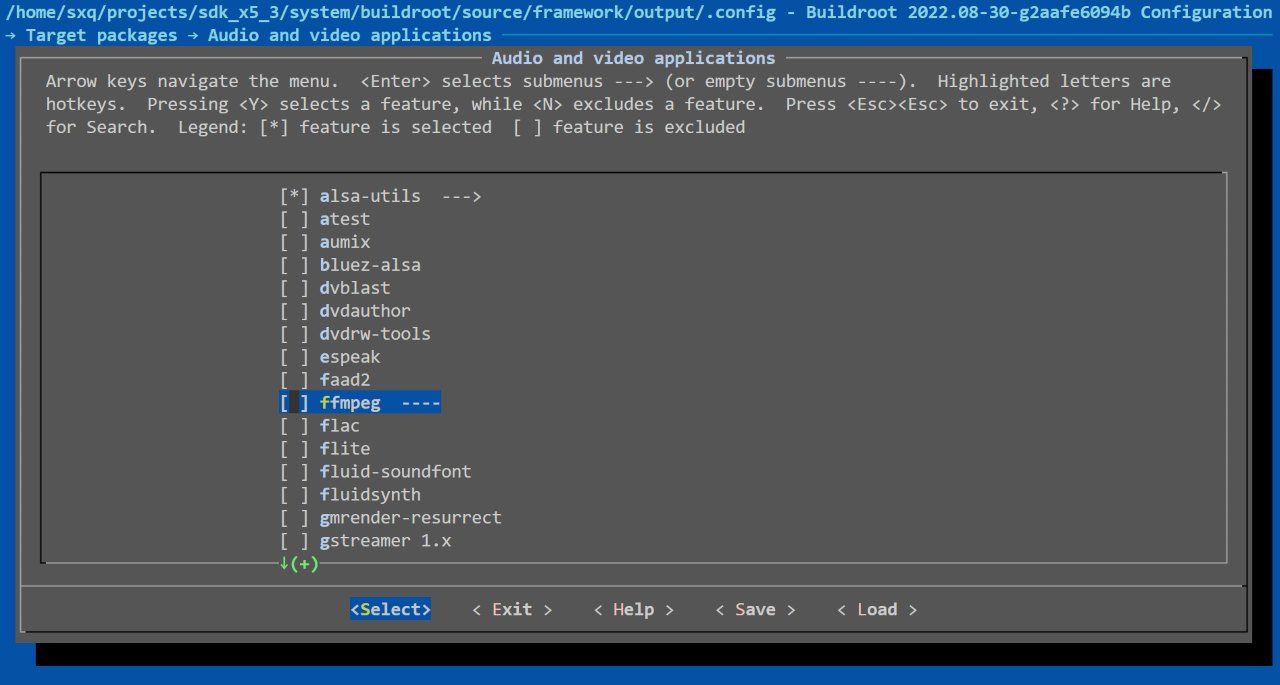

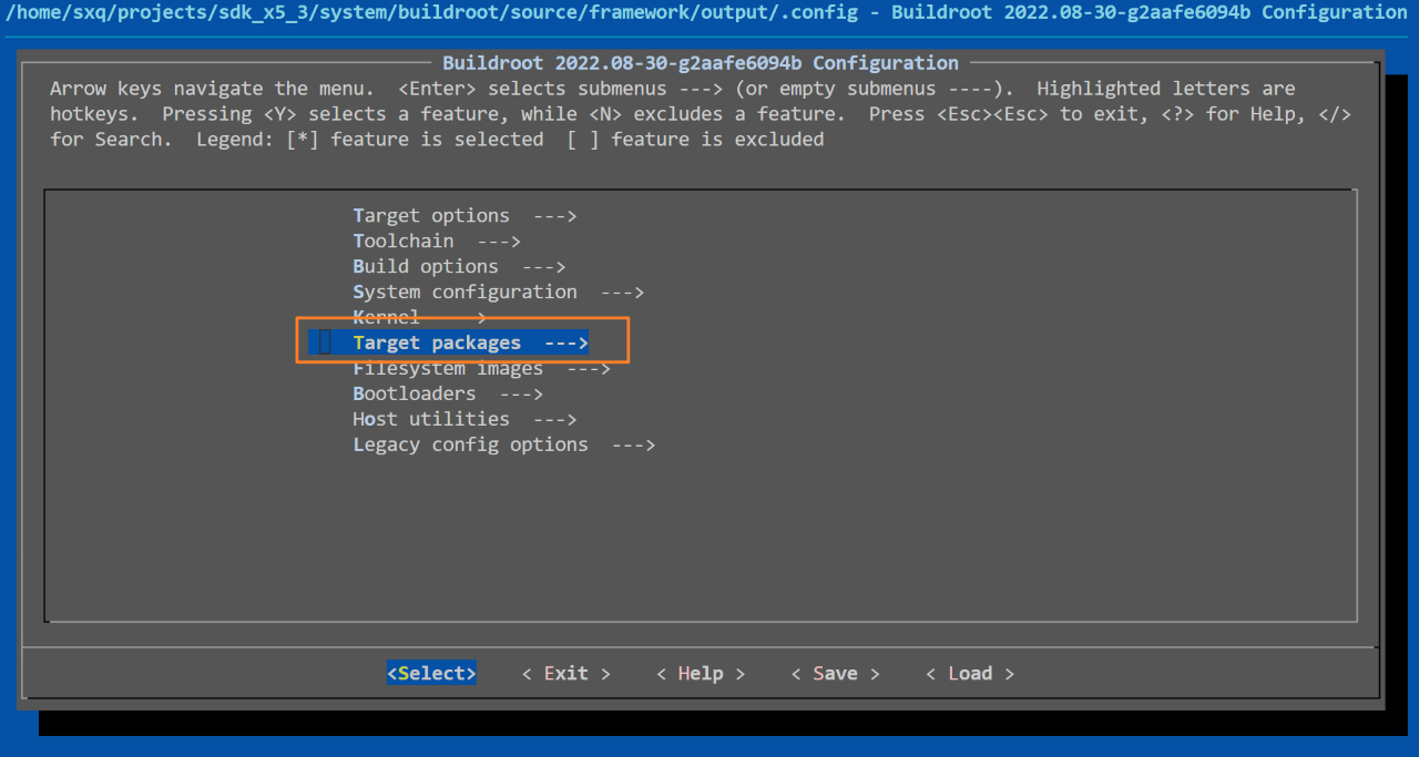

Run the following command in the system/buildroot/source directory to remove unnecessary applications and libraries:
./build.sh menuconfig x5_system_defconfig
Enter the menuconfig interface for configuration:
buildroot_packages
All application packages in the root filesystem are located under the target packages directory and can be modified as needed. For example, to disable the ffmpeg package, simply uncheck the ffmpeg option in this menu:
buildroot_ffmpeg
After completing configuration in the menuconfig interface, select Exit and choose Yes to save changes to the .config file (on this platform: system/buildroot/source/configs/x5_system_defconfig).

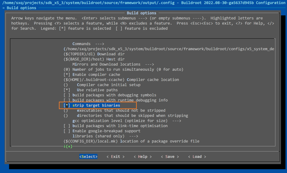

Additionally, strip removes symbol and debug information from binaries and libraries, significantly reducing space usage. This platform enables the Buildroot strip option by default:
buildroot_strip
This setting uses the strip command to remove debug symbols from binaries and libraries in the target filesystem, saving space. Debug symbols are needed for local debugging but not for remote debugging.

Removing support for certain boot devices (e.g., SD card boot) during U-Boot trimming may prevent the system from booting. Retain necessary hardware support and boot functions during trimming.
