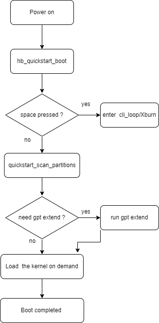

U-Boot is a bootloader that runs after the CPU powers on and before the operating system kernel starts. It performs required hardware initialization and image loading, then hands control to the Linux kernel. This optimization focuses on shortening the boot chain and removing components and features that are not required on the target platform, improving boot efficiency while maintaining reliability.
U-Boot Quickstart Boot Flow Diagram
Block Diagram
Key Boot Chain Changes
  • Default Quickstart boot path: board stage-2 initialization is completed in hb_quickstart_board_init_r.
  • Flashing and serial port: flashing tools rely on serial interaction. U-Boot keeps an interruptible wait window, configurable via CONFIG_QUICKSTART_ABORT_DELAY_MS.
  • Environment variable policy: env_get / env_set take effect in memory only and are not written back to eMMC, reducing storage writes and access.

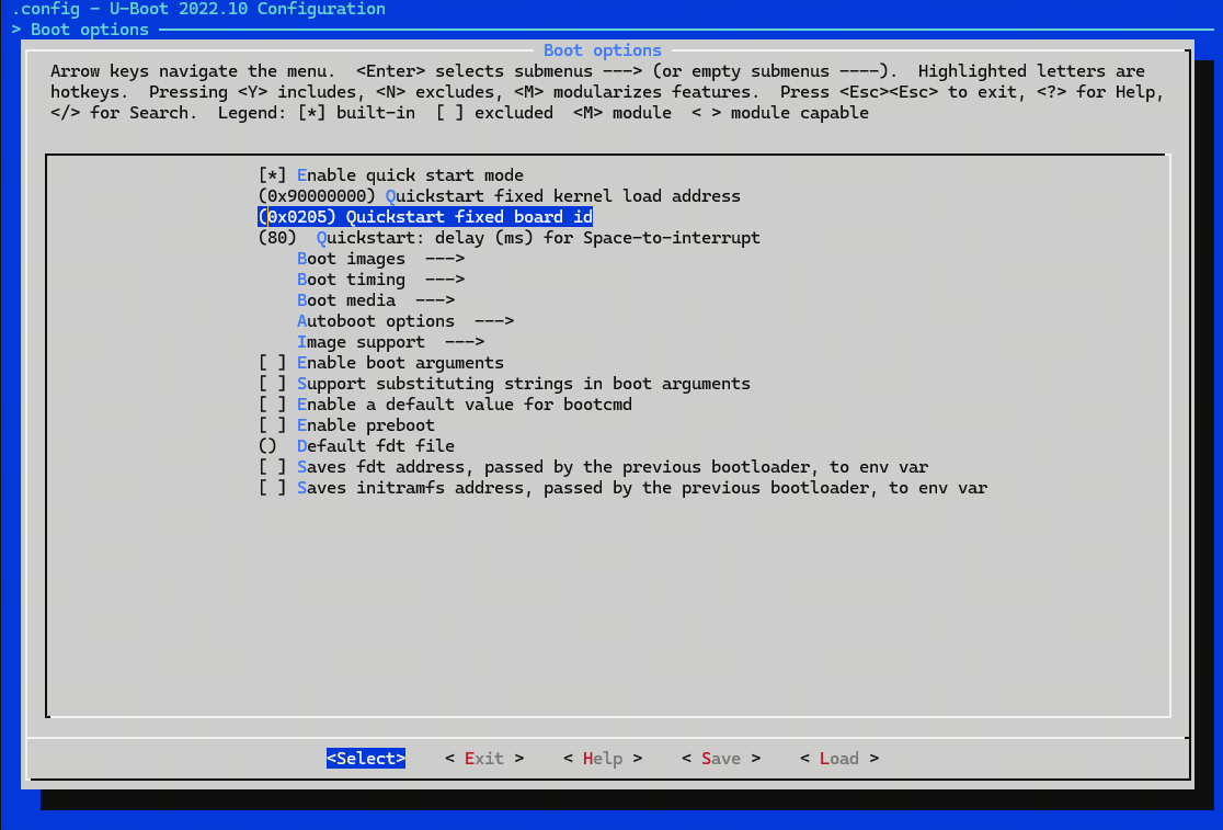

CONFIG_QUICKSTART y Enable Quickstart
CONFIG_QUICKSTART_KERNEL_ADDR 0x90000000 Load address of the FIT image in memory
CONFIG_QUICKSTART_BOARD_ID 0x0205 Hardware board ID
CONFIG_QUICKSTART_ABORT_DELAY_MS 80 Interruptible wait time retained in the U-Boot stage

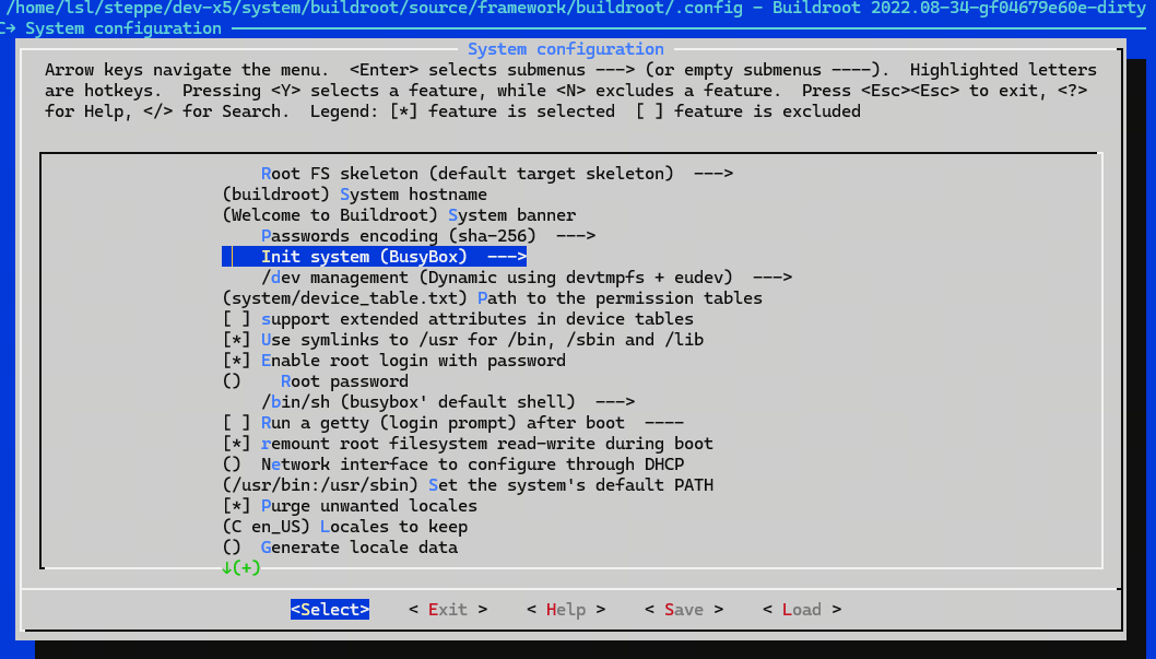

Lightweight init
Enable BusyBox init to reduce the resource and time overhead of the init framework. Configure it in the menuconfig UI:

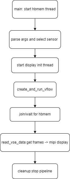

single_pipe_vin_isp_vse_quickstart_display is a quick display sample for validating single-pipeline video capture and display.
Caution: This sample is validated only with the SC230AI sensor module. Other sensor models have not been verified. Do not use this program with sensors other than SC230AI.
Code Location and Directory Structure
  • Code location: app/samples/platform_samples/sample_pipeline/single_pipe_vin_isp_vse_quickstart_display.c
  • Directory structure:
├── Makefile
├── single_pipe_vin_isp_vse_quickstart_display
├── single_pipe_vin_isp_vse_quickstart_display.c
├── vp_display.c
└── vp_display.h
Display Application Startup Flow
App startup flow
Overall, display application optimization focuses on parallel threads (hbmem_open_worker / display_init_worker) and reducing preparation time before the cached probe path create_and_run_vflow, to accelerate startup.
Running the Application
source /etc/profile.d/environment.sh
/app/platform_samples/sample_pipeline/single_pipe_vin_isp_vse_quickstart_display/single_pipe_vin_isp_vse_quickstart_display -s 3
