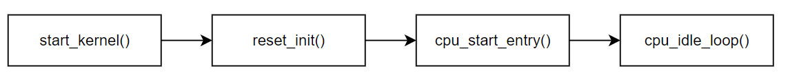

In the final stage of Linux kernel startup, the start_kernel() function calls reset_init() to create the first process—the idle process with pid=0. This process runs in kernel mode and is the only one not created via fork() or kernel_thread(). Through a series of calls, it eventually enters cpu_idle_loop(), where two critical processes are spawned:
  • init process: The ancestor of all user-space processes, responsible for managing and spawning user-space processes.
  • kthreadd process: The ancestor of all kernel threads, responsible for kernel thread management.
The code analysis below clearly shows that pid=0 is the ancestor of all processes and threads, while the init and kthreadd processes handle different responsibilities.
