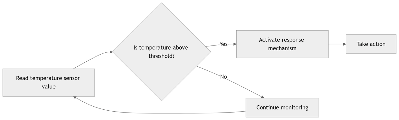

Principle of Thermal System Functionality
The core principle of the Thermal system is to read temperature sensor values from the hardware system and compare them with predefined temperature thresholds. When the temperature reaches a certain critical value, the system initiates response mechanisms to prevent hardware overheating.
The functional principle of the Thermal system is illustrated in the figure below:
thermal_function_principle
Operation of the Thermal System
The operation of the Thermal system typically consists of the following steps:
  1. Temperature Acquisition: Real-time temperature data is obtained via hardware temperature sensors. These sensors can be built-in sensors within the processor or external thermocouples or thermistors.
  2. Threshold Setting: The kernel or user-space applications define safe temperature ranges and corresponding response measures. These usually include high-temperature thresholds (Critical) and moderate-temperature thresholds (Warning).
  3. Response Strategy: When the temperature exceeds the preset threshold, the system activates the corresponding strategy. Responses may include:
    • Reducing frequency
    • Increasing fan speed
    • Shutting down unnecessary hardware or services
    • Triggering thermal protection (e.g., system shutdown)
  4. Temperature Adjustment: After adjustments based on the strategy, the system continues monitoring temperature changes and repeats the above process.

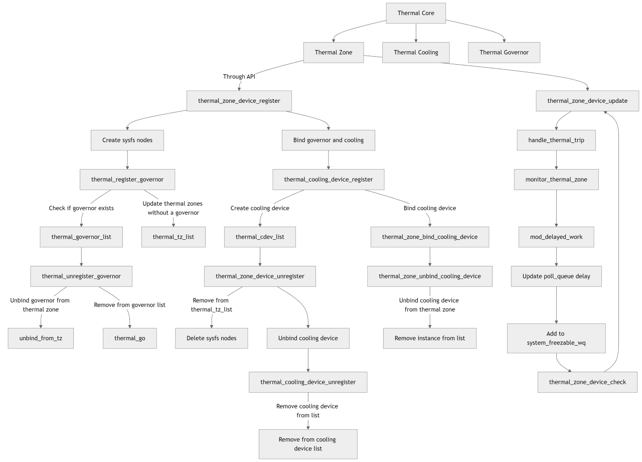

4.3.14.4. Functions and Usage of the Thermal System

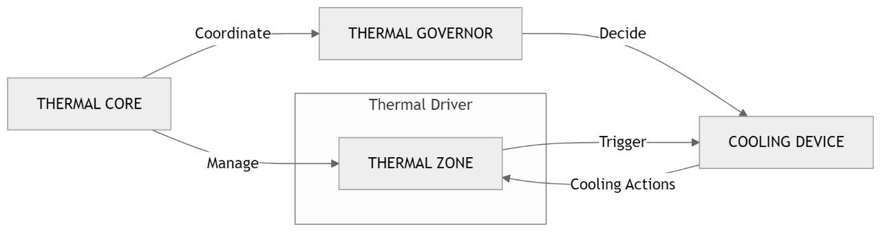

Linux Thermal is a module related to temperature control in Linux systems, primarily used to control heat generated by chips during system operation, keeping chip and device casing temperatures within a safe and comfortable range.
The entire Thermal framework can be divided into four parts:
  • Thermal Driver: Responsible for acquiring temperature devices and registering them as struct thermal_zone_device. A Thermal Zone Device is essentially an abstraction of the temperature-measuring device. There are two thermal zones in this board-level system: thermal_zone0 and thermal_zone1.
  • Thermal Governor: Responsible for determining how to control temperature, registered as struct thermal_governor, such as Step Wise, User space, etc. The Thermal Governor is essentially a temperature control policy.
  • Thermal Cooling: Responsible for managing temperature-controlling devices, registered as struct thermal_cooling_device. These are the actual devices requiring cooling. There are four cooling devices on the board-level system:
    • cooling_device0: cpu
    • cooling_device1: bpu
    • cooling_device2: gpu
    • cooling_device3: ddr Among them, the DDR cooling device is associated with thermal_zone0, while CPU/BPU/GPU cooling devices are associated with thermal_zone1.
  • Thermal Core: Responsible for integrating governor, cooling device, zone device, and other components, while providing common functionalities such as sysfs nodes in user space. Thermal Core is the core of the thermal system.
Information and control states of the above modules can be accessed under the /sys/class/thermal directory.
The workflow of Thermal involves acquiring temperature via the Thermal Driver, making decisions via the Thermal Governor, and finally executing temperature control via the Thermal Cooling. The relationship between these modules can be described in the figure below:
thermal_kernel_framwork

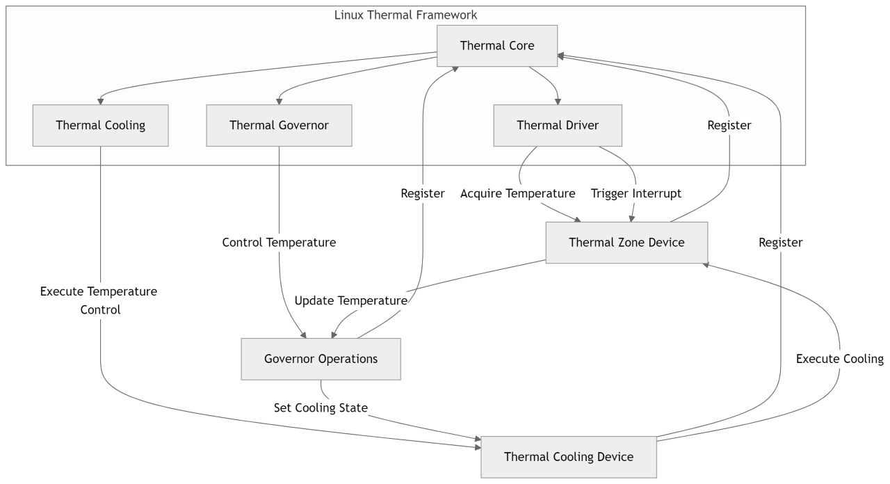

After incorporating device components, the relationship between the Thermal framework and device components, along with the data processing flow during temperature changes, is shown below:

Key Function Interfaces of Thermal Subsystem
The Thermal core acts as a coordinator among Thermal Zones, Thermal Cooling devices, and Thermal Governors, providing unified APIs to interconnect them and achieve temperature control.
Specifically, the Thermal core operates as follows:
  1. Obtain temperature from Thermal Zone: First, retrieve the current temperature value from the Thermal Zone device.
  2. Select the appropriate Thermal Governor: Based on the temperature, select a suitable Thermal Governor to manage the thermal control policy.
  3. Control Thermal Cooling devices: Adjust the states of Thermal Cooling devices according to the settings of the Thermal Governor to regulate temperature.
Device Registration and Unregistration:
  • Register Thermal Zone Device: Call thermal_zone_device_register() to register a thermal zone device, create a series of sysfs nodes, and bind it with the corresponding governor and cooling devices.
  • Unregister Thermal Zone Device: thermal_zone_device_unregister() performs the reverse operation—removing the thermal zone device, unbinding it from cooling devices, and deleting the corresponding sysfs nodes.
Cooling Device Management:
  • Register Cooling Device: Use thermal_cooling_device_register() to create a cooling device, add it to the thermal_cdev_list, and create relevant sysfs nodes. At this point, the cooling device is bound to thermal zone devices.
  • Unregister Cooling Device: thermal_cooling_device_unregister() performs the reverse operation—unbinding the cooling device from thermal zones and removing associated sysfs nodes.
Governor Management:
  • Register Thermal Governor: thermal_register_governor() first checks whether a governor with the same name already exists in thermal_governor_list. If not, it adds the new governor to the list and updates the thermal_tz_list for any thermal zones that have no assigned governor.
  • Unregister Thermal Governor: thermal_unregister_governor() unbinds the specified governor from its associated thermal zones, calls unbind_from_tz() to clear related data, and finally removes the governor from the thermal_governor_list.
Binding and Unbinding Devices:
  • Bind Cooling Device to Thermal Zone: thermal_zone_bind_cooling_device() creates a thermal_instance device to bind a Thermal Zone with a Thermal Cooling device, enabling temperature-based control of the cooling device.
  • Unbind Cooling Device: thermal_zone_unbind_cooling_device() removes the bound thermal_instance from both linked lists, thereby breaking the binding relationship.
Temperature Update and Handling:
  • Update Thermal Zone Temperature: thermal_zone_device_update() is typically triggered by a thermal driver, either via polling or interrupt, to update the current temperature. Based on temperature changes, it invokes handle_thermal_trip() for appropriate handling.
Monitoring and Delayed Processing:
  • Monitor Thermal Zone: monitor_thermal_zone() determines whether to start the thermal_zone_device->poll_queue delayed work item based on passive or polling settings.
  • Polling Process: The entire polling process is triggered by thermal_zone_device_update(), with the following steps:
    1. In handle_thermal_trip(), call monitor_thermal_zone().
    2. In monitor_thermal_zone(), call mod_delayed_work() to update the delay value of poll_queue. If the thermal zone has multiple trip points, the delay may be updated multiple times.
    3. Once poll_queue is queued into system_freezable_wq, after the specified delay, thermal_zone_device_check() is called, which in turn calls thermal_zone_device_update() to complete periodic updates and processing.
The above process can be illustrated in the following diagram:
thermal_api

				struct thermal_governor *new_gov)
Parameters:
  • tz: Pointer to the thermal zone device.
  • new_gov: The new thermal governor.
Logic:
  • If the thermal zone already has a bound governor, first call its unbind_from_tz method to unbind.
  • If the new governor exists and has a bind_to_tz method, attempt to bind it to the thermal zone.
  • If binding fails, try to revert to the previous governor.
  • Finally, update the thermal zone’s governor pointer.
Return Value:
  • Returns 0 on success; returns an error code if binding the new governor fails.
thermal_register_governor Function
Function:
Register a new thermal governor.
Function Prototype:
int thermal_register_governor(struct thermal_governor *governor)
Parameters:
  • governor: The thermal governor to register.
Logic:
  • Check whether the governor already exists.
  • If not, add it to the governor list and set it as the default governor if applicable.
  • Traverse all thermal zones and attempt to apply the new governor to each.
Return Value:
  • Returns 0 on success; returns an error code on failure.
thermal_unregister_governor Function
Function:
Unregister a thermal governor.
Function Prototype:
void thermal_unregister_governor(struct thermal_governor *governor)
Parameters:
  • governor: The thermal governor to unregister.
Logic:
  • Remove the specified governor from the governor list.
  • Traverse all thermal zones and revert any zones using this governor back to the default governor.
update_temperature Function
Function:
Update the temperature of the thermal zone device.
Function Prototype:
static void update_temperature(struct thermal_zone_device *tz)
Parameters:
Logic:
  • Call thermal_zone_get_temp to read the temperature.
  • Update the temperature value of the thermal zone device.
  • If the temperature is valid, trigger corresponding notifications.
thermal_zone_device_update Function
Function:
Update the state of the thermal zone device.
Function Prototype:
void thermal_zone_device_update(struct thermal_zone_device *tz,
				enum thermal_notify_event event)
Parameters:
  • event: Type of event triggering the update.
Logic:
  • Check if the system is suspended; if so, return immediately.
  • Update the temperature.
  • Handle all trip points.
  • Adjust polling frequency as needed.
thermal_zone_device_check Function
Function:
Callback function for the work queue, used to check and update the state of the thermal zone device.
Function Prototype:
static void thermal_zone_device_check(struct work_struct *work)
Parameters:
  • work: Pointer to the work structure.
Logic:
  • Call thermal_zone_device_update to update the state of the thermal zone device.
thermal_zone_bind_cooling_device Function
Function:
Bind a cooling device to a specific trip point of a thermal zone device.
Function Prototype:
int thermal_zone_bind_cooling_device(struct thermal_zone_device *tz,
				     int trip,
				     struct thermal_cooling_device *cdev,
				     unsigned long upper, unsigned long lower,
				     unsigned int weight)
Parameters:
  • tz: Thermal zone device.
  • trip: Index of the trip point.
  • cdev: Cooling device.
  • upper: Maximum cooling state.
  • lower: Minimum cooling state.
  • weight: Weight of the cooling device.
Logic:
  • Validate input parameters.
  • Create a new thermal_instance structure to represent the binding between the cooling device and the thermal zone.
  • Update the sysfs interface to reflect the new binding.
Return Value:
thermal_zone_unbind_cooling_device Function
Function:
Unbind a cooling device from a thermal zone device.
Function Prototype:
int thermal_zone_unbind_cooling_device(struct thermal_zone_device *tz,
				       int trip,
				       struct thermal_cooling_device *cdev)
Parameters:
Logic:
  • Locate the corresponding thermal_instance structure and remove it from the list.
  • Update the sysfs interface to reflect the unbinding.
Return Value:
thermal_cooling_device_unregister Function
Function:
Unregister a cooling device.
Function Prototype:
void thermal_cooling_device_unregister(struct thermal_cooling_device *cdev)
Parameters:
  • cdev: The cooling device to unregister.
Logic:
  • Remove the specified cooling device from the cooling device list.
  • Unbind it from all associated thermal zones.
bind_tz Function
Function:
Bind a cooling device to a thermal zone.
Function Prototype:
static void bind_tz(struct thermal_zone_device *tz)
Parameters:
Logic:
  • Iterate through all cooling devices and attempt to bind each to the thermal zone.
thermal_zone_device_register_with_trips Function
Function:
Create and register a new thermal zone device with specified trip point information.
Function Prototype:
thermal_zone_device_register_with_trips(const char *type, struct thermal_trip *trips, int num_trips, int mask,
					void *devdata, struct thermal_zone_device_ops *ops,
					struct thermal_zone_params *tzp, int passive_delay,
					int polling_delay)
Parameters:
  • type: Name of the thermal zone.
  • trips: Array of trip points.
  • num_trips: Number of trip points.
  • mask: Bitmask of trip points.
  • devdata: Private data.
  • ops: Operations for the thermal zone device.
  • tzp: Parameters for the thermal zone.
  • passive_delay: Delay for passive cooling.
  • polling_delay: Polling interval.- ops: Thermal zone operation interface.
  • tzp: Thermal zone parameters.
  • passive_delay: Passive cooling delay.
  • polling_delay: Polling delay.
Logic:
  • Initialize the thermal zone device.
  • Register the device to sysfs.
  • Bind cooling devices.
  • Set polling and delays.
Return value:
  • Returns a pointer to the thermal zone device on success, or an error pointer on failure.
thermal_zone_device_unregister function
Function:
Unregister a thermal zone device.
Function prototype:
void thermal_zone_device_unregister(struct thermal_zone_device *tz)
Parameters:
Logic:
  • Remove the thermal zone from the thermal zone list.
  • Unbind all cooling devices.
  • Unregister the device.
thermal_init function
Function:
Initialize the thermal management framework.
Function prototype:
static int __init thermal_init(void)
Logic:
  • Register thermal governor.
  • Register thermal class.
  • Register PM notifier.
Return value:
  • Returns 0 on success, or an error code on failure.
