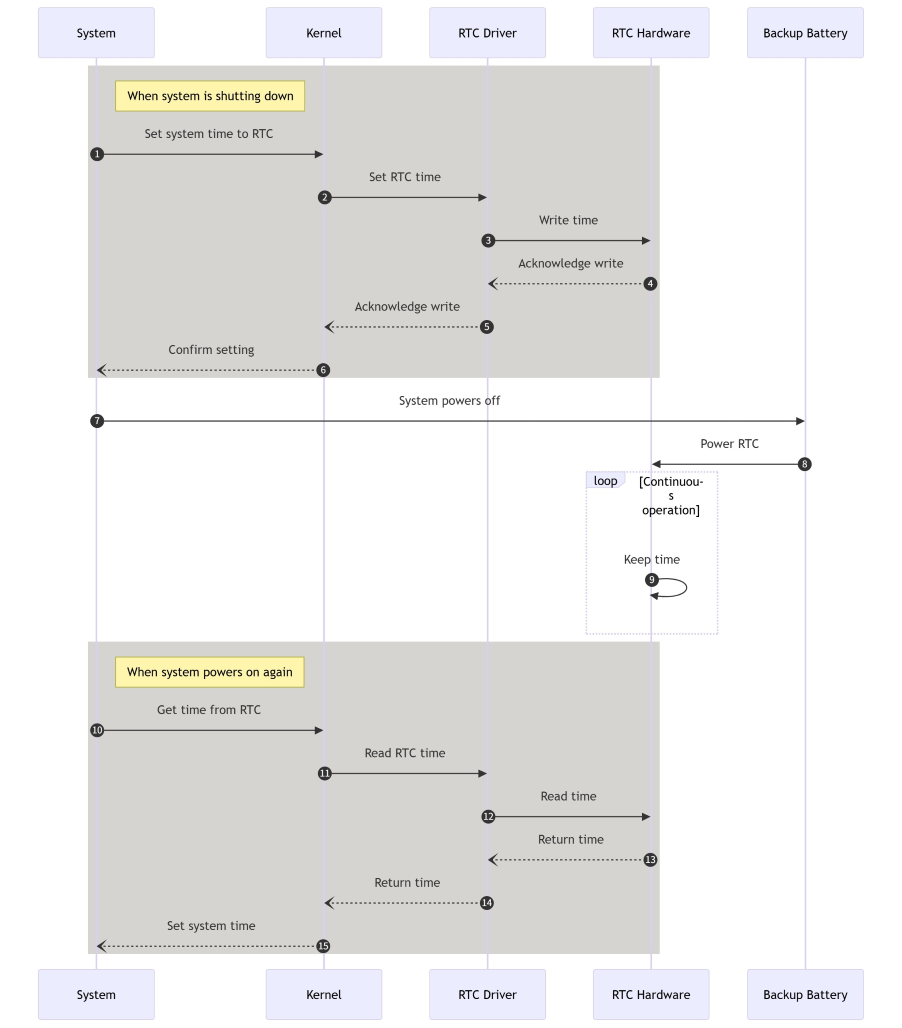

RTC Time Retention
Linux system time is lost when the system shuts down, whereas the RTC can continue operating using an external battery after system shutdown, preserving the time. The system can then restore the time from the RTC upon next boot. The process is as follows:
Detailed process explanation:
  1. During System Shutdown:
    • Before shutdown, the system sets the current system time into the RTC.
    • The kernel writes the time to the RTC hardware via the RTC driver.
    • The RTC hardware confirms successful time write.
    • The RTC driver returns confirmation to the kernel.
    • The kernel returns confirmation to the system.
  2. After System Shutdown:
    • After shutdown, the backup battery begins powering the RTC hardware.
    • The RTC hardware continues to run and count time under backup battery power.
  3. On Next System Power-On:
    • Upon reboot, the system retrieves time from the RTC hardware via the kernel.
    • The kernel reads the time from the RTC hardware via the RTC driver.
    • The RTC hardware returns the current time to the RTC driver.
    • The RTC driver returns the time to the kernel.
    • The kernel sets the time as the system time.

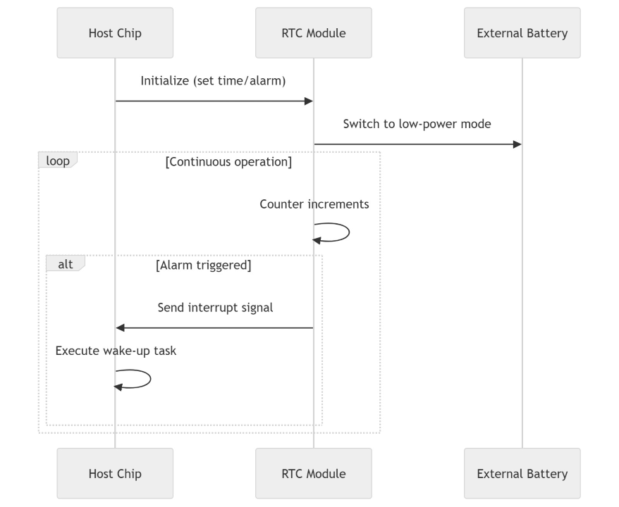

RTC Periodic Wake-up
A typical application of the RTC is periodic system wake-up. The process is as follows:
Process explanation:
  1. Initialization Phase: The main controller first initializes communication with the RTC module, setting the current time and alarm (time reminder). This step typically occurs after system power-on, where the main controller configures time and alarm parameters via communication with the RTC module.
  2. Switch to Low-Power Mode: After initialization, the RTC module switches to low-power mode, relying on an external battery to continuously maintain time and alarm information. The external battery provides necessary power to ensure the RTC module remains operational even when the main controller is off or in low-power state.
  3. Continuous Operation Phase (Loop): The RTC module enters a loop mode, continuously counting (incrementing counter). This process is low-power, and the RTC module periodically updates its internal counter.
  4. Alarm Trigger Event: At a specific time point, when the RTC module’s alarm condition is met, it sends an interrupt signal to the main controller, notifying it that the set time has been reached. Upon receiving the interrupt signal, the main controller executes predefined wake-up tasks, such as waking up the system, processing specific tasks, or performing specific functions.

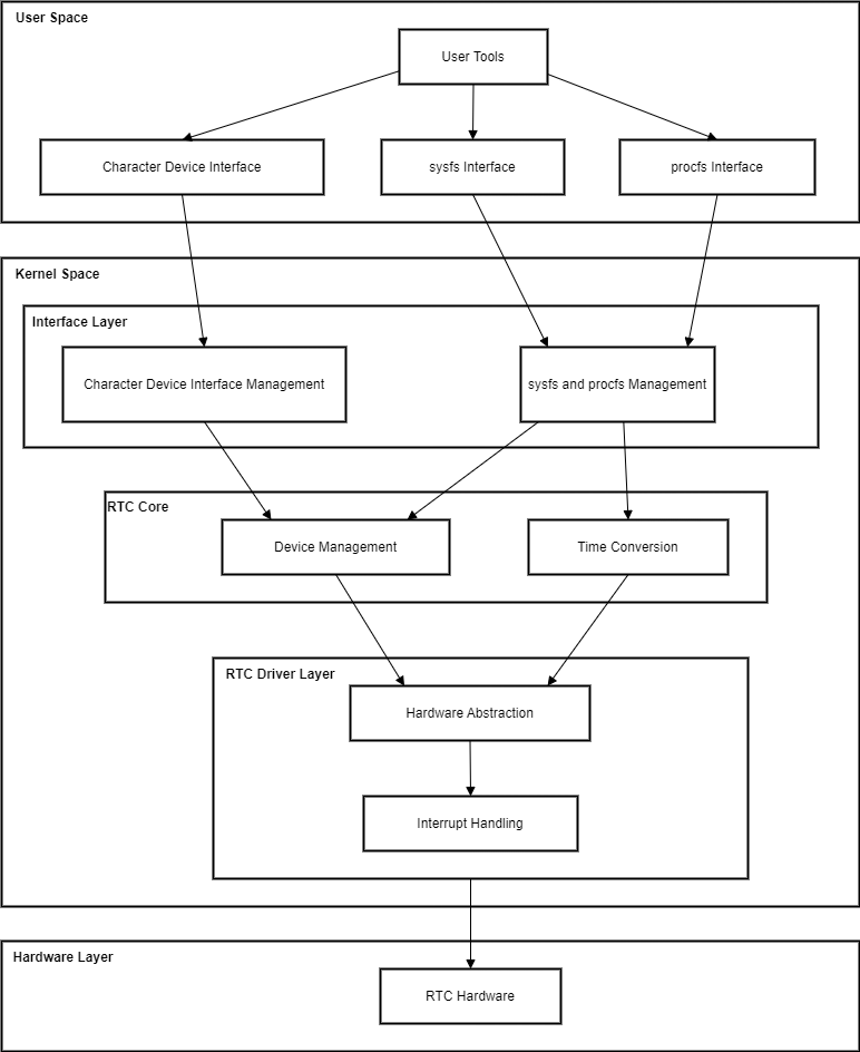

Linux RTC Driver Framework
In Linux, the RTC device driver is a standard character device driver. The Linux RTC driver framework can be abstracted into the following main components:
  1. User Space: At the top layer, includes user tools and interfaces to kernel space.
  2. Kernel Space: In the middle layer, divided into three parts:
    • Interface Layer: Directly interacts with user space.
    • RTC Core: Core module managing RTC devices.
    • RTC Driver Layer: Directly interacts with the hardware layer.
  3. Hardware Layer: At the bottom layer, representing the actual RTC hardware devices.
The Linux RTC driver framework is illustrated in the figure below:
Each layer is described below.
RTC User Space (User Space):
User space interacts with RTC devices primarily through the following methods:
  • User Tools:
    • hwclock: Hardware clock operation tool.
    • date: System time operation tool.
    • Test tools: e.g., rtctest.c, used to test the RTC driver’s ioctl interface.
  • Character Device Interface:
    • /dev/rtcN: Character device node supporting open, read, write, and ioctl operations.
  • sysfs Interface:
    • /sys/class/rtc/rtcN: Provides read-only attributes such as time and alarm, allowing user space to access certain RTC device properties.
  • procfs Interface:
    • /proc/driver/rtc: Provides information about the system clock RTC. If the system lacks a dedicated RTC, it defaults to using rtc0.
RTC Kernel Space (Kernel Space):
The various modules in kernel space are responsible for RTC driver management, device registration, and interaction with user space:
  • Interface Layer (Interface Layer):
    • Manages character device interface.
    • Manages sysfs and procfs attributes.
  • RTC Core (Core Layer):
    • Device Management:
      • Device Registration and Unregistration: Uses register and unregister functions to register and unregister RTC devices.
      • Character Device Abstraction: Uses dev.c to abstract RTC devices as generic character devices, providing file operation functions.
      • sysfs and procfs Management: Uses sysfs.c and proc.c to manage RTC device sysfs and procfs attributes.
    • Time Conversion: Uses lib.c to provide conversion between RTC time and system time.
  • RTC Driver Layer (Driver Layer):
    • Hardware Abstraction:
      • Operation Function Set: Defined via the rtc_class_ops structure, provides low-level operations on RTC hardware, such as reading/writing time, reading/setting alarms, etc.
      • Hardware Initialization: Initializes RTC hardware, configures clock sources, interrupts, etc.
      • Interrupt Handling: Handles interrupts generated by the RTC, such as alarm and periodic interrupts.
  • Data Structures:
    • struct rtc_device: Describes the RTC device.
    • struct rtc_class_ops: Defines low-level operation functions.
RTC Hardware Layer (Hardware Layer):
  • RTC Hardware:
    • Hardware clock chip (e.g., PCF8563)
    • Crystal oscillator
    • External battery

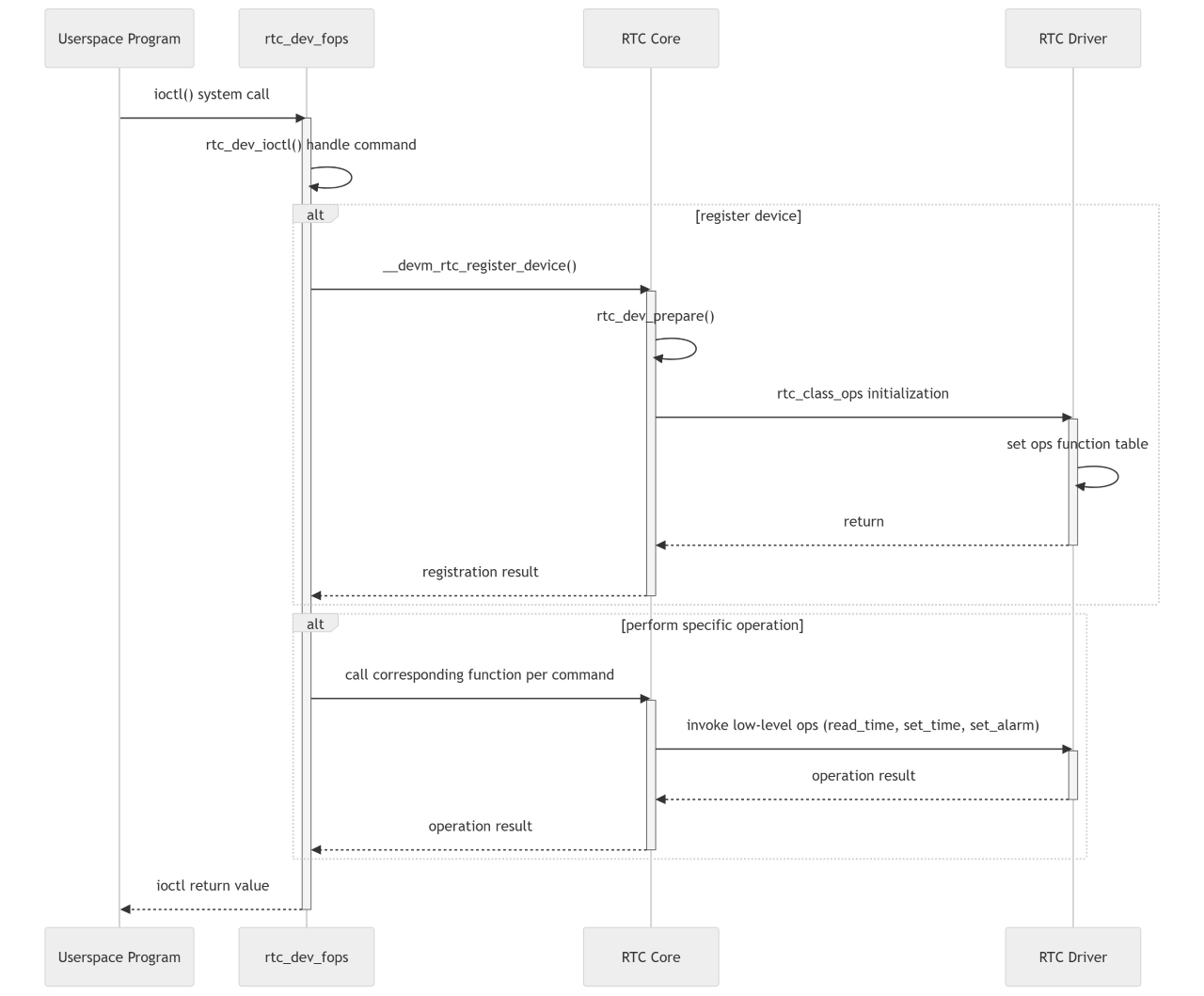

When applications use the ioctl function to perform operations such as setting/reading time or configuring alarms, the rtc_dev_ioctl function is invoked. Ultimately, rtc_dev_ioctl calls functions like read_time, set_time, etc., from the lower-level operation set rtc_class_ops to perform actual read/write operations on the specific RTC hardware.
Linking the above code together, the sequence diagram for interaction between user-space programs and the RTC device is as follows:
Detailed explanation:
  1. User-Space Program:
    • Initiates an ioctl() system call to request an operation on the RTC device.
  2. RTC User Interface (rtc_dev_fops):
    • Upon receiving the ioctl() call, invokes the rtc_dev_ioctl() function to handle the specific command.
    • The RTC user interface acts as a bridge between user space and the kernel.
  3. RTC Core:
    • If the RTC device is used for the first time, calls __devm_rtc_register_device() to register the device.
    • Calls rtc_dev_prepare() to prepare device resources.
    • Initializes rtc_class_ops and sets up the lower-level operation function set.
    • Based on the command from the user-space program, calls the corresponding lower-level operation functions (e.g., read_time, set_time, set_alarm, etc.).
  4. RTC Driver:
    • Provides the lower-level operation function set (rtc_class_ops) and directly interacts with the RTC hardware.
    • Performs specific hardware operations and returns results to the RTC core.
  5. Return Results:
    • Operation results are returned layer by layer back to the user-space program, which continues execution based on the returned result.
