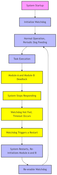

Typical Applications of Watchdog
A watchdog is a mechanism used to monitor the system’s operational status, capable of automatically restarting the system when faults or system hangs occur. In Linux systems, a typical application of the watchdog is to ensure that the system can automatically restart when encountering deadlocks, hangs, or other unrecoverable failures, thereby restoring normal operation.
The figure below illustrates a typical application scenario where the watchdog resets the system from a deadlock state:
watchdog_typical_applications
Specific explanation as follows:
  1. Under normal conditions:
    • The system operates normally, and the watchdog is fed periodically.
    • Tasks complete without deadlocks, and the watchdog timer continues counting without triggering a restart.
  2. After a deadlock occurs:
    • Module A and Module B enter a deadlock, causing the system to become unresponsive.
    • Due to the deadlock, the system cannot complete periodic tasks and thus fails to feed the watchdog in time.
    • The watchdog times out and triggers a restart.
  3. After system restart:
    • The system restarts, initializing Module A and B, eliminating the deadlock.
    • The watchdog begins counting again, continuing to monitor the system status.

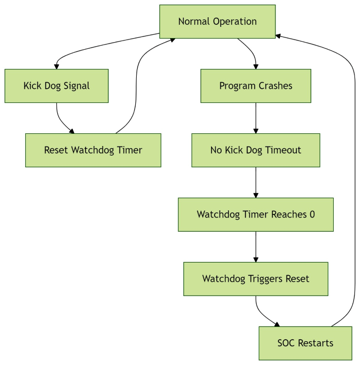

Watchdog Functional Principle
At its core, a watchdog is essentially a timer. It generally has an input referred to as “kicking the dog” or “servicing the dog.” When the SoC is operating normally, it outputs a signal to the watchdog at regular intervals to reset the watchdog timer. If no signal is sent within a specified period (typically when the program runs out of control), the watchdog timer counts down to 0, triggering a timeout event. The watchdog then sends a reset signal to the SoC, causing the system to restart. The purpose of the watchdog is to prevent system crashes caused by runaway programs.
The functional block diagram of the watchdog is shown below:
watchdog_function_diagram_zh_CN

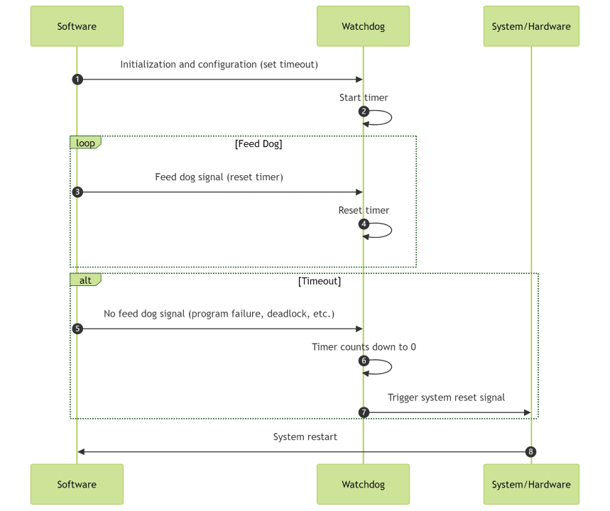

Basic Workflow of Watchdog
The core mechanism of the watchdog operation is “timer timeout” and “reset”:
  • Initialization and Configuration: During system startup, the watchdog is initialized and configured. The system sets the timeout duration (i.e., the countdown cycle of the Watchdog timer), usually set by software, but can also be hard-coded. At this point, the watchdog begins counting.
  • “Feeding the Dog” Mechanism: Under normal conditions, the software program in the system periodically sends a signal to the watchdog, known as a “feed” operation. This is typically achieved by resetting the watchdog timer. For example, software writes a specific value to the watchdog at regular intervals, resetting the countdown process to ensure the watchdog does not time out.
  • Timeout Detection: If the software program fails to perform a “feed” operation for an extended period (e.g., due to a program deadlock, crash, or hang), the watchdog timer counts down to the preset timeout value (usually several seconds to minutes).
  • Post-Timeout Handling: When the timer counts down to 0, the watchdog assumes the system is abnormal and automatically triggers a predefined response, typically a reset operation, restarting the system or hardware modules to restore the system to a normal state.
The above mechanism can be illustrated as follows:
Watchdog_work_flow
