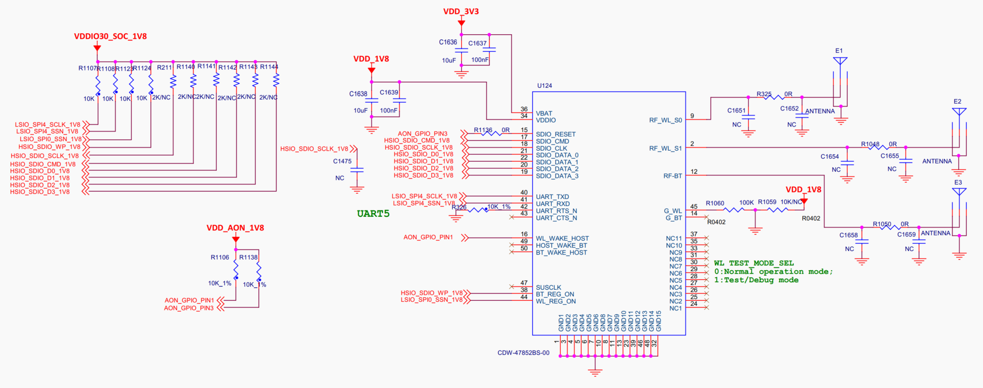

Partial schematics of the X5 RTL8852BS are shown below:
For the RTL8852BS Bluetooth module to operate properly, the hardware must meet the following conditions:
  • Power supply: The module has two power supplies, where VDD_3V3 is the main power supply and VDD_1V8 is the IO pull-up power supply.
  • Enable: For normal operation, a high level must be applied to BT_REG_ON. Currently, the hardware is pulled high at power-on, so no configuration is needed in the device tree.
  • Clock: The 40MHz clock input can be internally generated by the module, so no external signal input is required.
  • Communication: Bluetooth communication is via UART, with UART_TXD and UART_RXD being the two data lines of the UART.
Note:
1. To maintain interface and functional diversity, the EVB does not connect flow control for the Bluetooth UART interface. In product design, it is recommended to connect flow control; otherwise, audio transmission may suffer from stuttering or degraded audio quality.

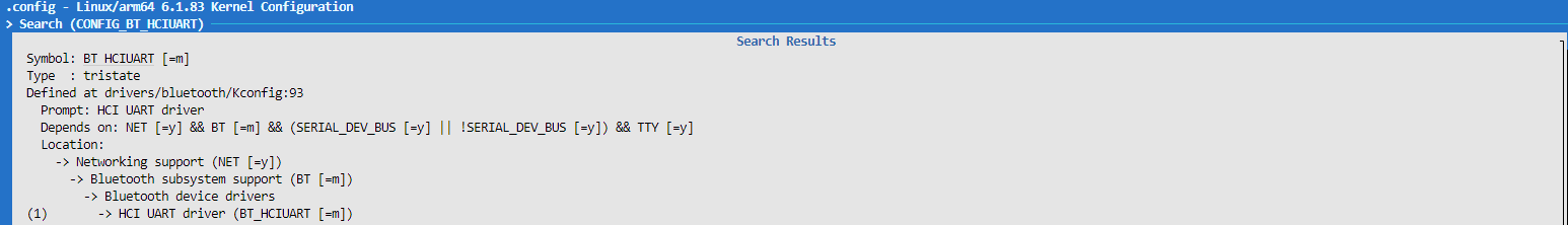

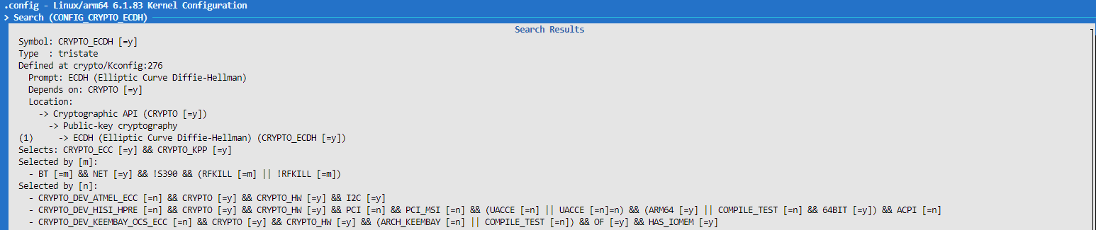

Kernel Configuration

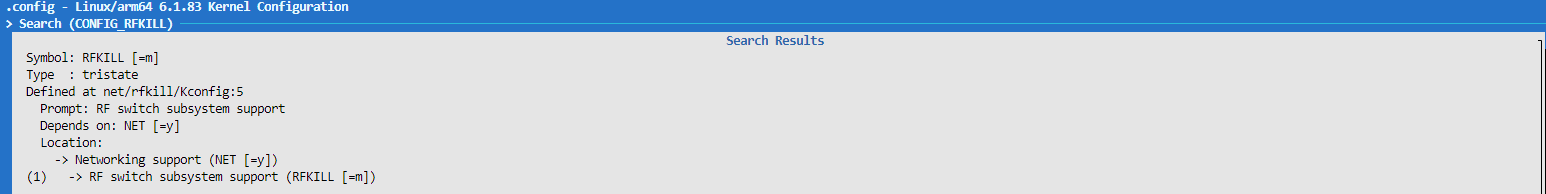

Enter the BSP’s build directory and execute ./xbuild.sh boot menuconfig to configure kernel features.
Configuration Command
Executing ./xbuild.sh boot menuconfig launches a text-based menu interface. Navigate the menu using the arrow keys on the keyboard. Press Enter to enter submenus or modify configuration options. After completing the configuration, select the Save menu item to save your settings.
Configuration Options

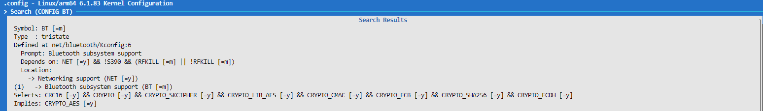

Option 1: Configure kernel option CONFIG_BT=m
Option 2: Configure kernel option CONFIG_CRYPTO_ECDH=y
Option 3: Configure kernel option CONFIG_BT_HCIUART=m
Option 4: Configure kernel option CONFIG_RFKILL=m

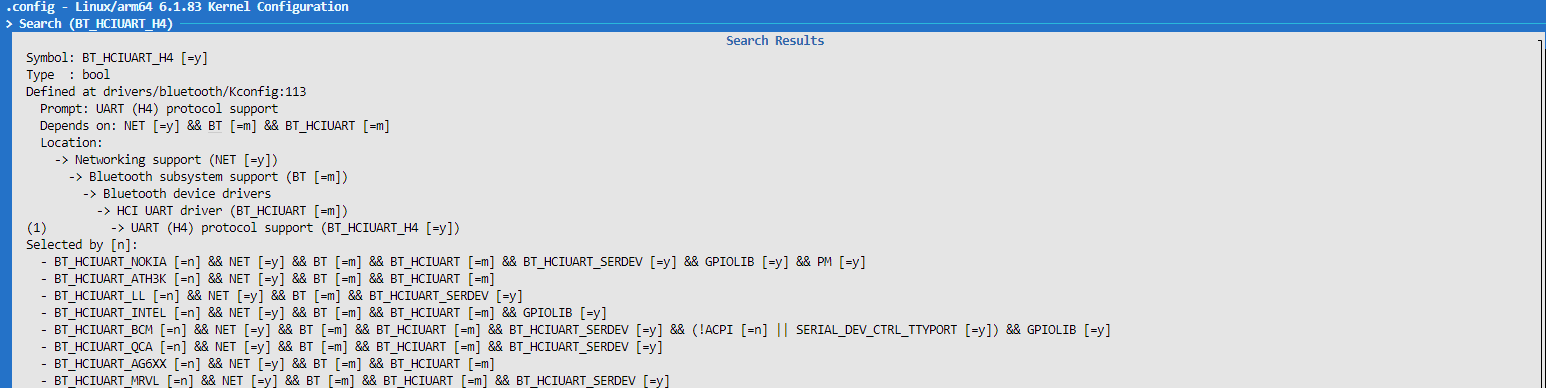

Option 5: Configure kernel option BT_HCIUART_H4=y

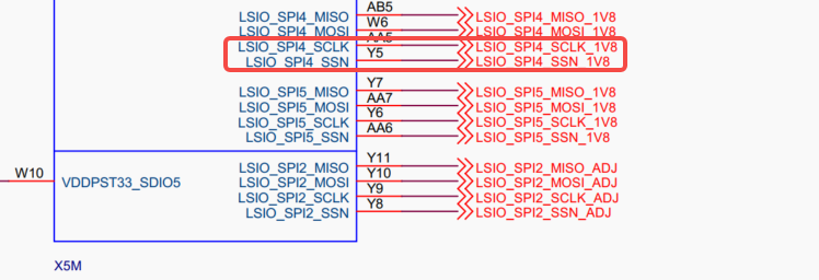

  1. Based on the schematic connection and the device tree pinmux-func.dtsi, the pin LSIO_SPI4_SCLK corresponds to the pin multiplexing configuration pinctrl_uart5.

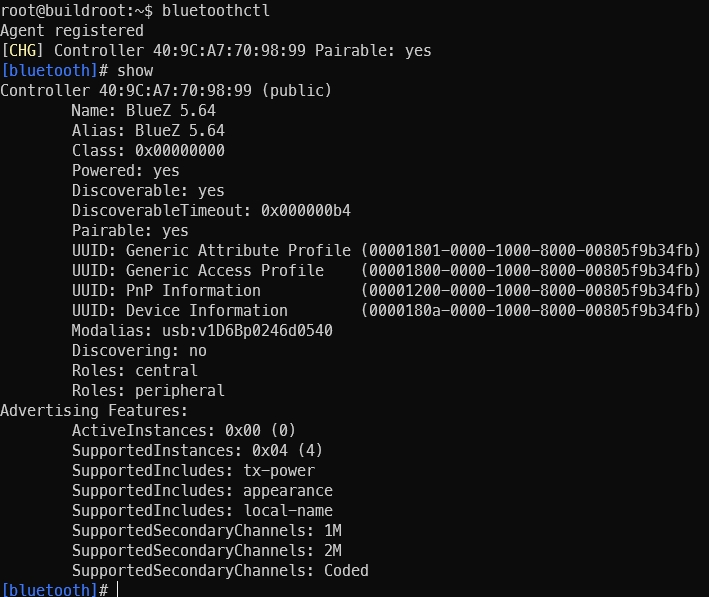

The following steps describe how to complete Bluetooth device pairing and connection via the bluetoothctl interactive interface.
1. Enter Bluetooth Configuration Interface
  • Run bluetoothctl to enter interactive mode. The system will display the MAC address of the Bluetooth controller and its current state (usually pairable).
  • Run show to view detailed Bluetooth information, focusing on the powered and discoverable states.
2. Enable Bluetooth Function
  • Run power on to enable Bluetooth.

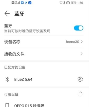

3. Set Bluetooth to Discoverable Mode
  • Run discoverable on to make the Bluetooth device discoverable by nearby devices.
  • At this point, scanning with a phone or computer will reveal a Bluetooth device named BlueZ 5.64.

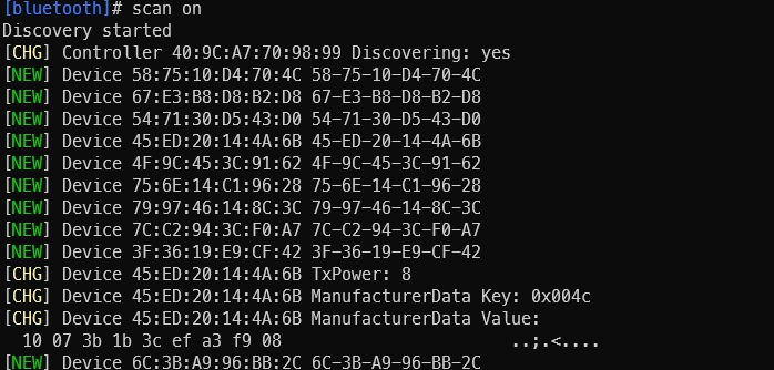

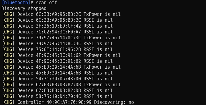

4. Scan Nearby Bluetooth Devices
  • Run scan on to start active scanning; the system will periodically display nearby Bluetooth devices.
  • Run scan off to stop scanning and summarize the discovered devices.

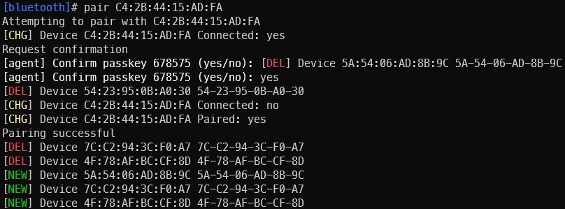

5. Pair with Other Bluetooth Devices
Proceed to pair with other Bluetooth devices:

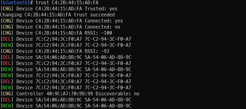

  • Run pair [targetMAC] to initiate pairing. Confirm with yes when prompted and confirm pairing on the peer device.
  • After successful pairing, run trust [targetMAC] so the device will automatically pair on next connection.

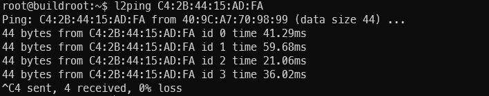

6. Test Bluetooth Device Connection
  • Use the l2ping command to test Bluetooth network connectivity.
Summary
Through the above steps, you have completed Bluetooth device scanning, pairing, and connection testing. For more features, refer to the official documentation on the BlueZ website.
