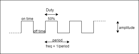

Basic structure of a PWM signal:
  • Period: Time from one rising edge to the next. A frequency of 100Hz means there are 100 cycles per second.
  • Duty Cycle: The proportion of time the PWM signal remains high during one period. Duty cycle is usually expressed as a percentage. For example, at 50% duty cycle, the signal is high for half the period and low for the other half.
  • Frequency: The number of times the PWM signal repeats per second. Frequency is inversely proportional to period: Frequency = 1 / Period.

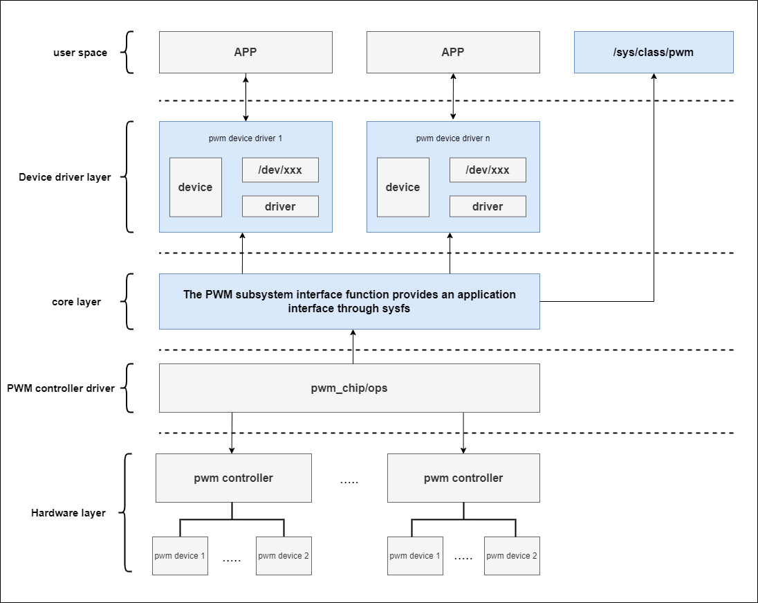

Functional Principle
The figure below shows the PWM subsystem architecture, which can be roughly divided into three layers: user layer, core layer, and hardware layer.

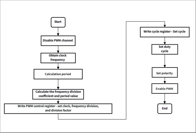

The generation and control process of a PWM signal consists of several steps:
  • Device Initialization: The driver initializes the PWM hardware via device tree or platform code and configures the hardware registers.
  • PWM Configuration: Set the PWM period (frequency) and duty cycle via drobot_pwm_apply or user-space interfaces.
  • Enable PWM: Call pwm_enable() to start PWM output. Once enabled, the hardware controller generates the PWM waveform according to the specified frequency and duty cycle.
  • Runtime Adjustment: The duty cycle and frequency of the PWM can be adjusted in real time through system interfaces.
  • Disable PWM: When PWM output is no longer needed, call pwm_disable() to stop the output.
The detailed flow is shown below:
