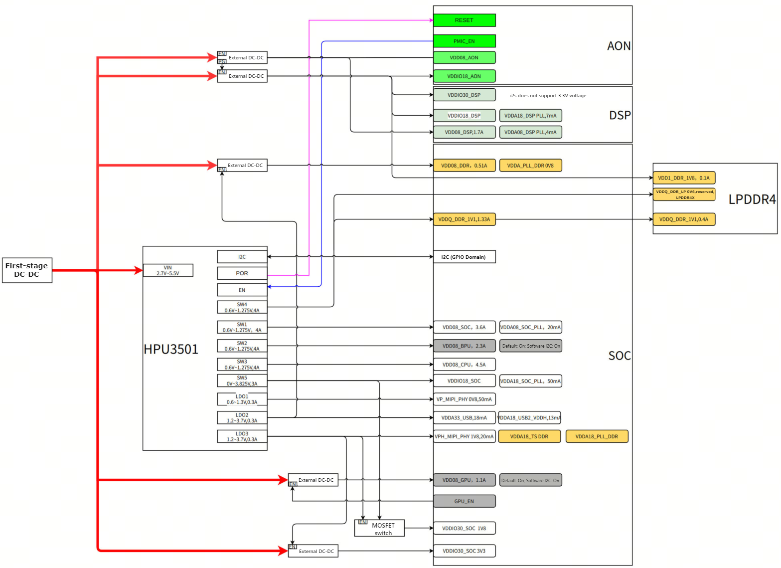

Introduction to HPU3501 Typical Applications
The PMIC currently used on the X5 EVB is the HPU3501, whose typical application is shown in the figure below:
HPU3501_typical_application
In the above diagram, HPU3501 acts as the core component, providing multiple voltage and current power rails to the X5 SoC via its internal switching regulators and low-dropout linear regulators, along with external DC/DC converters, while managing power through an I2C interface. Details are as follows:
Input Power:
  • 5V IN: External power input, supplying power to the PMIC and other external DC/DC converters.
PMIC:
  • VIN (2.7V–5.5V): Main power input for the PMIC, accepting a voltage range of 2.7V to 5.5V.
  • I2C: I2C interface used to configure and monitor PMIC functions.
  • POR (Power-On Reset): Ensures the system starts in a known state upon power-up.
  • SWx (Switchers): Configurable switching regulators used to provide power rails with different voltages and currents. SW1 to SW5 are labeled in the diagram, each with different voltage and current specifications.
    • SW1: 0.6V–1.275V, max current 4A
    • SW2: 0.6V–1.275V, max current 4A
    • SW3: 0.6V–1.275V, max current 4A
    • SW4: 0.6V–1.275V, max current 4A
    • SW5: 0V–3.875V, max current 3A
  • LDOx (Low Dropout Regulators): Provide stable, low-noise power rails. LDO1 to LDO3 are labeled in the diagram, each with different voltage and current specifications.
    • LDO1: 0.6V–1.3V, max current 0.3A
    • LDO2: 1.2V–3.7V, max current 0.3A
    • LDO3: 1.2V–3.7V, max current 0.3A
X5 SoC Power Rails:
  • VDDx Series: These are power rails providing different voltages and currents to the X5 SoC, including:
    • VDD08_ANON, VDD08_DSP, VDD08_DSP_PLL, etc.: Power various modules of the SoC (e.g., analog, digital signal processing, PLLs).
    • VDD08_DDR, VDDQ_DDR_IV1, VDDA_PLL_DDR 0V8: Supply power to DDR memory.
    • VDD08_SOC, VDD08_BPU, VDD08_CPU: Power core components of the SoC (e.g., CPU, BPU).
    • VDD08_SOC_PLL, VDDAIR_SOC_PLL: Supply power to SoC PLLs.
    • VP_MIPI_PHY 0V8: Supply power to the MIPI interface.
    • VDDAIR1_USB, VDDAIR1_USER2_VOOH: Supply power to USB and user interfaces.
    • VDDAIR8_PHY 1V8, VDDAIR8_PLL_DDR: Supply power to PHY and PLL.
    • VDD08_GPU: Supply power to the GPU.
    • VDD08_SOC_1V8: Provide 1.8V power to other parts of the SoC.
    • VDD08_SOC_5V3: Provide 5.3V power to the SoC.

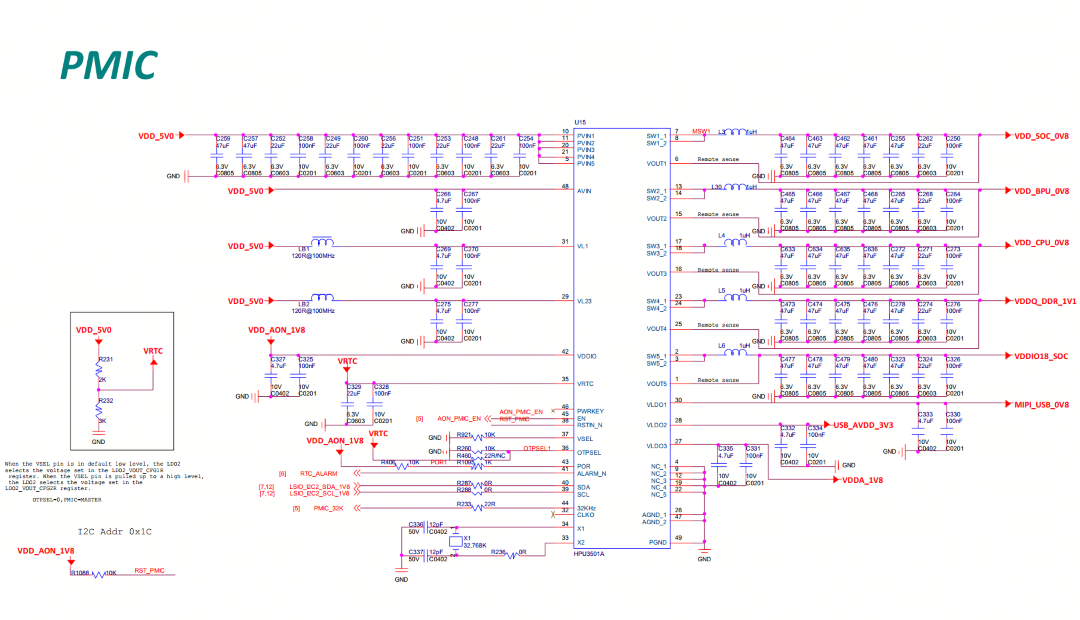

The schematic of the PMIC module circuit on the X5 EVB is as follows:

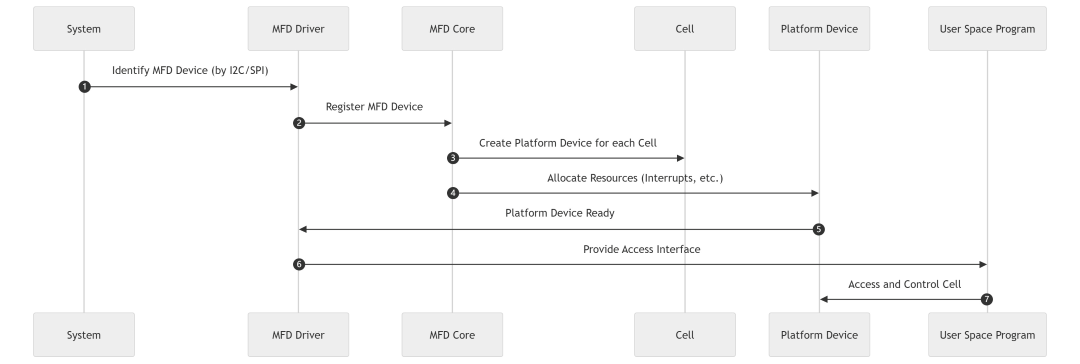

MFD Workflow:
  • When an MFD device is recognized by the system (e.g., via I2C or SPI bus), the MFD device driver uses the MFD Core interface to register the device.
  • The MFD Core creates a Platform device for each Cell in the device and allocates resources such as interrupts to these Platform devices.
  • Drivers and user-space programs can access and control each Cell via the Platform device interface, thereby achieving management and control of the MFD device.
This process is illustrated in the figure below:

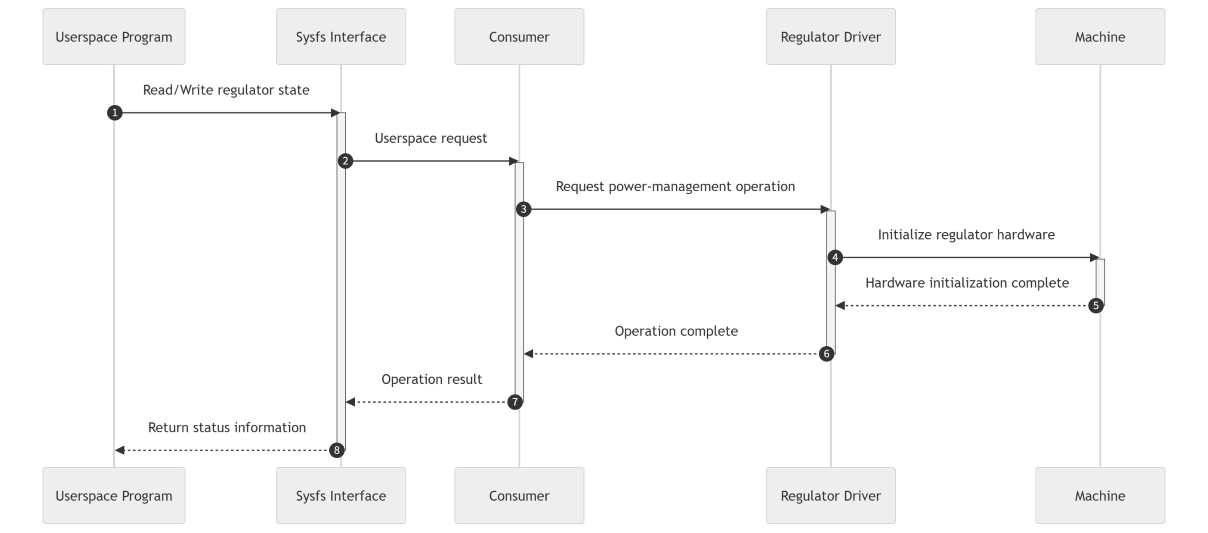

The Linux Regulator Framework in actual drivers is shown in the figure below:
Regulator_framework
Explanation:
  1. User Space Program (User_Space): Initiates read or write requests for regulator status.
  2. Sysfs Interface (Sysfs_Interface): Acts as the interface between user space and kernel space, receiving user requests and forwarding them to the appropriate Consumer.
  3. Consumer: Represents devices or modules in the system using regulator power; they request power management operations via the Sysfs interface.
  4. Regulator Driver (Regulator_Driver): Kernel regulator driver responsible for handling Consumer requests and interacting with hardware to perform power management operations.
  5. Machine: Represents platform-specific configuration information used to initialize regulator hardware.

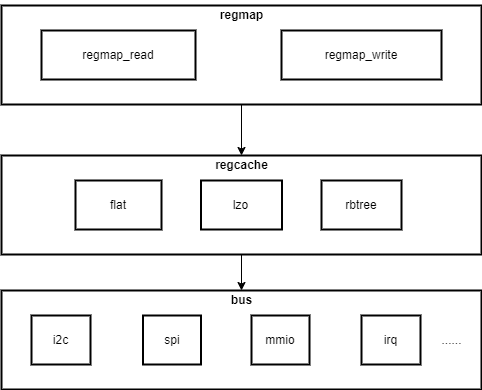

The entire Regmap is divided into three layers, with the following topology:
Regmap_Topology
This diagram shows a simplified topology of the regmap subsystem in the Linux kernel. The regmap subsystem simplifies hardware register access through a unified interface and supports various bus types. Below is an analysis of each layer:
The regmap layer provides generic read/write interfaces:
  • regmap_read and regmap_write: The two main interfaces provided by the regmap subsystem for reading from and writing to hardware registers. These interfaces hide the specific bus operation details from upper-layer drivers.
The regcache layer manages caching to improve efficiency:
  • regcache: This layer manages register caching. Regmap can use caching to reduce hardware access frequency, improving performance. The diagram lists several different cache implementations:
    • flat: Array-based, simple flat cache without complex data structures. Suitable when the device has few registers.
    • lzo: Cache using the LZO (Lempel–Ziv–Oberhumer) compression algorithm, suitable for scenarios requiring compression of large amounts of register data. This algorithm has three characteristics:
      • Fast compression
      • Decompression requires no extra memory
      • Compression ratio is adjustable
      • Can be viewed as an array cache with an added compression layer to save memory. Consider this type when the number of device registers is moderate.
    • rbtree: Cache implemented using a red-black tree (a self-balancing binary search tree), characterized by fast indexing. Use this type when the number of device registers is large or when low register operation latency is required.
The bus layer handles interaction with specific hardware buses:
  • bus: This layer defines specific methods for interacting with different bus types. Each bus type has its own implementation to support the regmap interface. The diagram lists several common bus types:
    • i2c: Implementation for I2C bus.
    • spi: Implementation for SPI bus.
    • mmio: Implementation for Memory-Mapped I/O.
    • irq: Implementation for interrupts.

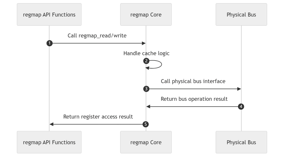

The corresponding regmap driver framework has three main components: regmap API functions, regmap core, and the physical bus layer:
  1. regmap API Functions
    This layer provides a set of API functions to simplify register read/write operations. These are the external interfaces of the regmap framework, allowing drivers to access hardware registers uniformly without worrying about underlying bus types or register access details.
  2. regmap Core
    This is the core of the regmap framework, responsible for managing register caching and supporting different caching strategies. The choice of caching strategy can affect performance and resource usage.
  3. Physical Bus Layer
    This layer defines specific methods for interacting with different physical buses. Each bus type has its own implementation to support regmap API functions. These buses include:
The interaction process between layers of the regmap driver framework is shown in the figure below:
Regmap_framework
Explanation of the PMIC Driver Framework

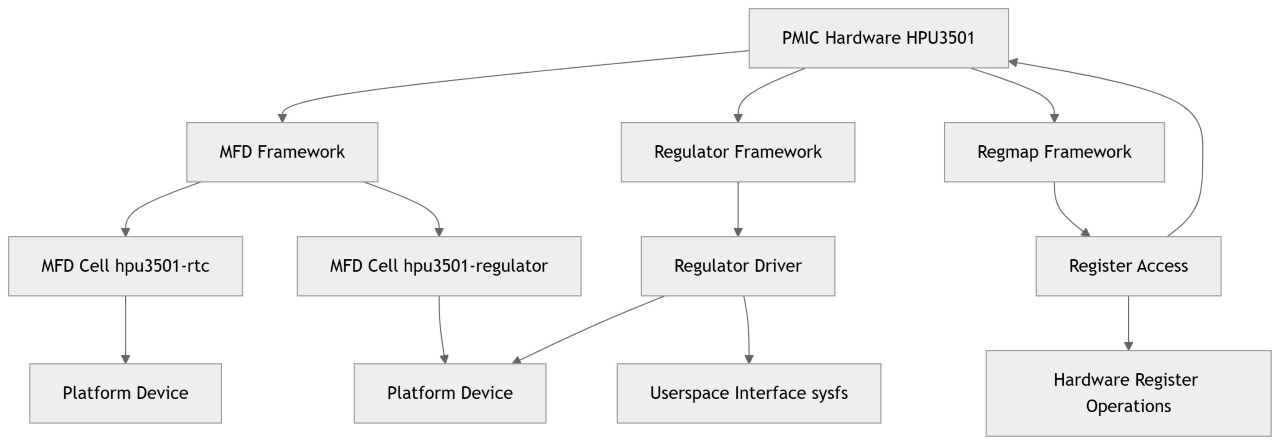

First, clarify the relationships among PMIC, MFD, Regulator, and Regmap:
  1. PMIC and MFD:
    • The PMIC hardware is registered into the kernel via the MFD framework. The MFD framework abstracts each function of the PMIC into a Cell and creates a Platform device for each Cell.
    • For example, the hpu3501 PMIC chip is registered via the MFD framework, with each function (e.g., LDO or DC-DC converter) abstracted as a Cell.
  2. MFD and Regulator:
    • The MFD framework acts as an intermediary layer, abstracting each functional module of the PMIC into independent devices. The Platform devices created by the MFD framework for each Cell can be used by the Regulator framework. The Regulator framework communicates with the PMIC hardware through these Platform devices.
    • For example, the MFD framework creates a Platform device for each LDO in hpu3501, and the Regulator framework controls voltage and current through these devices.
  3. Regulator and Regmap:
    • The Regulator framework communicates with the PMIC hardware through the Regmap framework. Regmap provides register access APIs, and the Regulator framework uses these APIs to read from and write to PMIC registers.
    • For example, the Regulator framework uses the regmap_write function to set the PMIC’s voltage control register.
In short, the MFD framework manages the multi-functional units of the PMIC, the Regulator framework controls the voltage regulators, and Regmap handles communication with the PMIC’s registers.
Taking hpu3501 on the X5 EVB as an example, the above relationships can be illustrated as follows:
PMIC_framework

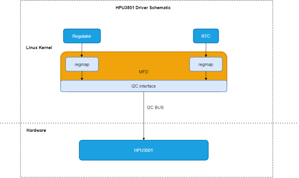

The PMIC driver framework can be described as follows:
hpu3501
The hpu3501 hardware supports multiple functions, such as RTC and Regulator, so the Linux MFD architecture is adopted as the overall architecture for both Regulator and RTC.
As shown in the figure, the main role of the MFD layer is to register the I2C device, communicate with the hardware HPU3501 via the I2C bus, and provide a unified register read/write interface to the Regulator and RTC via the regmap method.
RTC mainly handles time and alarm settings and read/write operations.
The Regulator mainly controls various power rails.

This guide explains PMIC usage using the hpu3501 driver code as an example.
hpu3501 MFD Layer Driver Code
In the previous section MFD Driver Framework, the architecture of the hpu3501 MFD has been explained. Currently, only the Regulator function of hpu3501 is used, so there is only one Cell. This chapter details the hpu3501 MFD layer-related code.

Currently, in x5-evb.dtsi, only one PMIC is used, connected to I2C2. The relevant description for the MTD driver usage of HPU3501 in the DTS is as follows:
# kernel/scripts/dtc/include-prefixes/arm64/hobot/x5-evb.dtsi
&i2c2 {
	status = "okay";
	hpu3501@1c {
		compatible = "hobot, hpu3501";
		reg = <0x1c>;
		status = "okay";
This device tree defines a PMIC (hpu3501) connected to I2C bus 2 at address 0x1C. The meanings of each property in the device tree are as follows:
  • hpu3501@1c: Defines a node named hpu3501, where @1c indicates the device’s address on the I2C bus is 0x1C.
  • compatible = "hobot, hpu3501";: Specifies device compatibility, typically used for driver matching in the kernel.
  • reg = <0x1c>;: Reiterates the I2C device address.
  • status = "okay";: Indicates that the device is enabled and available.
Key Functions of hpu3501 MFD
Initialization:
  • Register I2C device
  • Initialize regmap interface
  • Register MFD devices for Regulator and RTC

Combining the device tree with the PMIC Hardware Schematic, a deeper understanding of the Linux Regulator framework can be achieved. As explained in the earlier section on the Regulator framework, regulators form part of power domains. The two regulators described in the device tree represent two power domains controllable by the kernel. All components in the circuit schematic labeled VCC_BPU or VDD08_CPU are consumers of these two regulators.
