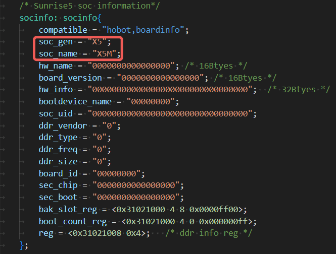

“soc_gen” and “soc_name” must be configured in the Kernel DTS file, located at kernel/arch/arm64/boot/dts/hobot/x5.dtsi, under the node named “socinfo”.
Currently, in the kernel DTS, the placeholder length for "hw_name" and "board_version" is 16 bytes, and for "hw_info" it is 32 bytes. If any field exceeds its placeholder length, the socinfo driver initialization will fail.

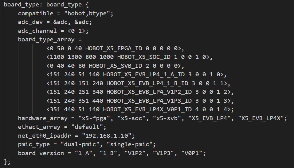

Information such as “board_id”, “hw_name”, and “board_version” must be configured in the Uboot DTS file, located at uboot/arch/arm/dts/x5.dtsi, under the node named “board_type”.
The board_type_array field in DTS corresponds to “board_id”; refer to Modify Board ID Macro Definitions for related changes.
The hardward_array field corresponds to “hw_name”, and the board_version field corresponds to “board_version”.
