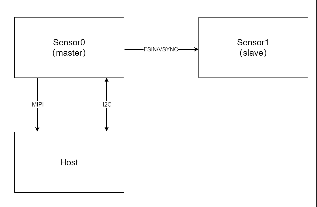

Method 1:
sensor_control_1
  • Sensor0 is configured as master mode (FSIN/VSYNC as output), while Sensor1 is configured as slave mode (FSIN/VSYNC as input).
  • Sensor0 acts as the master device, outputting the FSYNC signal to synchronize other sensors. When the HOST initiates image capture, Sensor0 outputs an FSYNC signal during its exposure period, triggering other sensors to perform synchronized capture.
  • The FSIN/VSYNC pin of Sensor1 is set as input and controlled by Sensor0, thereby achieving synchronized capture between the two image sensors.

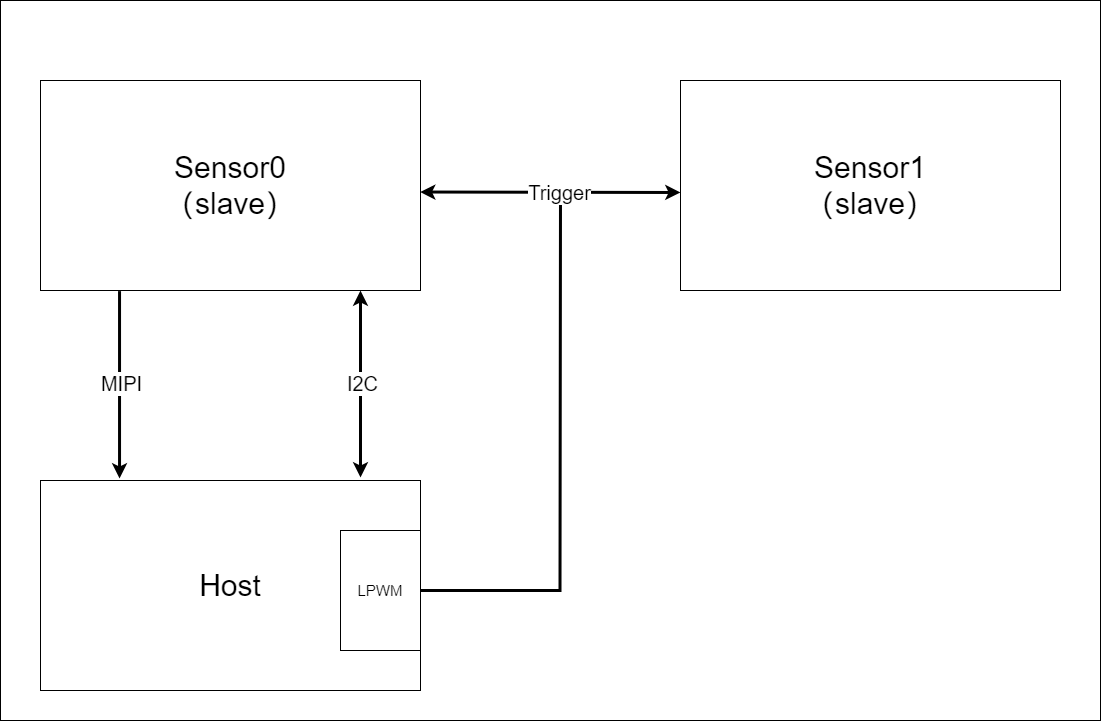

Method 2:
sensor_control_2
  • Both sensors are configured in slave mode, so each frame capture is triggered by an external FSYNC signal.
  • The HOST sends a synchronization signal uniformly to the Slave Sensors to trigger their exposure. Based on the configured LPWM parameters, a square wave signal is output on the trigger pin. Whenever both sensors receive the trigger signal, they simultaneously capture one frame of image.

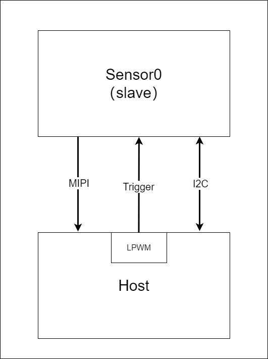

Method 3:
sensor_control_3
  • One sensor is configured in Slave mode. When the HOST initiates image capture, a square wave based on the LPWM configuration is output on the trigger pin. Upon receiving the trigger signal, the sensor captures one frame of image.

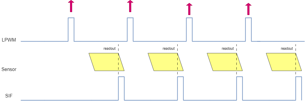

When the sensor receives the LPWM trigger signal (red arrow), it starts exposure and image output. However, due to a fixed delay inherent in the LPWM that persists throughout operation, the trigger signal is not perfectly aligned with SIF exposure output. The interaction between LPWM, Sensor, and SIF is illustrated below:
lpwm_sensor_cim

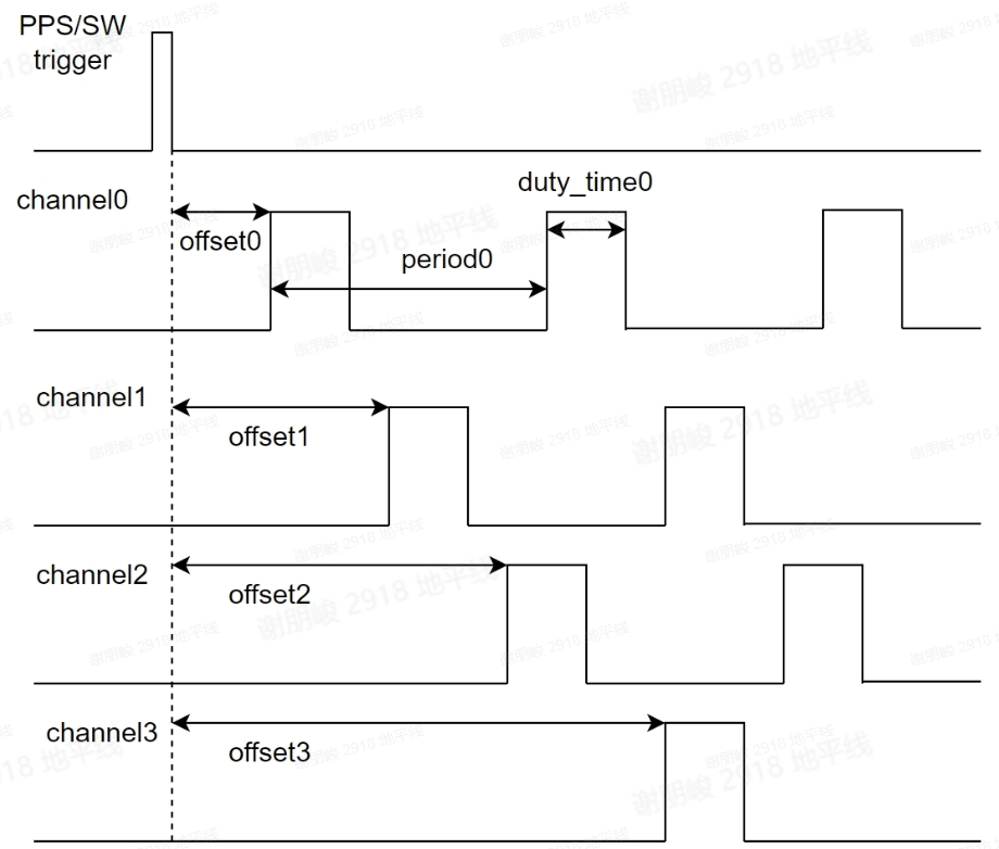

Explanation of lpwm_attr structure parameters:
Parameter Description Range Output 30Hz, High Level 10μs Parameters
offset Time offset relative to the trigger point 11
duty_time Active high time; actual effective time is (duty_time + 1)μs [0, 4000 | period) μs 9
period Period; actual effective period is (period + 1)μs [1, 1000000) μs 33332
threshold Threshold for gradual synchronization function [0, 65535] μs 0
adjust_step Adjustment time per step: adjust_time = 2 ^ adjust_step [0, 15] 0
trigger_source Trigger source selection; one LPWM chip can only select one trigger source. For example: lpwm0 cannot have channel_0 set to trigger_source 7 and channel_1 set to trigger_source 0 [0, 10]
trigger_mode Trigger mechanism (1 – external hardware trigger, 0 – internal software trigger) [0, 1]

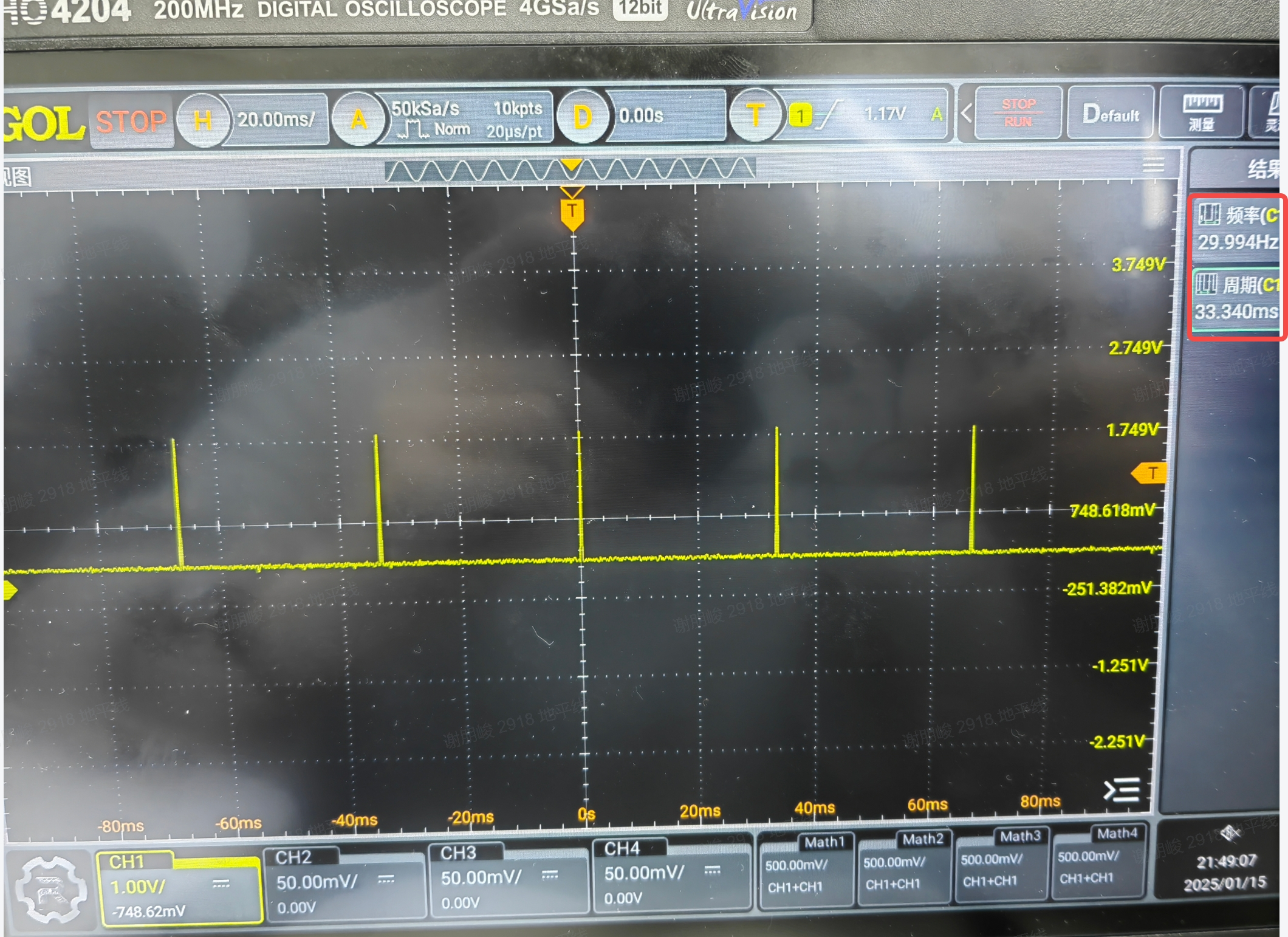

A common scenario involves connecting a 30fps sensor, where period should be set to 1s/fps = 33,333μs. After the sensor completes 30 frames, there will be a 10μs gap with the next PPS trigger after 999,990μs. Therefore, the offset should be set to 10μs (at least 10μs, at most period-duty_time μs; otherwise, lpwm will output 31 square waves within 1 second).
lpwm_channel
Formula calculations:
  • Period = 1000000 / fps
  • Offset = 1000000 - Period * fps

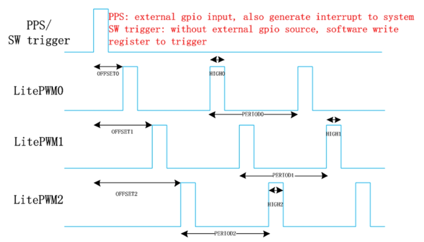

LPWM Triggering Methods
  • Software Trigger: trigger_mode = 0, indicating internal software trigger. After configuring software trigger, the LPWM driver automatically provides a 1-second periodic software trigger based on hrtimer. Essentially, it writes to an LPWM register (LPWM_SW_TRIG) every second, causing LPWM to re-output square waves according to the configuration.
  • Hardware Trigger: trigger_mode = 1, indicating external trigger. Requires an external PPS (pulse per second) signal. Upon receiving the PPS signal, the hardware outputs square waves according to the software configuration. Every received PPS signal causes LPWM to re-output waves according to the configuration.
    • External trigger requires configuration of trigger_source. The external trigger source can be configured with the following values:

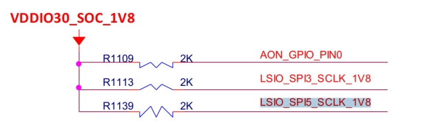

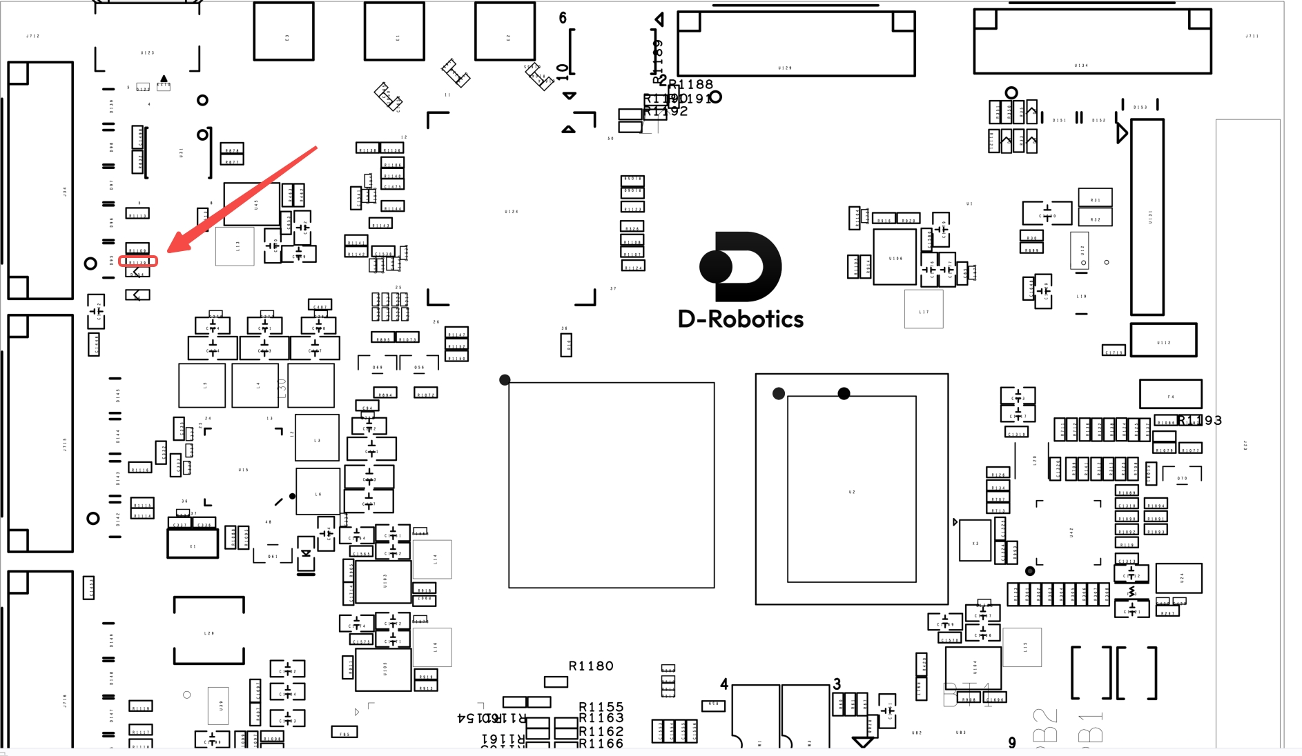

Referring to the EVB_X5 schematic, the LPWM trigger pin for the camera sensor on the MIPI0 interface is LSIO_SPI5_SCLK. As per the table above, this corresponds to LPWM0. The device tree association configuration is as follows:
&lpwm0 {
	status = "okay";
	/* conflict with camera pwd gpio */
	pinctrl-names = "default";
	pinctrl-0 = <&pinctrl_lpwm0_0 &pinctrl_lpwm0_1
			&pinctrl_lpwm0_2 &pinctrl_lpwm0_3>;

Refer to the EVB X5 schematic. Using LPWM0 channel 0, the corresponding pin is LSIO_SPI5_SCLK as shown:
lpwm_pin
The corresponding development board pinout is as follows:
lpwm_pin
During sample execution, use an oscilloscope to probe as shown:
lpwm_pin
The frequency and period observed on the oscilloscope match the LPWM parameters in the configuration file.
