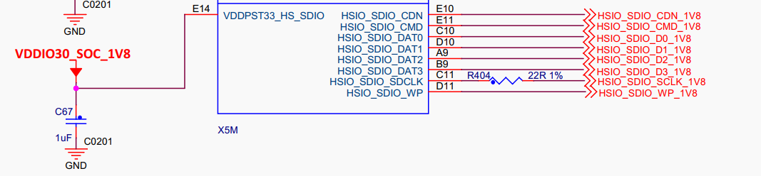

Schematic Confirmation
Partial schematics of X5 RTL8852BS are shown below:
For the RTL8852BS Wi-Fi module to operate properly, the hardware must meet the following conditions:
  • Power supply: The module has two power supplies: VDD_3V3 as the main power and VDD_1V8 as the IO pull-up power.
  • Enable: To work normally, both WL_REG_ON and SDIO_RESET must be set to high level. Currently, these signals are pulled up at power-on in hardware, so no configuration is needed in the device tree.
  • Clock: The 40MHz clock can be internally generated by the module; no external input is required.
  • Communication: Communication between the module and SOC is via SDIO, where SDIO_DATA_0, SDIO_DATA_1, SDIO_DATA_2, and SDIO_DATA_3 are the four data lines of SDIO. SDIO_CMD and SDIO_CLK are the command and clock lines, respectively.

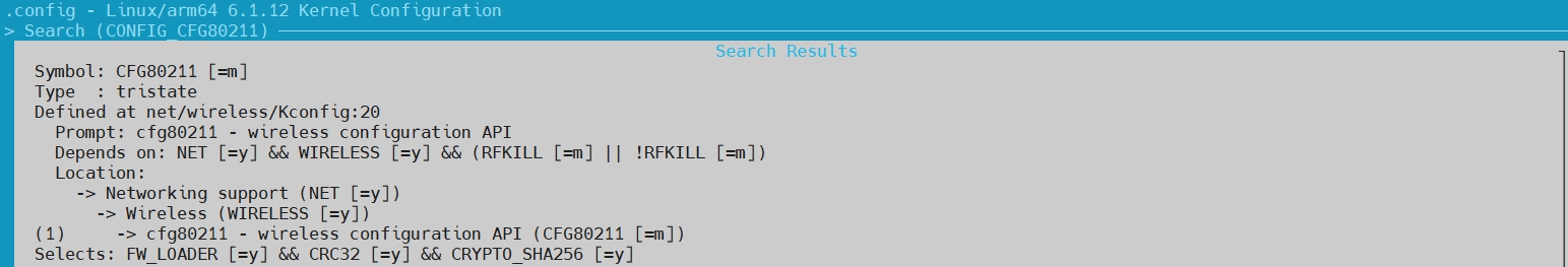

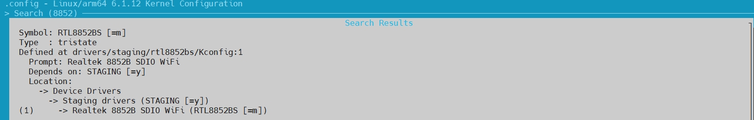

Option 1: Configure kernel option CONFIG_RTL8852BS=m
Option 2: Configure kernel option CONFIG_CFG80211=m WiFi usage requires enabling cfg80211 and mac80211 support in the kernel.

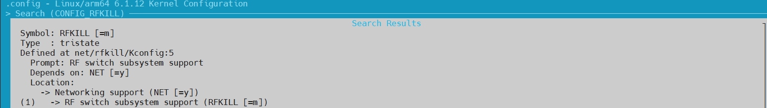

Option 3: Configure kernel option CONFIG_RFKILL=m

There are three MMC controllers on the X5. First, confirm which controller the RTL8852BS uses, as follows:
  1. Based on the schematic connection and device tree pinmux-func.dtsi, the pin HSIO_SDIO_CMD corresponds to the multiplexing configuration pinctrl_sdio.

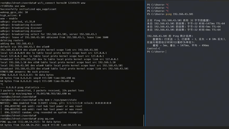

RTL8852BS WOW Feature Verification
WOW (Wake on WLAN) is a technology that allows a device in sleep mode to be awakened by receiving specific packets via Wi-Fi. WOW technology uses a “hardware monitoring + signal assertion” mechanism to achieve remote network wake-up while maintaining extremely low standby power consumption. The core principle is that the Wi-Fi chip retains packet parsing capability in sleep mode; once a preset pattern is matched, it immediately triggers a host interrupt via a physical signal. The Out-band wake-up method uses a dedicated GPIO pin for waking up, connecting the Wi-Fi chip’s GPIO directly to the host’s wake-up input pin. When the chip detects a wake-up packet, it sends a pulse signal through the GPIO to wake the host.

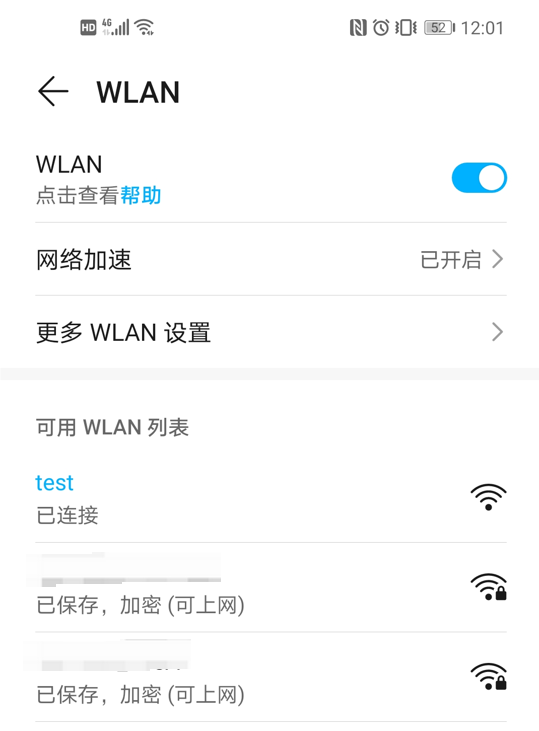

  1. Use the script wifi_connect "ssid" "password" wow to start the script.
  2. Run echo mem > /sys/power/state to put X5 into deep sleep mode.
  3. Ping the board’s IP address; a magic packet will be sent to the module to wake up the host.
  4. Run ping qq.com on the board to verify successful wake-up; the board should still be on the network.
Note: Verifying the RTL8852BS WOW feature requires independent power supply to the RTL8852BS. The RTL8852BS must not lose power when the system is in sleep mode. The current EVB design does not support this; if verification is needed, the power supply design must be modified.

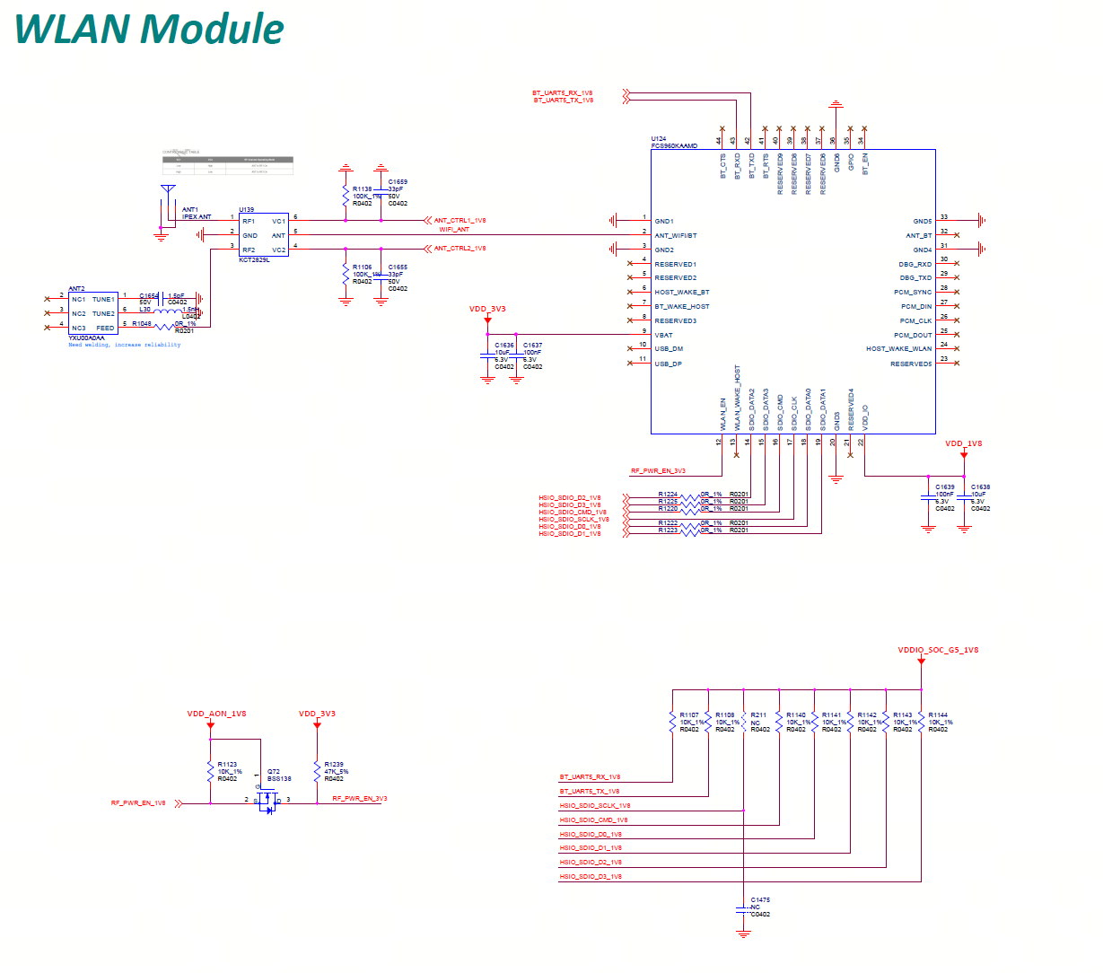

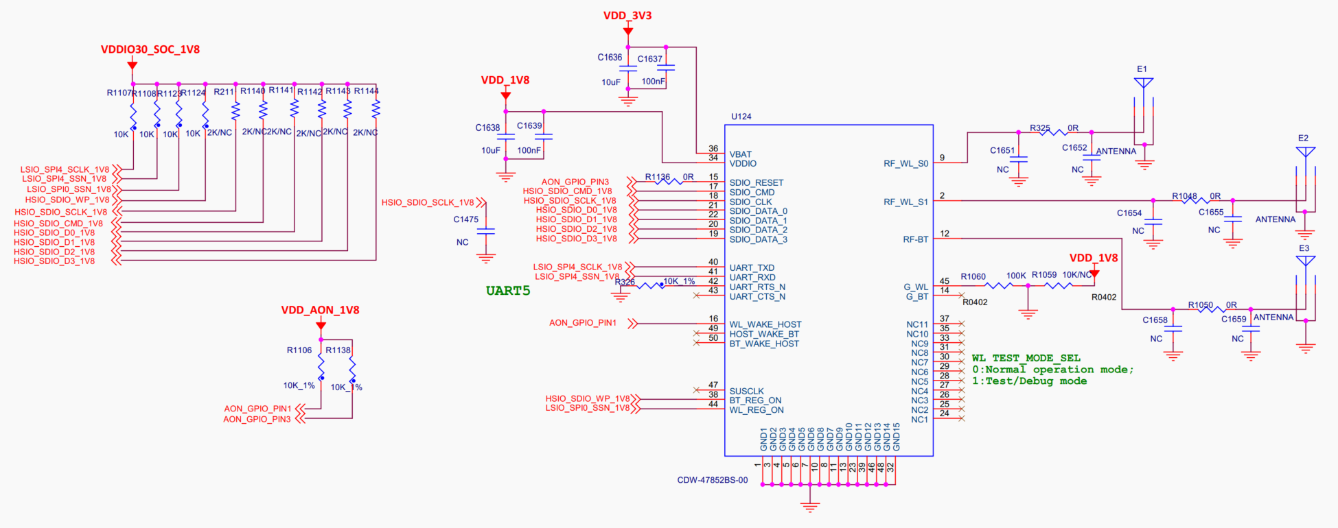

Partial schematics of X5 FCS960K are shown below:
For FCS960K to operate properly, the following hardware conditions must be met:
  • Enable: To work normally, RF_PWR_EN must be set to high level.
  • Antenna: WIFI/Bluetooth antenna interface ANT_WIFI/BT. The EVB provides both onboard and external antenna switching, supporting free switching.
  • Communication Interface Configuration
  • Wi-Fi Subsystem (SDIO Interface)
    • SDIO_DATA_0, SDIO_DATA_1, SDIO_DATA_2, SDIO_DATA_3 are the four data lines of SDIO. SDIO_CMD and SDIO_CLK are the command and clock lines, respectively.

The DTS configuration for the FC960K module can be found in the V2P0 DTS file: kernel/arch/arm64/boot/dts/hobot/x5-evb-lp4-v2p0.dts. The specific content is as follows:
```dts
/* ANT_CTRL1 */
&hsio_iomuxc {
hsio_gpio0_23: hsio_gpio0_23 {
	horizon,pins = <
	HSIO_SDIO_WP	HSIO_PINMUX_2	BIT_OFFSET8		MUX_ALT2	&pconf_output_high
pinctrl_sdio: sdiogrp {
	horizon,pins = <
	HSIO_SDIO_CLK	HSIO_PINMUX_0	BIT_OFFSET30	MUX_ALT0	&pconf_sd_sdio_pu_ds5_ipctrl
	HSIO_SDIO_CMD	HSIO_PINMUX_0	BIT_OFFSET28	MUX_ALT0	&pconf_sd_sdio_pu_ds3_ipctrl
	HSIO_SDIO_DATA0	HSIO_PINMUX_1	BIT_OFFSET0		MUX_ALT0	&pconf_sd_sdio_pu_ds3_ipctrl
	HSIO_SDIO_DATA1	HSIO_PINMUX_2	BIT_OFFSET30	MUX_ALT0	&pconf_sd_sdio_pu_ds3_ipctrl
	HSIO_SDIO_DATA2	HSIO_PINMUX_2	BIT_OFFSET28	MUX_ALT0	&pconf_sd_sdio_pu_ds3_ipctrl
	HSIO_SDIO_DATA3	HSIO_PINMUX_2	BIT_OFFSET26	MUX_ALT0	&pconf_sd_sdio_pu_ds3_ipctrl
/* ANT_CTRL2 */
&lsio_iomuxc {
lsio_gpio1_4: lsio_gpio1_4 {
	horizon,pins = <
	LSIO_SPI0_SSN	LSIO_PINMUX_1	BIT_OFFSET2	MUX_ALT2	&pconf_output_low
/* RF_PWR_EN */
&aon_iomuxc {
aon_gpio_3: aon_gpio_3 {
	horizon,pins = <
	AON_GPIO0_PIN3	INVALID_PINMUX	BIT_OFFSET0		MUX_ALT0	&pconf_output_high
&sdio_1 {
status = "okay";
pinctrl-names = "default";
pinctrl-0 = <&pinctrl_sdio &aon_gpio_3 &hsio_gpio0_23 &lsio_gpio1_4>;
power-gpios = <&aon_gpio_porta 3 GPIO_ACTIVE_HIGH>;
toggle_interval_us = <100000>;
  1. pinctrl_sdio defines the SDIO pin multiplexing.
  2. hsio_gpio0_23 and lsio_gpio1_4 are GPIO pins for switching antennas.
  3. aon_gpio_3 is the RF_PWR_EN pin, which must be set high to enable the module.
  4. sdio_1 is the SDIO node configuration for the Wi-Fi module, where:
    • status: node status
    • pinctrl-names: multiplexing configuration name
    • pinctrl-0: multiplexing configuration
    • power-gpios: GPIO pin for RF_PWR_EN
    • toggle_interval_us: switching interval for RF_PWR_EN

  • Run wifi_connect [ssid] [password] to connect to a Wi-Fi hotspot.
  • [ssid] and [password] should be replaced with the actual hotspot name and password.
Example:
	wifi_connect "WiFi-Test" "12345678"
Output:
	[ 3079.230115] [BB][halbb_la_bb_set_smp_rate] smp_rate_tmp=7, la_smp_rate_log=160 M
	udhcpc: started, v1.35.0
	udhcpc: broadcasting discover
	udhcpc: broadcasting select for 192.168.43.207, server 192.168.43.1
	udhcpc: lease of 192.168.43.207 obtained from 192.168.43.1, lease time 3600
	deleting routers
	adding dns 192.168.43.1
	default via 192.168.43.1 dev wlan0
	default via 192.168.1.1 dev eth0 metric 700 linkdown
	192.168.1.0/24 dev eth0 proto kernel scope link src 192.168.1.10 linkdown
	192.168.43.0/24 dev wlan0 proto kernel scope link src 192.168.43.207
	local 127.0.0.0/8 dev lo table local proto kernel scope host src 127.0.0.1
	local 127.0.0.1 dev lo table local proto kernel scope host src 127.0.0.1
	broadcast 127.255.255.255 dev lo table local proto kernel scope link src 127.0.0.1
	local 192.168.1.10 dev eth0 table local proto kernel scope host src 192.168.1.10
	broadcast 192.168.1.255 dev eth0 table local proto kernel scope link src 192.168.1.10 linkdown
	local 192.168.43.207 dev wlan0 table local proto kernel scope host src 192.168.43.207
	broadcast 192.168.43.255 dev wlan0 table local proto kernel scope link src 192.168.43.207
	64 bytes from 8.8.8.8: seq=1 ttl=50 time=65.481 ms
	64 bytes from 8.8.8.8: seq=2 ttl=50 time=70.789 ms
	64 bytes from 8.8.8.8: seq=3 ttl=50 time=71.112 ms
Note: When udhcpc connects to Wi-Fi, if the device lacks an antenna or has poor signal strength, it may take a relatively long time to scan for Wi-Fi hotspots and establish a connection.

  • Use a mobile phone to connect to the hotspot with SSID test.
  • After successful connection, the development board will display that device HONOR_30 has joined wlan0 with IP 192.168.5.153.
    dnsmasq-dhcp: DHCPREQUEST(wlan0) 192.168.5.153 c2:31:4e:29:d5:6a
    dnsmasq-dhcp: DHCPACK(wlan0) 192.168.5.153 c2:31:4e:29:d5:6a HONOR_30-bffd2df053010722
