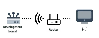

Performance test diagram:
image-20241212-152024

The following is the network configuration for this test:
  • Personal computer (PC) acts as the server, IP address: 192.168.137.1.
  • Development board acts as the client, IP address: 192.168.137.124.
