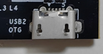

1. Connect the x5_evb development board’s USB 2.0 port to the PC’s USB 2.0 port, as shown in the figure:
X5_USB2.0

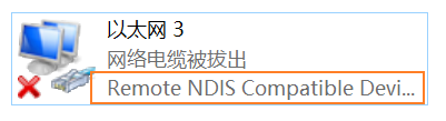

On the PC, open the network configuration page and you should see a network adapter named Remote RNDIS Compatible Device, as shown below.

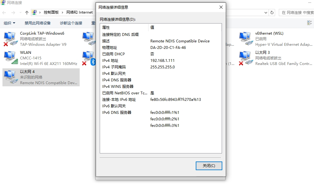

3. Use the following command to configure the IP address of the usb0 network interface so that its subnet matches the IP address of the remote network adapter on the PC side.
ifconfig usb0 192.168.1.10
PC-side remote network adapter IP configuration is shown in the image:
NETWORK_CONFIG
