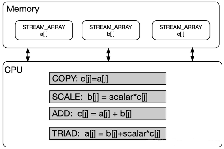

The four items in the test results — Copy, Scale, Add, and Triad — represent the bandwidth measurements. The test principles for these four operations are illustrated in the figure below:
image-20240310220251394
  • Copy: Reads a value from one memory location and writes it to another.
    • Test Description: In the Copy test, the system copies content from one array to another. This is the most basic memory bandwidth test, primarily evaluating performance during simple memory-to-memory data transfers.
    • Bandwidth Result: 9504.6 MB/s
  • Scale: Reads a value from memory, performs a multiplication, and writes the result to another memory location.
    • Test Description: The Scale test involves not only memory bandwidth but also CPU computation, thus better reflecting the collaborative performance between processor and memory.
    • Bandwidth Result: 12742.9 MB/s
  • Add: Reads two values from memory, performs an addition, and writes the result to another memory location.
    • Test Description: The Add test simulates adding two arrays and storing the result in a third array, testing bandwidth demands under parallel CPU and memory operations.
    • Bandwidth Result: 11429.7 MB/s
  • Triad: Combines Copy, Scale, and Add operations. Specifically, it reads two values a and b from memory, computes a + scalar * b, and writes the result to another memory location.
    • Test Description: Triad involves both array addition and scaling, making it a composite operation that includes computation, addition, and memory access.
    • Bandwidth Result: 11437.3 MB/s
