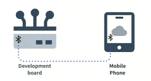

Performance test diagram:
test_diagram

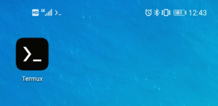

  1. Download Termux terminal on your phone: Termux Android download link: https://github.com/termux/termux-app/releases
    Termux_terminal

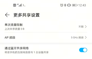

  2. Enable Bluetooth network sharing on your phone: Enable Bluetooth
    • Android phone: The path is usually Settings -> Personal Hotspot -> Bluetooth Network Sharing, though the exact location may vary slightly across different phones.
    • iOS Bluetooth sharing is usually limited to Apple devices. If your testing environment involves an iPhone and a Linux development board, it is recommended to use an Android phone instead.
    Enable_Bluetooth_network_sharing

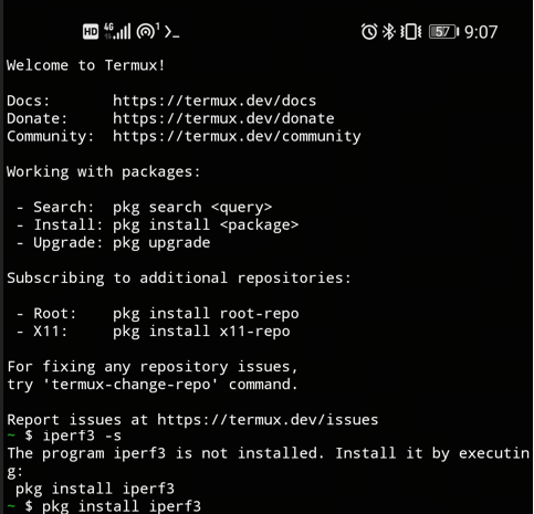

  1. Open the Termux terminal, download and install iperf3 by executing pkg install iperf3, as shown below:
    pkg_install_iperf3

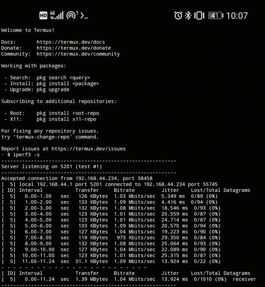

  2. In the Termux terminal, run the following command to start the server:
    iperf3 -s
    Example server log after startup:
    Server listening on 5201
    After the client successfully connects, the server log will display:
    client_successfully_connects

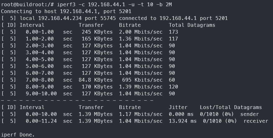

On the development board, start the iperf3 client to connect to the phone server and begin testing:
iperf3 -c 192.168.44.1 -u -t 10 -b 2M
Command parameter explanation:
-c: Specify the server's IP address (192.168.44.1 in this case).
-u: Use UDP protocol for testing.
-t: Set the total test duration (10 seconds in this case).
-b: Set the target bandwidth (2 Mbits/sec in this case).
Example client log output:
client_log
