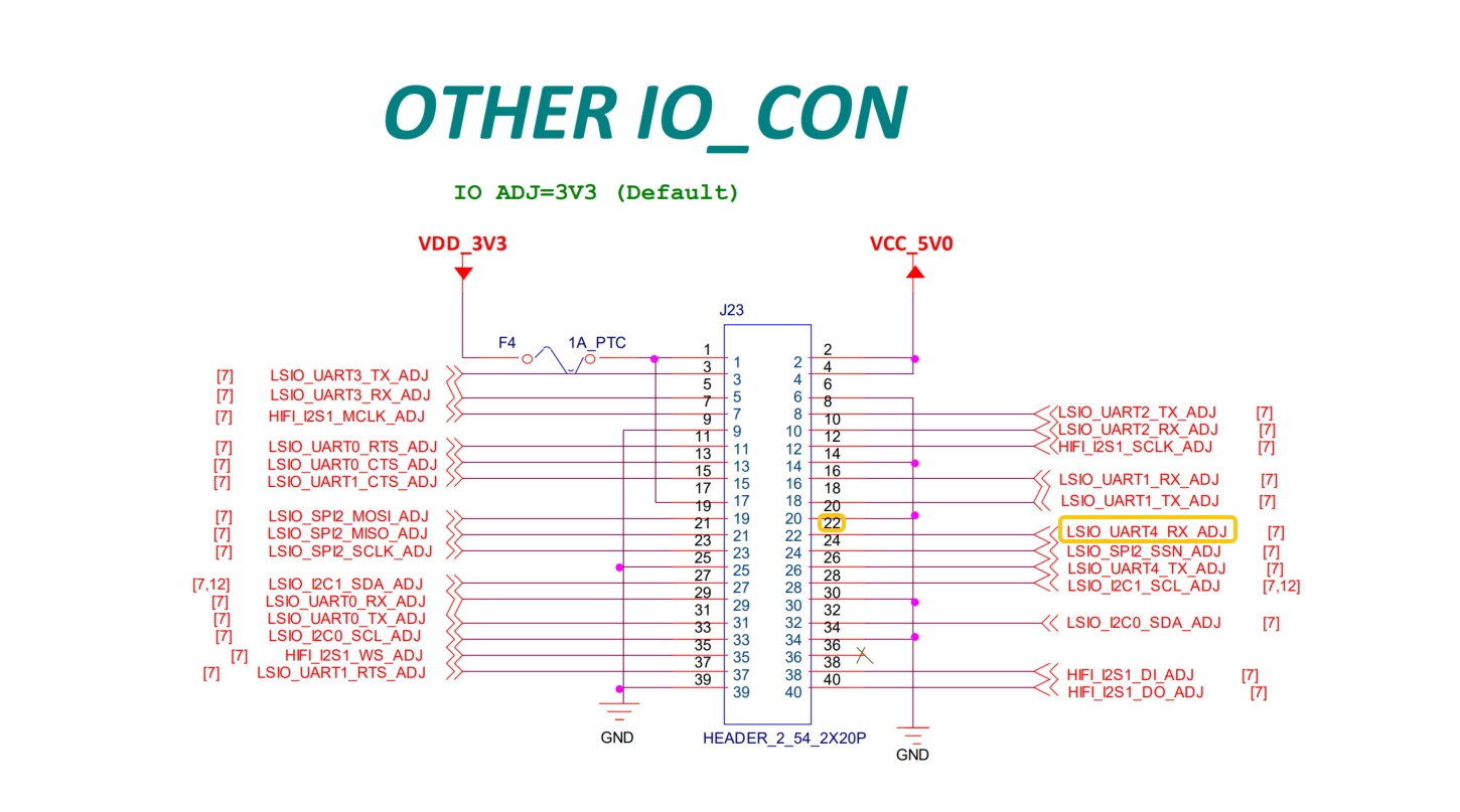

  1. Confirm Hardware Connection
    • Refer to the schematic to locate the GPIO pin, as highlighted in the yellow box in the figure below:
    image-20240313201614942
