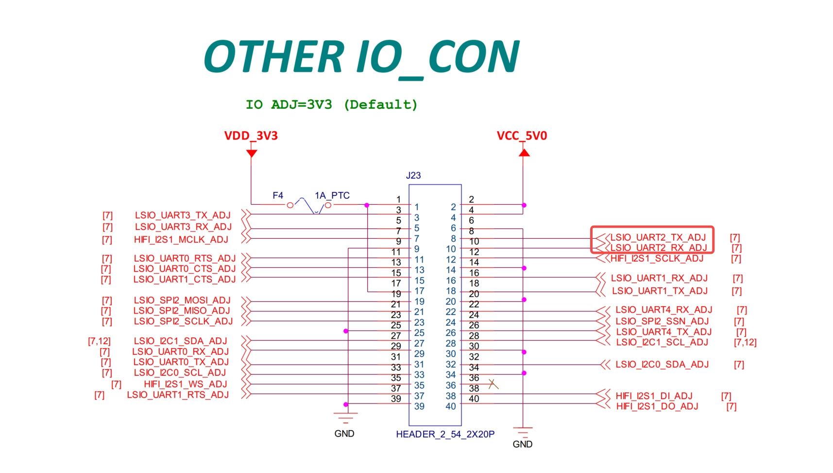

1. Refer to the x5_evb schematic to locate the pins and connector positions corresponding to uart2, as shown in the figure:
UART2_SCH

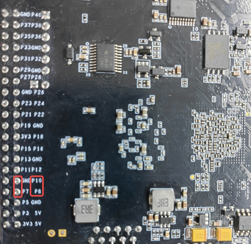

Use a dual female jumper wire to connect uart2_tx and uart2_rx. Flip the x5_evb to the back side; the location is shown in the figure:
UART2_EVB
