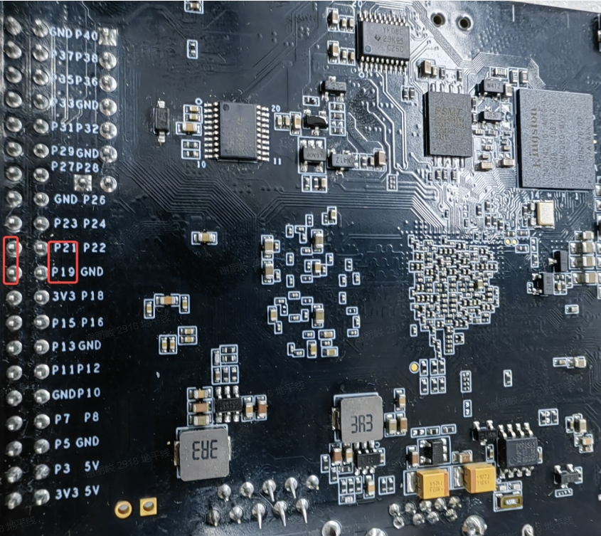

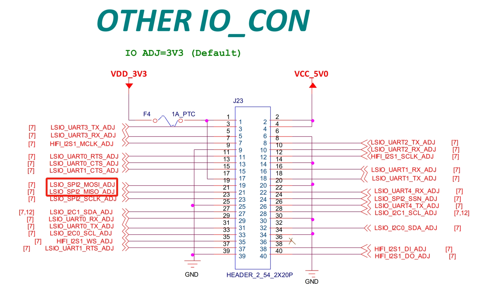

1. Refer to the x5_evb schematic to locate the pins and connector positions corresponding to SPI2_MOSI and SPI2_MISO, as shown in the figure:
SPI_SCH
Connect SPI2_MOSI and SPI2_MISO with dual-female jumper wires. Flip the x5_evb to the backside; the location is shown in the figure:
SPI_EVB
2. Check the x5_evb device tree and modify SPI2 to support Master functionality:
