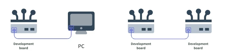

  1. Choose Connection Method: Direct connection between development board - computer, or development board - development board.
  2. Determine Server and Client: The development board can act as either client or server; the peer device can be a personal computer (PC) or another development board.
  3. Define Network Segment: Configure IP addresses within the same subnet.
