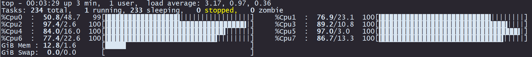

Run the top command to check CPU utilization:
image-20240313201614942
Each line displays the status of a CPU core in the format:
%CpuX  :  user/system  idle [ progress bar ]
  • %CpuX: Indicates the CPU core number; for example, %Cpu0 refers to core 0.
  • user: The proportion of CPU time used for user-space processes (e.g., applications, processes).
  • system: The proportion of CPU time used for kernel-space processes (kernel operations).
  • idle: The proportion of time the core is idle; for cpu0, current idle time is 1%.
  • progress bar: Displays the core’s load status. The length of each bar reflects the intensity of CPU load.
For example, on the first core %Cpu0, 50.8% of the time is spent executing user processes, 48.7% on kernel operations (system processes), and 0% idle time—indicating the core is almost never idle.
