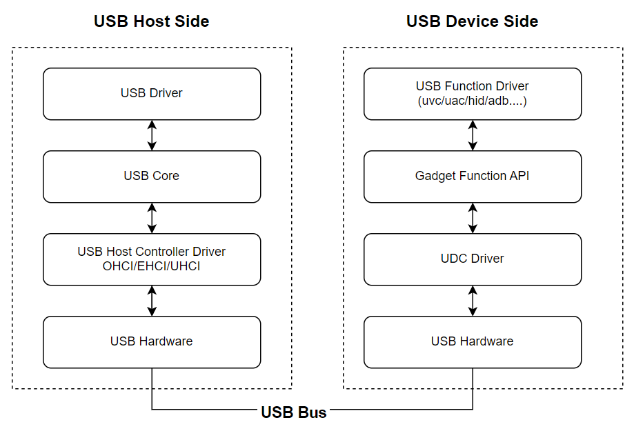

Functional Principles
The USB Gadget driver framework is shown below
In the USB Gadget framework, the functionality and behavior of a USB device are implemented through the following layers:
  • USB Function Driver
    The USB Function Driver is responsible for implementing the specific functions of the device. It defines the behavior and capabilities of the USB device when connected to a host, such as virtual serial ports, USB storage, or network adapters. A USB Gadget device typically has one or more function drivers, representing the different functions it supports.
  • configfs
    configfs is a user-space interface that allows dynamic configuration of USB devices through a file system. It provides a highly flexible way to set various parameters of a USB Gadget device, including device descriptors, configurations, interfaces, and functions.
  • UDC Driver
    The UDC Driver (USB Device Controller Driver) is the driver that interacts with the hardware USB controller, responsible for managing the physical connection and data transmission of the USB device. It acts as the low-level interface to the USB controller, interacting directly with the hardware layer of the USB device.

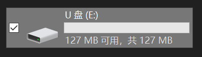

Usage

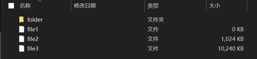

Host shows mass storage device inserted
Compare source directory and host directory contents:
  • Source directory
root@buildroot:/media/mass_storage# ls -al
total 11282
drwxr-xr-x 3 root root    16384 Jan  1 00:00 .
drwxrwxrwt 3 root root       60 Jan  1 00:00 ..
-rwxr-xr-x 1 root root        0 Jan  1  1980 file1
-rwxr-xr-x 1 root root  1048576 Jan  1  1980 file2
-rwxr-xr-x 1 root root 10485760 Jan  1  1980 file3
drwxr-xr-x 2 root root     2048 Jan  1  1980 folder
  • Host side

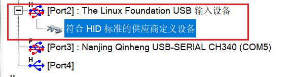

Usage
Run the command on the device:
/etc/init.d/usb-gadget.sh restart hid
The host will detect the HID peripheral insertion

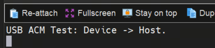

  • ACM Path Test - Direction Device->Host
    Run test command on the device:
echo "USB ACM Test: Device -> Host." > /dev/ttyGS0
Open the corresponding virtual serial port on the host (in this example, COM4, default baud rate 9600), and the same string will be received

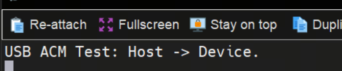

  • ACM Path Test - Direction Host -> Device
    Open the corresponding virtual serial port on the host (in this example, COM4, default baud rate 9600), and send a string
Run test command on the device to receive the same string:
root@buildroot:/userdata# cat /dev/ttyGS0
USB ACM Test: Host -> Device.

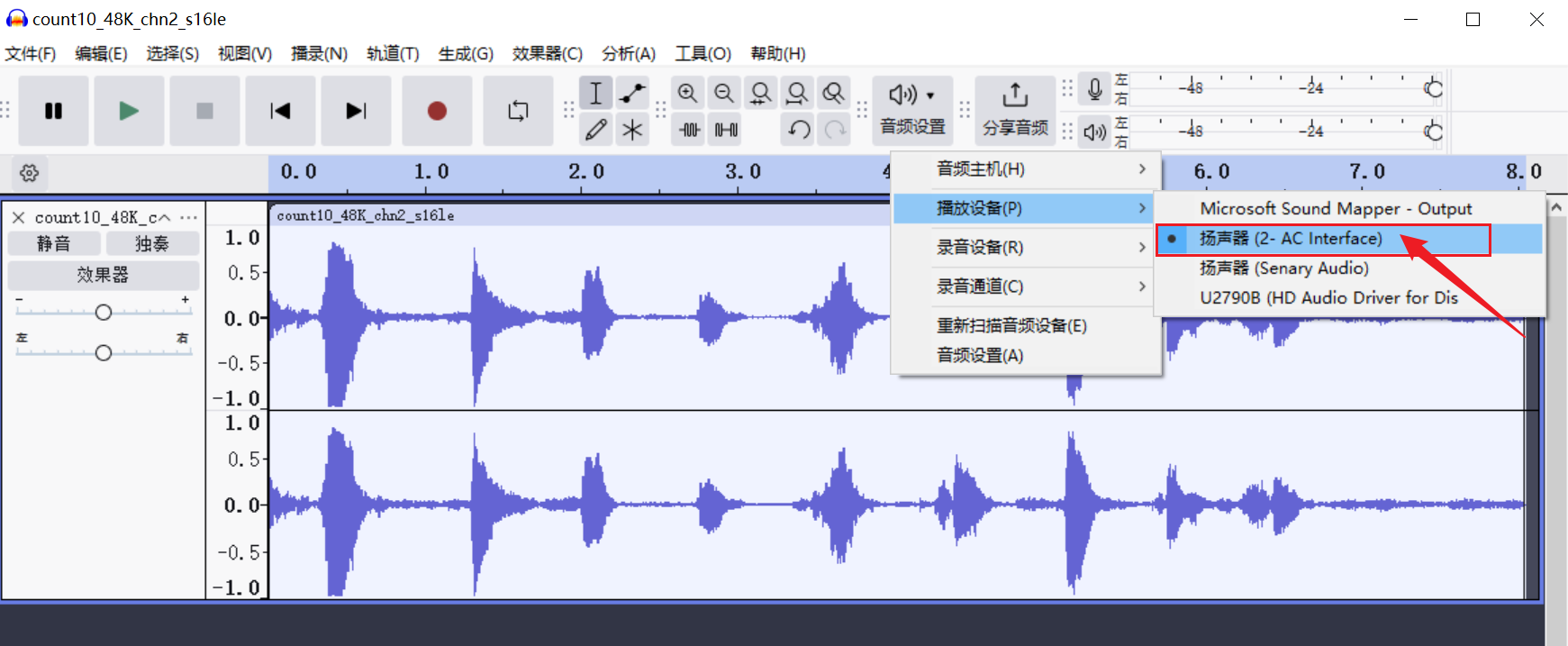

  • Test UAC1 Playback Functionality
    Note: Since the X5 EVB board lacks actual audio playback hardware, we verify playback functionality by recording the audio output.
    On the host, open an audio player and select the UAC1 playback device.
    Using Audacity as an example, select a test audio clip and choose the UAC1 playback device (in this example, 2-AC Interface), then click play.
Run the following command on the device:
arecord -f dat -t wav -r 48000 -c 2 -D hw:1,0 /userdata/rec.wav
This command records from Card1 (UAC1Gadget), specifying WAV format, 48kHz sample rate, stereo, and saves it as /userdata/rec.wav.

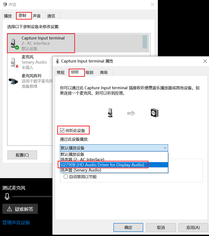

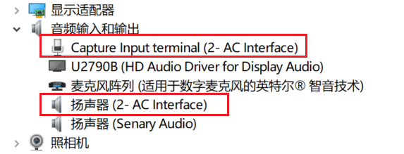

  • Test UAC1 Recording Functionality
    Note: Since the X5 EVB board lacks a microphone, we verify recording functionality by playing an audio file through the UAC1 device.
    Use Windows’ audio loopback (listen to recording) feature to monitor the recorded audio in real time:
    On the host, go to Sound Settings -> Sound Control Panel -> Recording -> Properties -> Listen, check “Listen to this device” (in this example, 2-AC Interface), and select a speaker for output.
aplay /userdata/play.wav -c 2 -r 48000 -D hw:1,0
This command plays the audio file through Card1 (UAC1Gadget), specifying WAV format, 48kHz sample rate, and stereo.

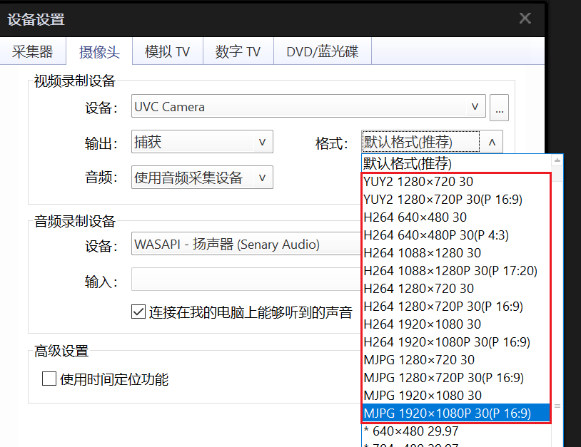

Current X5 UVC supported resolutions and formats:
Format Resolution
YUV 1280 x 720
H264 640 x 480
1088 x 1280
1280 x 720
1920 x 1080
MJPEG 1280 x 720
1920 x 1080
The UVC resolution list is set in two locations below. If users customize the list, ensure content and order remain consistent.

Obtain UVC resolution list using PotPlayer

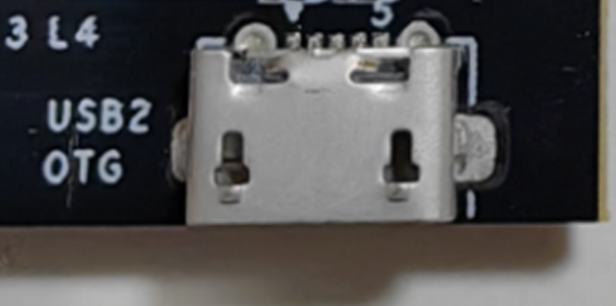

Which interfaces correspond to USB 2.0 and USB 3.0 on the X5 EVB board?
  • USB 2.0 corresponds to the Micro-USB interface
  • USB 3.0 corresponds to the USB Type-A interface

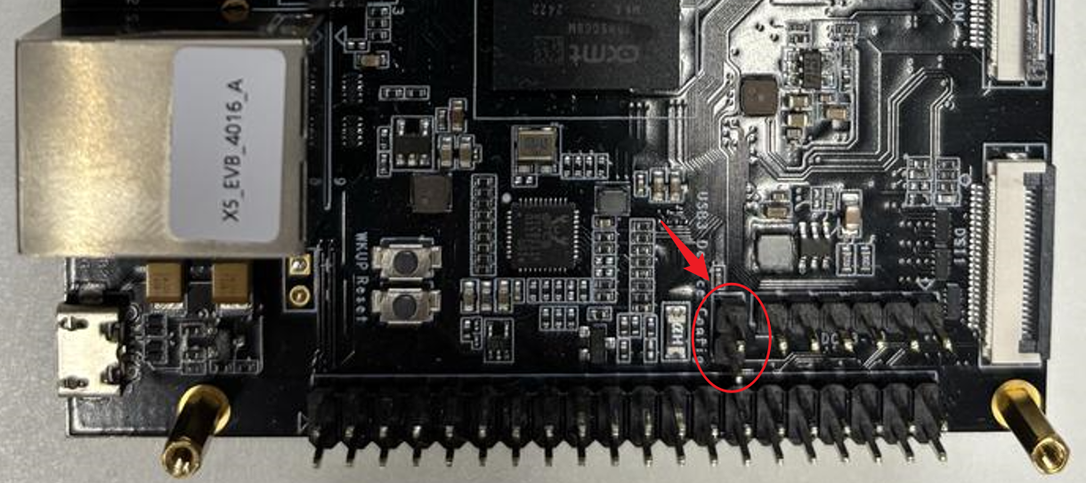

How to switch USB 3.0 between Host and Device modes
USB 3.0 defaults to Host mode. Users can switch to Device mode via software or hardware methods:
  • Hardware method
Short the jumper pins; after boot, USB 3.0 will automatically switch to Device mode
