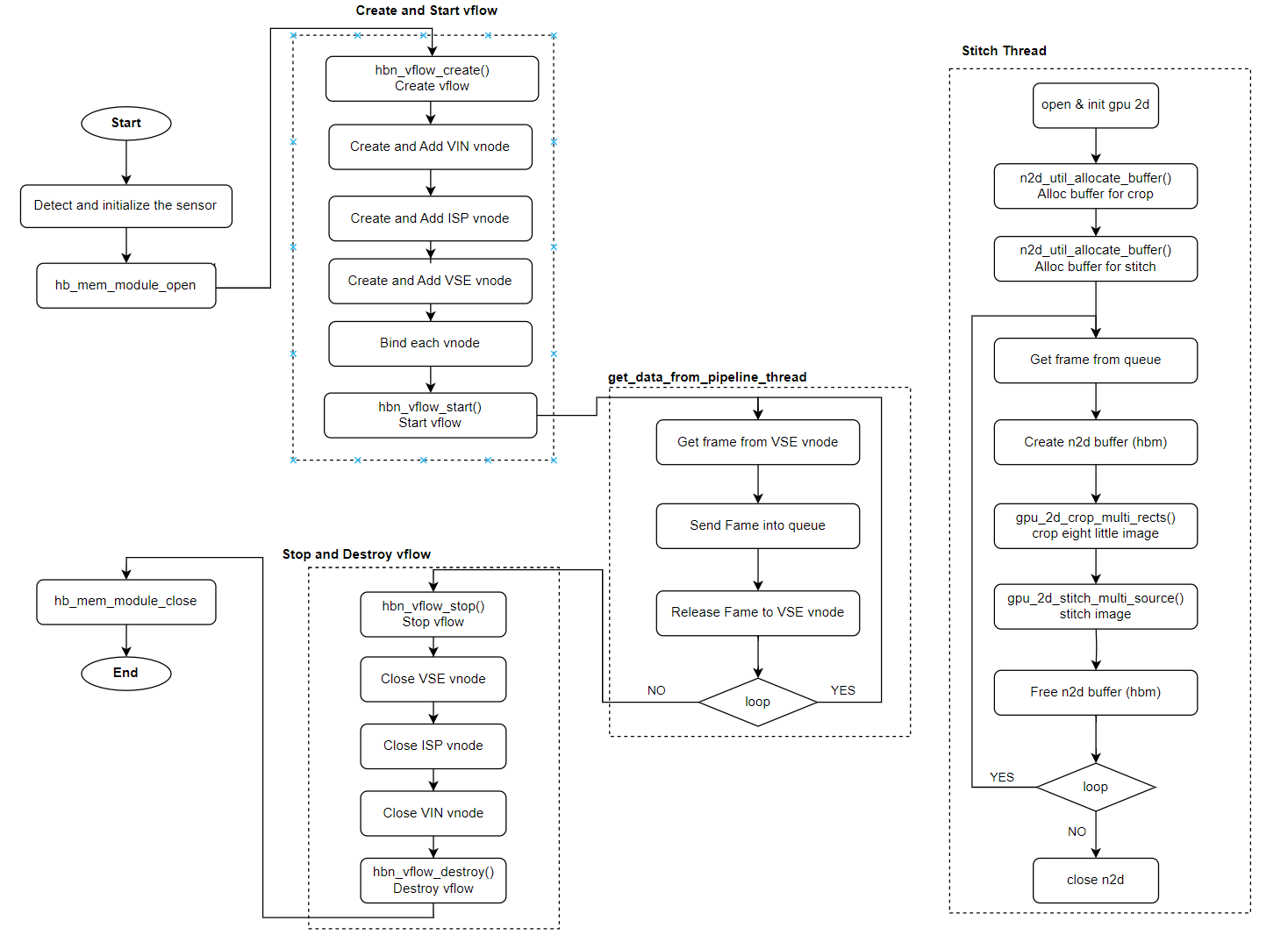

multi_pipe_crop_and_stitch Test case for multi-sensor cropping and stitching

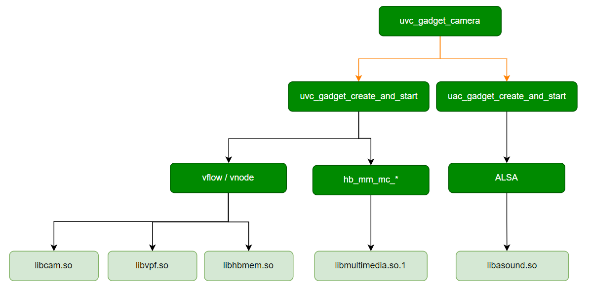

uvc_gadget_camera Virtual UVC test case

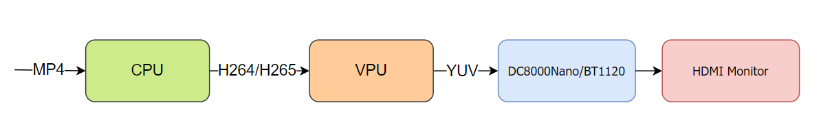

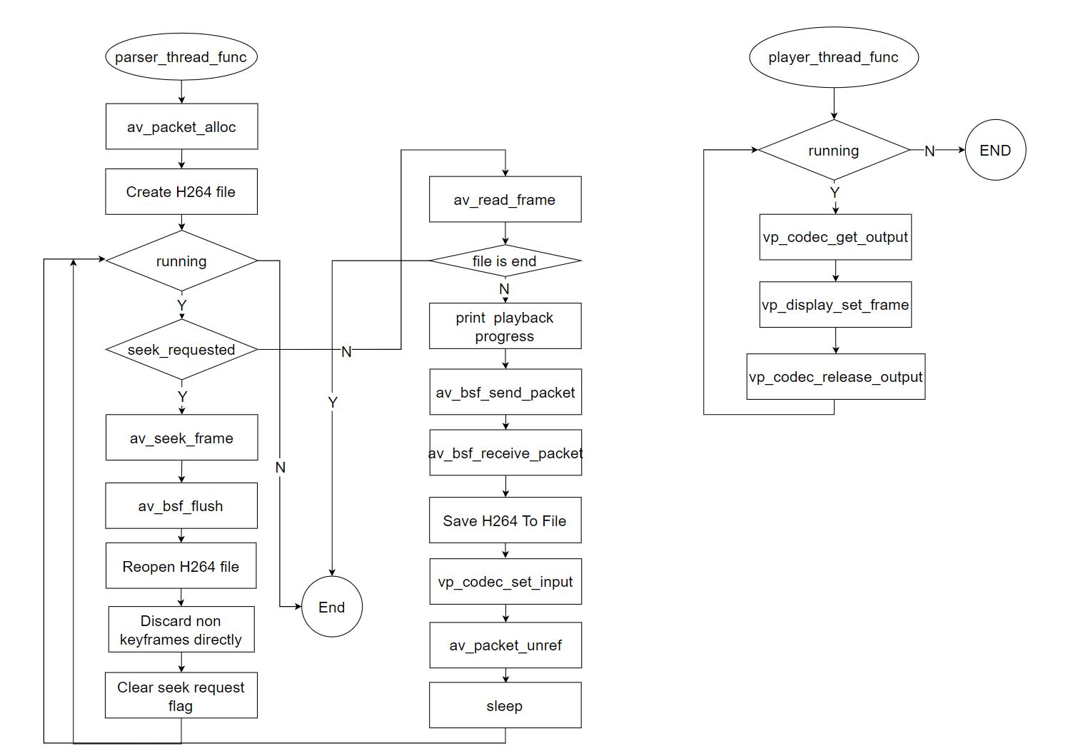

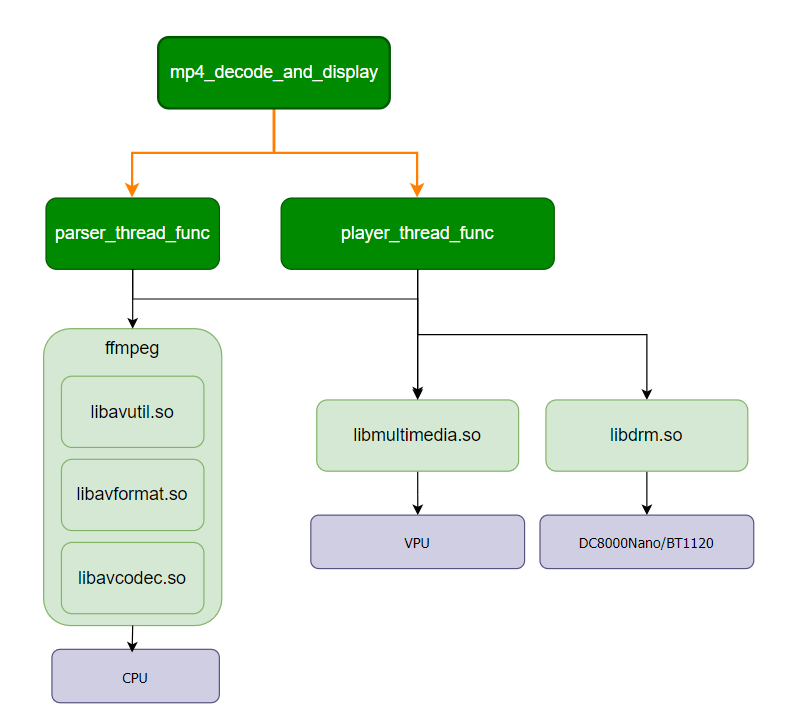

mp4_decode_and_display Use case for displaying MP4 files via HDMI after decoding through the VPU

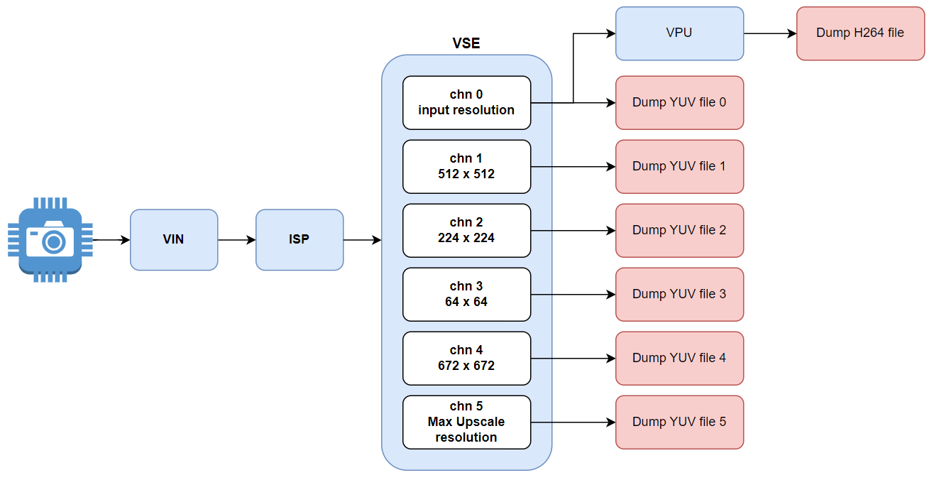

3.15.2. single_pipe_vin_isp_vse
3.15.2.1. Functional Overview

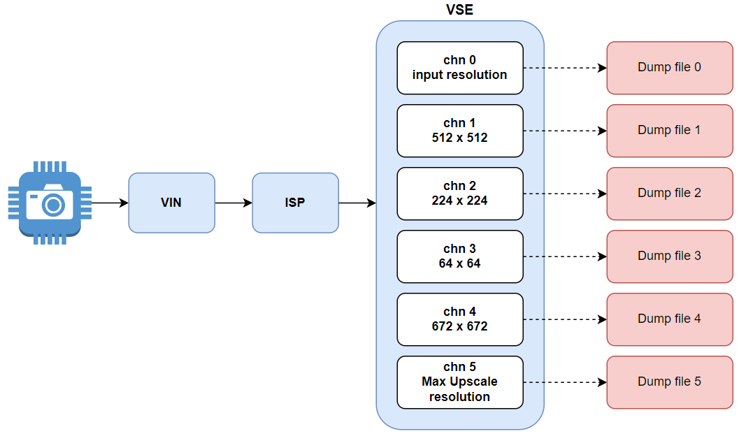

The single_pipe_vin_isp_vse example cascades the MIPI CSI, VIN, ISP, and VSE modules. It is one of the most basic examples demonstrating the connection of modules in a video pipeline. Users can refer to this example to understand the creation methods of vnode and vflow.
After the Camera Sensor image passes through VIN and ISP processing, it reaches the VSE module. The VSE module is configured with six output channels as follows:
  • Channel 0: Outputs the original resolution image after ISP processing.
  • Channel 1: Outputs a commonly used algorithm image resolution of 512 x 512, aligned to 16 pixels.
  • Channel 2: Outputs a commonly used algorithm image resolution of 224 x 224, not aligned to 16 pixels.
  • Channel 3: Outputs an image with width and height each cropped by half around the original center point. The output width and height equal the ROI region dimensions, scaled down to the supported minimum resolution: 64 x 64.
  • Channel 4: Outputs a commonly used algorithm image resolution: 672 x 672.
  • Channel 5: Outputs an image scaled up to the maximum supported resolution (Note: Images can be scaled up to 4x maximum, and only this channel supports scaling up): 4096 x 3076.

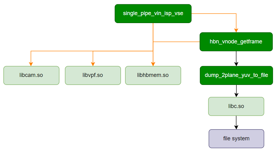

Software Architecture Description
Data Flow Description
Code Location and Directory Structure
  • Code location: app/samples/platform_samples/sample_pipeline/single_pipe_vin_isp_vse
  • Directory structure
├── Makefile
├── single_pipe_vin_isp_vse
└── single_pipe_vin_isp_vse.c

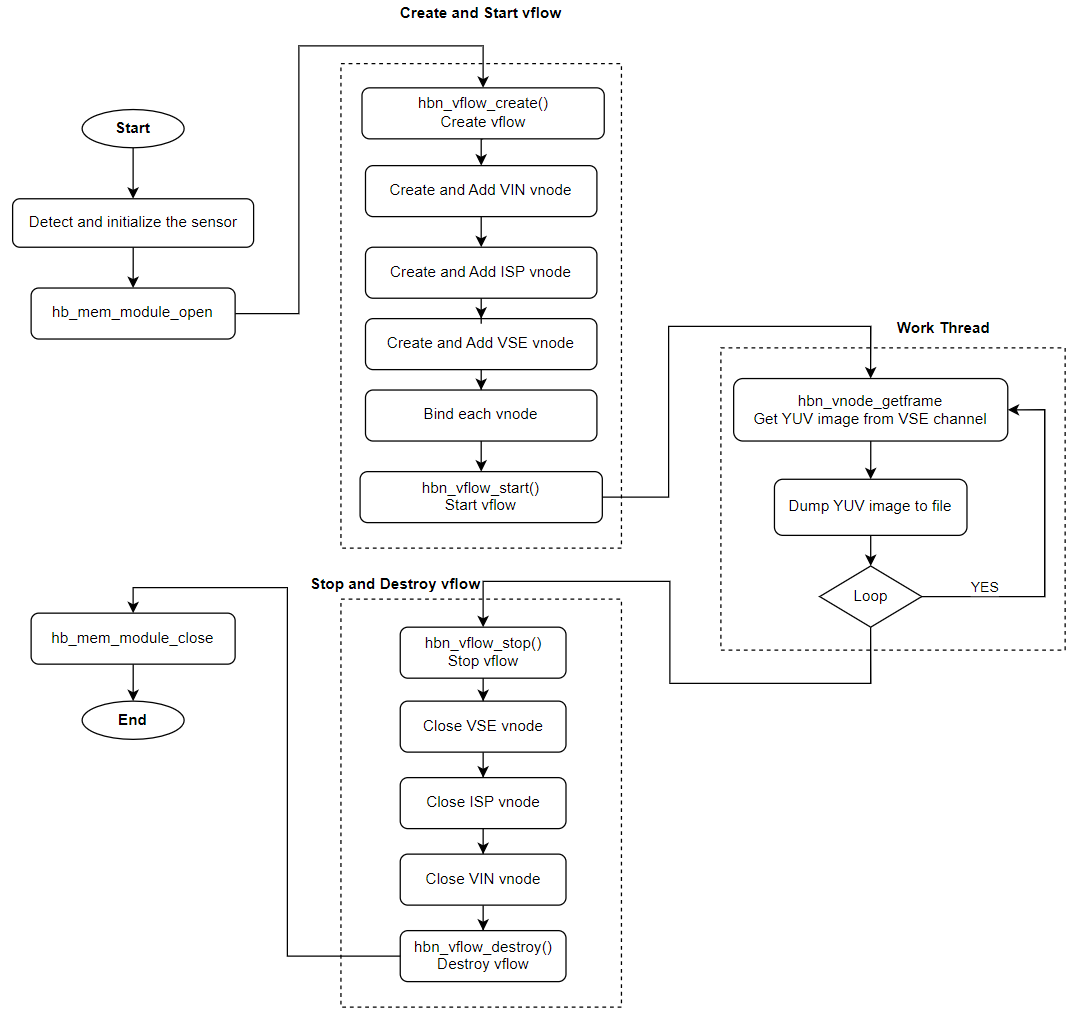

API Flow Description

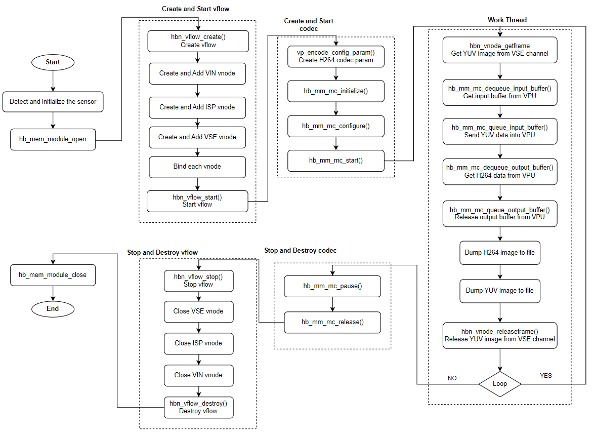

3.15.3. single_pipe_vin_isp_vse_vpu
3.15.3.1. Functional Overview

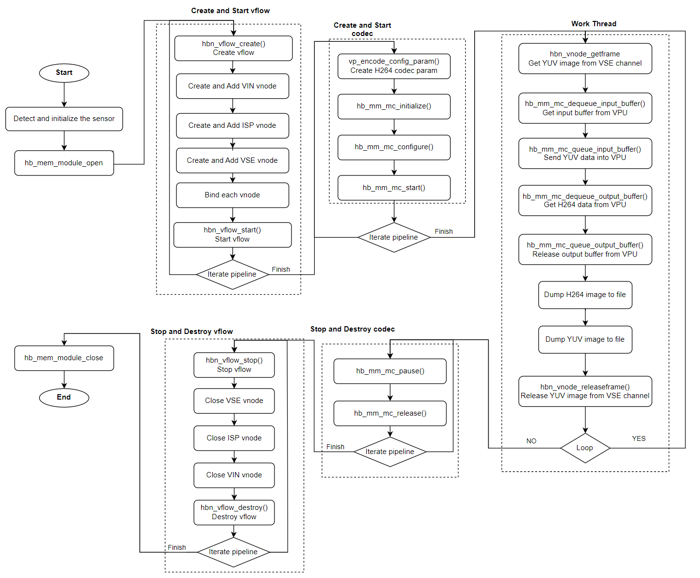

The single_pipe_vin_isp_vse_vpu example cascades the MIPI CSI, VIN, ISP, VSE, and CODEC modules, forming one of the most basic module cascading examples. After the Camera Sensor image undergoes VIN and ISP processing, it reaches the VSE module. The VSE module is configured with six output channels as follows:
  • Channel 0: Outputs the original resolution image after ISP processing. The output from this channel is further sent to the encoder and saved as an H.264 video stream.
  • Channel 5: Outputs an image scaled up to the maximum supported resolution (Note: Images can be scaled up to 4x maximum): 4096 x 3076.

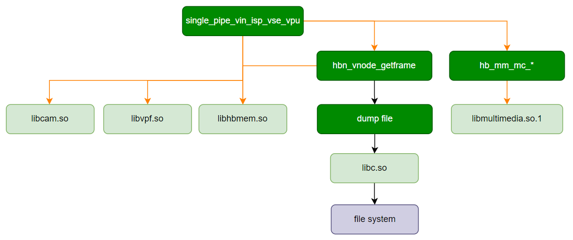

  • Code location: app/samples/platform_samples/sample_pipeline/single_pipe_vin_isp_vse_vpu
├── Makefile
├── single_pipe_vin_isp_vse_vpu
└── single_pipe_vin_isp_vse_vpu.c

single_pipe_vin_isp_vse_vpu saves one NV12 image from each output channel every 60 frames into the current running directory and saves the H.264 encoded file from VSE channel 0.
Example: Using sc230ai as the sensor input, execute ./single_pipe_vin_isp_vse_vpu -s 3. Please select the corresponding index based on the currently connected sensor.
Sample log output is shown below:
# ./single_pipe_vin_isp_vse_vpu -s 3
[INFO] board_id is 0x0202, not need skip sci1.
mipi mclk is configed.
hbn_vnode_set_ochn_attr: 0, 1920x1080
hbn_vnode_set_ochn_attr: 1, 512x512
hbn_vnode_set_ochn_attr: 2, 224x224
hbn_vnode_set_ochn_attr: 3, 64x64
hbn_vnode_set_ochn_attr: 4, 672x672
hbn_vnode_set_ochn_attr: 5, 3840x2160
[   34.670395] hobot-sif 3d020000.sif: sif frame size incorrect, hsize count:0x780 vsize count:0x0 for inst:0
[   34.703353] hobot-sif 3d020000.sif: sif frame size incorrect, hsize count:0x780 vsize count:0x438 for inst:0
Encode idx: 0, init successful
lunch read_vse_data thread

The program will generate the following files at runtime:
single_pipe_vin_isp_vse_vpu.h264
vse_ch0_0.yuv
vse_ch1_0.yuv
vse_ch2_0.yuv
vse_ch3_0.yuv
vse_ch4_0.yuv
vse_ch5_0.yuv
vse_ch0_60.yuv
vse_ch1_60.yuv
vse_ch2_60.yuv
vse_ch3_60.yuv
vse_ch4_60.yuv
vse_ch5_60.yuv

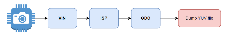

3.15.4. single_pipe_vin_isp_gdc
3.15.4.1. Function Overview
single_pipe_vin_isp_gdc demonstrates the configuration and execution of a single video input (VIN) pipeline through Image Signal Processing (ISP) and Geometric Distortion Correction (GDC).
This sample program initializes the Camera Sensor, establishes a video pipeline to GDC, and routes the ISP-processed image data to two GDC instances for further processing.

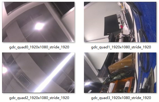

Running Results
After running this example, 4 sets of GDC binbuf configurations will be switched sequentially, and 4 output images will be saved with file names as follows:
gdc_quad0_1920x1080_stride_1920.yuv
gdc_quad1_1920x1080_stride_1920.yuv
gdc_quad2_1920x1080_stride_1920.yuv
gdc_quad3_1920x1080_stride_1920.yuv
This section uses sc230ai as an example to demonstrate the usage of single_pipe_vin_isp_vse_gdc
Run the following command:
./single_pipe_vin_isp_vse_gdc -s 3 -c vf:if
Image output is as follows:
Notes
  • Multiple different binbufs will occupy multiple ION memory blocks. Identical binbufs will share the same ION memory block.

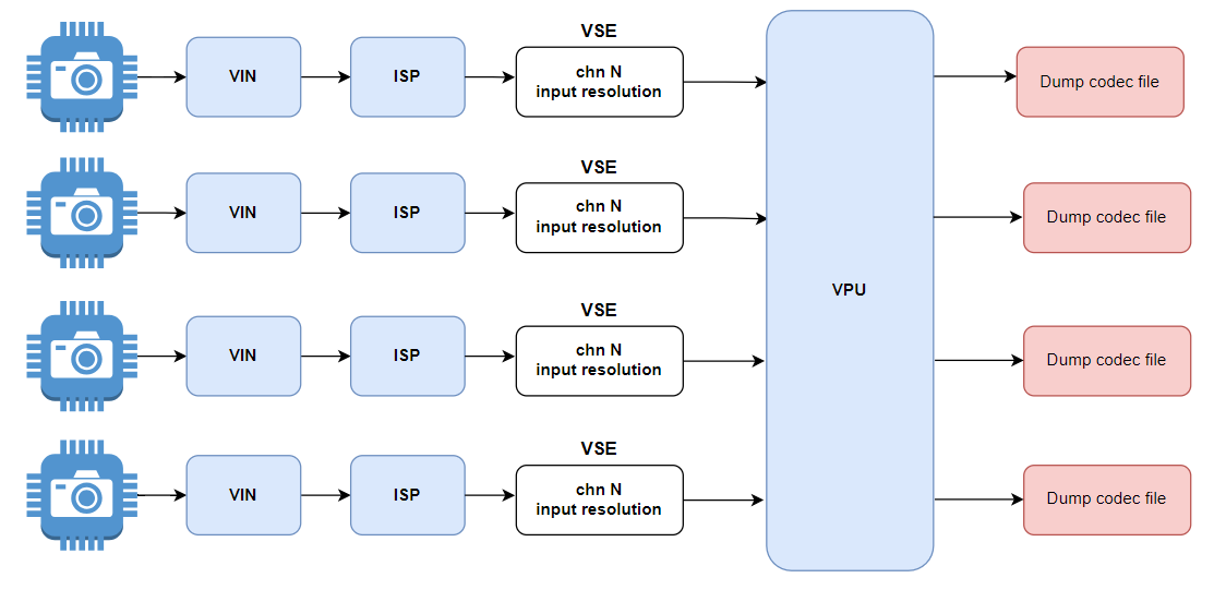

                mode     --  Sensor mode of camera_config_t
                channel  --  Vse channel index bind to encode, default 0, can be set to [0-5].
                type     --  Encode type, default is h264, can be set to [h264, h265].
                output   --  Save codec stream data to file, default is 'pipeline[xx]_[width]x[height]_[xxx]fps.[type]'.
-v, --verbose   Enable verbose mode
-h, --help      Show help message
  • -c, --config="sensor=id channel=vse_chn type=TYPE output=FILE"
    • Configures parameters for each video pipeline. This option can be repeated up to 4 times to configure up to 4 video pipelines.
    • sensor is required; channel, type, and output are optional. Default values are used if not specified.
    • sensor: Sensor index (required).
    • channel: VSE channel index (optional, default 0, range [0-5]).
    • type: Encoding type (optional, default h264, supports [h264, h265]).
    • output: File to save encoded stream data (optional, default format: pipeline[xx]_[width]x[height]_[xxx]fps.[type]).
  • -v, --verbose
    • Enables verbose mode.
  • -h, --help
    • Displays help message.
Note: To adjust the number of video pipelines, simply increase or decrease the number of -c parameter sets. Up to 4 video pipelines are supported.
Runtime Behavior
This section demonstrates the use of multi_pipe_vin_isp_vse with two video pipelines.
./multi_pipe_vin_isp_vse -c "sensor=2 channel=0 type=h264 output=output0.h264" -c "sensor=8 channel=1 type=h265 output=output1.h265" -v
Pipeline configuration details:
  • Pipeline 0: sensor=2 channel=0 type=h264 output=output0.h264
    • Sensor name: sc230ai-10fps
    • VSE channel: 0
    • Encoding type: h264
    • Output file: output0.h264
  • Pipeline 1: sensor=8 channel=1 type=h265 output=output1.h265
    • Sensor name: imx415-30fps-2lane
    • VSE channel: 1
    • Encoding type: h265
    • Output file: output1.h265

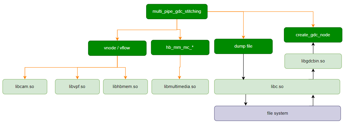

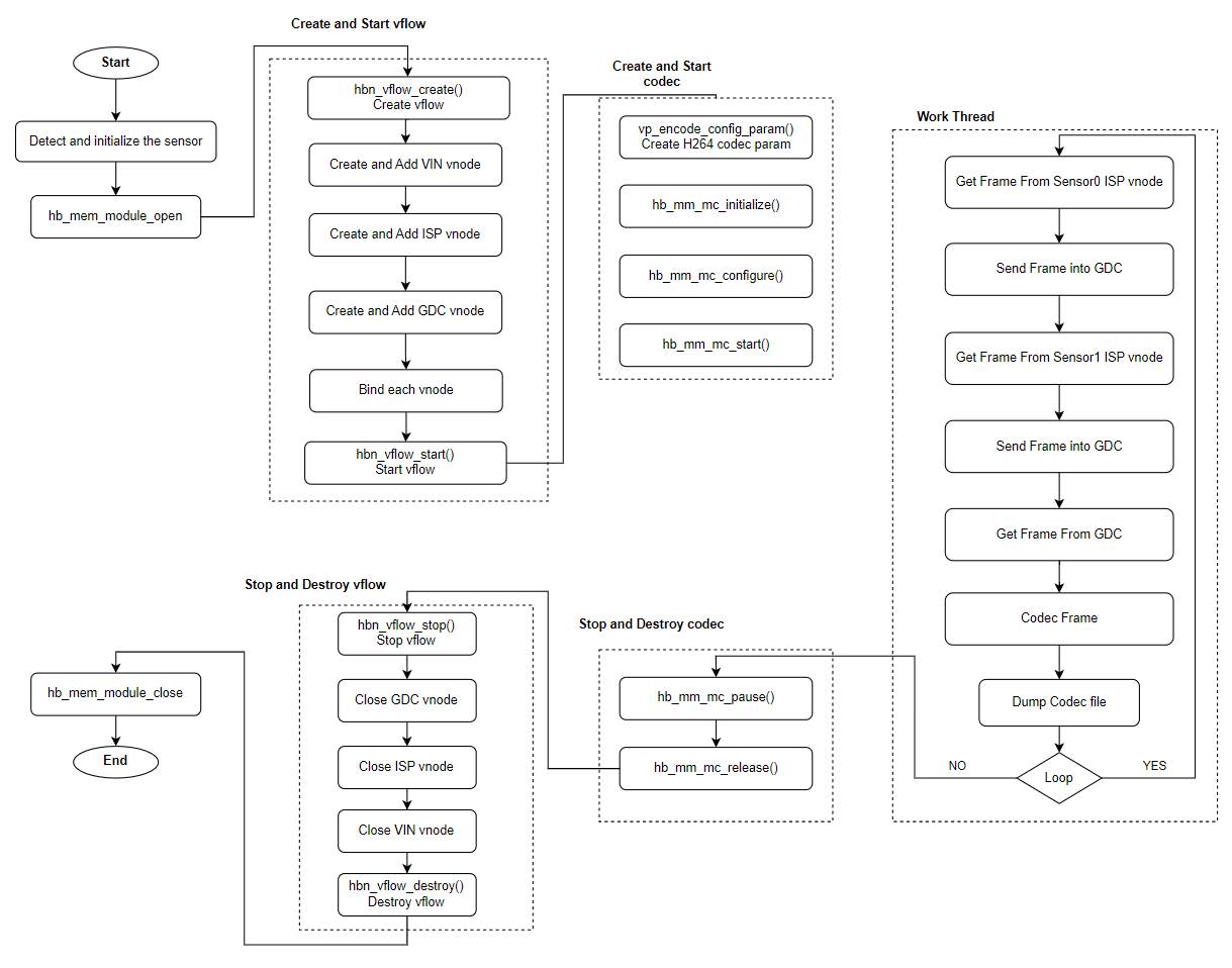

3.15.7. multi_pipe_gdc_stitching
3.15.7.1. Function Overview
The multi_pipe_gdc_stitching program acquires images from two sensors with identical resolution, performs GDC stitching, and encodes the stitched output into an h264 video.
  • Code location: app/samples/platform_samples/sample_pipeline/multi_pipe_gdc_stitching
├── Makefile
├── multi_pipe_gdc_stitching
└── multi_pipe_gdc_stitching.c
3.15.7.2. Build and Deployment
Build
  • Enter the multi_pipe_gdc_stitching directory and run make to compile.
  • The output binary is multi_pipe_gdc_stitching located in the source directory.
  • For detailed build instructions, refer to the Build Method section.
Program Deployment
After uploading multi_pipe_gdc_stitching to the development board, run chmod +x multi_pipe_gdc_stitching to grant execution permissions.
3.15.7.3. Run
How to Run the Program
Running ./multi_pipe_gdc_stitching directly displays the help message.
Program Option Descriptions
Usage: multi_pipe_gdc_stitching [Options]
Options:
-c, --config="sensor=id"
                Configure parameters for each video pipeline, can be repeated up to 2 times.
                sensor   --  Sensor index, can have multiple parameters, reference sensor list.
  • -c, --config="sensor=id"
    • Configures parameters for each video pipeline. Currently supports up to 2 camera configurations.
  • -v, --verbose
  • -h, --help
Note: Two cameras with the same resolution must be configured.
Runtime Behavior
Example log output:
# ./multi_pipe_gdc_stitching -c "sensor=3" -c "sensor=3"
mipi mclk is not configed.
Searching camera sensor on device: /proc/device-tree/soc/cam/vcon@1 i2c bus: 1 mipi rx phy: 1
WARN: Sensor Name: sc230ai-30fps, Expected Chip ID: 0xCB34, Actual Chip ID Read: 0x00
Searching camera sensor on device: /proc/device-tree/soc/cam/vcon@2 i2c bus: 2 mipi rx phy: 2
Searching camera sensor on device: /proc/device-tree/soc/cam/vcon@3 i2c bus: 7 mipi rx phy: 3
INFO: Found sensor_name:sc230ai-30fps on mipi rx csi 3, i2c addr 0x30, config_file:linear_1920x1080_raw10_30fps_1lane.c
total_pipeline_num:2
Pipeline index 0:
        Sensor index: 3
        Sensor name: sc230ai-30fps
        Active mipi host: 0
Pipeline index 1:
        Sensor index: 3
        Active mipi host: 3
Encode type: h264
Output file: pipeline1_1920x1080_30fps.h264
MIPI host: 0x9
  Host 0: Used
Verbose: 0
Create Encode idx: 0, init successful
q
^C[  145.555162] [VPF ops]:[L153][S2][gdc0] vpf_safety_close: sudden close
[  145.561818] vin sensor1: sensor_frame_end_stop_wait 488 fe 0ms abort
[  145.569080] [VPF ops]:[L153][S1][vin3] vpf_safety_close: sudden close
[  145.577640] [VPF ops]:[L153][S1][isp0] vpf_safety_close: sudden close
[  145.589144] vin sensor0: sensor_frame_end_stop_wait 509 fe 0ms abort
[  145.596381] [VPF ops]:[L153][S0][vin0] vpf_safety_close: sudden close
[  145.604412] [VPF ops]:[L153][S0][isp0] vpf_safety_close: sudden close
After running, the following encoded video file will be saved:

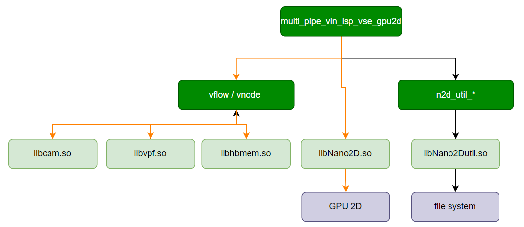

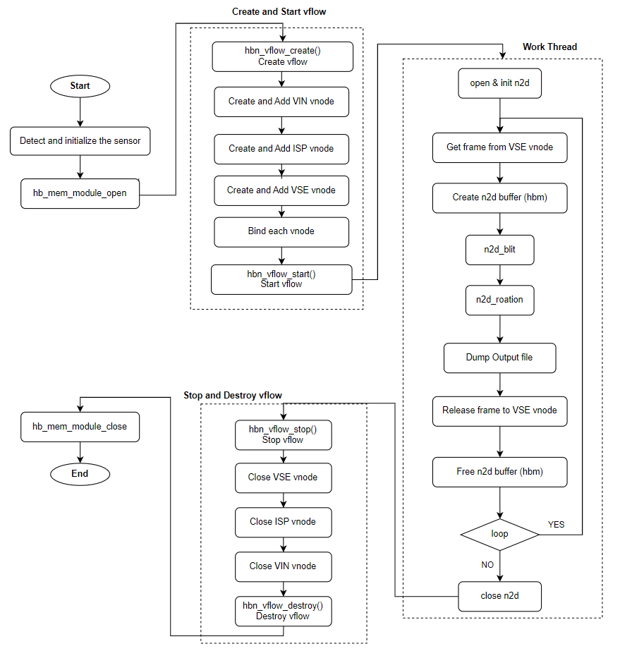

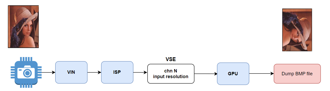

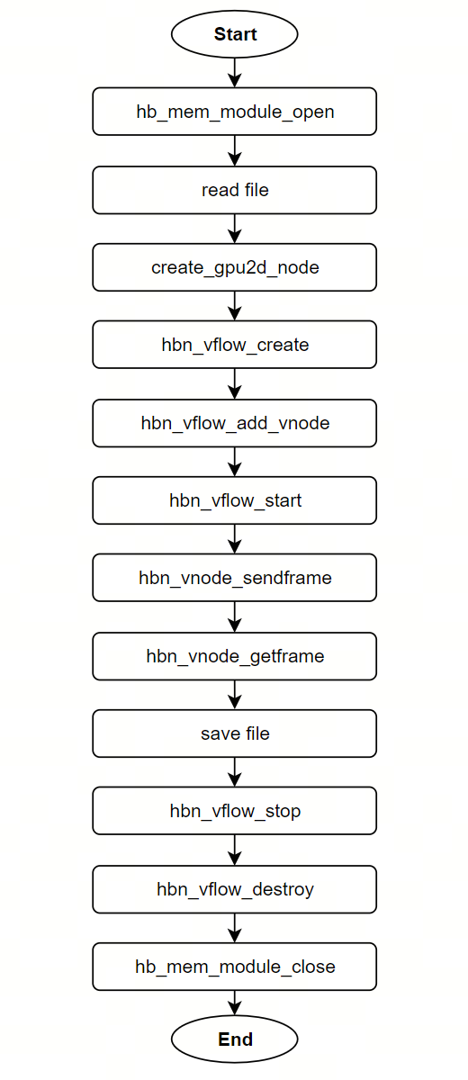

3.15.8. multi_pipe_vin_isp_vse_gpu2d
3.15.8.1. Function Overview
multi_pipe_vin_isp_vse_gpu2d is a test program for multiple video pipelines, completing hardware initialization and pipeline integration for MIPI CSI, VIN, ISP, VSE, and GPU2D modules. The program processes data through the SIF->ISP->VSE pipeline, applies GPU2D rotation, and saves the rotated images as BMP format files in the current directory.
  • Code location: app/samples/platform_samples/sample_pipeline/multi_pipe_vin_isp_vse_gpu2d
├── Makefile
├── create_n2d_buffer_wraper.c
├── create_n2d_buffer_wraper.h
├── multi_pipe_vin_isp_vse_gpu2d
└── multi_pipe_vin_isp_vse_gpu2d.c
3.15.8.2. Build and Deployment
Build
  • Enter the multi_pipe_vin_isp_vse_gpu2d directory and run make to compile.
  • The output binary is multi_pipe_vin_isp_vse_gpu2d located in the source directory.
Program Deployment
After uploading multi_pipe_vin_isp_vse_gpu2d to the development board, run chmod +x multi_pipe_vin_isp_vse_gpu2d to grant execution permissions.

3.15.9. multi_pipe_crop_and_stitch
3.15.9.1. Function Overview
multi_pipe_crop_and_stitch is a test program for multiple video pipelines, which completes hardware initialization and pipeline connection for modules including MIPI CSI, VIN, ISP, VSE, 2D GPU, and CODEC. Users can refer to this program to learn how to use the HBN API to create multiple video vflow pipelines and use the 2D GPU to achieve image cropping, scaling, and stitching.
Key steps are as follows:
  1. Two video streams are captured simultaneously and scaled to 4K via VSE.
  2. Extract 640×480 images from the top-left, top-right, bottom-left, and bottom-right corners of each video stream, resulting in 8 small images.
  3. Scale up the 8 small images obtained in step 2.
  4. Stitch the two original video frames and the 8 small images into a single 4K image.
  5. Encode the stitched image using H265 and save it to the file output.h265.
Note: Currently supported camera resolutions are: 1920×1080 and 3840×2160.

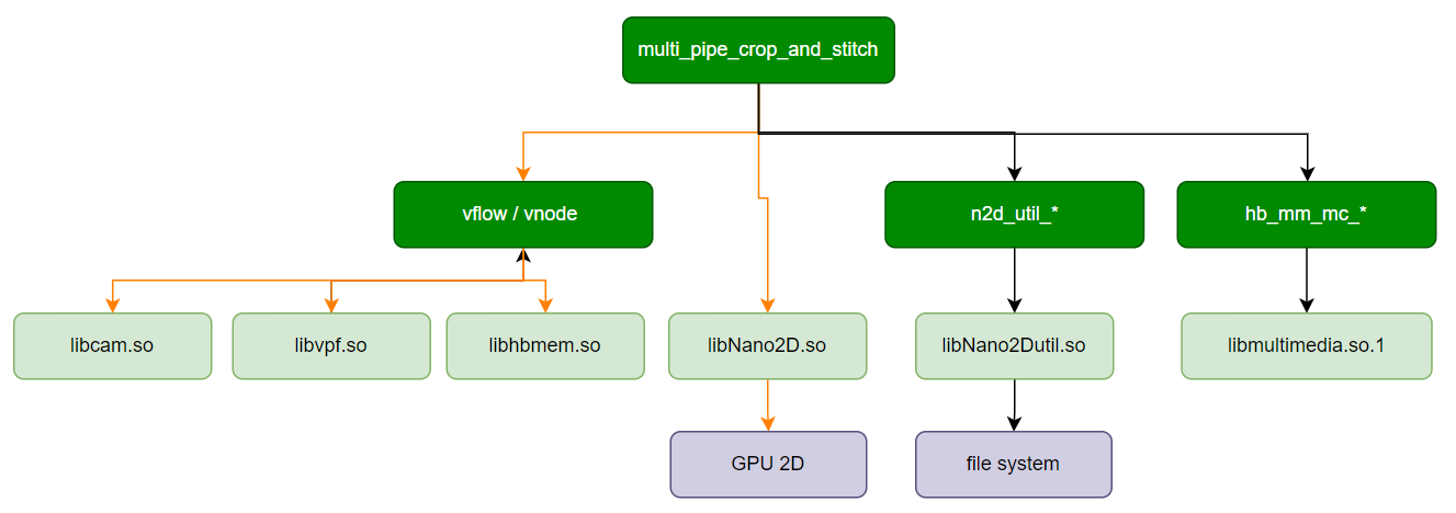

Data Flow
  • Code location: app/samples/platform_samples/sample_pipeline/multi_pipe_crop_and_stitch
  • Directory structure:
├── Makefile
├── bpu_limit.sh
├── multi_pipe_crop_and_stitch
├── multi_pipe_crop_and_stitch.c
├── param_parser.c
├── param_parser.h
├── qos.sh
├── qos_read.sh
├── run_gdc_yolo_h264_mjpeg.sh
├── run_gdc_yolo_h265.sh
├── run_gdc_yolo_hdmi.sh
└── run_noqos.sh
API Flow
3.15.9.2. Build and Deployment
Build
  • Enter the multi_pipe_crop_and_stitch directory and run make to compile.
  • The output binary is multi_pipe_crop_and_stitch in the source directory.
  • For detailed build instructions, see the Build Method section.
Program Deployment
After uploading multi_pipe_crop_and_stitch to the development board, run chmod +x multi_pipe_crop_and_stitch to make it executable.
3.15.9.3. Run
Running the Program
Run ./multi_pipe_crop_and_stitch directly to get help information.
Program Options
Usage: multi_pipe_crop_and_stitch [Options]
Options:
-c, --config="sensor=id "
                Configure parameters for each video pipeline, can be repeated up to 4 times.
                sensor   --  Sensor index,can have multiple parameters, reference sensor list.
                gdc      --  Enable gdc, default is disable.
                out264   --  Enable codec h264 stream, default is disable.
                outmjpeg --  Enable codec mjpeg stream, default is disable.
                file     --  Enable codec stream save as file, default is disable.
-o, --output="file or hdmi, default is nothing output
-r, --ratio="camera image width ratio, used to blend, default is 0.0
-b, --bpu_enable        Enable bpu, default is disable
-p, --bpu_postprocess_enable    Enable bpu postprocess, default is disable
    • Configure parameters for each video pipeline. Currently supports up to two cameras, with individual settings per sensor:
      • sensor: Sensor index, refer to sensor list.
      • gdc: Enable GDC, default is 0, valid values [0-1].
      • out264: Enable H264 encoding, default is 0, valid values [0-1].
      • outmjpeg: Enable MJPEG encoding, default is 0, valid values [0-1].
      • file: Save encoded streams to file, filename format: Chn[channel_number].[codec_type].
  • -o, --output
    • Output method for the stitched image:
      • -o file: Output H265 encoded file named output.h265.
      • -o hdmi: Output to HDMI display (currently supports only 4K resolution).
  • -b, --bpu_enable
    • Enable algorithm thread for human detection using YOLOv5.
  • -p, --bpu_postprocess_enable
    • Enable algorithm post-processing.
  • -v, --verbose
    • Enable verbose logging.
  • -h, --help
    • Show help message.
Running Effect
This example uses two sc230ai sensors to demonstrate how to use multi_pipe_crop_and_stitch to test image cropping, stitching, and output H265 encoded file.
Run the following test command:
./multi_pipe_crop_and_stitch -c "sensor=3" -c "sensor=3" -o file
Sample log output:
[INFO] board_id is 202, not need skip sci1.
INFO: Found sensor_name:sc230ai-30fps on mipi rx csi 2, i2c addr 0x30, config_file:linear_1920x1080_raw10_30fps_1lane.c
mipi host 2
MIPI host: 0x4
  Host 2: Used
mipi host 3
MIPI host: 0xc
  Host 2: Used
  Host 3: Used
 Show sensor info:
  Pipeline index 0:
        Sensor index: 3
        Active mipi host: 2
        Vse Channel: 5
  Pipeline index 1:
        Sensor index: 3
        Active mipi host: 3
        Vse Channel: 5
hbn_vnode_set_ochn_attr: 3840x2160 fps:30
Codec param:
        codec type :H265
        codec fps :30
        codec width :3840
        codec height :2160
input q to stop :
During execution, the following encoded video file will be saved:

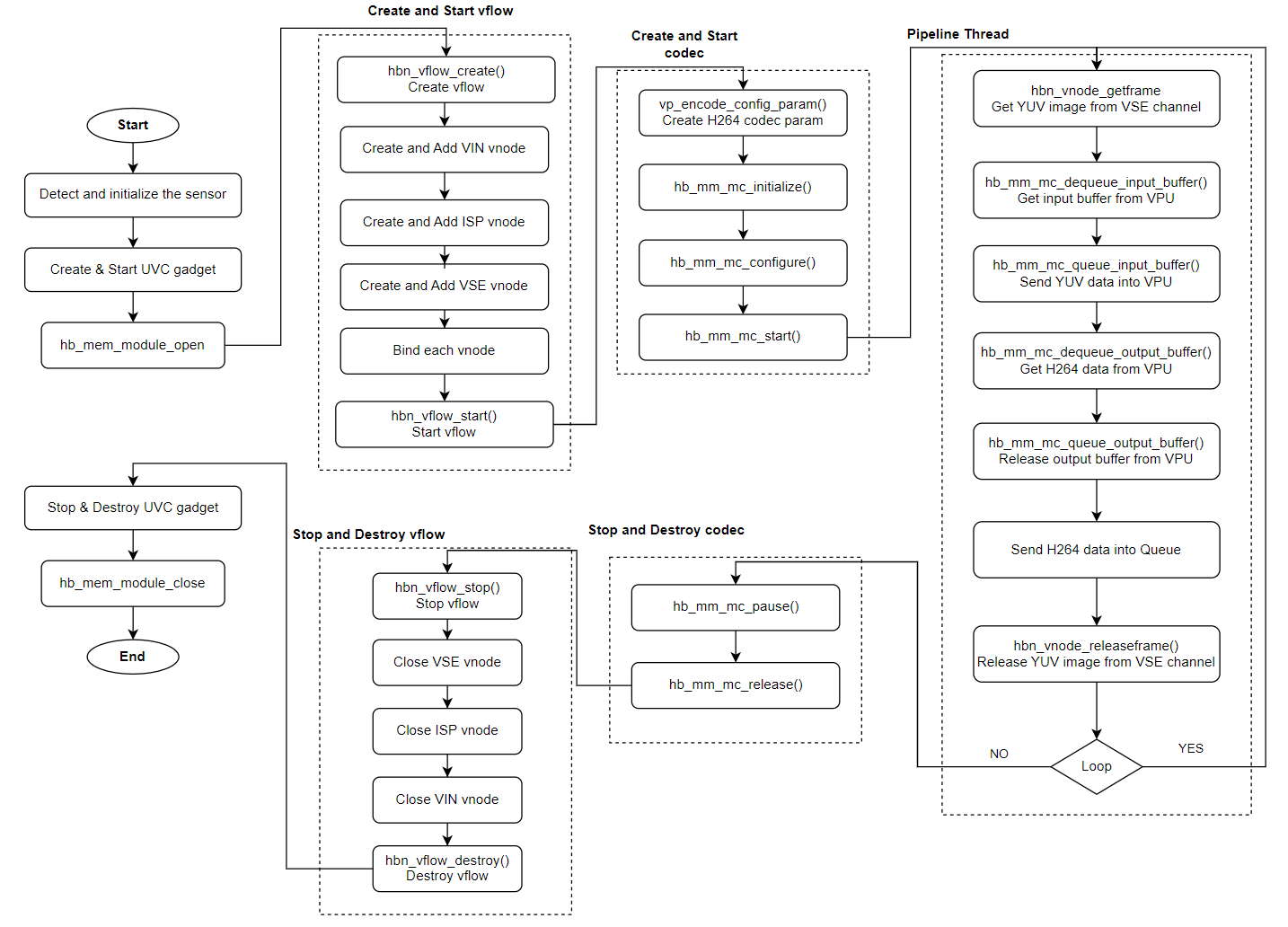

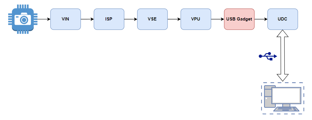

3.15.10. uvc_gadget_camera
3.15.10.1. Function Overview
uvc_gadget_camera provides the following functions:
  • Capture data from MIPI camera through CSI, VIN, ISP, VSE, CODEC, and send it to PC via USB Gadget for display. Currently supports only H264 format.
  • UAC1 plays PCM file in a loop, using default 48K sample rate, dual channel, 16-bit.
  • UAC1 records PCM file, using default 48K sample rate, dual channel, 16-bit.
Data Flow
  • Code location: app/samples/platform_samples/sample_pipeline/uvc_gadget_camera
├── Makefile
├── alsa_device.c
├── audio
│   └── count10_48K_chn2_s16le.pcm
├── include
│   ├── alsa_device.h
│   ├── uac_common.h
│   ├── uac_gadget.h
│   ├── uac_micphone.h
│   ├── uac_speaker.h
│   ├── utils.h
│   ├── uvc.h
│   ├── uvc_gadget.h
│   └── uvc_gadget_api.h
├── lib
│   └── libguvc.a
├── mqueue.c
├── mqueue.h
├── uac_gadget.c
├── uac_micphone.c
├── uac_speaker.c
├── uvc_gadget_camera
├── uvc_gadget_camera.c
├── uvc_gadget_wraper.c
├── uvc_gadget_wraper.h
├── vp_codec.c
├── vp_codec.h
├── vp_pipeline.h
└── vp_pipeline.c
API Flow
3.15.10.2. Build and Deployment
Build
  • Enter the uvc_gadget_camera directory and run make to compile.
  • The output binary is uvc_gadget_camera in the source directory.
Program Deployment
After uploading uvc_gadget_camera to the development board, run chmod +x uvc_gadget_camera to make it executable.
3.15.10.3. Run
Running the Program
Run ./uvc_gadget_camera directly to get help information.
Program Options
Usage: get_isp_data [OPTIONS]
Options:
  -s <sensor_index>      Specify sensor index
  -m <sensor_mode>       Specify sensor mode of camera_config_t
  -p <play PCM file>     Specifies the audio playback file path
  -r <record PCM file>   Specify the audio recording file path
  • -s <sensor_index>
    • Specify the Camera Sensor index.
    • Example: -s 0 means using sensor with index 0.
  • -m <sensor_mode>
    • Specify the sensor mode (sensor_mode) in camera_config_t.
    • Example: -m 6 means using mode 6 (Slave). This option is not supported by all sensors; use according to the specific Camera Sensor module design.
  • -p <play PCM file>
    • Specify the path of the PCM file to play.
    • Example: -p /userdata/play.pcm, using default 48K sample rate, dual channel, 16-bit.
  • -r <record PCM file>
    • Specify the path to save the recorded PCM file.
    • Example: -r /userdata/rec.pcm, using default 48K sample rate, dual channel, 16-bit.
  • -h
    • Show help message. Running this command will display detailed descriptions of the above options.
Running Effect
Example 1: Testing UVC
  • Connect the development board and PC using a USB data cable, refer to USB 2.0 Interface.
  • By default, the USB interface is used for ADB. Run the following commands to switch to UVC gadget mode:
/etc/init.d/usb-gadget.sh stop
/etc/init.d/usb-gadget.sh start uvc isoc
  • The appearance of device node /dev/video0 indicates successful switch:
root@buildroot:~# ls /dev/video0
/dev/video0
  • Start uvc_gadget_camera
Using sc230ai as an example, run the following command:
./uvc_gadget_camera -s 3

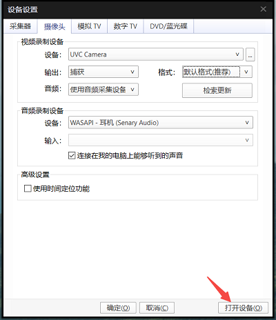

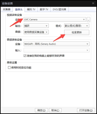

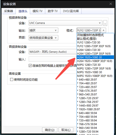

  • On the PC, open a USB Camera player such as PotPlayer. Press Alt+D to open camera settings, select “UVC Camera”, and click “Refresh”.
image-20220307220126767
  • On the PC, select the appropriate configuration based on the camera’s resolution and frame rate, then open the camera.
Notes
  • After usb-gadget.sh script starts UVC, the UVC peripheral does not appear immediately on PC. It is created only after running the uvc_gadget_camera program.
  • When opening the camera in PotPlayer on PC, if format options are not available, click “Refresh”.
  • When opening the camera in PotPlayer, ensure the format matches the actual camera parameters. Mismatched resolution or format will cause uvc_gadget_camera to exit.
Example 2: Testing UVC + UAC1
/etc/init.d/usb-gadget.sh start uvc-uac1 isoc
Using sc230ai as example, play count10_48K_chn2_s16le.pcm in loop and record audio to /userdata/rec.pcm. Use the following command:
cd /app/platform_samples/sample_pipeline/uvc_gadget_camera/
./uvc_gadget_camera -s 3 -p count10_48K_chn2_s16le.pcm -r /userdata/rec.pcm

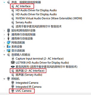

  • On the PC, Device Manager will show new UVC and UAC devices.
image-20241028220126767
Running Results
  • Run command ./uvc_gadget_camera -s 3, log output as follows (uvc_gadget_camera waits for PC client connection):
index:3 settle=-1 sensor_mode=0
##function uvc_gadget_init in
using uvc device: /dev/video0
###uvc_gadget_init###
width: 1920
height: 1080
format: 1
io_method: 0
bulk_mode: 0
nbufs: 2
mult: 2
burst: 0
speed: 3
mult_alts: 0
h264_quirk: 0
maxpkt_quirk: 3072
uvc device is dwc3-gadget on bus gadget.0
uvc open succeeded, file descriptor = 4
uvc_size=3, maxpkt_size=3072
##function uvc_gadget_init succeed
##function uvc_gadget_start in
##function uvc_gadget_start succeed
'q' for exit
##function uvc_loop in
  • When PC initiates connection and correct format is provided, the following log appears:
STREAM ON! show video info:
fcc: h264(0x34363248)
run_standalone: 1
uvc_devname: /dev/video0
mem: 0xffff9003b2a0
dummy_buf: (nil)
nbufs: 2
width: 1920
height: 1080
bulk: 0
imgsize: 0
imgdata: (nil)
maxpkt: 1024
speed: 3
mult_alts: 0
h264_quirk: 0
maxpkt_quirk: 3072

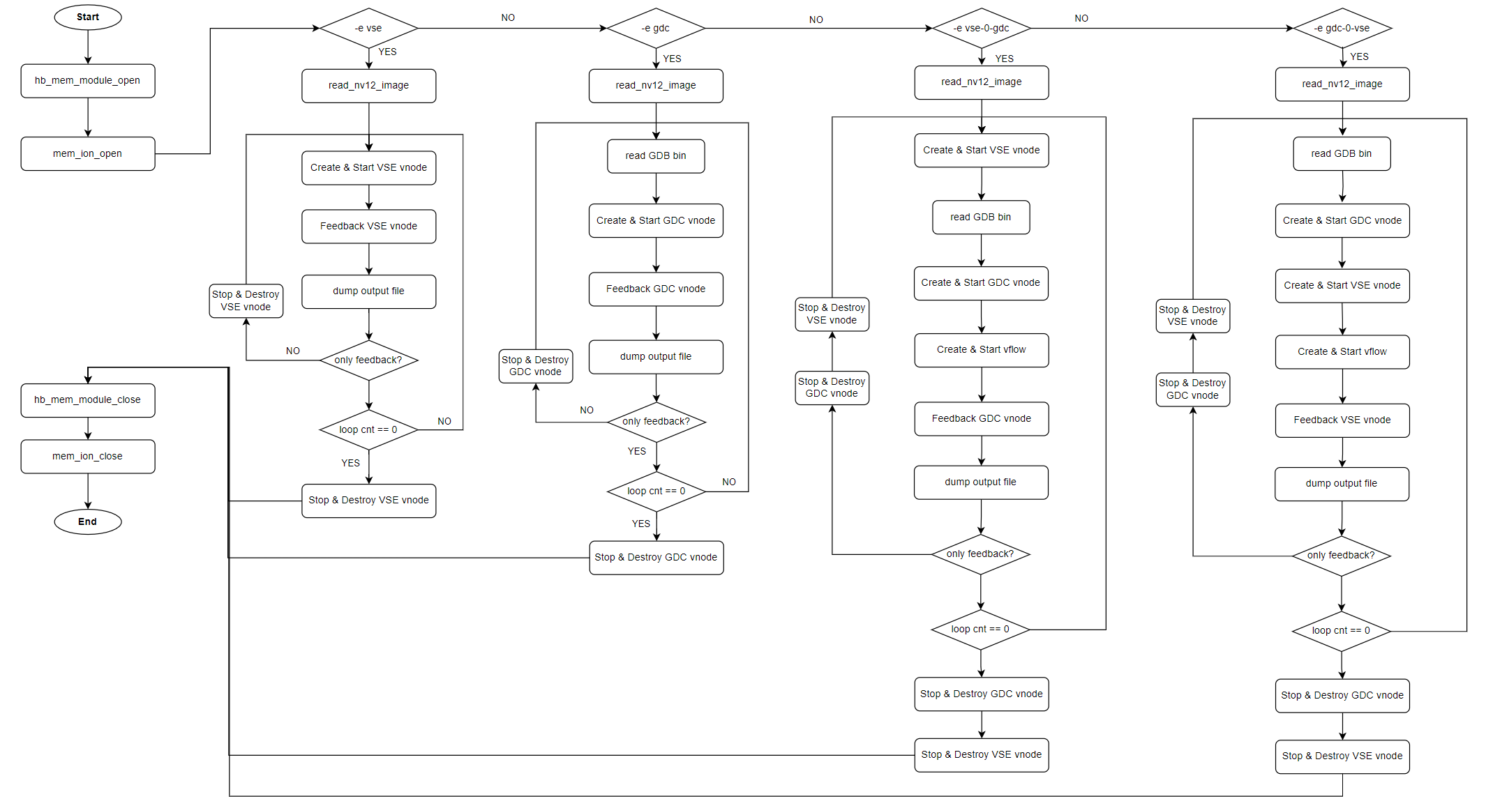

sample_custom_capbuf supports various VSE/GDC pipeline configurations via parameter options. Users can adjust parameters according to actual needs to build pipelines and verify module processing latency.

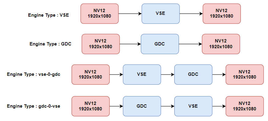

This test case uses the -e option to specify the module type to be tested. Supported module types are:
  • vse: scales an NV12 image using VSE
  • gdc: performs distortion correction on an NV12 image using GDC
  • vse-0-gdc: first scales via VSE channel 0, then applies GDC distortion correction, and outputs NV12
  • gdc-0-vse: first applies GDC distortion correction, then scales via VSE channel 0, and outputs NV12

3.15.13. mp4_decode_and_display
3.15.13.1. Function Overview
The mp4_decode_and_display sample parses the H264 or H265 raw stream from MP4 files using the ffmpeg library, sends it to the VPU for decoding, and then displays it on an HDMI monitor.
The program also supports specifying playback position after startup: after the program executes, you can specify the current playback position via command line.
Note:
  1. An HDMI monitor must be connected, and the HDMI monitor must support the resolution of the video file in the MP4
  2. Since the decoder can only start decoding from key frames, when the specified position is not a key frame, it will select an appropriate position near the specified position to start playback
Data Flow

API Flow

The execution results of mp4_decode_and_display are as follows:
  1. The video from the MP4 video file will be displayed on the HDMI display screen
  2. Starting from the most recently specified playback position, save the H264 or H265 raw stream to file output.h264 or output.h265
  3. Enter a number in the command line to specify the playback position
  4. Enter q or quit to exit the program, or press Enter after the file finishes playing to also exit the program

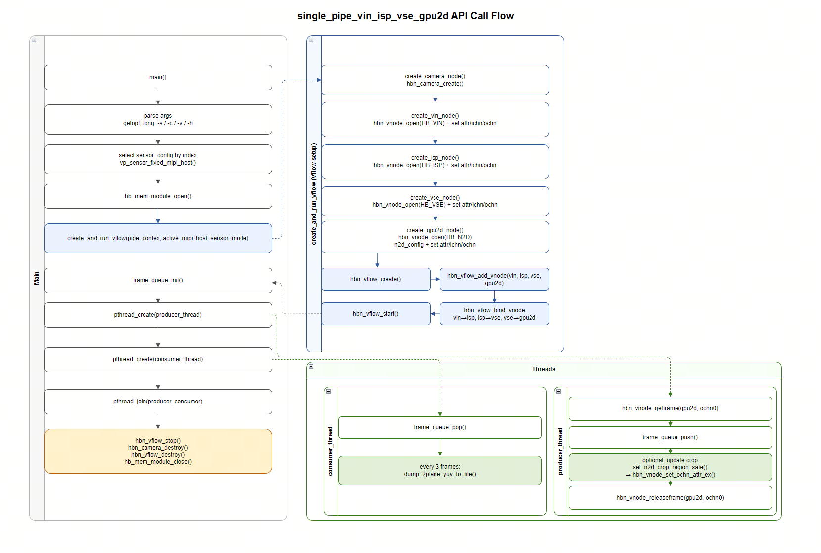

3.15.14. single_pipe_vin_isp_vse_gpu2d
3.15.14.1. Function Overview
single_pipe_vin_isp_vse_gpu2d is a sample program for testing a single video pipeline, demonstrating the complete video processing chain from Sensor → VIN → ISP → VSE → GPU2D.
The core functions of the program are:
  • Complete signal processing through VIN, ISP, and VSE modules;
  • Use GPU2D module to perform image cropping and scaling;
  • Finally save NV12 images as .yuv files through queue processing.
Data Flow
  • Code location: app/samples/platform_samples/sample_pipeline/single_pipe_vin_isp_vse_gpu2d
├── Makefile
├── single_pipe_vin_isp_vse_gpu2d
└── single_pipe_vin_isp_vse_gpu2d.c
API Flow

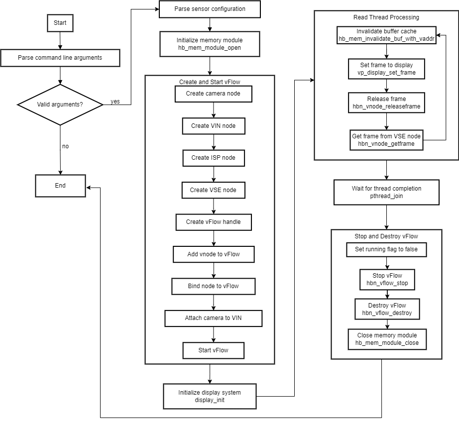

3.15.15. single_pipe_vin_isp_vse_vo
3.15.15.1. Function Overview
single_pipe_vin_isp_vse_vo is a test sample program for verifying single-channel video capture and display functionality, demonstrating the complete video data flow processing chain from Sensor → VIN → ISP → VSE → HDMI display.
  • Use DRM interface (vp_display) to display images on HDMI in real-time;
  • Automatically match the resolution supported by the display device; if the current resolution is not in the supported list, the program will attempt to find the closest available resolution; if still unable to match, it will terminate and display an error message.

Running Results
This example demonstrates how to use single_pipe_vin_isp_vse_vo with one sc230ai sensor
./single_pipe_vin_isp_vse_vo -s 3
Example log output:
hbn_vnode_set_ochn_attr: 1920x1080
[   59.491765] hobot-sif 3d020000.sif: sif frame size incorrect, hsize count:0x0 vsize count:0x438 for inst:0
Checking resolutions:
Mode 0: 2560x1440 @ 60Hz
Mode 1: 3840x2160 @ 30Hz
Mode 2: 3840x2160 @ 30Hz
Mode 3: 3840x2160 @ 25Hz
Mode 4: 3840x2160 @ 24Hz
Mode 5: 3840x2160 @ 24Hz
Mode 6: 2560x1440 @ 100Hz
Mode 7: 2560x1440 @ 75Hz
Mode 8: 1920x1080 @ 60Hz
hdmi support resolution 1920*1080
Plane 0:
  Plane ID: 64
  Src W: 1920
  Src H: 1080
  CRTC X: 0
  CRTC Y: 0
  CRTC W: 1920
  CRTC H: 1080
  Format: NV12
  Z Pos: -1
  Alpha: -1
  Pixel Blend Mode: -1
  Rotation: -1
  Color Encoding: -1
  Color Range: -1
Setting up KMS...
Checking mode 2560x1440@60.00Hz
Checking mode 3840x2160@30.00Hz
Checking mode 3840x2160@29.97Hz
Checking mode 3840x2160@25.00Hz
Checking mode 3840x2160@24.00Hz
Checking mode 3840x2160@23.98Hz
Checking mode 2560x1440@100.00Hz
Checking mode 2560x1440@75.00Hz
Checking mode 1920x1080@60.00Hz
Found resolution match: 1920x1080@60.00Hz
Checking mode 1920x1080@59.94Hz
Checking mode 1920x1080@50.00Hz
Checking mode 1280x1440@59.91Hz
Checking mode 1680x1050@59.88Hz
Checking mode 1280x1024@75.02Hz
Checking mode 1280x1024@60.02Hz
Checking mode 1440x900@59.90Hz
Checking mode 1280x720@60.00Hz
Checking mode 1280x720@59.94Hz
Checking mode 1280x720@50.00Hz
Checking mode 1024x768@75.03Hz
Checking mode 1024x768@70.07Hz
Checking mode 1024x768@60.00Hz
Checking mode 832x624@74.55Hz
Checking mode 800x600@75.00Hz
Checking mode 800x600@72.19Hz
Checking mode 800x600@60.32Hz
Checking mode 800x600@56.25Hz
Checking mode 720x576@50.00Hz
Checking mode 720x480@60.00Hz
Checking mode 720x480@59.94Hz
Checking mode 640x480@75.00Hz
Checking mode 640x480@72.81Hz
Checking mode 640x480@66.67Hz
Checking mode 640x480@60.00Hz
Checking mode 640x480@59.94Hz
Checking mode 720x400@70.08Hz
Using resolution-matched mode: 1920x1080@60.00Hz
vp_display_init ok: 1920x1080 -> 1920x1080
After the program runs, the display will show the image content from the sensor in real-time.
3.15.16. single_format_convert_gpu2d
3.15.16.1. Function Overview
single_format_convert_gpu2d is a test example program for verifying image format conversion using 2D GPU. It demonstrates NV12 to BMP, NV12 to YUV422, YUV422 to BMP, and YUV422 to NV12 conversions.
  • Read the image file to be converted;
  • Create a 2D GPU node, and create and start a vflow;
  • Send data to and retrieve data from the 2D GPU node;
  • Save the retrieved data to the specified path.

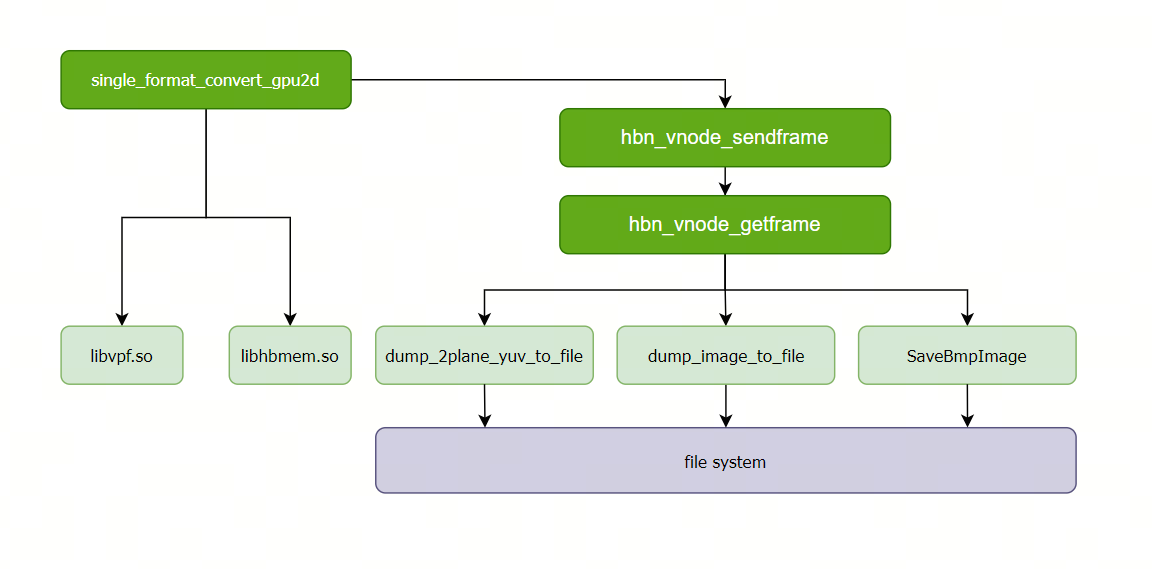

  • Code location: app/samples/platform_samples/sample_pipeline/single_format_convert_gpu2d
├── Makefile
├── bmp.c
├── bmp.h
├── res/nv12_1920x1080.yuv
├── res/yuv422_1920x1080.yuv422
├── single_format_convert_gpu2d
└── single_format_convert_gpu2d.c

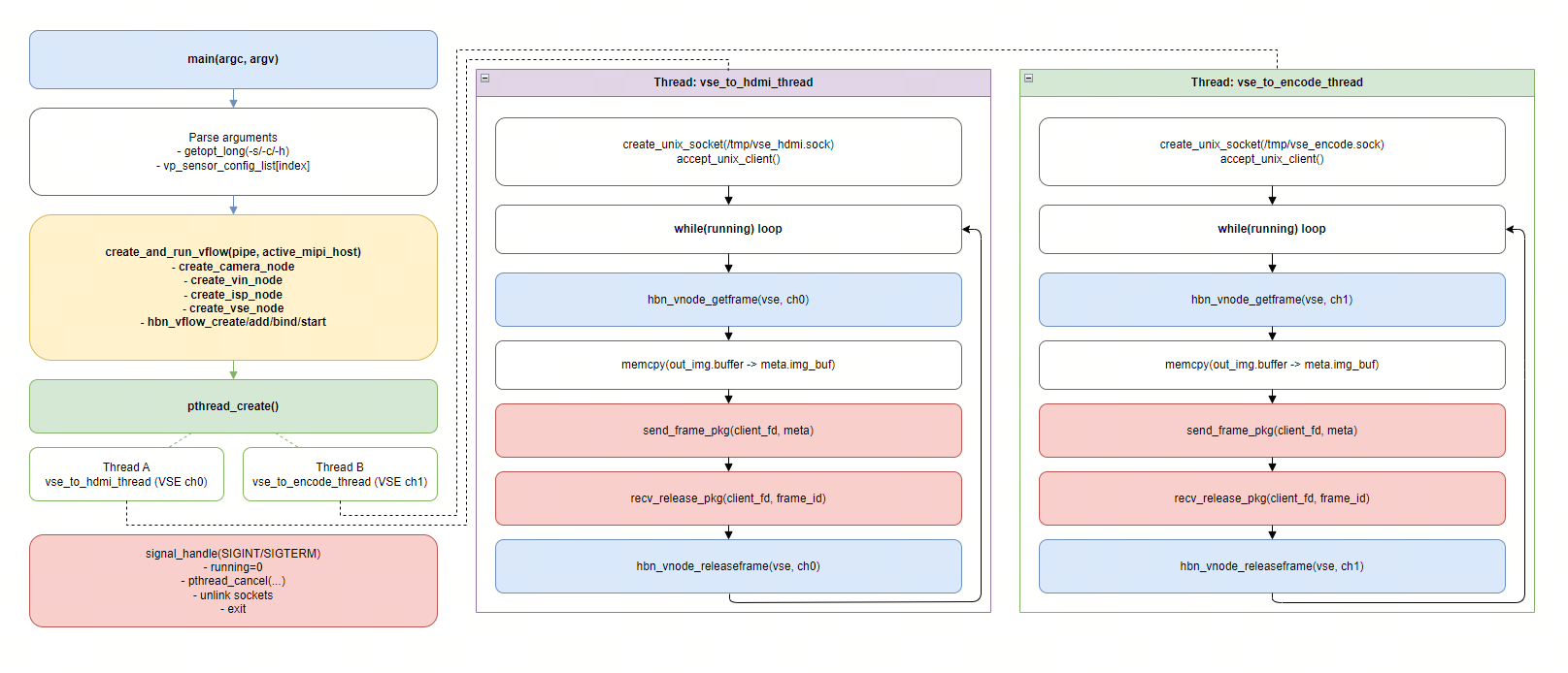

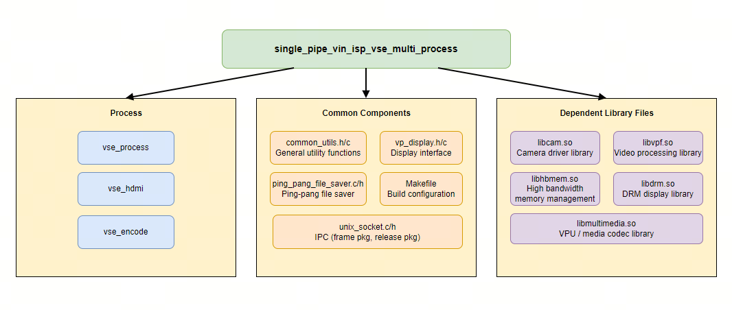

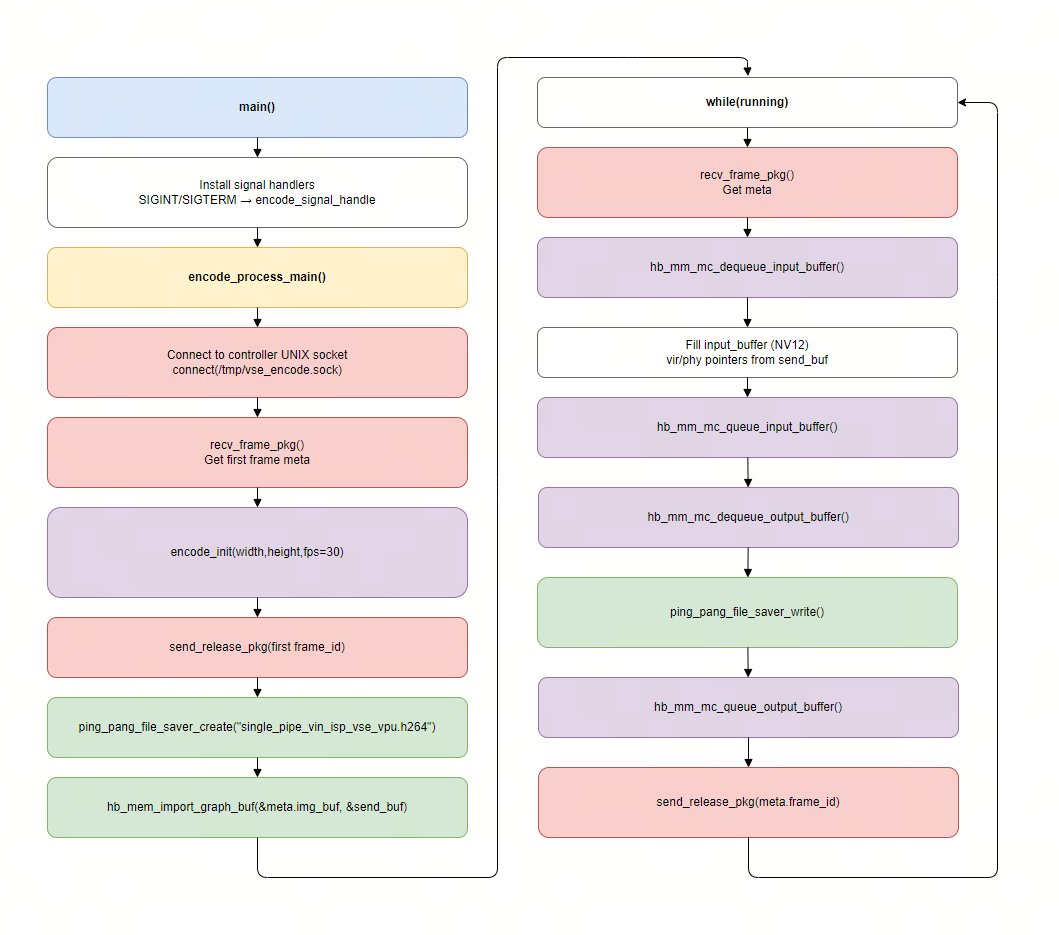

3.15.17. single_pipe_vin_isp_vse_multi_process
3.15.17.1. Function Overview
single_pipe_vin_isp_vse_multi_process is a multi-process communication sample program. It demonstrates how to obtain NV12 images from Sensor → VIN → ISP → VSE, and then send image frames to the following processes via UNIX domain sockets:
  • Encode process: send NV12 images to the VPU encoder and continuously save H.264 bitstream files;
  • HDMI display process: display NV12 images in real-time on an HDMI monitor via DRM.
This sample consists of 3 processes (executables):
  • single_pipe_vin_isp_vse_process: controller process. It is responsible for creating the vflow, getting frames from VSE and dispatching them to child processes, and receiving release messages from child processes;
  • single_pipe_vin_isp_vse_hdmi: display process. It receives frames and displays them on HDMI;
  • single_pipe_vin_isp_vse_encode: encode process. It receives frames and encodes/saves H.264 bitstream files (ping/pang rotation).
Data Flow
3.15.17.2. Function Flowcharts

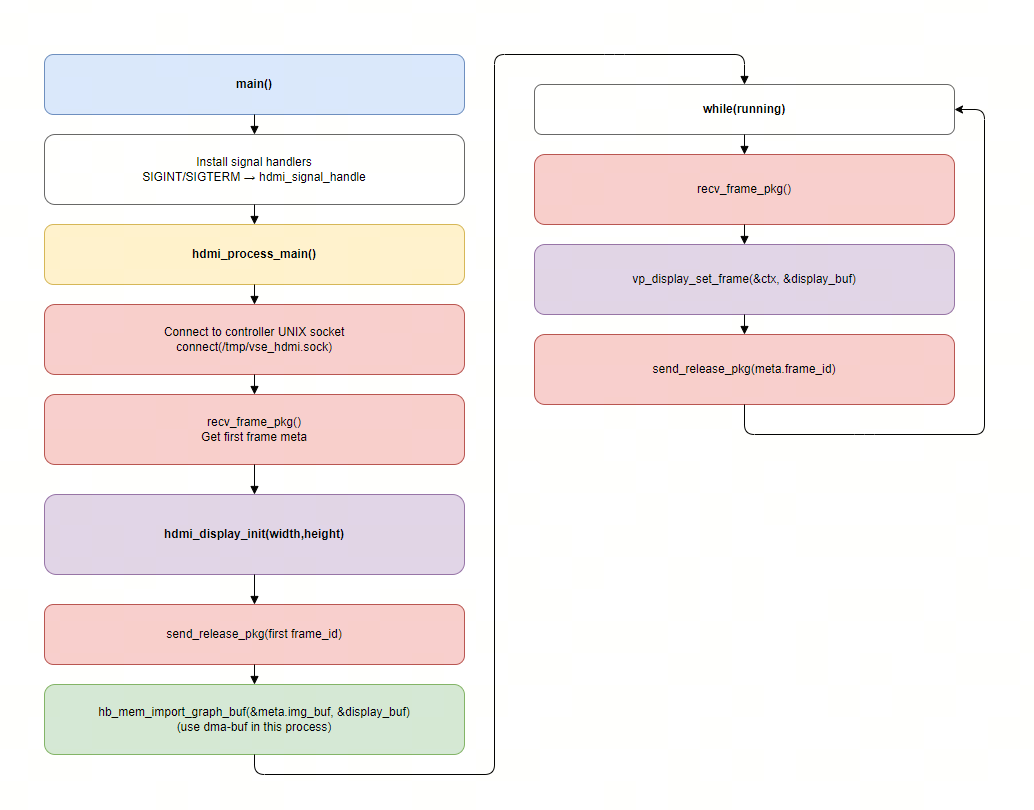

VSE process: single_pipe_vin_isp_vse_process.c
HDMI process: single_pipe_vin_isp_vse_hdmi.c
Encode process: single_pipe_vin_isp_vse_encode.c
  • Code location: app/samples/platform_samples/sample_pipeline/single_pipe_vin_isp_vse_multi_process
├── Makefile
├── single_pipe_vin_isp_vse_process.c
├── single_pipe_vin_isp_vse_encode.c
├── single_pipe_vin_isp_vse_hdmi.c
├── unix_socket.c
├── unix_socket.h
├── ping_pang_file_saver.c
├── ping_pang_file_saver.h
3.15.17.3. Build and Deployment
Build
  • Navigate to the single_pipe_vin_isp_vse_multi_process directory and run make to build.
  • The output artifacts are three executables in this directory:
  • For detailed build instructions, please refer to the Build Method section.
Deployment
After uploading the three executables to the development board, run chmod +x single_pipe_vin_isp_vse_* to grant executable permissions.
3.15.17.4. Running
How to Run
Before running the HDMI display process, ensure the display device is properly connected and load the display-related driver modules (same as single_pipe_vin_isp_vse_vo):
modprobe panel-jc-050hd134
modprobe galcore
modprobe vio_n2d
modprobe lontium_lt8618
modprobe vs-x5-syscon-bridge
modprobe vs_drm
It is recommended to use three terminals to start the three processes. Suggested start order:
  1. Start the controller process single_pipe_vin_isp_vse_process
  2. Start the HDMI display process single_pipe_vin_isp_vse_hdmi
  3. Start the encode process single_pipe_vin_isp_vse_encode
The encode/HDMI processes will actively connect to the sockets created by the controller process. If you start the encode/HDMI process first, it will print “please start VSE process first” and exit.

Running Results
This sample uses one sensor as an example to demonstrate how to use single_pipe_vin_isp_vse_multi_process.
  1. Start the controller process first (example uses sensor index = 3):
    ./single_pipe_vin_isp_vse_process -s 3
    Typical logs include:
    Wait encode process connect...
    Wait HDMI process connect...
  2. In another terminal, start the HDMI display process:
    ./single_pipe_vin_isp_vse_hdmi
    After a successful connection, the HDMI monitor will display images from VSE in real-time, and the terminal will output logs similar to:
    HDMI display frame success: id=..., resolution=...x...
  3. In another terminal, start the encode process:
    ./single_pipe_vin_isp_vse_encode
    After a successful connection, the encode process will start printing received frame information, and will generate ping/pang rotated H.264 bitstream files in the current directory:
    • ping_single_pipe_vin_isp_vse_vpu.h264
To stop the program, press Ctrl+C in each terminal. The controller process will clean up /tmp/vse_encode.sock and /tmp/vse_hdmi.sock.

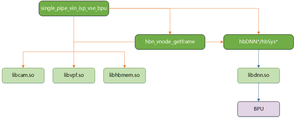

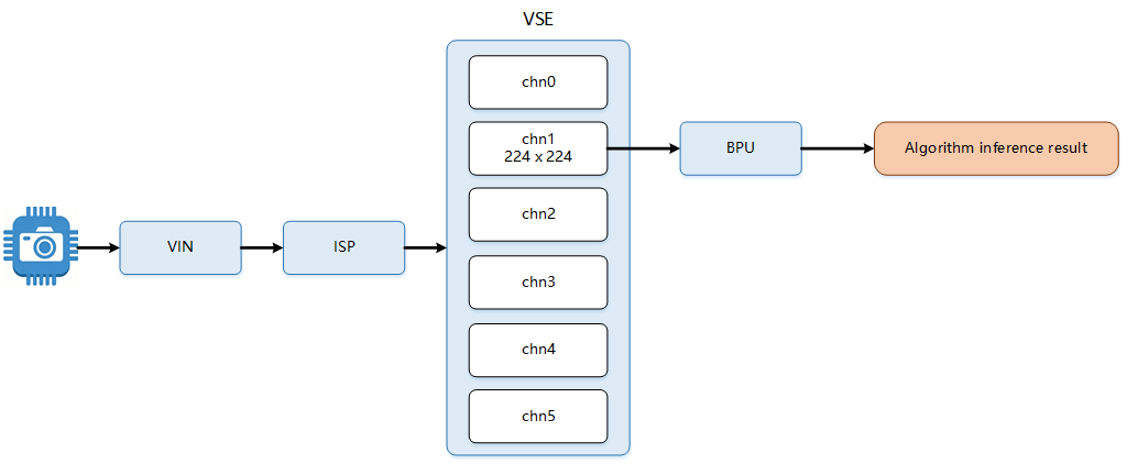

3.15.18. single_pipe_vin_isp_vse_bpu
3.15.18.1. Function Flowcharts
single_pipe_vin_isp_vse_bpu The example demonstrates how to transfer image data captured by the Camera to the BPU module for algorithm inference:
  • The program retrieves image data that has been scaled and matches the resolution requirements of the algorithm from output channel 1 of the VSE module
  • The algorithm demonstrated in this example is: mobilenetv2
Data Flow

  • Code location app/samples/platform_samples/sample_pipeline/single_pipe_vin_isp_vse_bpu
├── bpu_mobilenetv2.c
├── bpu_mobilenetv2.h
├── Makefile
├── mobilenetv2_image_labels.h
├── model_zoom
│   └── mobilenetv2_224x224_nv12.bin
└── single_pipe_vin_isp_vse_bpu.c

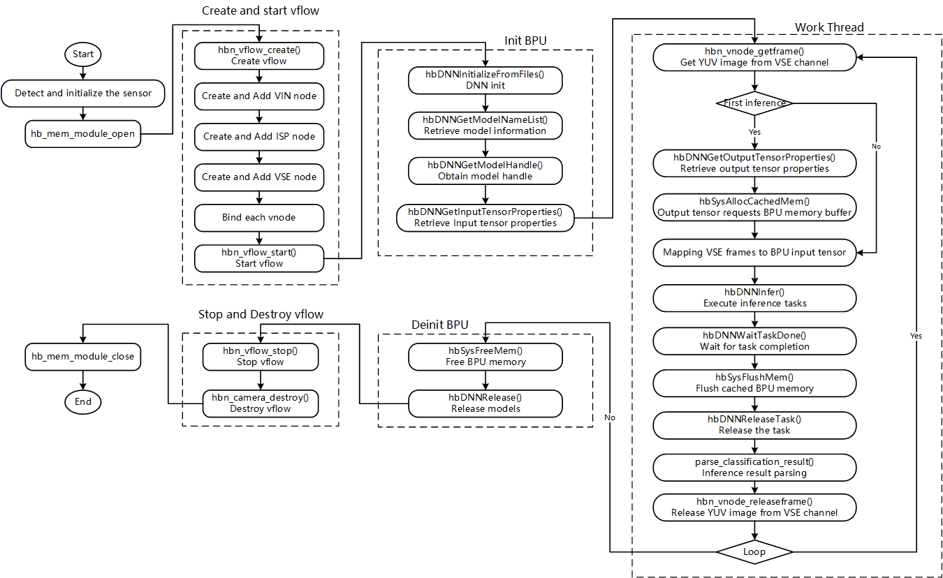

3.15.18.2. Build and Deployment

single_pipe_vin_isp_vse_bpu performs mobilenetv2 algorithm inference on the image captured by the camera and prints the inference result.
