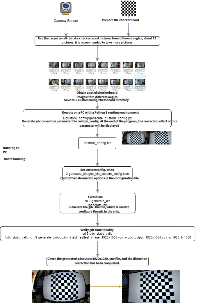

3.6.1.3. Development and Usage Procedure
X5-gdc
On a PC, use the generate_custom_config.py program to generate GDC correction calibration parameters.

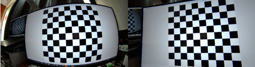

  • Prepare a chessboard pattern image (chessboard.png), which can be printed or displayed on a monitor.

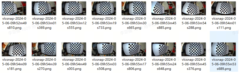

  • Use the target Camera Sensor to capture the chessboard image from different angles, taking about 15 images; it is recommended to take more.
    image-20240612173301868
  • Using the above chessboard images as input, run the following Python script (ensure the system supports Python 3 and has the opencv-python library installed) to generate the GDC correction calibration parameter file (custom_config.txt):
    cd 1-custom_config
    python3 ./generate_custom_config.py
    Log output in terminal:
    No graphical environment detected. Skipping display of images.
    Input images directory: ./chessboard
    Test image file: ./chessboard/vlcsnap-2024-05-06-09h53m19s733.jpg
    Output file: custom_config.txt
    i: 0
    i: 1

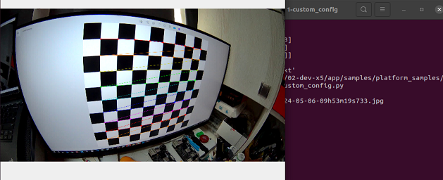

    Validation of distortion correction
    Saving mapx and mapy to 'custom_config.txt'
    No graphical environment detected. The output image has been saved to 'custom_config.txt'.
    If running in a graphical desktop terminal, the calibration and correction results will be displayed:
    image-20240612173753866
    image-20240612173729269

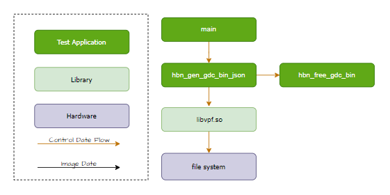

This program reads a local gdc_bin_custom_config.json configuration file and generates the corresponding gdc.bin file.

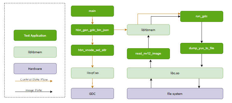

Software Architecture Description
image-20250106-225014

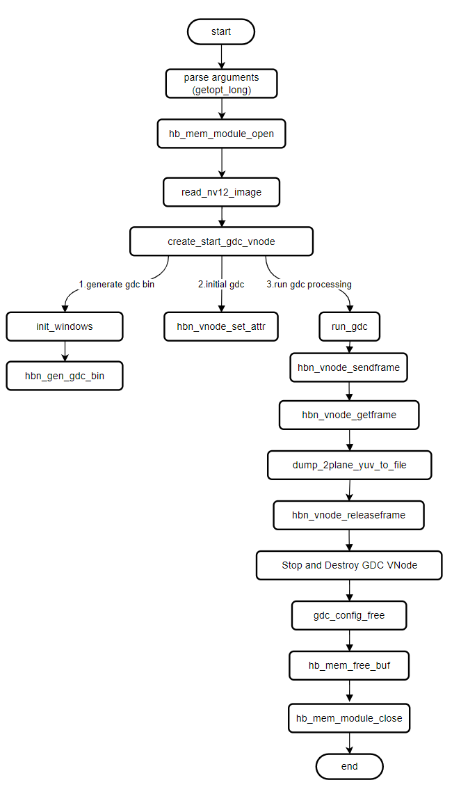

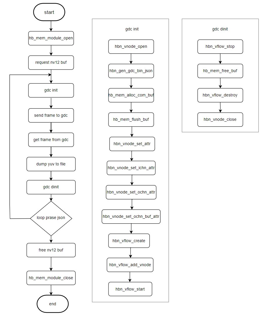

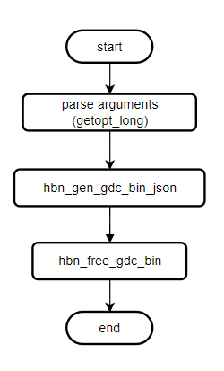

API Flow Description
image-20250106-232817
3.6.2.2. Build and Deployment
Build
  • Enter the sample_gdc directory and run make to compile.
  • The output artifact is generate_bin located in the sample_gdc/2-generate_bin directory.
  • For detailed compilation methods, refer to the Build Method section.
Program Deployment
After flashing the system software image, the executable file for this sample is located on the target device at: /app/platform_samples/sample_gdc/2-generate_bin.
3.6.2.3. Run
How to Run
Run the program with ./generate_bin -h to get help information:
./generate_bin -h
genereate_bin [-c json_config_file] [-o output_file]
Program Option Descriptions
Options:
  • [-c json_config_file]: Specify the JSON parameter file for configuring the GDC module (optional), default is ./gdc_bin_custom_config.json.
  • [-o output_file]: Specify the output path for the GDC bin file (optional), default is ./gdc.bin.
Execution Results
Run the command:
cd 2-generate_bin
chmod +x generate_bin
./generate_bin
Log output:
Gdc bin custom config: ./gdc_bin_custom_config.json
Generate gdc bin file: ./gdc.bin

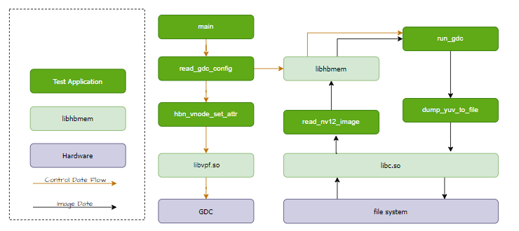

The gdc_static_valid program reads a local NV12 YUV image, sends it along with gdc.bin to GDC for transformation, and saves the result as a local NV12 format YUV image.

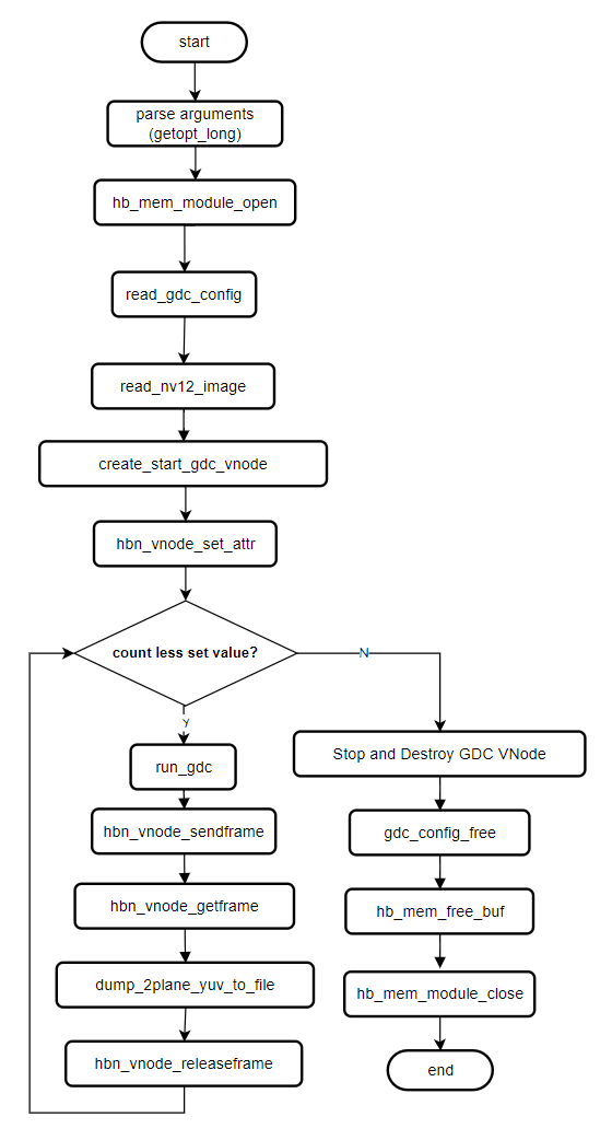

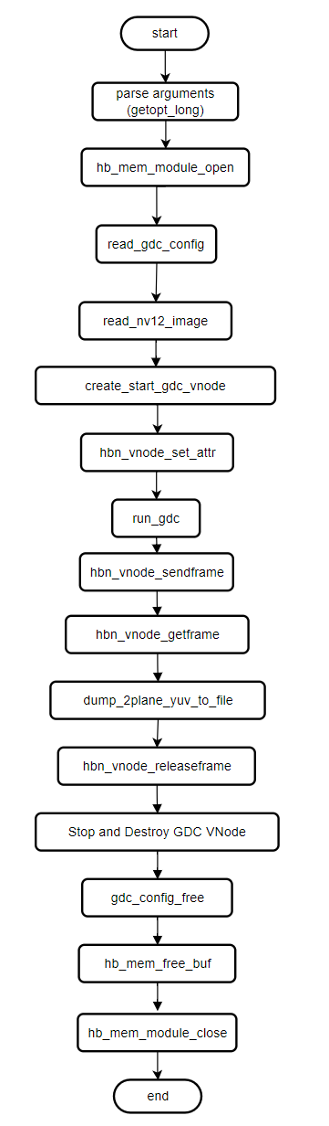

  C, --Count [run count]        Specify gdc sendframe and getframe count.
  p, --p [process id]           Specify id of process.
  f, --feedback                 Specify feedback mode
If --ow and --oh are not specified, they will default to the input width and height, respectively.
Options for gdc_stress_test:
  • c, --config: Specify the gdc.bin configuration file
  • i, --input: Specify the input NV12 image
  • o, --output: Specify the output NV12 image
  • w, --iw: Specify the input image width (horizontal resolution)
  • h, --ih: Specify the input image height (vertical resolution)
  • x, --ow: Specify the output image width (optional), defaults to input width
  • y, --oh: Specify the output image height (optional), defaults to input height
  • C, --Count: Specify the number of times to send frames to the GDC module.
  • p, --p: Specify the process ID.
  • f, --feedback: Use feedback mode.

3.6.5. 5-gdc_equisolid
3.6.5.1. Overview
The gdc_equisolid program reads a local NV12 YUV image, sends it to GDC for (panoramic) correction processing, and saves the corrected result as a local NV12 format YUV image.
image-20250106-224734
Code Location and Directory Structure
  • Code location: app/samples/platform_samples/sample_gdc
  • Directory structure
sample_gdc/
├── 5-gdc_equisolid
```│   ├── Makefile
│   └── gdc_equisolid.c
image-20250106-232907

The gdc_transformation in this document implements the GDC module to perform 180-degree linear transformation, cylindrical transformation, equidistant transformation, and trapezoidal correction with dewarping on feedback-input images.
Software Architecture Description:
The gdc_transformation program adopts a feedback workflow: it reads the original YUV file and JSON file generated by the GDC Tool from system storage as input for GDC. It relies on libgdcbin.so to calculate GDC coordinate points and saves the transformed image as a local NV12 format YUV file.
All JSON files generated by the GDC Tool are stored in the gdc_res directory. Currently, there are four JSON files in this directory, corresponding to the following transformation effects: Affine, Equisolid (cylinder), Equidistant, and Keystone + dewarping. The gdc_transformation program will generate four YUV images based on these four JSON files.
Note: The number of YUV images generated equals the number of JSON files in the gdc_res directory.

The original image is shown below:
After parsing and transforming according to each JSON file, four processed NV12-format YUV images are generated, as shown below:
image-20241204-171635
