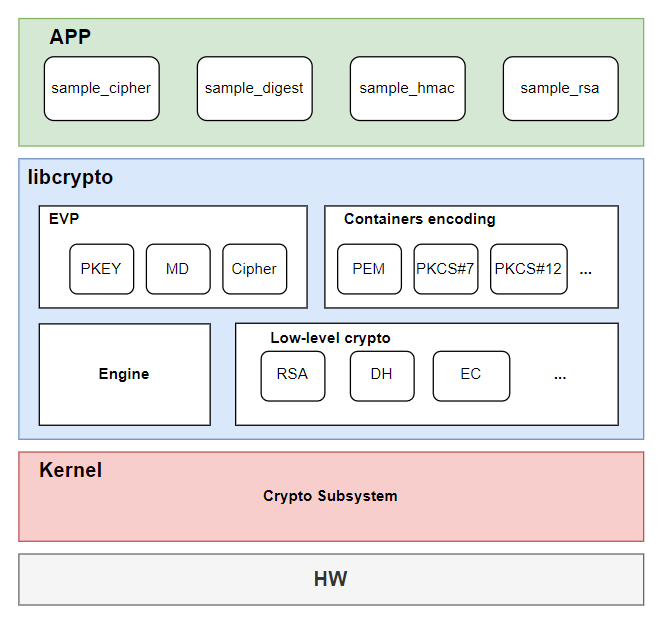

3.19.1.1. Software Architecture Description

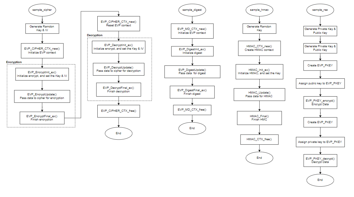

3.19.1.3. API Process Description
