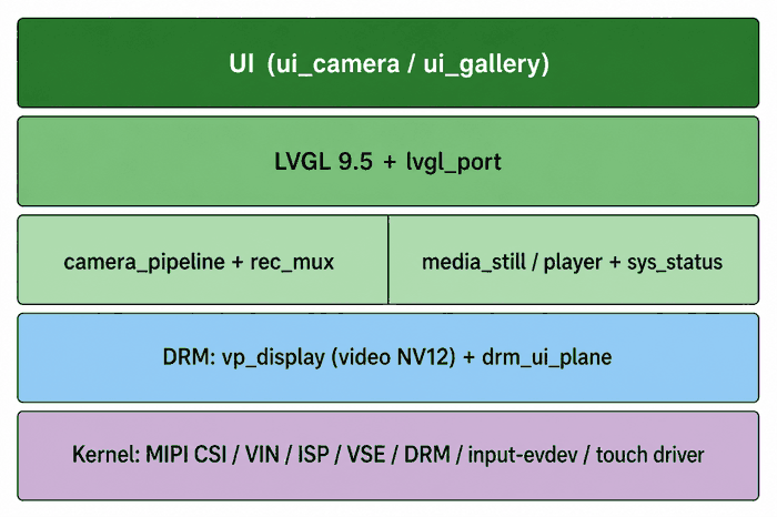

3.21.1.1. Software Architecture
Software layers (top to bottom):
software_architecture_diagram
  • Application UI: ui_camera / ui_gallery — camera main UI, status bar, shutter / REC / gallery controls.
  • LVGL framework: LVGL 9.x widgets, timers, and event loop; flush and input go through the port layer.
  • Display / input port: lvgl_display (ARGB8888 → DRM overlay), lvgl_input (evdev touch).
  • Camera business logic: camera_pipeline — preview thread, JPEG capture, H.264 record and remux, still / video playback.
  • Multimedia and display: VIN / ISP / VSE, encoder, vp_display video plane, drm_ui_plane UI overlay.
  • System status: sys_status reads battery (/sys/class/power_supply; show if present, hide if not) and free storage for the status bar and storage-guard logic.

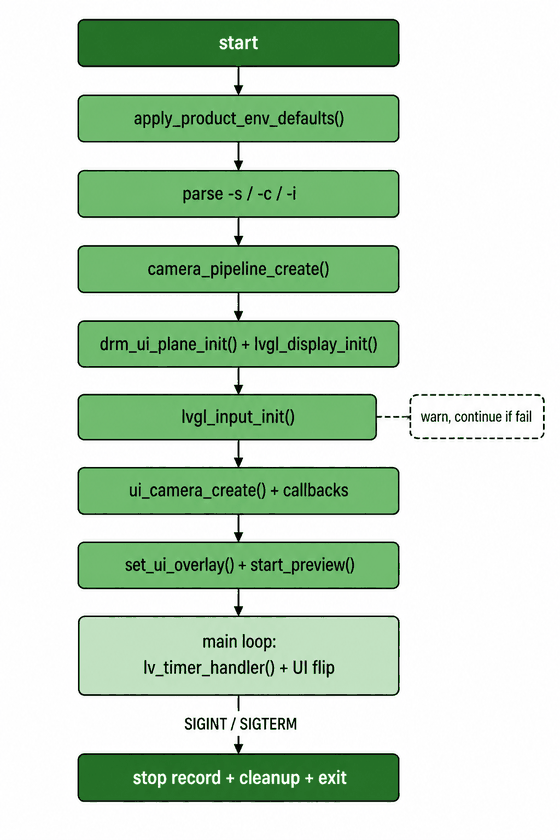

3.21.1.3. API Flow Description
api_flow_diagram
Typical startup:
  1. apply_product_env_defaults(): apply default environment variables (rotation, frame, touch offset, etc.).
  2. Parse -s / -c / -i.
  3. camera_pipeline_init(): create sensor path, start VSE drain thread, init MIPI DRM video plane.
  4. drm_ui_plane_init() + lvgl_display_init(): create UI overlay and LVGL display.
  5. lvgl_input_init(): open touch device and register pointer indev (warn only on failure; can run without touch).
  6. ui_camera_create(): create camera UI and bind capture / record / gallery callbacks.
  7. camera_pipeline_start_preview(): commit video + UI together.
  8. Main loop: lv_timer_handler() + DRM UI flip; on SIGINT / SIGTERM, stop recording and release resources.

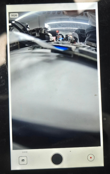

Figure 1 — Preview (viewfinder)
Preview
Live preview sits in the cream-colored frame. The bottom bar, left to right: Album, Shutter (large black circle), REC (small red circle). Tap shutter to save a JPEG; tap REC to start / stop recording.

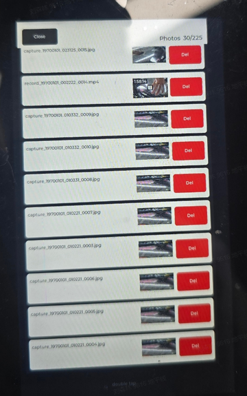

Figure 2 — Gallery
Gallery
Recent photos and videos are listed newest first. Tap an item to view a still or play an MP4 (no audio). Del removes the item; Close returns to the preview.
