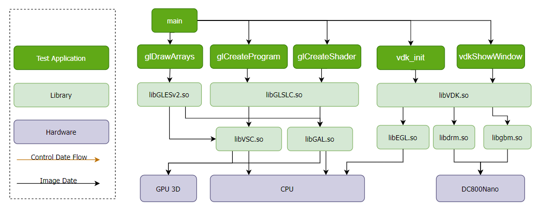

Software Architecture Description
sample_bezier supports two rendering modes:
  • Onscreen mode (default): Presents the EGL surface on an HDMI monitor via DRM + GBM.
  • Offscreen mode: Renders offscreen via fbdev virtual framebuffer, no physical monitor required.
 framwork_bezier

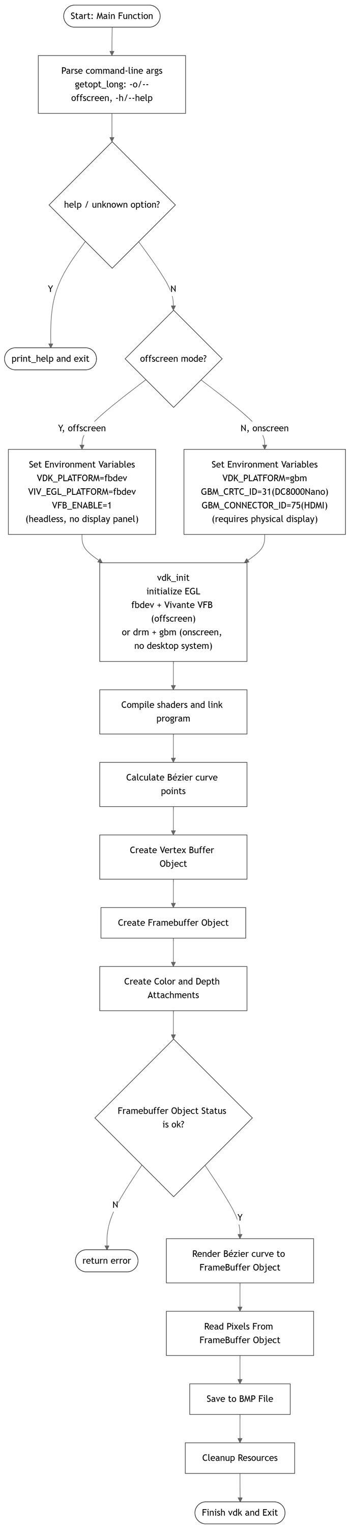

Overall Flow
 sample_bezier_data_flow

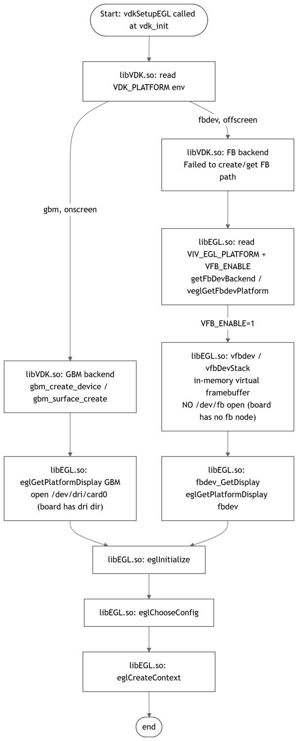

vdk_init
vdk_init is a function in libVDK.so that encapsulates the EGL interface and completes the initialization of the EGL context based on DRM+GBM or fbdev when no desktop system is available. Which path is used is determined by the VDK_PLATFORM environment variable set when the program starts:
  • Onscreen mode: VDK_PLATFORM=gbm
  • Offscreen mode: VDK_PLATFORM=fbdev, with VIV_EGL_PLATFORM=fbdev and VFB_ENABLE=1 set
 sample_bezier_vdk_init_data_flow

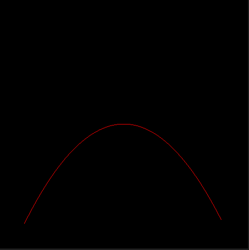

Running Results
Result description:
In the current directory, a BMP image file named bezier.bmp will be generated. The red line in the file represents a Bezier curve. The bezier.bmp generated in Onscreen and Offscreen modes is identical.

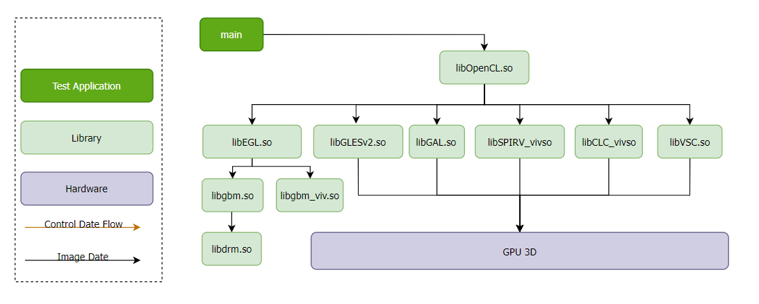

 framwork_matrix_mulpi

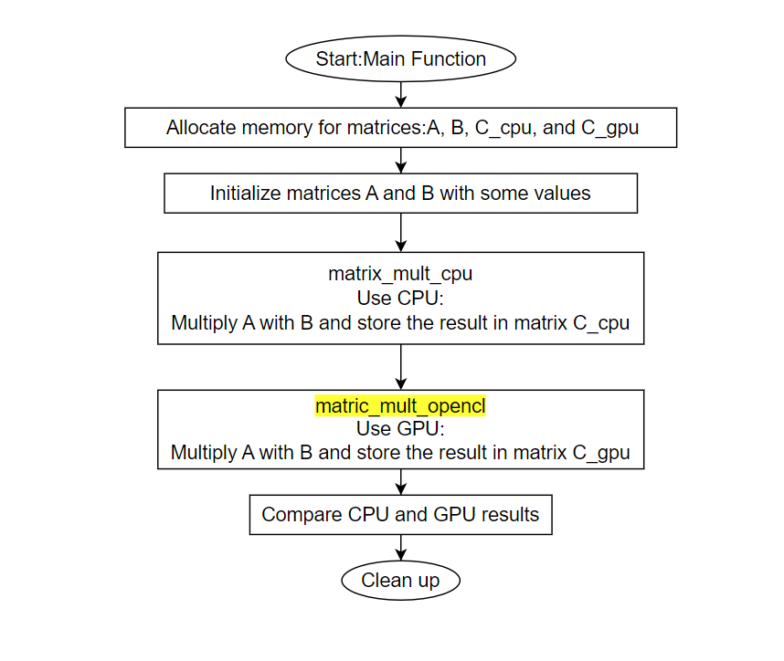

Overall Flow
 sample_matrix_mulpti_data_flow

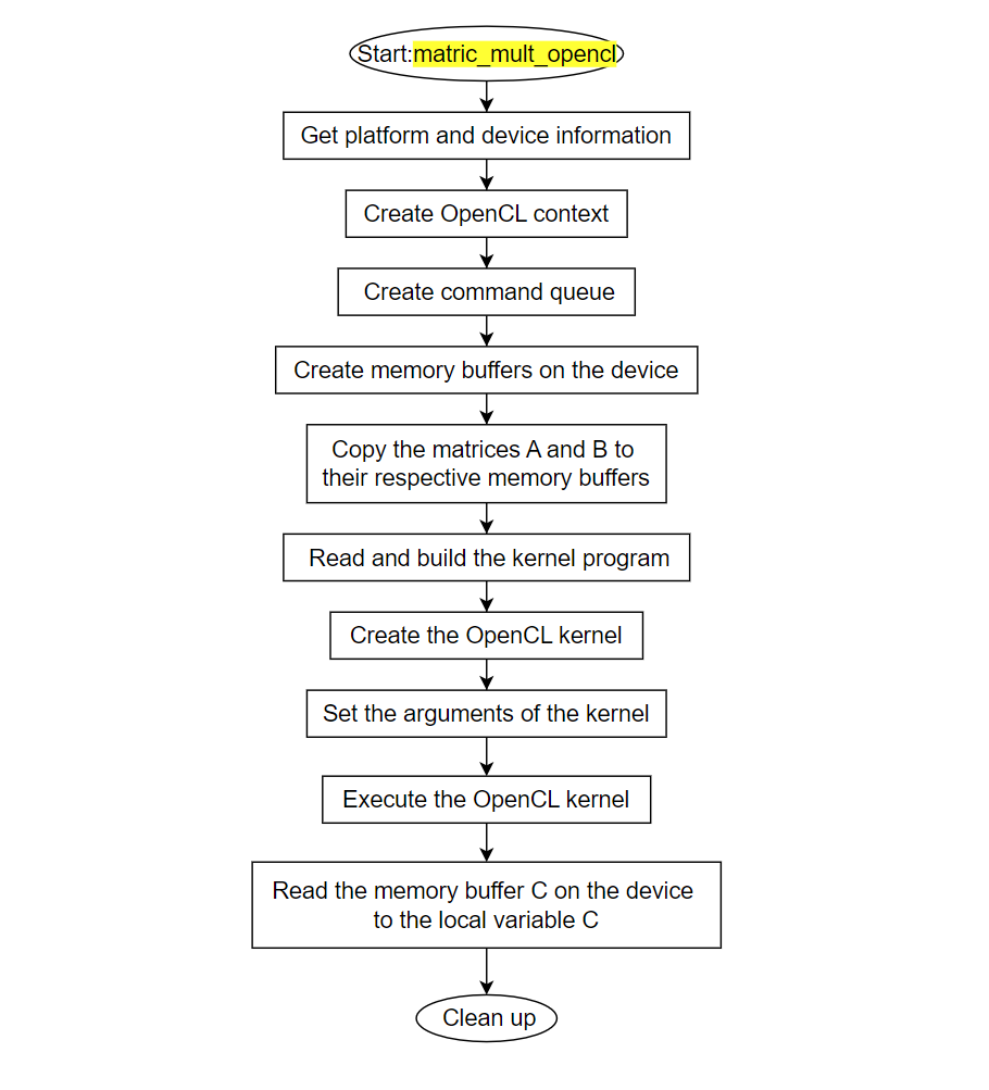

matirc_mult_opencl
The function matirc_mult_opencl uses the GPU to perform matrix multiplication, as shown in the following process (corresponding to the yellow background section in the overall flow):
 sample_matrix_mulpti_opencl_data_flow

Result description: For the same matrix multiplication operation:
  1. CPU execution time: 19.133549 seconds
  2. GPU execution time: 0.792543 seconds
From the total execution time, it can be seen that the GPU has significantly better performance than the CPU in matrix multiplication operations.
