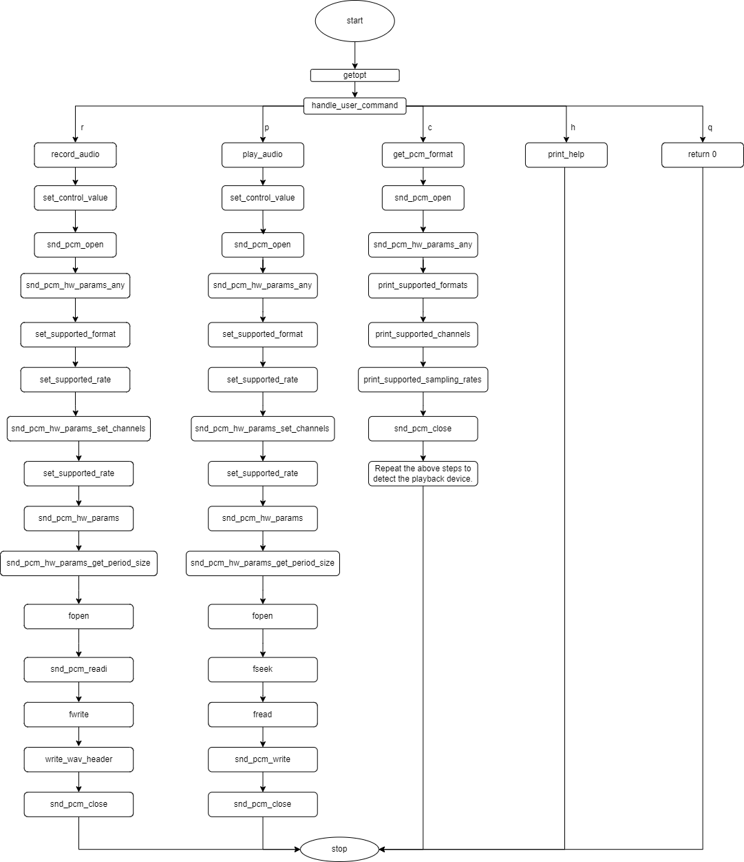

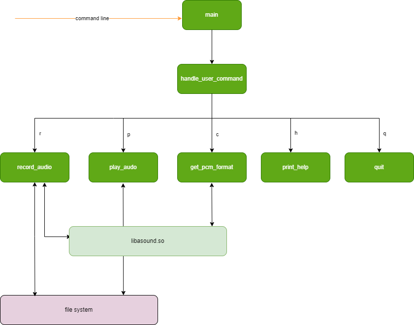

Software architecture diagram: After receiving the user command, sample_alsa invokes interfaces from the ALSA library (libasound) according to different business operations to implement recording, playback, and hardware parameter checking.

sample_alsa mainly uses the following ALSA library API flow (record_audio and play_audio are basically identical):
  • snd_pcm_open: Open the PCM device (SND_PCM_STREAM_CAPTURE for recording, SND_PCM_STREAM_PLAYBACK for playback).
  • snd_mixer_open / snd_mixer_attach / snd_mixer_selem_register / snd_mixer_load / snd_mixer_find_selem / snd_mixer_selem_set_capture_volume_all / snd_mixer_selem_set_playback_volume_all / snd_mixer_close: Used to set mixer controls such as ADC PGA Gain before recording and DAC before playback; if the corresponding control is not found, the program prints a warning and skips it without terminating.
  • snd_pcm_hw_params_any: Initialize the hardware parameter object.
  • snd_pcm_hw_params_set_access: Set the data access method (the program uses SND_PCM_ACCESS_RW_INTERLEAVED, i.e. interleaved left/right channels).
  • snd_pcm_hw_params_set_format: Set the audio format; before setting, snd_pcm_hw_params_test_format probes whether the hardware supports the format corresponding to the specified bit depth; if not, it falls back to SND_PCM_FORMAT_S16_LE.
  • snd_pcm_hw_params_set_rate_near: Set the sampling rate; before setting, snd_pcm_hw_params_test_rate probes whether the hardware supports the specified sampling rate; if not, it falls back to 44100 Hz.
  • snd_pcm_hw_params_set_channels: Set the number of channels.
  • snd_pcm_hw_params: Apply the hardware parameters to the device.
  • snd_pcm_hw_params_get_period_size: Get the period size, used to allocate read/write buffers.
  • snd_pcm_readi and snd_pcm_writei: Used to read and write audio data; when -EPIPE (buffer overrun/underrun) is returned, snd_pcm_prepare is called to recover and continue.
  • snd_pcm_drain: Drain remaining data at the end of playback.
  • snd_pcm_close: Close the PCM device and release resources.
Querying hardware capabilities (the c command) also uses:
  • snd_pcm_hw_params_test_format: Test each PCM format supported by the hardware.
  • snd_pcm_hw_params_test_rate: Test each sampling rate supported by the hardware.
  • snd_pcm_hw_params_get_channels_min / snd_pcm_hw_params_get_channels_max: Get the minimum/maximum number of channels supported by the hardware.

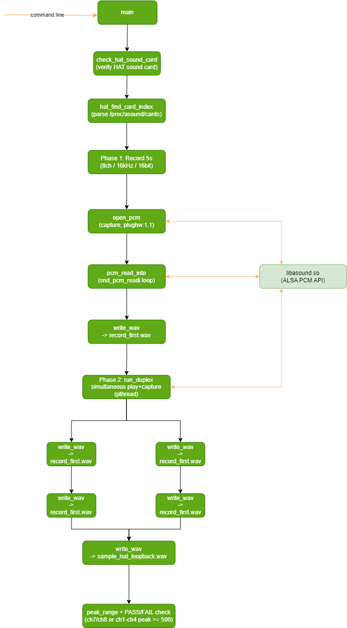

sample_hat_loopback is a full-duplex loopback self-test program dedicated to the Waveshare Audio Driver HAT REV2 (ES7210+ES8156) external sound card. Through a two-phase flow of “record a segment of voice first, then play while recording”, it verifies whether the HAT sound card is properly registered and capable of 8-channel full-duplex transmit/receive, and gives a PASS/FAIL conclusion based on the peak values of the loopback capture channels. The fixed parameters are 8 channels, 16000 Hz, 16 bit, period 512 frames, capture device plughw:1,1, playback device plughw:1,0.
3.12.4.2. Software Architecture Description
sample_hat_loopback is also developed based on the ALSA library (libasound) using C language, and additionally uses pthread to implement parallel full-duplex capture/playback. It targets the Waveshare Audio Driver HAT REV2 (ES7210+ES8156) external sound card and is primarily divided into the following components:
  • Sound card detection module, parses /proc/asound/cards to find the sound card named duplexaudio, and verifies whether it is registered as card 1 (corresponding to plughw:1,1/plughw:1,0)
  • Phase 1 recording module, opens plughw:1,1 to record 5 seconds of 8-channel voice, saves it as record_first.wav and prints the peak of each channel
  • Phase 2 full-duplex module, runs in parallel through two pthreads — the playback thread plays the phase 1 recording twice consecutively (with a 2-second silence gap in between), while the capture thread simultaneously records the complete 8-channel stream and saves it as sample_hat_loopback.wav
  • Peak decision module, counts the peaks of ch7/ch8 (PCB loopback) and ch1-ch4 (wired loopback) in the captured data; peak >= 500 (i.e. the maximum absolute value of the channel’s PCM samples reaches 500; the 16-bit range is 0-32768, reaching 500 means the loopback capture path actually captured a valid signal rather than noise floor/silence) judges PASS, otherwise FAIL
Software architecture diagram: sample_hat_loopback first detects the HAT sound card at the main entry, then sequentially enters phase 1 recording and phase 2 full-duplex (pthread dual-thread play-while-record), and finally gives a PASS/FAIL conclusion from the peak decision module, relying on libasound’s PCM interfaces, the pthread threading library, and the file system to store WAV files.

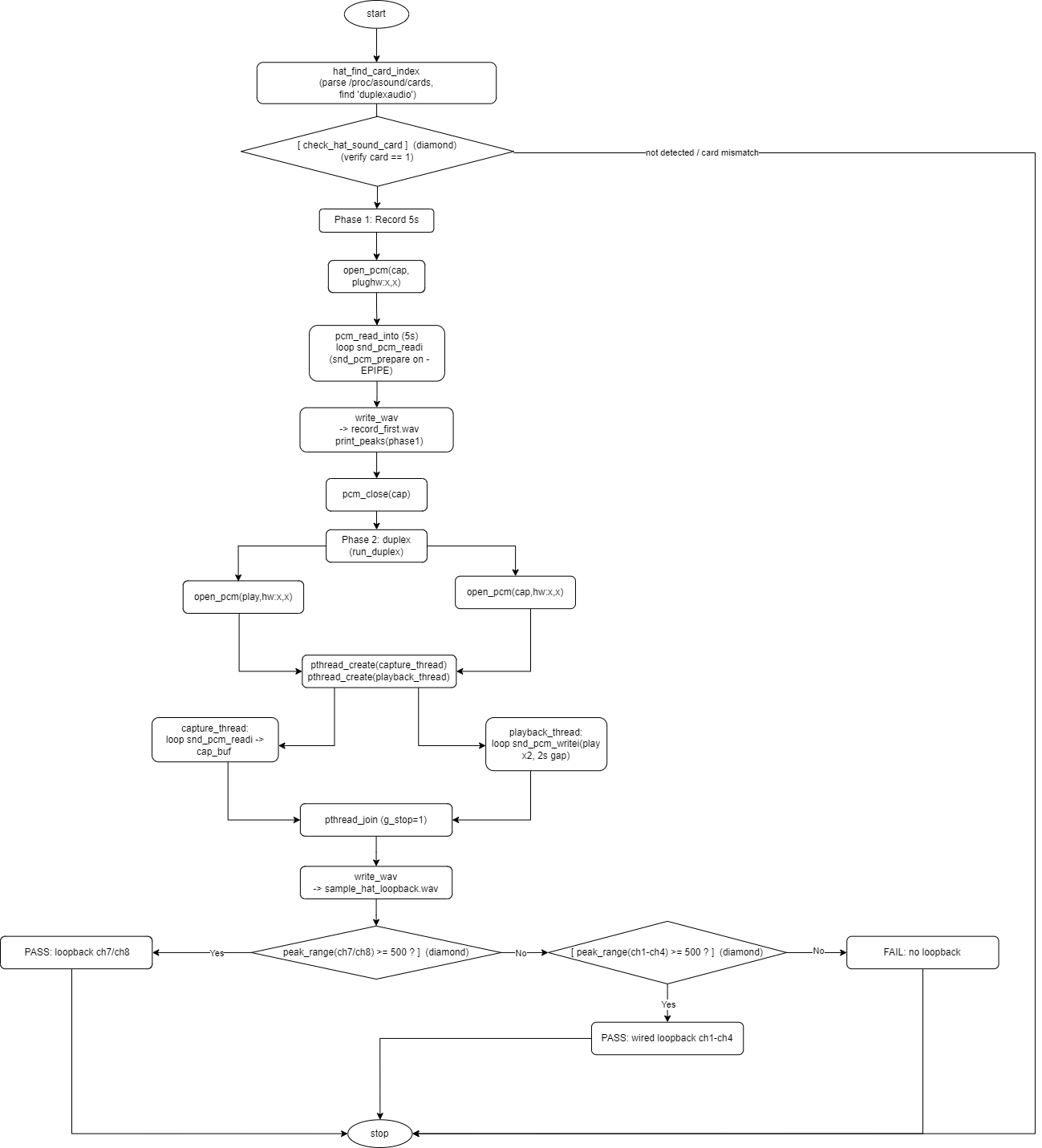

The program runs as follows:
  1. At startup, it searches /proc/asound/cards for the sound card named duplexaudio and verifies whether it is registered as card 1 (corresponding to plughw:1,1/plughw:1,0). If the HAT is not detected or the card number does not match, it prints a troubleshooting hint and exits.
  2. Phase 1: opens the plughw:1,1 capture device, speaks into the microphone for 5 seconds, saves the 8-channel voice as record_first.wav, and prints the peak of each channel.
  3. Phase 2: opens the capture and playback devices again, and runs in parallel through two threads (pthread) — the playback thread plays the voice recorded in phase 1 twice consecutively (with a 2-second silence gap in between), while the capture thread simultaneously records the complete 8-channel stream and saves it as sample_hat_loopback.wav.
  4. Counts the peaks of ch7/ch8 (PCB loopback channels) and ch1-ch4 (wired loopback channels) in the captured data; peak >= 500 judges PASS, otherwise FAIL.

Decision explanation:
  • If the peak of ch7/ch8 (HAT onboard PCB loopback channels) >= 500, it prints PASS: PCB loopback ch7/ch8 (peak xxxx), indicating the HAT onboard loopback capture path is normal.
  • If ch7/ch8 do not meet the threshold but the peak of ch1-ch4 (external wired loopback channels) >= 500, it prints PASS: wired loopback ch1-ch4 (peak xxxx), with an accompanying ch7/ch8 peak hint.
  • If the peaks of both channel groups are below 500, it prints FAIL: no loopback ..., indicating no valid loopback capture was detected; check the HAT installation, DIP switches, and system enable configuration.
