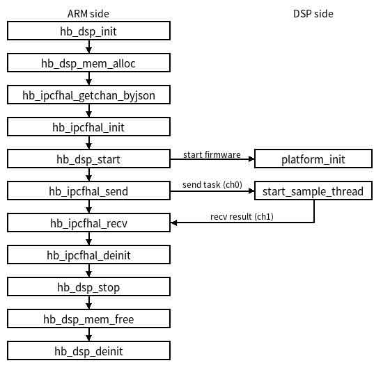

3.11.1.5. API Process Description
The API flowchart details each step from initialization to data processing. Below is a brief explanation of the process:
Function Name Description
hb_dsp_init Initializes the DSP environment.
hb_dsp_mem_alloc Allocates necessary memory for DSP operations.
hb_ipcfhal_getchan_byjson Retrieves the IPC channel.
hb_ipcfhal_init Initializes the IPC channel.
hb_dsp_start Starts DSP processing.
hb_ipcfhal_send Sends task parameters to the DSP via IPC (called in the send thread).
hb_ipcfhal_recv Receives the DSP processing result via IPC (called in the receive thread).
hb_ipcfhal_deinit Releases the IPC channel.
hb_dsp_stop Stops DSP processing.
hb_dsp_mem_free Frees previously allocated memory.
hb_dsp_deinit Deinitializes the DSP environment.
