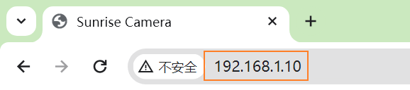

After the Sunrise camera starts normally, enter the IP address in the address bar through the chrome browser (the default IP of the development board is 192.168.1.10) to log in to the user control main interface, for example: http://192.168.1.10

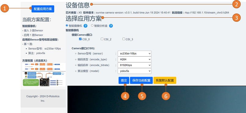

The detailed description of the interface menu is as follows:
Function number Description
1 Configure the application plan, click to open the application plan selection and parameter configuration page
2 Display the currently running scene information
3 Displays the main information of the current application solution, such as the sensor model used, encoding and decoding parameters, and algorithm model
4 Application solution block diagram to understand the data flow of the current application solution. Click to enlarge the image
5 Video display main screen, automatically adjust the number of display screens according to the number of video channels running in the application solution
6 Preview the real-time frame rate of the video
7 Real-time frame rate of algorithm operation

The specific modification steps are as follows:
  1. Start the sunrise_camera program, open the chrome browser and enter the IP address of the device, for example: http://192.168.1.10
  2. Click the Configure Application Solution button, labeled 1 in the above figure
  3. You can view the current device information, including chip type, software version, and rtsp stream link (this link supports pulling up the rtsp video stream in the vlc software and can support operations such as recording and screenshots), labeled 2 in the above figure
  4. Select the application plan, labeled 3 in the above figure. Please click the question mark button to learn about the parameter settings and precautions for each application solution.
  5. Click the Submit button to switch the application plan immediately. (Note: Just clicking Submit will not modify the configuration file of the development board and can be used to temporarily modify parameters for debugging)
  6. Click the Save current configuration button to write the set configuration to the configuration file on the development board. Sunrise_camera will start according to the current configuration the next time you restart it.
  7. Click Restore Default Configuration, and the user configuration will be reset to the configuration of Single-channel Video Analysis Box.

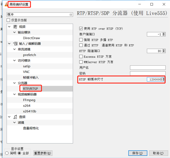

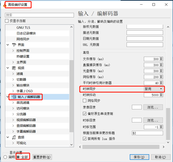

3.16.7. Use VLC player to play RTSP stream
When the Sunrise camera program is running, the rtsp video stream will be pushed synchronously. Users can play the RTSP stream through the vlc player to realize screen preview, video recording, screenshots and other functions.
3.16.7.1. Play method

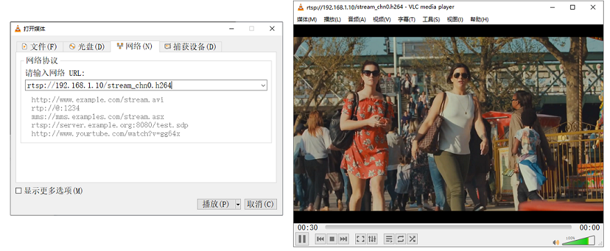

Open vlc player, select the Media menu, then select the Open Network Streaming option.
Fill in the url address in the Open Media dialog box and click the Play button to start playing, as shown below:
image-20220328225311750
The code stream network URL link of rtsp can be viewed on the device information on the web. The default supported code stream link is: rtsp://192.168.1.10/stream_chn0.h264

  • When 4K@30fps is configured with a high bit rate (above 8192Kbps), in order to ensure smooth video playback without frame loss, it is recommended to use a Gigabit network, otherwise video mosaics and blurred screens will easily occur.
  • vlc buffer_size setting, vlc receiving buffer modification: the default is 250000, it is recommended to change it to 1200000.

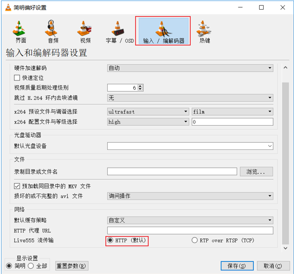

  • Using http mode can effectively solve the problem of screen blur caused by frame loss during playback.

  • Disable clock synchronization in advanced settings
