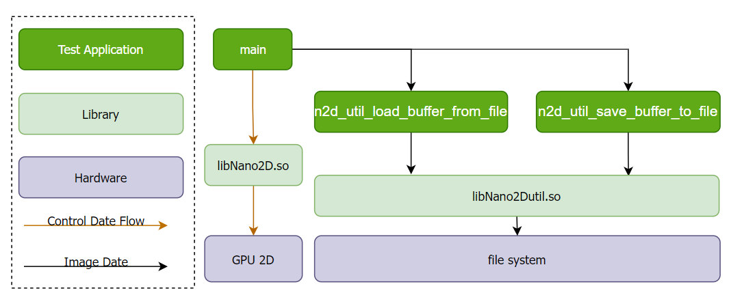

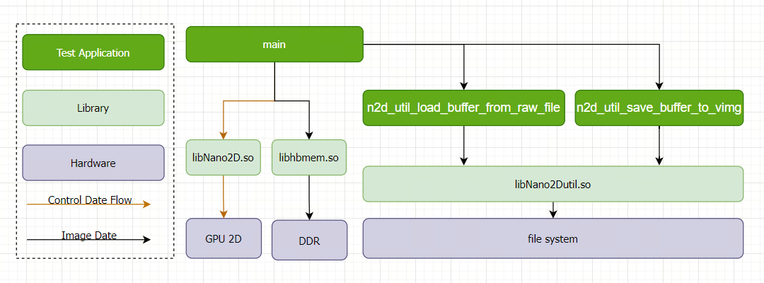

Software Architecture
framework_all

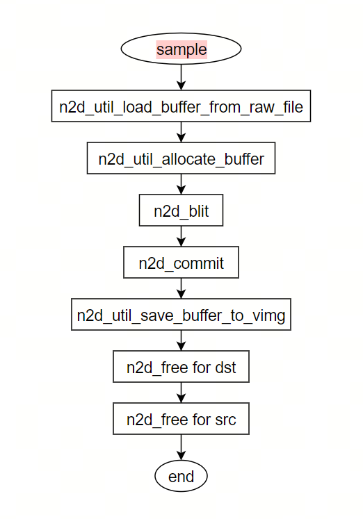

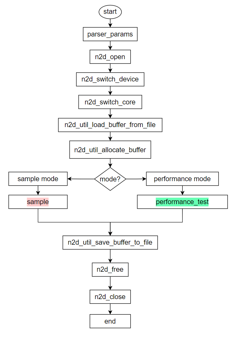

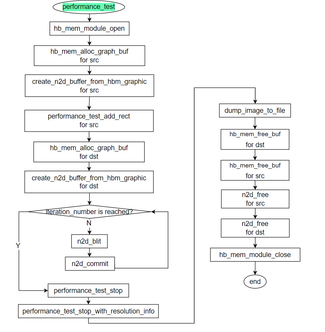

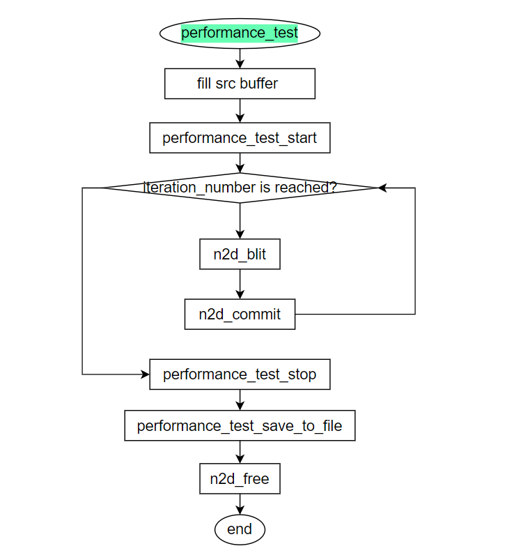

API Workflow Explanation
The core steps for using the GPU 2D API are:
  1. Prepare source and destination buffers. The buffer structures are defined using n2d_buffer_t.
  2. Execute blit operations: Send commands to the command buffer.
  3. Execute commit operation: Submit pending commands in the command buffer to the GPU hardware and block until processing is complete.

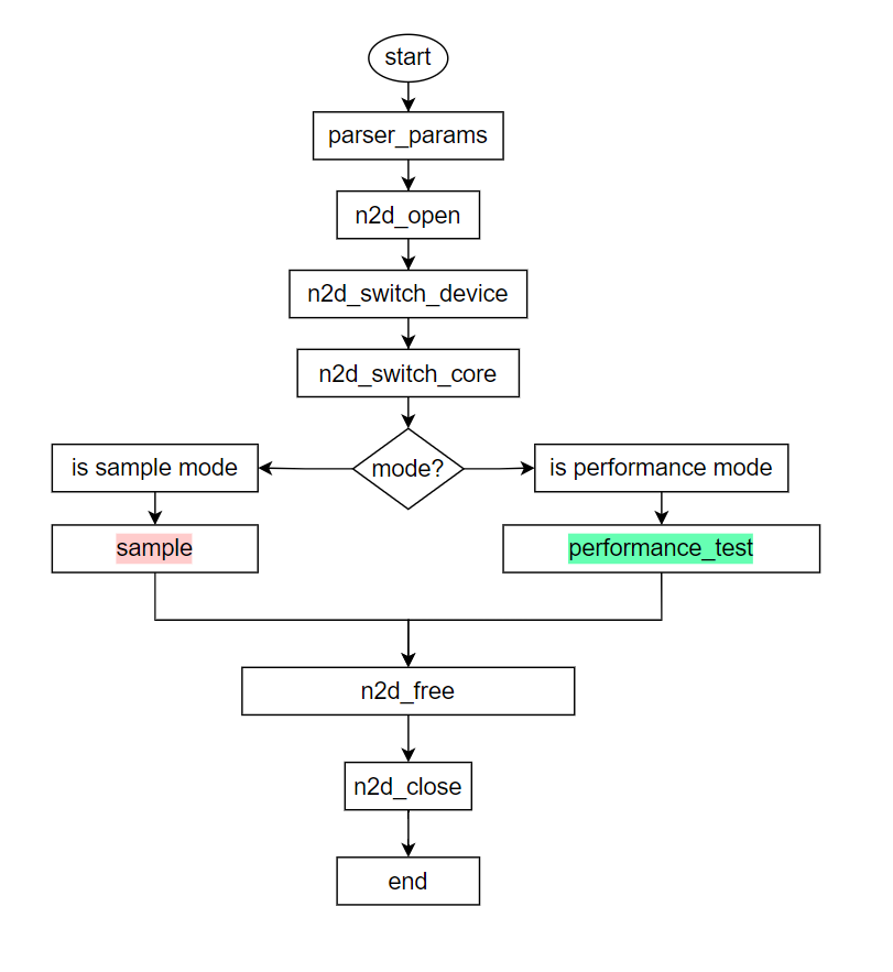

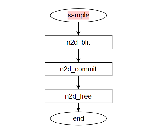

The example program mainly has two branches:
  1. Performance test
  2. Sample program
Overall Workflow
app_common_complex
Performance Test Workflow
performance
Sample Workflow
sample_simple

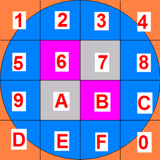

How to Run the Program
Run the program: ./rotation.
The program reads the file R5G6B5_640x640.bmp from the resource directory, rotates it, and saves the result to the current directory as R5G6B5_640x640_rotated.bmp.
Program Parameter Options
./rotation -h
Usage: rotation [OPTIONS]
Options:
  -m <mode>              Specify running mode (0: sample, 1: performance test)
  -c <image_width>       Specify image width (columns)
  -r <image_height>      Specify image height (rows)
  -i <iteration_number>  Specify number of iterations
  -h <help>              Show this help message
     For Example, performance test: ./rotation -m 1 -c 1920 -r 1080 -i 1000
     For Example, sample          : ./rotation (not need input param)
Examples:
  • ./rotation -m 1 -c 1920 -r 1080 -i 1000: Performance test mode, specifying resolution 1920×1080, runs 1000 times, and prints average execution time and FPS.
  • ./rotation: Rotates the input image 90 degrees clockwise.
Execution Results
Command:
./rotation
Log Output:
./rotation
Start !!!
Save file to [./R5G6B5_640x640_rotated.bmp].
Stop !!!

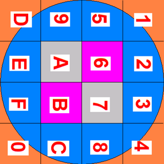

Result Description:
After reading the input file, the program rotates it 90 degrees clockwise and saves the result. The effect is as follows:
Input File:
rotation-input
Output File:
rotation-output
framework_all
  1. Performance test
  2. Sample program
Overall Workflow
app_common_simple
performance

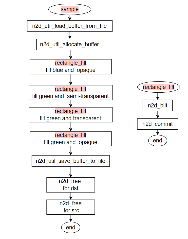

Sample Workflow
rectangle_fill_sample

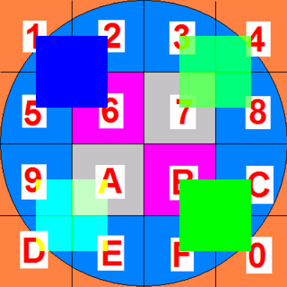

Result Description:
After reading the input file, the program performs the following operations:
  1. Adds an opaque blue rectangle at the top-left corner.
  2. Adds a semi-transparent green rectangle at the top-right corner.
  3. Adds a transparent green rectangle at the bottom-left corner.
  4. Adds an opaque green rectangle at the bottom-right corner.
Input File:
rectangle_fill-input
Output File:
rectangle_fill-output

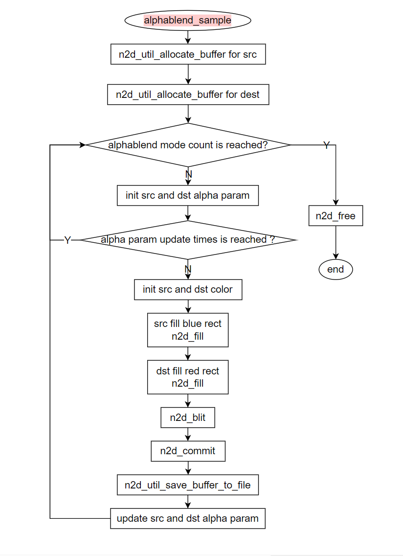

Overall Workflow
app_common_simple
performance
Sample Workflow
alpha_sample

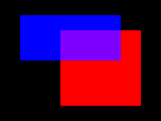

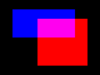

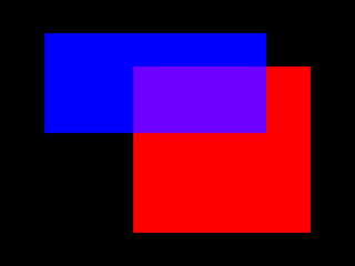

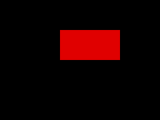

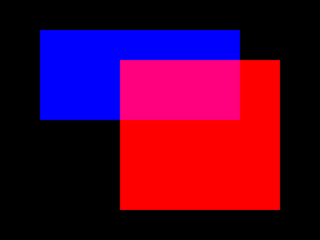

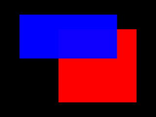

Result Description:
  1. First, create two buffers of size 640×480 in N2D_BGRA8888 format.
  2. Draw a blue rectangle in one buffer and a red rectangle in the other. The rectangles overlap (to show blending effect).
  3. Iterate through all blending modes, varying the transparency in each mode.
  4. Save the results of different blending modes and transparency combinations to files (filenames are generated by combining blending mode and transparency parameters).
src_over Mode
src_over-0 src_over-1 src_over-2 src_over-3
src_over-4 src_over-5 src_over-6 src_over-7
src_in Mode
src_in-0 src_in-1 src_in-2 src_in-3
src_in-4 src_in-5 src_in-6 src_in-7
dst_over Mode
dst_over-0 dst_over-1 dst_over-2 dst_over-3
dst_over-4 dst_over-5 dst_over-6 dst_over-7
dst_in Mode
dst_in-0 dst_in-1 dst_in-2 dst_in-3

3.10.4. sample_format_convert
3.10.4.1. Function Overview
Function Description: sample_format_convert performs color space conversion on images.
framework_all

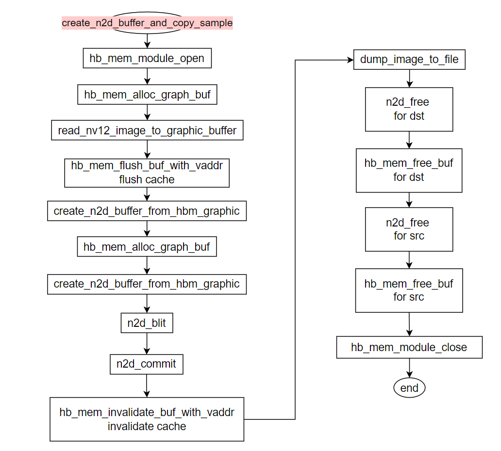

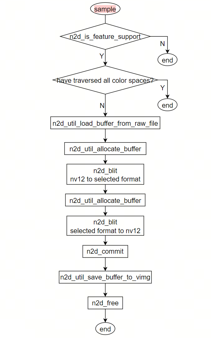

  1. Performance test
  2. Sample program
Overall Workflow
app_common_simple
performance
Sample Workflow
format_convert_sample

Effect description:
  1. The program reads the file nv12_1920x1080.yuv from the resource directory and performs color space conversion among different formats.
  2. First, the input image is converted into one of the following formats:
  3. Then, it is converted back to the input file’s original format (NV12) and saved as a file.
n2d_buffer_format_t yuv_format[] =
    N2D_YUYV,
    N2D_UYVY,
    N2D_YV12,
    N2D_I420,
    N2D_NV12,
    N2D_NV21,
    N2D_NV16,
    N2D_NV61,
    N2D_P010_MSB,
    N2D_P010_LSB,
    N2D_I010

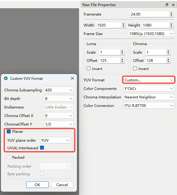

Note:In yuview software, when previewing nv12 format pictures, the format selection is as shown in the figure:

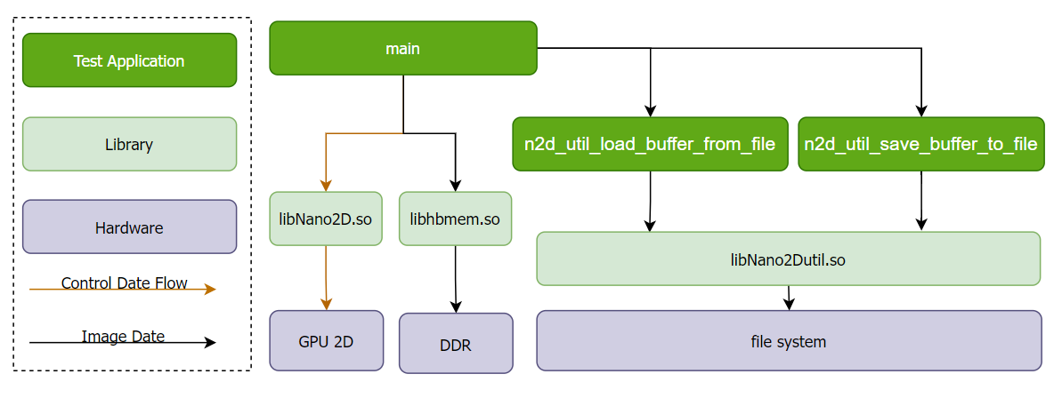

Function description: sample_copy implements image memory copy functionality.
Software Architecture Diagram
framework_all

API Workflow Description
The core steps for using GPU 2D API are:
  1. Prepare source and destination buffers. The buffer structures are defined using the n2d_buffer_t structure.
  2. Perform blit operations: send execution commands into the command buffer
  3. Perform commit operation: submit pending instructions in the command buffer to GPU hardware and block until GPU processing completes
  1. Performance test
  2. Sample program
Overall Flow
app_common_simple
Performance Test Flow
performance
Sample Flow
sample_normal
framework_all
performance

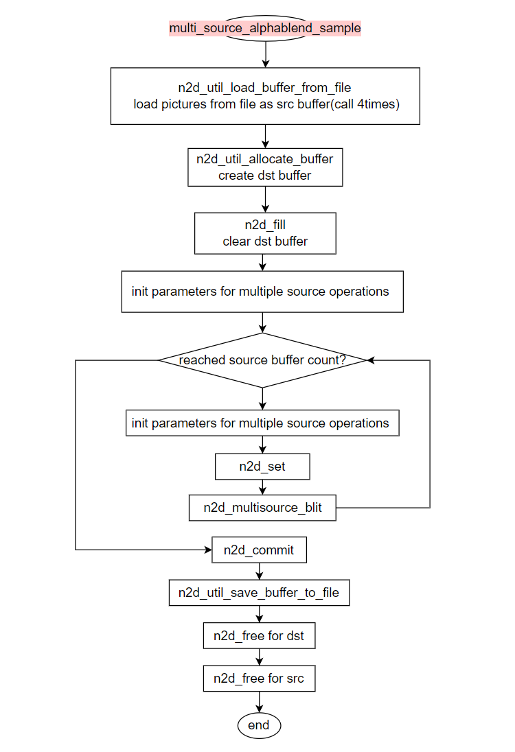

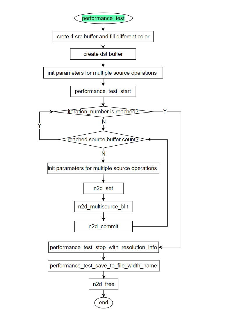

  1. Performance test
  2. Sample program
Overall Flow
app_common_simple
multi_source_blend_performance
Sample Program Flow
multi_source_blend

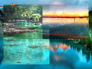

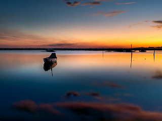

Effect description:
  1. The program reads files scenery01.bmp, scenery02.bmp, scenery03.bmp, and scenery04.bmp from the resource directory.
  2. Each of the four images is cropped from different positions and then blended using the N2D_BLEND_SRC_OVER blending mode with transparency.
  3. The blended result is saved to the file multi_source_alphablend_sample_640_480.bmp.
Input files:
format-input
format-input
format-input
format-input
Output file:
format-input

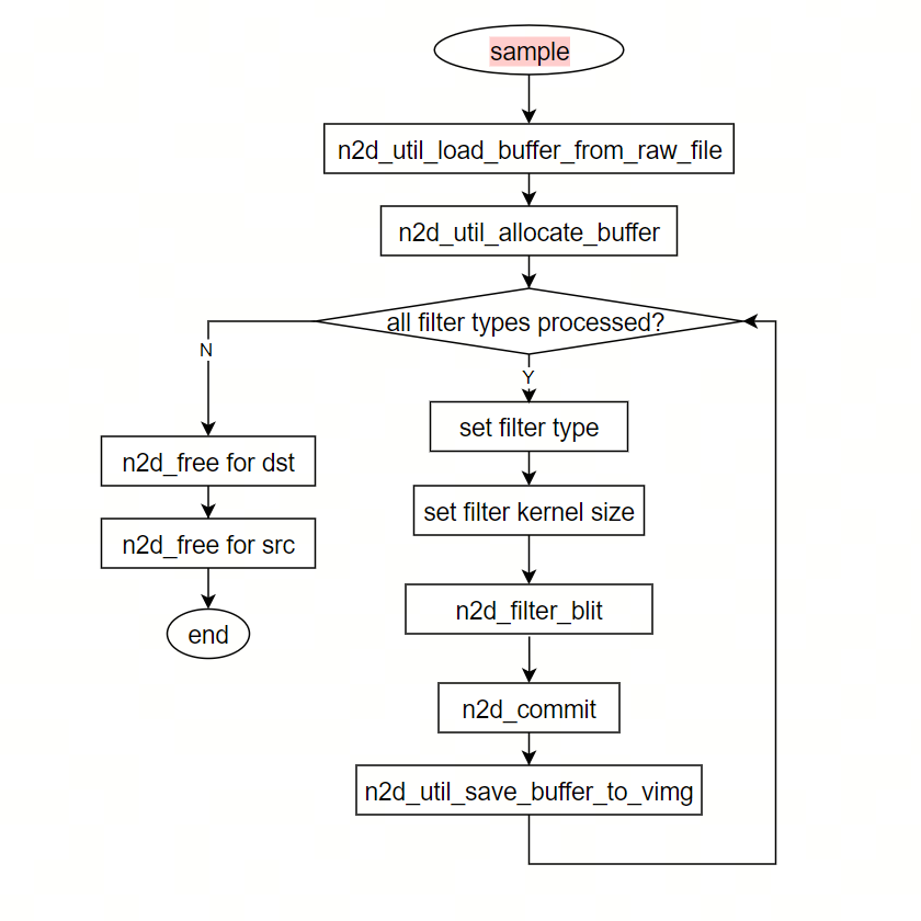

3.10.8. sample_resize
3.10.8.1. Function Overview
Function description: sample_resize completes the image enlargement function and can specify different filter types.
Filter type Meaning Typical uses
N2D_FILTER_SYNC Synchronous filter, mostly refers to Sinc Filter or synchronous interpolation filter, which can theoretically maintain the frequency domain characteristics of the image and reduce aliasing. The calculation amount is large. High-quality scaling, image processing with extremely high requirements for clarity.
N2D_FILTER_BLUR Blur filter, performs smoothing or low-pass processing to soften the image, reduce details, and reduce noise. Noise reduction, background blur, thumbnail generation.
N2D_FILTER_BILINEAR Bilinear interpolation filtering, one of the most commonly used interpolation algorithms, fast speed and medium quality. Real-time scaling, video playback, GUI rendering.
N2D_FILTER_BICUBIC Bicubic interpolation filtering is smoother and more detailed than bilinear, but requires a large amount of calculation. High-quality image scaling, photo processing.

  2. Perform blit operation: send the execution command to the instruction cache area
  3. Execute the commit operation: send the instructions to be executed in the instruction buffer area to the GPU hardware and block waiting for the GPU hardware processing to complete.
The sample program mainly has two branches:
  1. Performance testing
  2. Sample program
Overall process
app_common_simple
Performance testing process
performance
Sample program flow
sample_normal

Function description: sample_stitch implements stitching four input images into a single output image.
framework_all

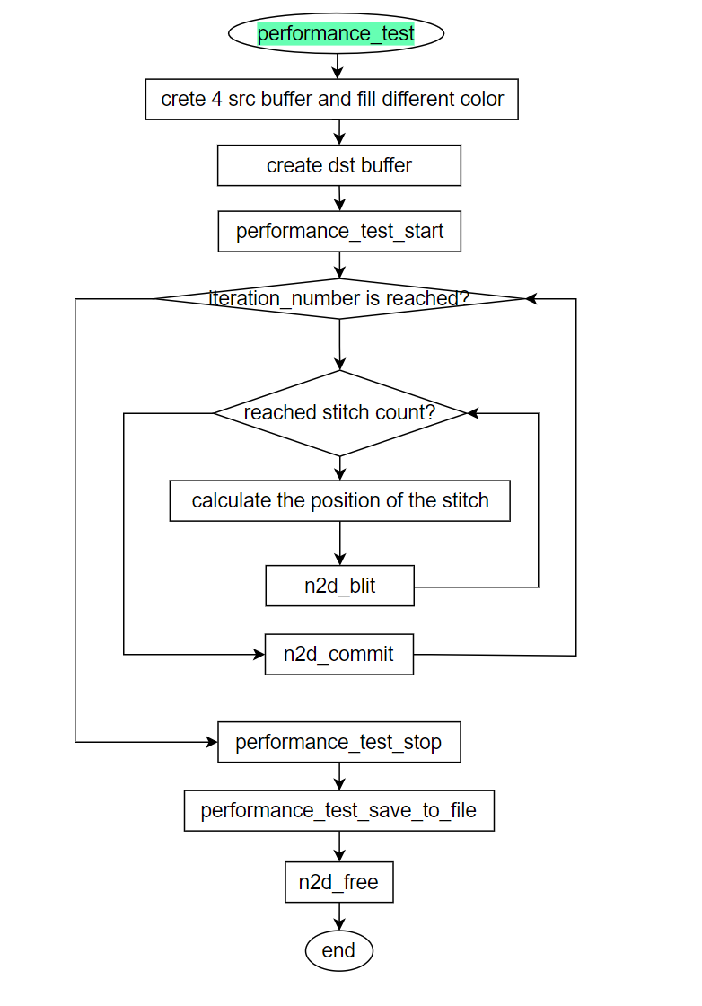

  1. Performance Test
  2. Sample Program
Overall Flow
app_common_simple
stitch_performance

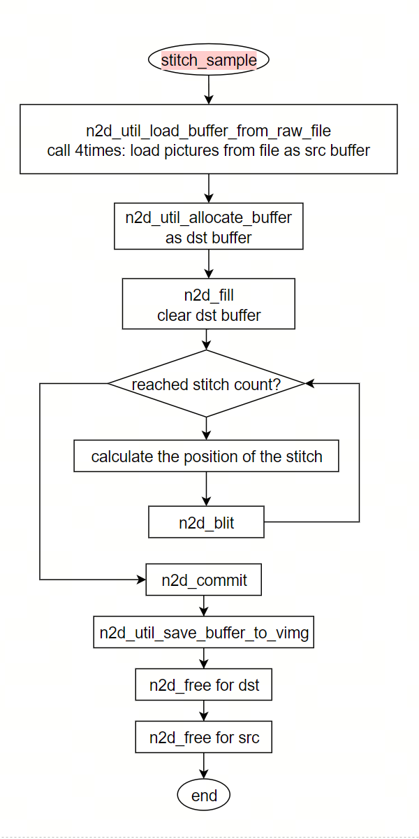

Sample Program Flow
stitch_sample

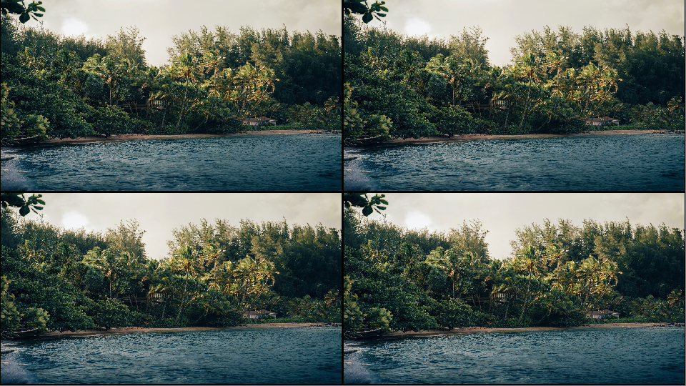

Result explanation:
  1. The program reads files nv12_1920x1080.yuvfour times from the resource directory
  2. The 4 input images are stitched together into one image in a 2x2 grid layout
  3. The stitched image is saved as stitch_sample_3840_2160.yuv
Input files:
format-input
Output file:
format-input

Function Description: sample_create_n2d_buffer demonstrates converting memory allocated via the following two methods into the image buffer structure n2d_buffer_t, which is used by the 2D GPU API:
  1. Non-contiguous physical address: memory allocated using the malloc function
  2. Contiguous physical address: memory allocated via the Hbmem interface
Software Architecture Description
framework_create_n2d_buffer

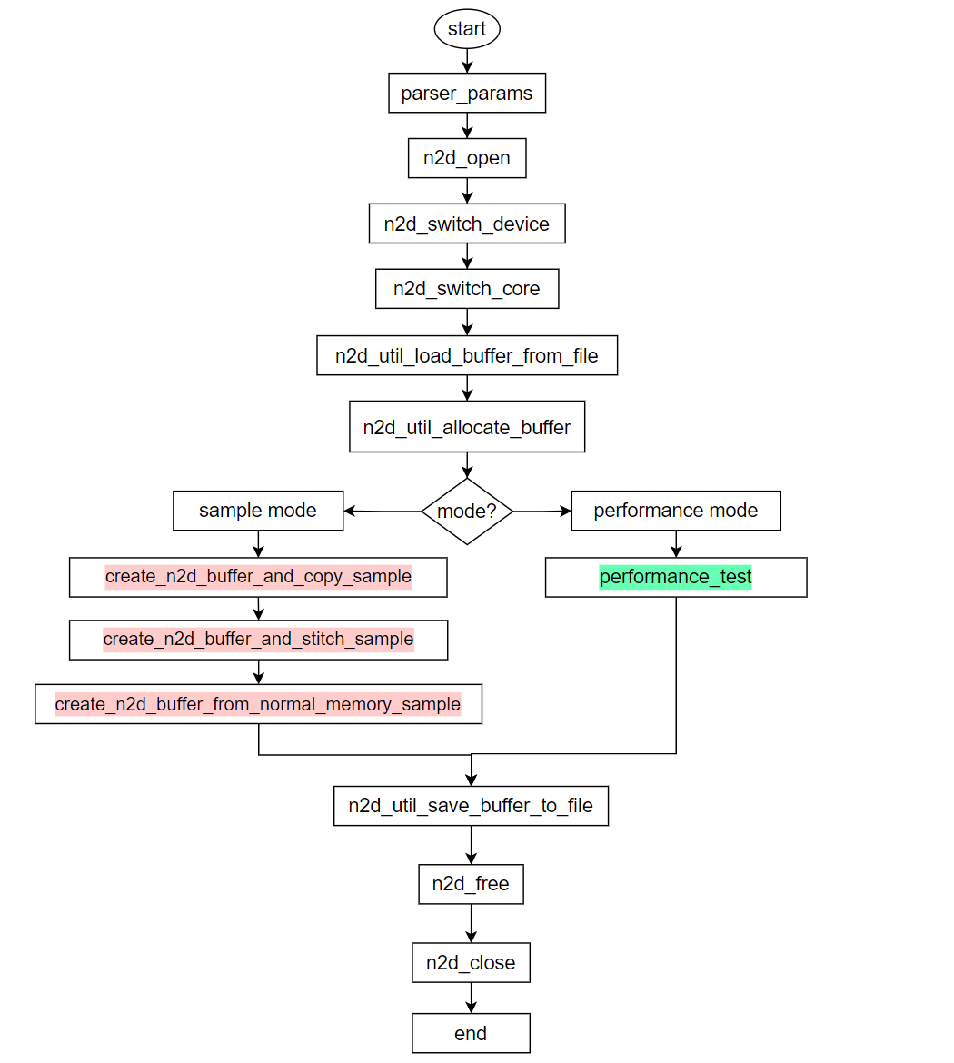

API Flow Description
  2. Perform blit operations: send commands to the command buffer
  3. Perform commit operation: submit pending commands in the command buffer to GPU hardware and block until GPU processing completes
  1. Performance test
  2. Sample program, which provides the following 3 examples:
    • create_n2d_buffer_and_copy_sample: Convert memory allocated via hbmem into the n2d_buffer_t structure used by the 2D GPU API
      • The essence of converting hbmem-allocated memory to n2d_buffer_t: encapsulating the memory descriptor in another form, without involving memory copy

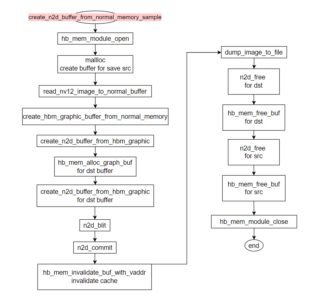

    • create_n2d_buffer_from_normal_memory_sample: Convert memory allocated via malloc into the n2d_buffer_t structure used by the 2D GPU API. The conversion steps are as follows:
      • Allocate physically contiguous memory via the Hbmem interface
      • Copy memory allocated by malloc into the memory allocated by Hbmem
      • Convert the memory allocated by Hbmem into n2d_buffer_t
    • create_n2d_buffer_stitch: Convert hbmem-allocated memory into n2d_buffer_t and perform image stitching
Note: The sample program calls cache-related interfaces, as listed below. For details, please refer to: Hbmem
  1. hb_mem_flush_buf
  2. hb_mem_invalidate_buf
Overall Flow of Sample Program
create_n2d_buffer_sample
create_n2d_buffer_performance
Flow of create_n2d_buffer_and_copy_sample Example
create_n2d_buffer_copy
Flow of create_n2d_buffer_from_normal_memory_sample Example
create_n2d_buffer_normal

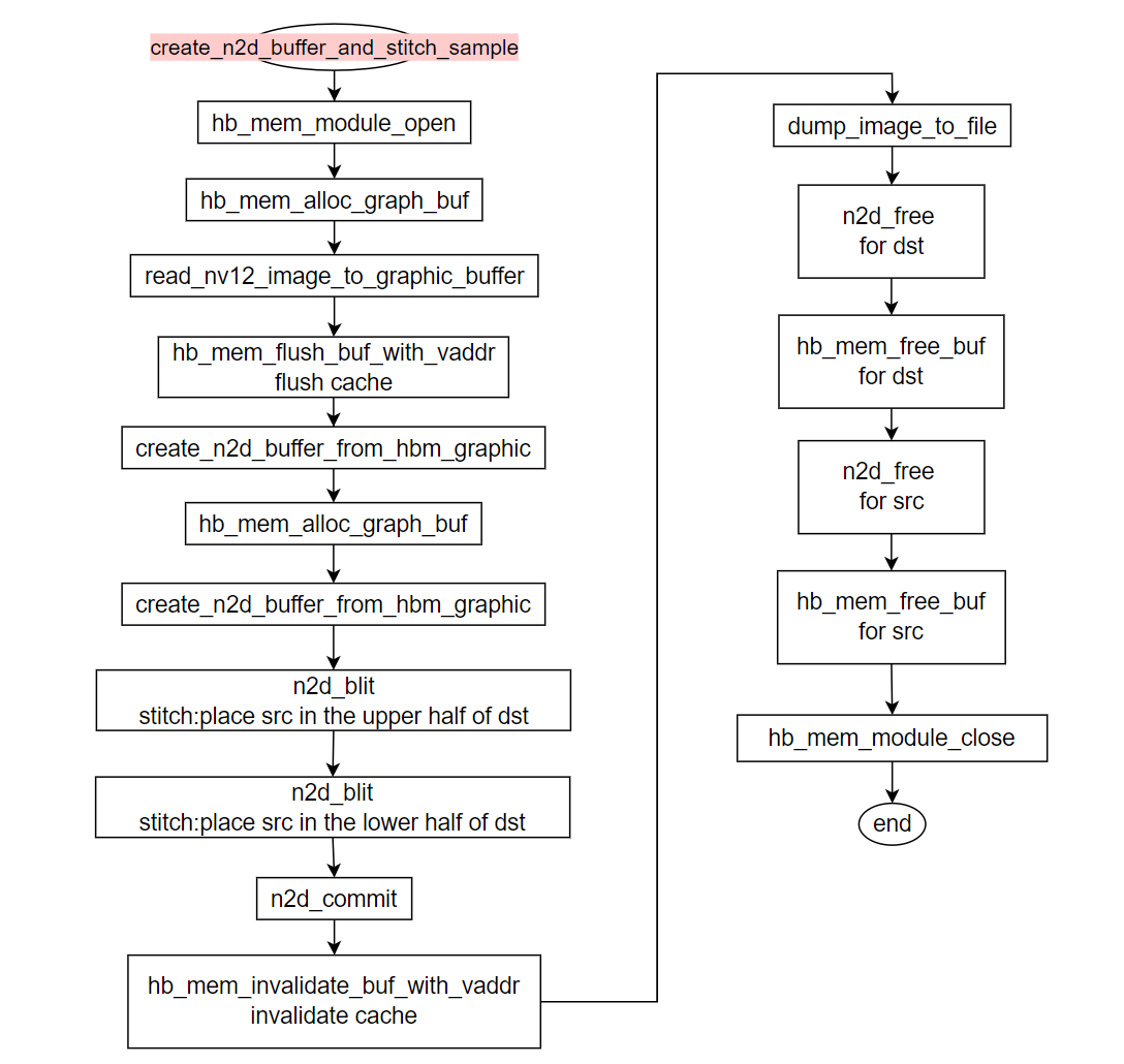

Flow of create_n2d_buffer_stitch Example

Result explanation:
  2. Performs three operations on the input image:
    a. Allocate physically contiguous memory using the Hbmem interface, convert it to n2d_buffer_t, use 2D GPU API to complete image copy, and save the result to file create_n2d_buffer_copy_sample_hbn_1920_1080.yuv
    b. Using Hbmem, the operation on a is enhanced by incorporating a 2D GPU interface to enable vertical and horizontal stitching functionality. The resulting output is saved to the file create_n2d_buffer_stitch_sample_hbn_1920_2160.yuv.
    c. Allocate non-contiguous physical memory using malloc, convert it to n2d_buffer_t, use 2D GPU API to complete image copy, and save the result to file create_n2d_buffer_normal_memory_sample_hbn_1920_1080.yuv
