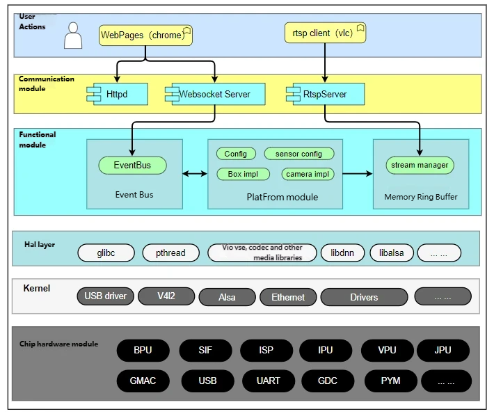

Sunrise camera implements various application solutions such as intelligent cameras and intelligent analysis boxes.
The Sunrise camera source code includes the WebPages layer for user interaction, the communication module layer, and the functional module layer; this document mainly introduces the design of these three modules.
The Hal layer modules include interface libraries for multimedia-related modules, BPU inference libraries, etc.
The Kernel version includes standard driver libraries and system BSP.
The software architecture is shown below:

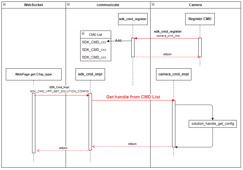

image-20220307211044226
Example:
In the camera submodule, the command SDK_CMD_CAMERA_GET_CHIP_TYPE is defined. After registering this CMD using the camera_cmd_register function, when the websocket submodule receives a web page request to get the chip type, the websocket module can invoke the interface in the camera submodule via the following code.
The entire process is illustrated below:
image-20220307211103942

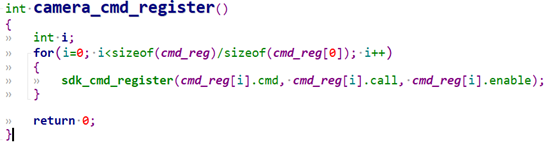

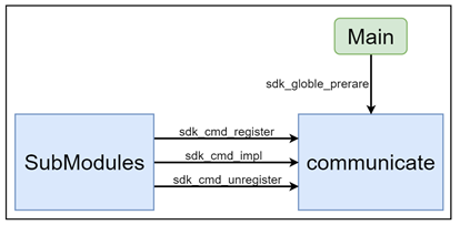

sdk_globle_prerare
Each submodule’s xxx_cmd_register() function is centralized into this function. During startup, the main program calls this interface to register and enable all necessary CMDs of submodules into the subsystem.
Each submodule must implement xxx_cmd_register(), which registers the submodule’s CMDs. This is the fundamental prerequisite for the system to operate normally.
Example:
image-20220307211216299
sdk_cmd_register
CMD registration interface.
sdk_cmd_unregister
CMD unregistration interface.
sdk_cmd_impl
Submodules use this interface to call interfaces implemented by other submodules.

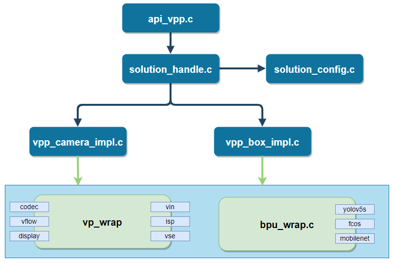

The module mainly includes video encoding, ISP control, image control, OSD watermarking, snapshot capture, video output, algorithm computation, etc.
The internal structure of this module is as follows:
api_vpp serves as the entry point of this module, defining the supported CMD command set;
solution_handle handles application configuration read/write and scene interface assignment;
vpp_camera_impl, vpp_box_impl implement application scenario functions;
vp_wrap encapsulates interfaces of the multimedia module;
bpu_wrap module encapsulates algorithm inference interfaces and post-processing methods.
image-20220307211420601

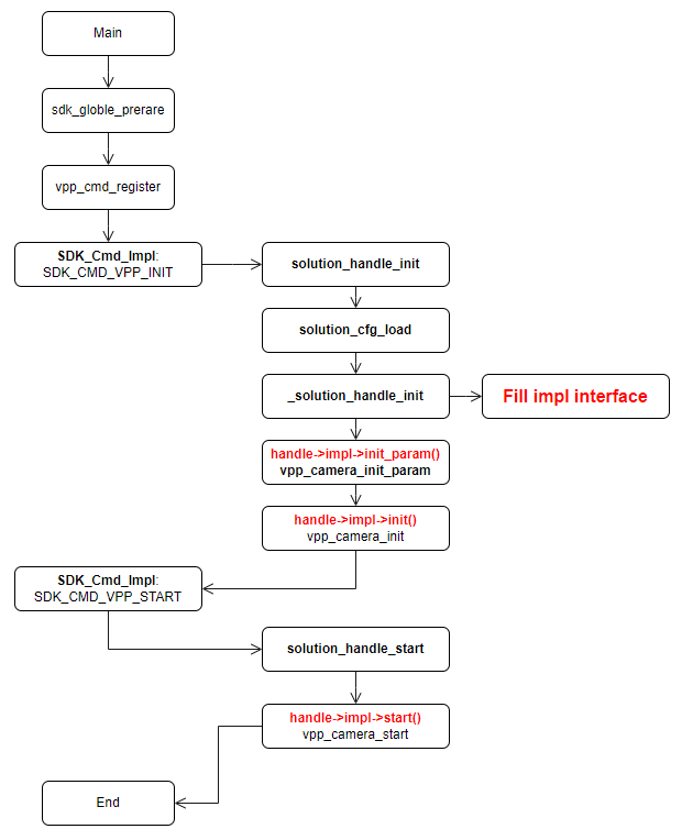

The flow to start an application solution (using vpp_camera as an example) is as follows:
image-20220307211524720
Initialization and startup procedures for other submodules can follow this flowchart.

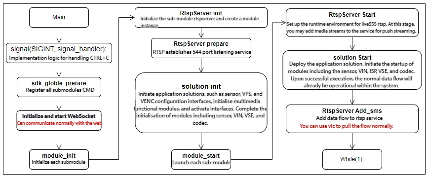

The current basic submodule startup order is as follows. Note that the startup sequence must respect dependencies among submodules.
Execution Flow
image-20220307211837929

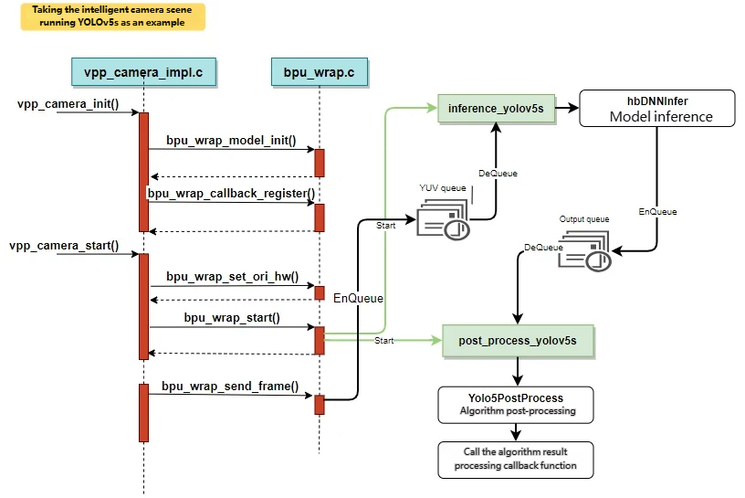

This module performs algorithm model loading, data pre-processing, inference, post-processing, and returns results in JSON format.
The module runtime sequence is as follows:
image-20220307213539978

When the algorithm task starts, the corresponding inference and post-processing threads are launched based on model_name.
Inference Thread Handler
In the inference thread, prepare the output tensor; retrieve YUV data from the YUV queue, call HB_BPU_runModel to perform inference and obtain results; then push the results into the output queue for post-processing.
static void *inference_yolov5s(void *ptr)
	// Prepare model output node tensors; 5 sets of output buffers rotate; simple handling, assuming post-processing is faster than inference
	hbDNNTensor output_tensors[5][3];
	int32_t cur_ouput_buf_idx = 0;
	for (i = 0; i < 5; i++) {
		ret = prepare_output_tensor(output_tensors[i], dnn_handle);
		if (ret) {
			SC_LOGE("prepare model output tensor failed");
			return NULL;
	while (privThread->eState == E_THREAD_RUNNING) {
		// Retrieve image data for algorithm computation, typically in NV12 YUV format
		if (mQueueDequeueTimed(&bpu_handle->m_input_queue, 100, (void**)&input_tensor) != E_QUEUE_OK)
			continue;
        // Model inference
		ret = hbDNNInfer(&task_handle,
				&output,
				&input_tensor->m_dnn_tensor,
				dnn_handle,
				&infer_ctrl_param);
		// Enqueue post-processing data
		Yolo5PostProcessInfo_t *post_info;
		post_info = (Yolo5PostProcessInfo_t *)malloc(sizeof(Yolo5PostProcessInfo_t));
		mQueueEnqueue(&bpu_handle->m_output_queue, post_info);
		cur_ouput_buf_idx++;
		cur_ouput_buf_idx %= 5;
Post-processing Thread Function
In the post-processing thread, retrieve algorithm results from the output queue; call the post-processing function; invoke the algorithm task callback to handle results (currently callbacks send results directly to the web for rendering).
static void *post_process_yolov5s(void *ptr)
	tsThread *privThread = (tsThread*)ptr;
	Yolov5PostProcessInfo_t *post_info;
	mThreadSetName(privThread, __func__);
	bpu_handle_t *bpu_handle = (bpu_handle_t *)privThread->pvThreadData;
		// Retrieve data from post-processing data queue
		if (mQueueDequeueTimed(&bpu_handle->m_output_queue, 100, (void**)&post_info) != E_QUEUE_OK)
			continue;
		char *results = Yolov5PostProcess(post_info); // Perform post-processing, e.g., obtain bounding boxes, filter low-confidence results, scale box dimensions to display video size
		if (results) {
			if (NULL != bpu_handle->callback) {
				// Algorithm result callback; currently sends results via websocket to browser
				bpu_handle->callback(results, bpu_handle->m_userdata);
			} else {
				SC_LOGI("%s", results);
			free(results);
		if (post_info) {
			free(post_info);
			post_info = NULL;
	mThreadFinish(privThread);
	return NULL;
