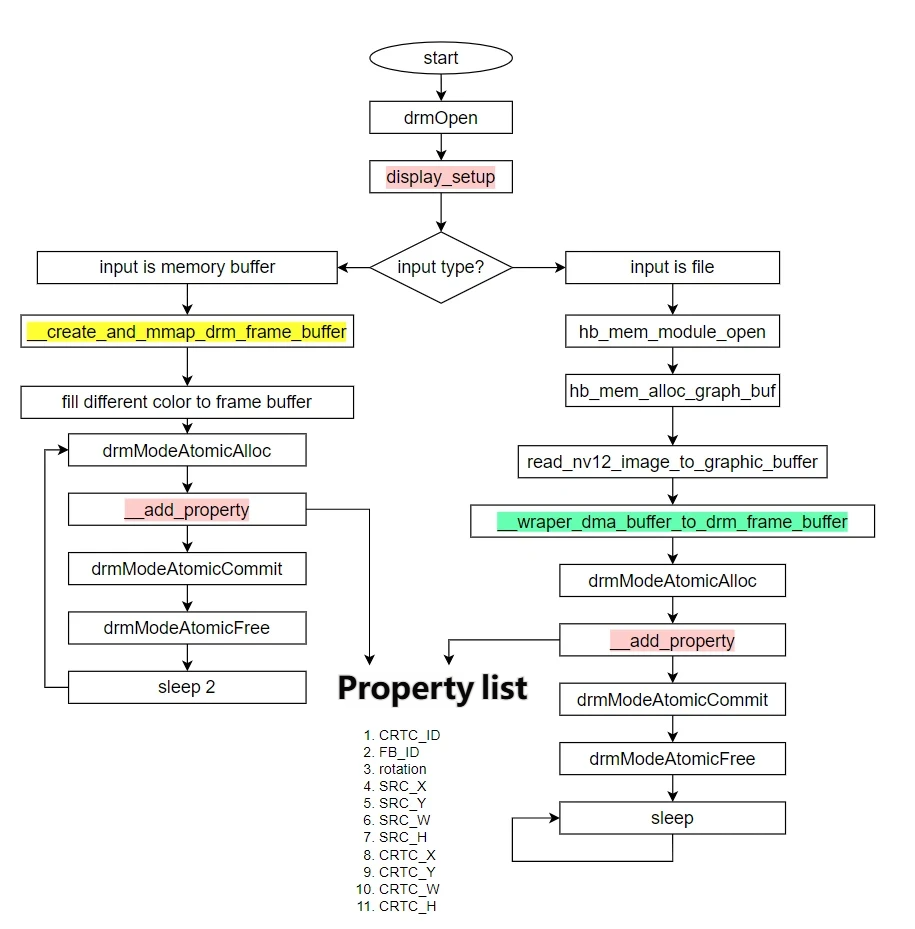

Depending on the input parameters, the processing flow is divided into two cases:
Case Description Characteristics Differences (Function background color in diagram)
Directly display data in memory Allocate memory from the DRM framework Yellow
Read file and display Allocate memory externally and pass to DRM framework Green
sample
sample_vot_data_flow
Functions with background colors in the diagram are wrappers for DRM interfaces. Below is a detailed explanation of each function’s functionality and flow:

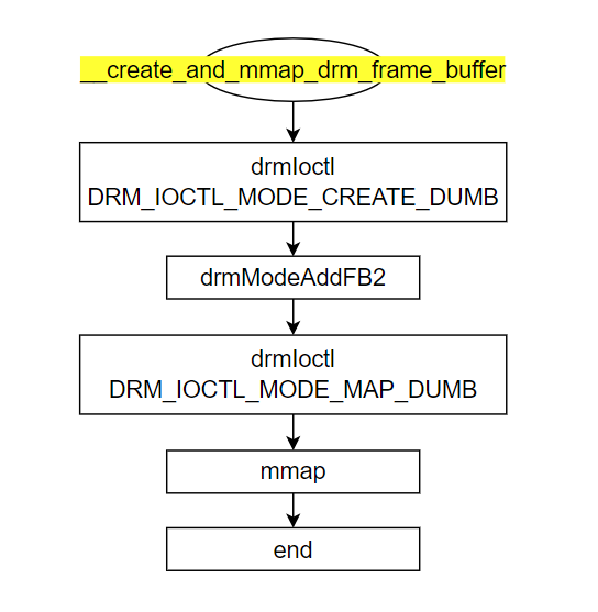

  1. __create_and_mmap_drm_frame_buffer (yellow background): Call DRM interface to allocate memory from the DRM framework

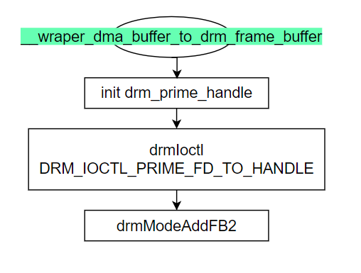

  2. __wraper_dma_buffer_to_drm_frame_buffer (green background): Allocate memory externally and pass it to the DRM framework

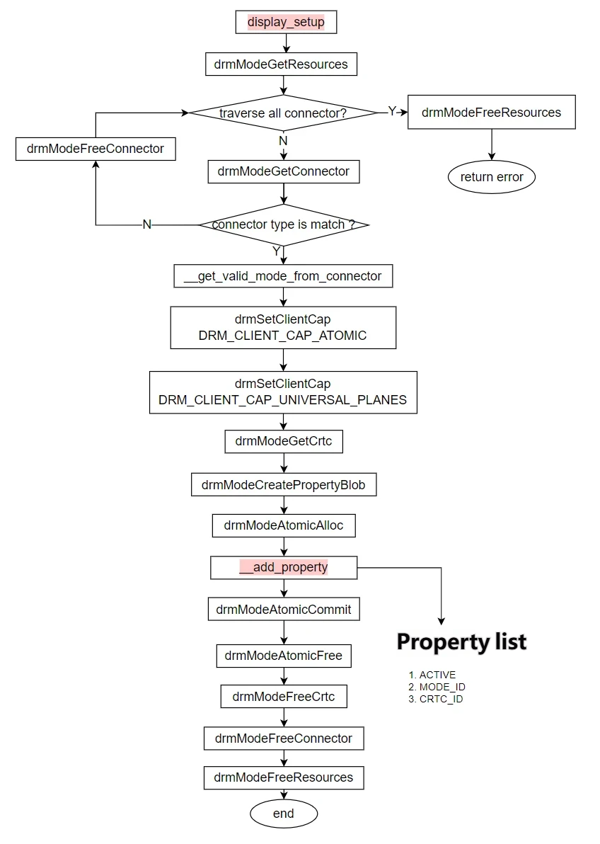

  3. display_setup: Call DRM interface to obtain an appropriate connector, and set corresponding crtc and connector as needed
  4. __add_property: Call DRM interface to set properties and complete layer display
Below are flowcharts for the four functions mentioned above:
sample_display_create_buffer
sample_display_wraper_buffer
display_setup
sample_vot_display_setup

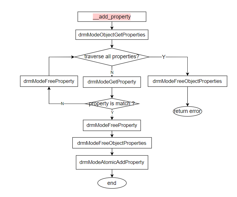

__add_property
sample_vot_add_property

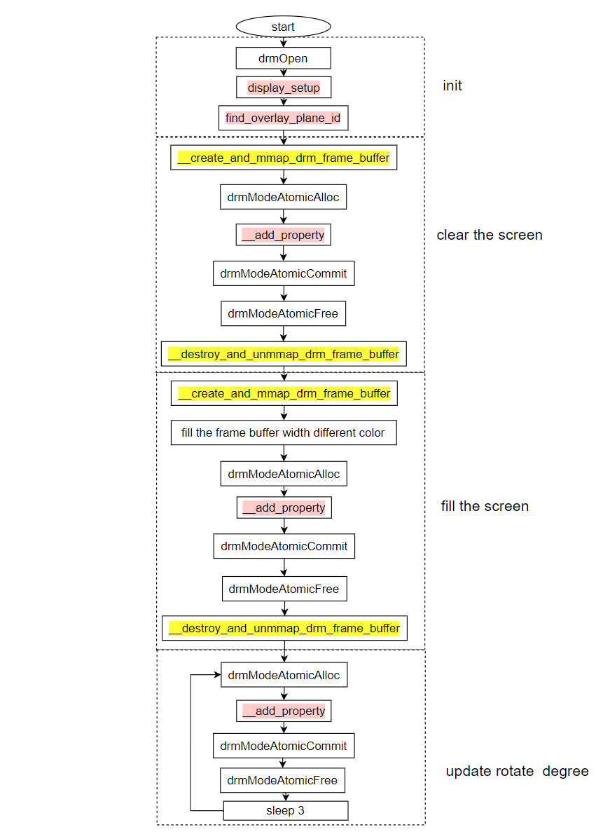

API Flow Description
sample
sample_rototaion_data_flow
  1. display_setup (red background): Call DRM interface to obtain an appropriate connector, and set corresponding crtc and connector as needed

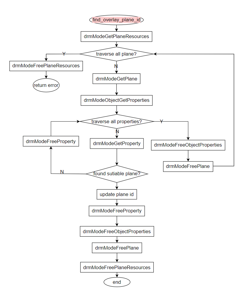

  2. find_overlay_plane_id (red background): Traverse all planes to find the one that supports rotation

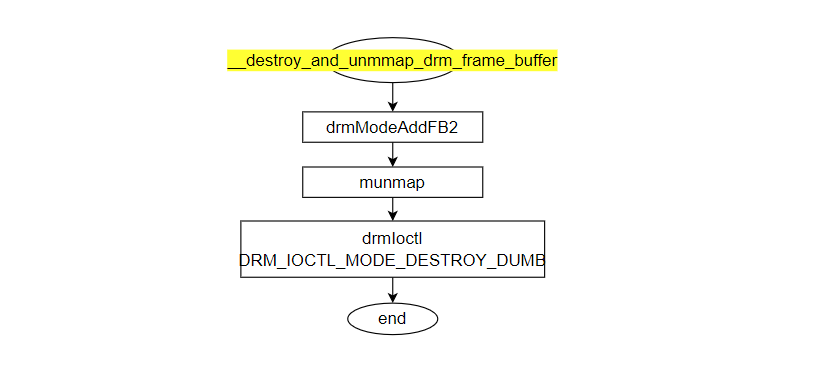

  3. __create_and_mmap_drm_frame_buffer (yellow background): Call DRM interface to allocate memory from the DRM framework
  4. __destroy_and_unmmap_drm_frame_buffer (yellow background): Call DRM interface to release memory allocated from the DRM framework
  5. __add_property (red background): Call DRM interface to set properties, completing layer rotation and display
display_setup
sample_display_flow_find_ovrlay_plane_id
__add_property
sample_display_destroy_and_unmmap

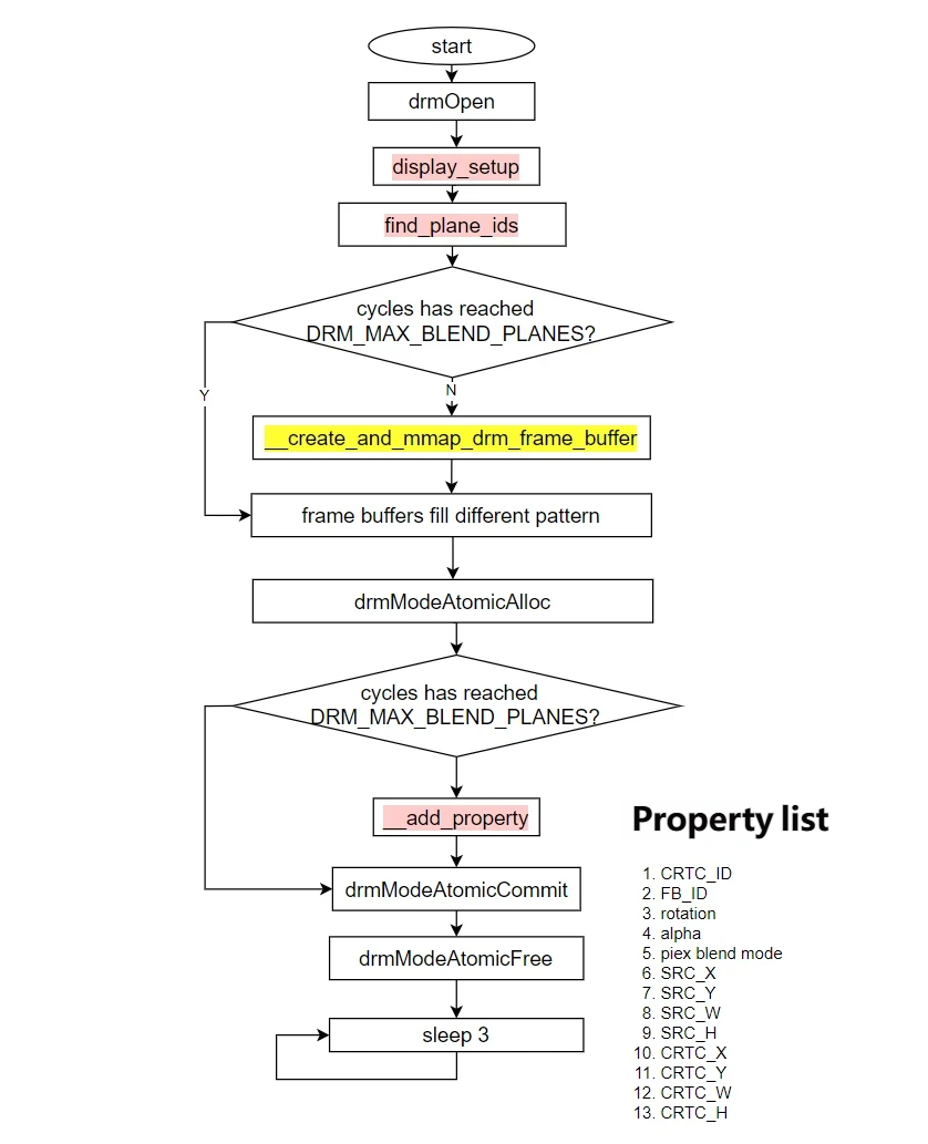

sample
sample_blend_data_flow

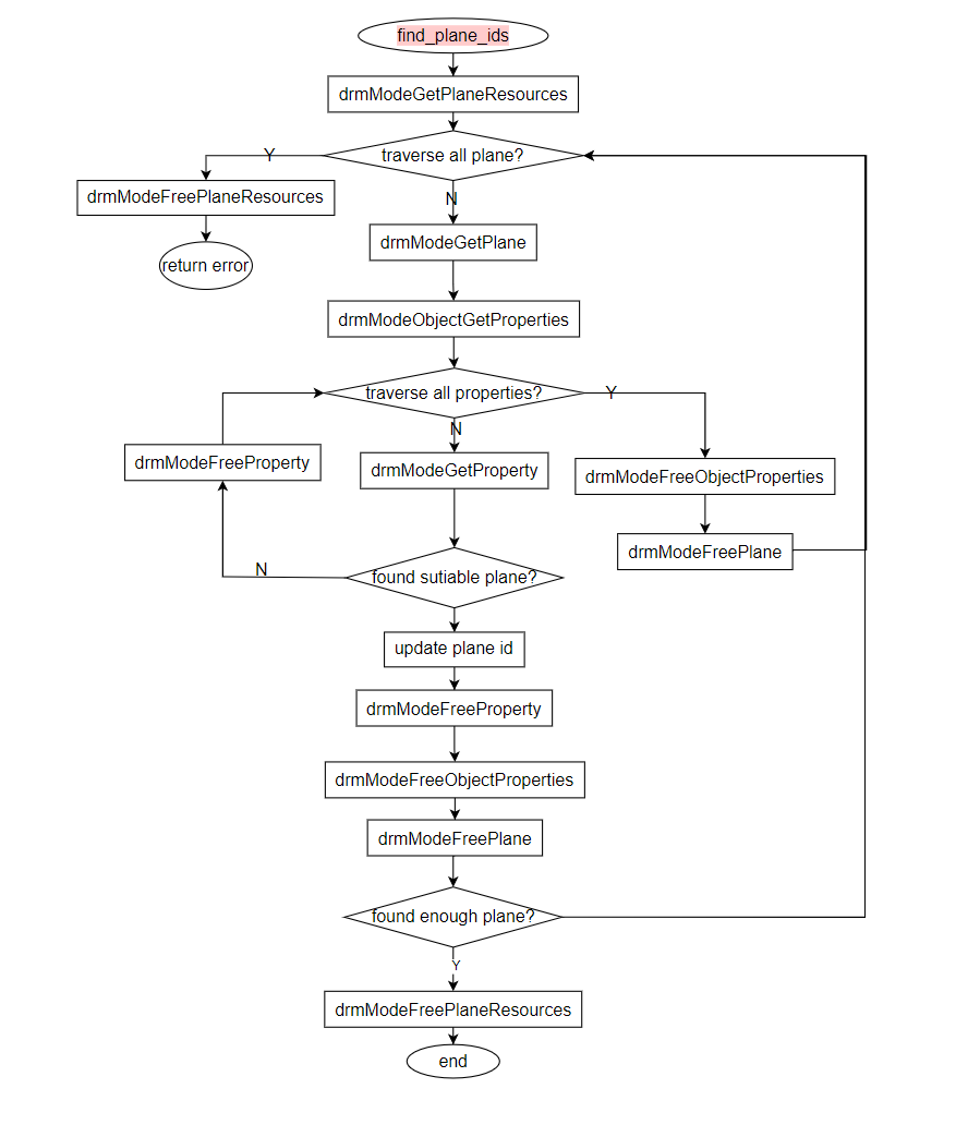

  2. find_plane_ids (red background): Traverse all planes to find those that support blending
  5. __add_property (red background): Call DRM interface to set properties, completing multi-layer blending and display
display_setup
find_plane_ids
sample_display_find_plane_ids
__add_property

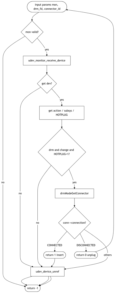

Function Description: based on sample_vot, sample_vot_drm_hotplug adds HDMI hot-plug detection, a select event loop, and Page Flip-based asynchronous display. It supports automatic reconnection and display resumption after “starting the program first and then plugging in the HDMI cable” or “unplugging and replugging the HDMI cable”. demonstrates the following functions by accepting different input parameters:
  1. List the resolutions supported by the HDMI display
  2. Read an image and display it via HDMI
  3. Create a frame buffer, fill it with color, and display it via HDMI
Software Architecture Description
display_sample_framework

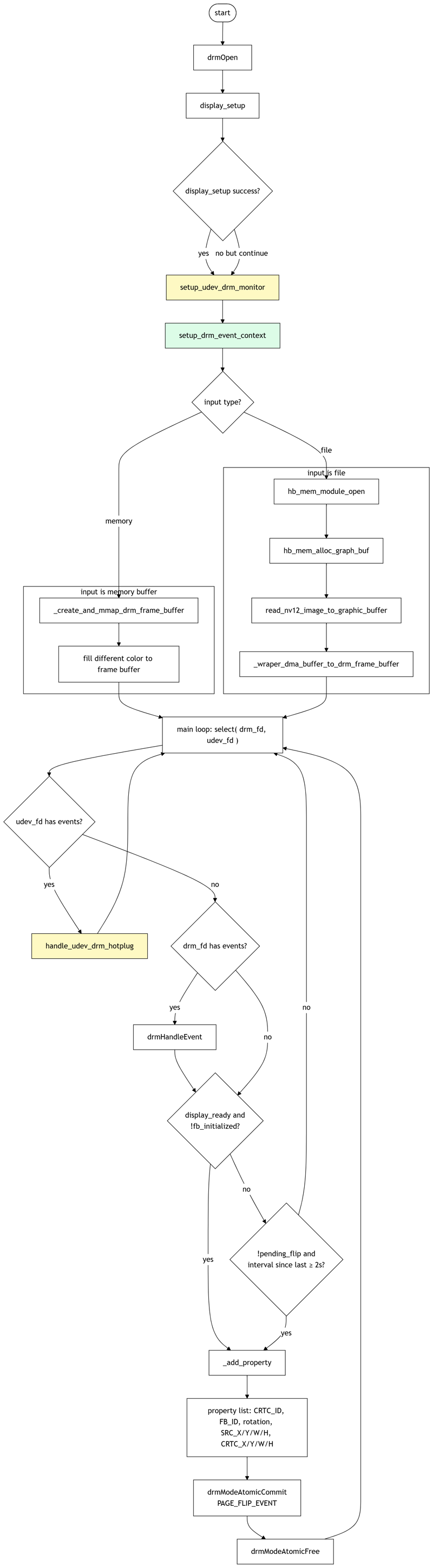

Scenario Background color of text in the figure
HDMI display hot-plug Yellow
DRM Page Flip event Green
sample
sample_vot_drm_hotplug_data_flow
Function descriptions and flow in the figure with colored backgrounds:

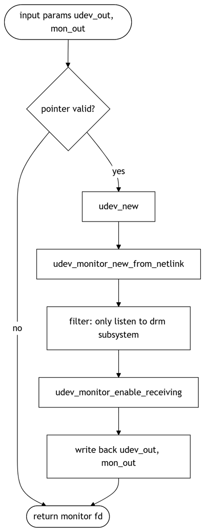

  1. setup_udev_drm_monitor (yellow background): Create and initialize a udev listener that only receives device events from the DRM subsystem (such as HDMI hot-plug events).
  2. handle_udev_drm_hotplug (yellow background): Handle a single DRM hot-plug event read from the udev monitor, and determine whether it is an “insert” or “remove” based on the current connector status.

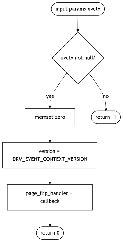

  3. setup_drm_event_context (green background): Initialize the DRM event context drmEventContext, which is used to receive and handle the Page Flip completion events reported by the DRM kernel.
Below are flowcharts for the three functions mentioned above:
sample_vot_drm_hotplug_udev_setup
sample_vot_drm_hotplug_udev_handle
sample_vot_drm_hotplug_flip
